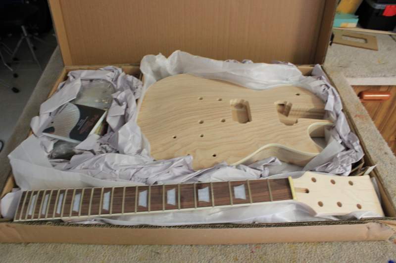

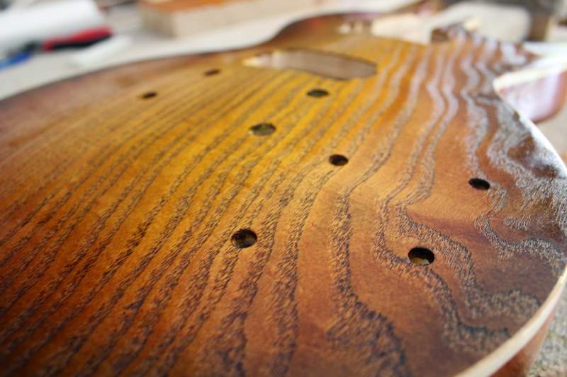

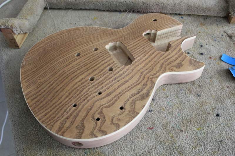

    Today I started a new project - an awesome LPA-1 Ash Les Paul. I've never built an LP before, and this looks to be a great starting point . Right out of the box the kit looks great with a solid ash body and a one-piece ash veneer on the top. Both the top and the body display some really nice figure, and I can't wait to get some stain on it!

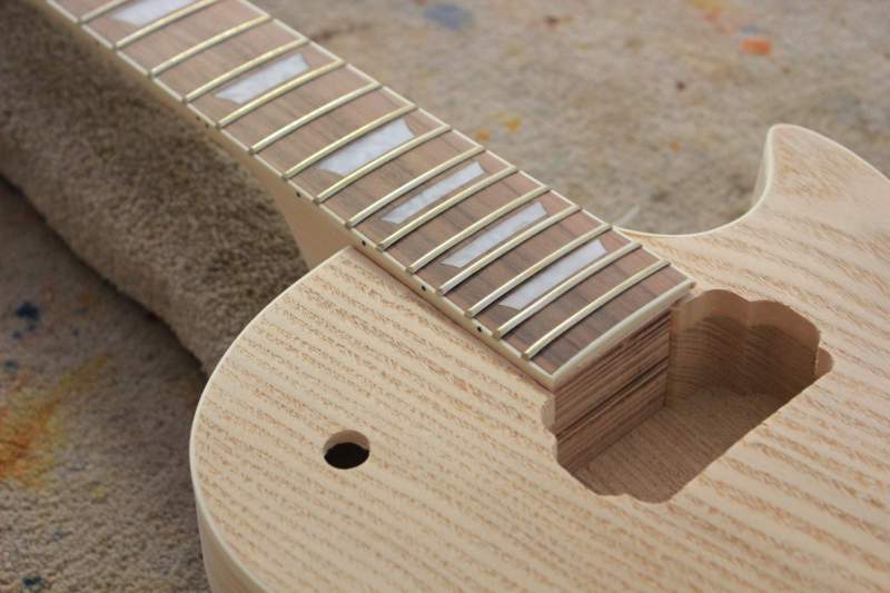

    As for the neck, the neck pocket fit is spot on with no gap on either side to be seen. The heel fits nice and snug in the pocket, and on the lower side the fretboard is sitting right down on the body. I'm very happy with the fit indeed.

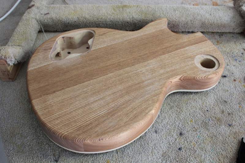

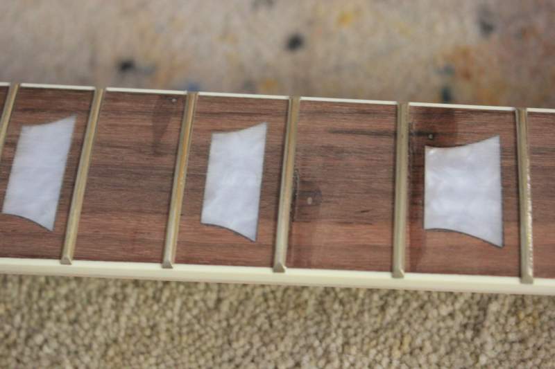

    While the neck fit is perfect, the body does exhibit a couple of annoying glue spots under the binding, and there are quite severe machining marks all around the outside.
    Nothing for it but to keep sanding away with 240 grit until all the machining marks are gone. I do hope there's some binding left when I'm finished! After sanding the body I'll hit the glue spots with a little stain to see if I need to get the wire brushes out. The fretboard also has some annoying little glue patches where it has obviously been filled. I guess I'll have to get a bit of fine wet and dry on to these as well.

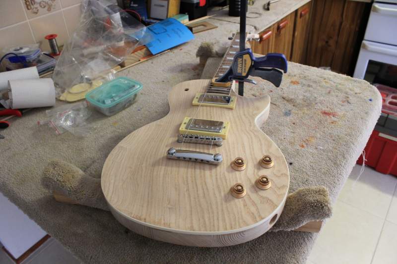

    Anyway, glue spots and machining marks not withstanding, I got the kit together for a mock build in next to no time. With the neck straight in the pocket, the bridge and stop-bar posts have been positioned correctly (phew) and the E strings travel straight up the fretboard. At it's lowest bridge height the strings are on the deck at the 22nd fret, so all in all she's looking pretty good for a straightforward assembly!

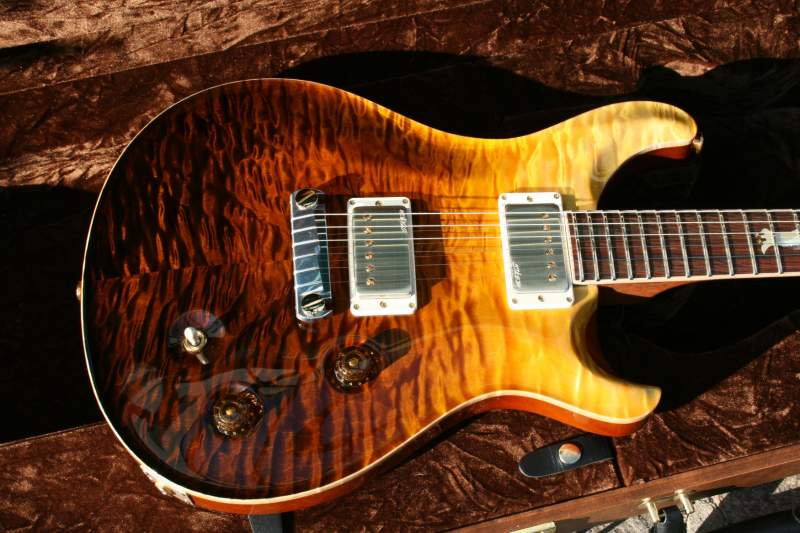

    I'm also considering a more radical dye job than the straight sunburst. I thought that something like the PRS "sandstorm" fade might look really great on this grain pattern. Something like this:
    I think it looks pretty awesome, and could suit this grain pattern nicely. I still haven't decided 100% - I may just stick with a simple honeyburst.

    nice one Gav, new project always gets the enthusiasm up. Love the look of the sandstorm, I reckon you can pull this off. Remember how complicated Rickmo's 3 bucker LP was, I'd stick to the 2 buckers, being your 1st LP !
    Look forward to seeing it with stain on
    Cool looking top. Love the PRS fade.
    @Wokka - thanks for the vote of confidence! :P. @Pabs - great video! on my test piece I worked in the opposite direction (lighter stain first going to dark) but the effect was much the same. Can't wait to get the rags out, but mucho sando to go first.
