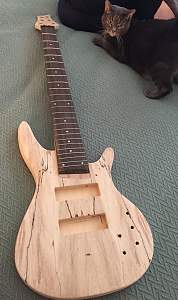

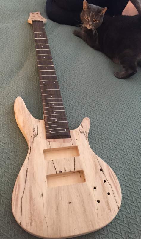

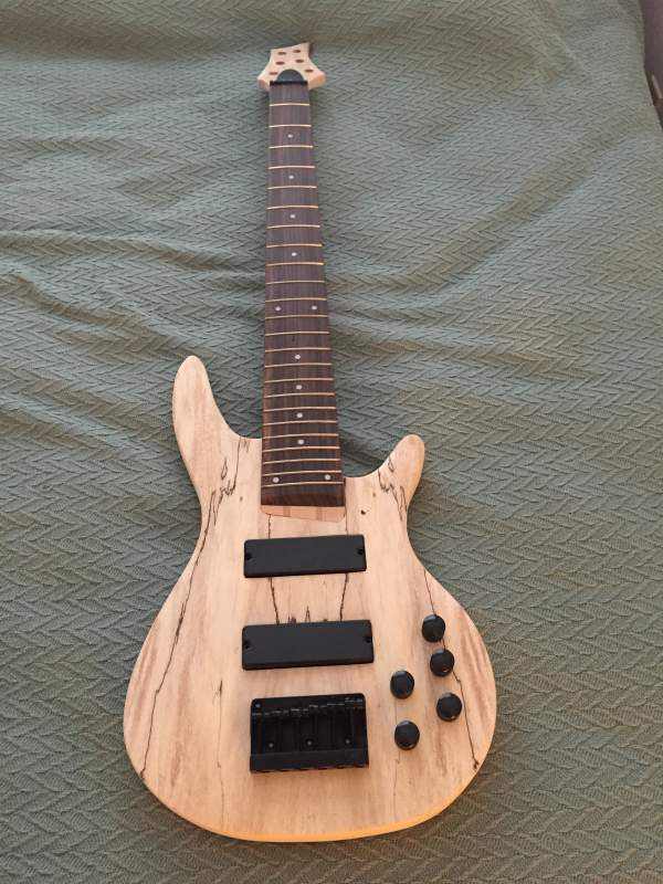

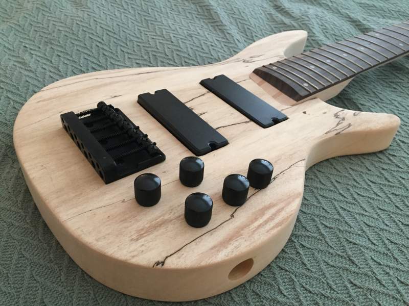

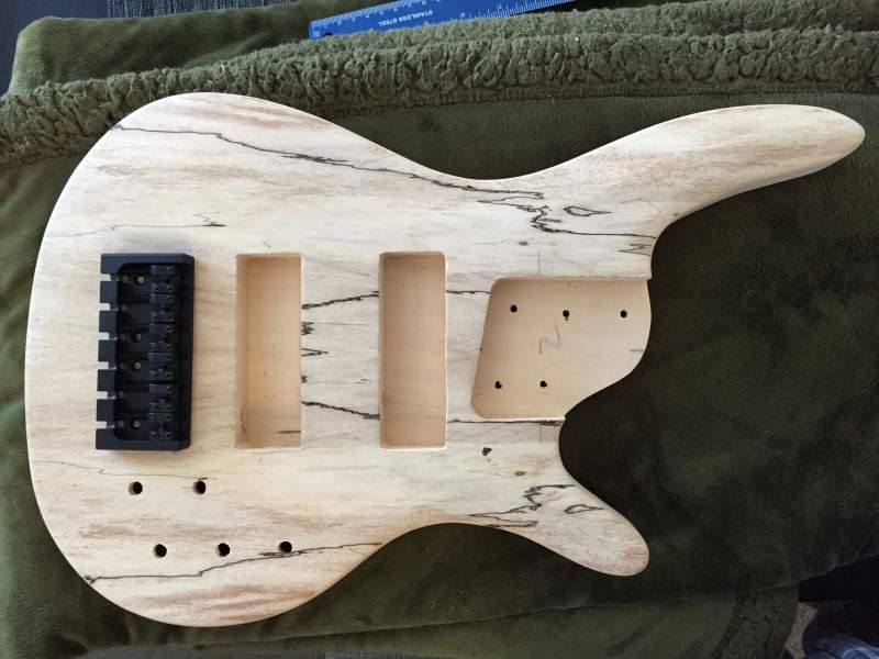

    I'm pretty happy with the spalt! Time to do a mock build:
    Looks pretty good! My cat Sophie even likes it.

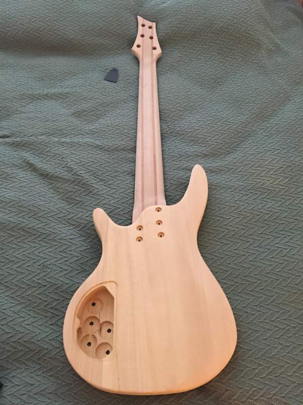

ID:	679 Click image for larger version.
ID:	680 Click image for larger version.
    The hardware in the last picture will not make it to the final instrument. I ordered a Hipshot A bridge and Bartolini quad coil pickups during a Black Friday sale over the weekend. I'm planning to drill through-body holes for the strings, and get a Michael Pope Flexcore pre-amp with coil taps.

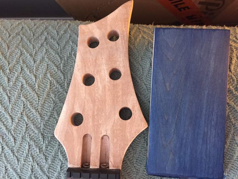

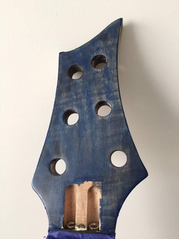

    What about color (sorry, I'm American, no unnecessary vowels for us!), you may be asking? I did dozens of tests, with over 100 coats, before settling on a Minwax blue woodstain (water-based) for the spalted maple. For the back of the body, I'll be using a Minwax walnut stain. My wife has some ideas for the back-of-neck staining, and we're undecided on that as of yet.
    Here's the final blue maple stain sample next to the headstock:
    I love the blue color on other spalted maple instruments I've found. I tried using a ink-based stain, but wasn't happy with the application process, or the final color, so I opted for the Minwax stains. I'll probably finish the body with Tru Oil. I bought some for testing, but haven't had a chance to try it on my sample woods yet.

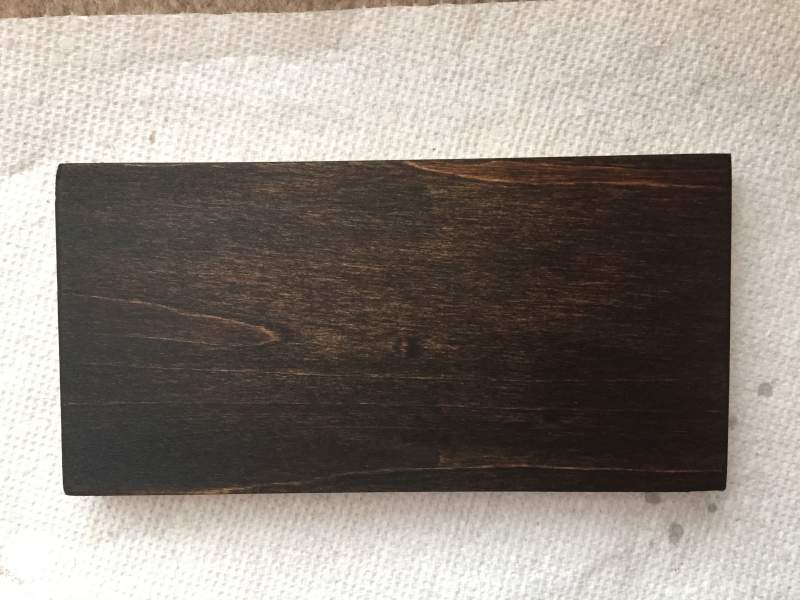

    Here's the walnut stain on a test piece of basswood:

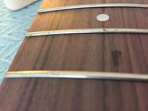

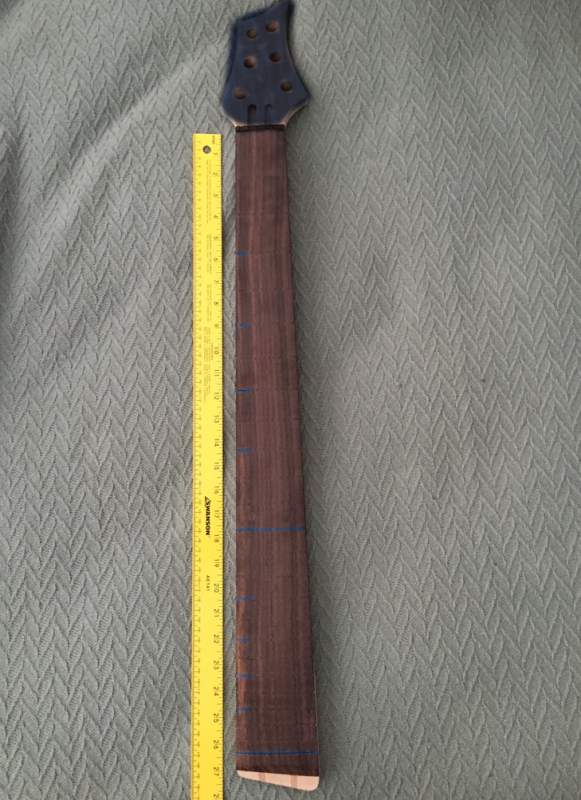

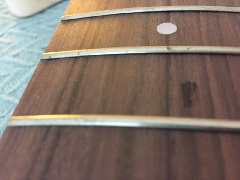

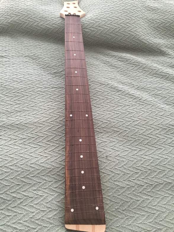

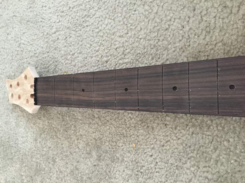

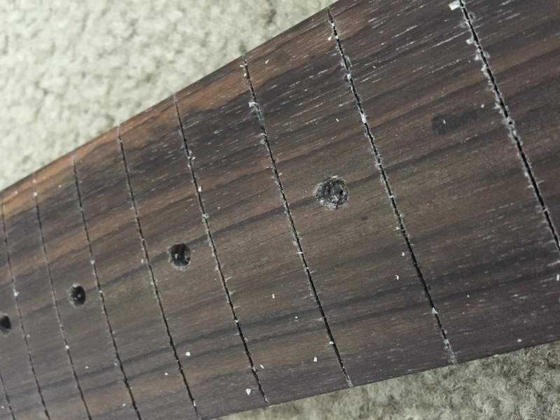

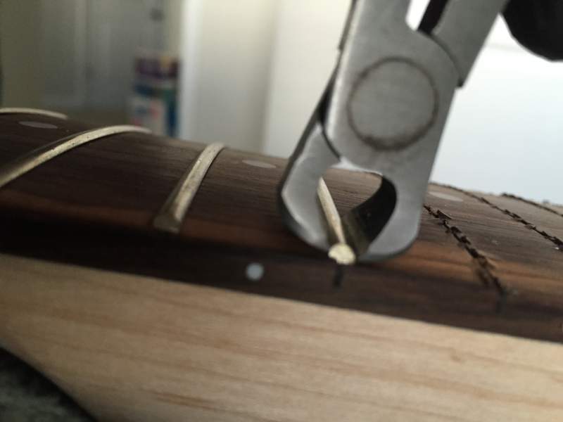

    I'm still undecided about the fretboard. It's going to be fretless, which is just as well, because the frets as installed are kind of a mess:

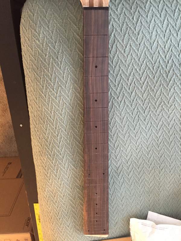

    The fretboard, as seen above, isn't perfect, either, but sanding would take care of the glue spots on it. I'm doing a test, right now (as I type this) on a spare fretboard to see how I'm going to fill the fretslots and inlay dots (I wish I knew I could have custom ordered a plain fretless fretboard a few weeks ago!), and stain it with an ebony Minwax stain (my tests look good with that!), but I may replace the fretboard entirely with a piece of ebony or pau ferro from LMII or Stewart MacDonald.
    The spalted maple and basswood body look to be in great shape. I'm going to carefully sand the spalted maple (it's thin!) before staining. I was going to do a base, pore-filling stain of black, but I don't want to do too much sanding on it.
    My plan for the fretboard is to have no fretlines, with slight (1-2cm) accent fretlines at the top of the board, near the B and E strings, for the fundamental frets (3, 5, 7, 9, 12, 15, 17, 19, 21, and 24). There may be other decorations on the fretboard, but I'm not skilled enough yet with the Dremel to even conceive of any!
