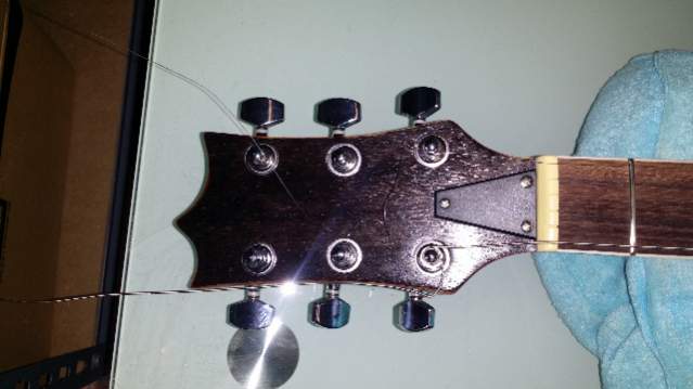

    Opened up the kit, all appears good. Neck fits well as does hardware in mock build (not pictured). First job, shape the headstock. I had a crack at a Gibson style headstock shape but my effort was nothing short of a disaster using my limited tools (and skill?). Opted for a 'custom' design instead.

    Thanks bargeloobs. There was some method to my madness, design is deliberately off center as my attempt at a centered design just didn't look right. Reckon I could nail a more traditional design with a Dremel... thats a good idea for a new thread! 'Excuses to buy a Dremel' - so far I have used sharpening kitchen knives, garden shears, repair an old metal gutter downpipe, polish jewelry...

    I wasn't quite happy with the head-stock with tuning posts in place. Needed to take off about 2-3mm off one side. Lines up a bit better now (according to my eye..)

    This is my headstock shaping arsenal..
    Coping saw, rasp and a rolled up piece of 80 grit emery (shearers grinding paper).
    Good stuff demonstrates the skill is in the craftsman. I now plan to practice some headstock designs on scrap wood after this build (probably a good idea anyhow instead of attacking a neck headstock 'cold')
