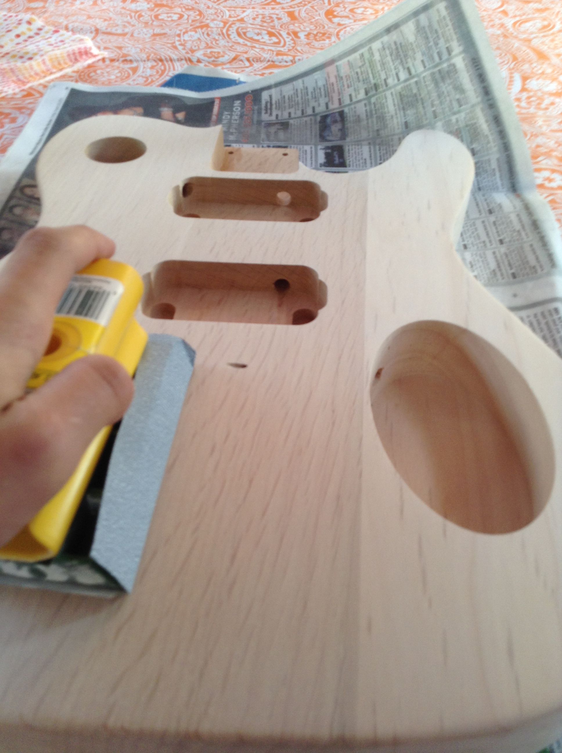

    I'm about to start building my first guitar, I'm not sure whether to be excited or nervous. I'm 14 years old and hope that this will expand my knowledge on how the inside of a guitar works.Here is the kit before I start!
    The colour will be an emerald green wudtone finish
    Before I continue with sanding, I want to experiment with designs for the head stock, here are the ones I narrowed it down to.
    Now on to sanding, I used 220 and 400
    welcome to the forum Jacob, don't think I've seen one of these kits built. Great choice and should look awesome in emerald green. A tip I wouldn't sand past about 320 grit paper or the surface won't have enough 'tooth' for the wudtone to soak into.

    I'd recommend you do a mock build to see how the neck fits in the neck pocket and have a read of the 'how to build' thread on the forum.
