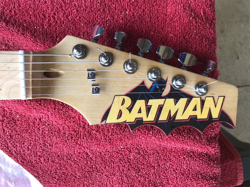

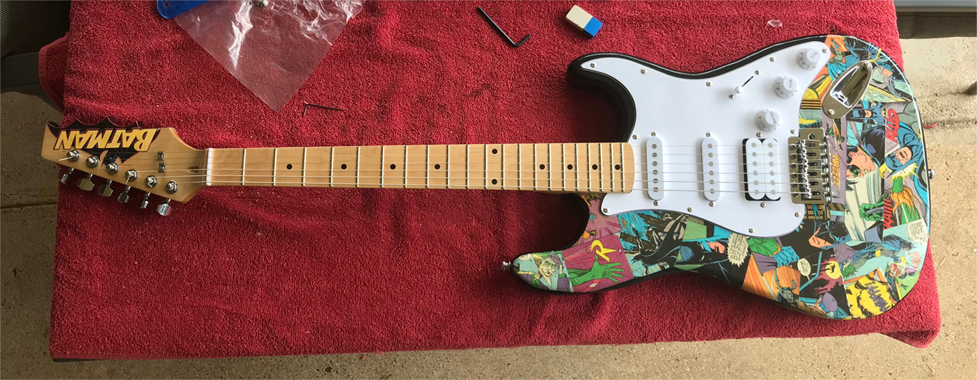

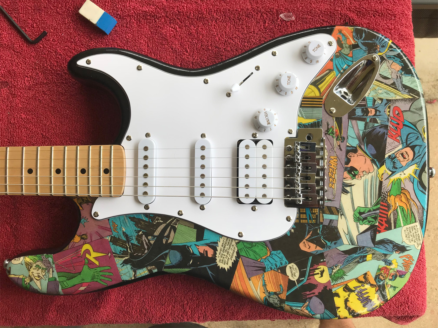

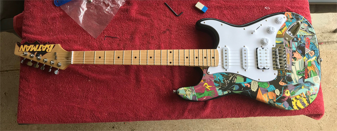

    Finished my Bat Strat today. It’s my first build. Upgraded the pickups to s-s-h configuration but that’s about it. Cut up some Batman comics to cover the front of the body then glossed the hell out of it. Cut the headstock to fit the logo.
Name:	Bat Strat front.jpg
Name:	Bat Strat body.jpg
Name:	Bat Strat head.jpg

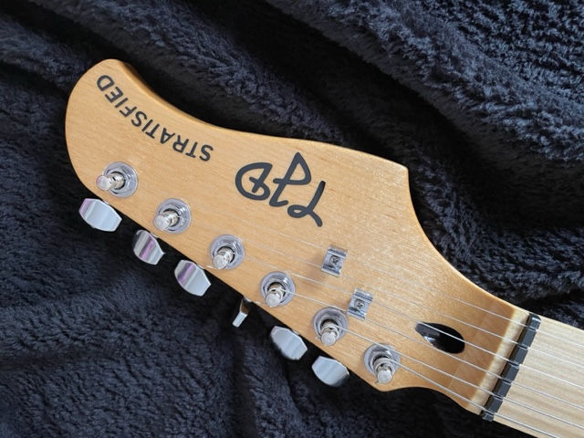

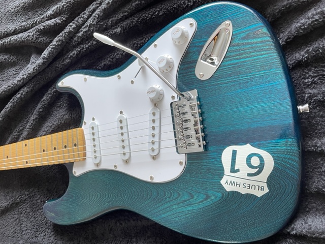

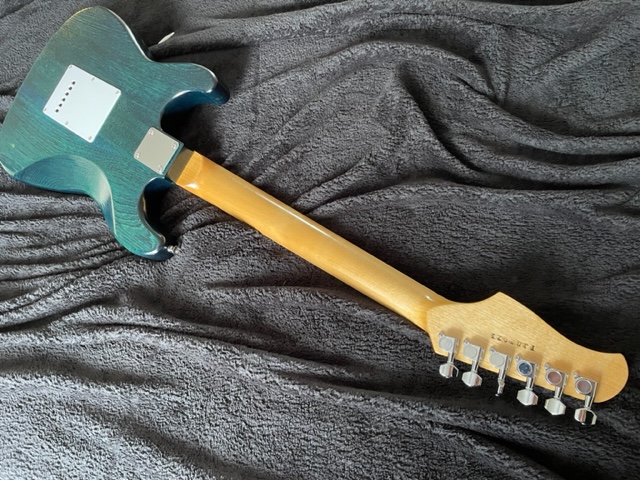

    My STA-1M:
    All stock parts.
    The body was stained with Ubeaut blue water dye (diluted to 25%, 2 coats) (the ash colour turned the blue to aqua!). Given 3 brushed on and 6 wiped on coats of Tru-oil. Sanded along the way up to 2000 g. I wanted to keep the grain texture on the body.
    The neck was given 9 coats of Tru-oil, and the fretboard given 6 coats.
    The headstock logo and body sign are Cricut vinyl stickers put on after coat 3.
    The serial number is stamped on, filled with ebony Timbermate and sanded flat before the Tru-oil.
