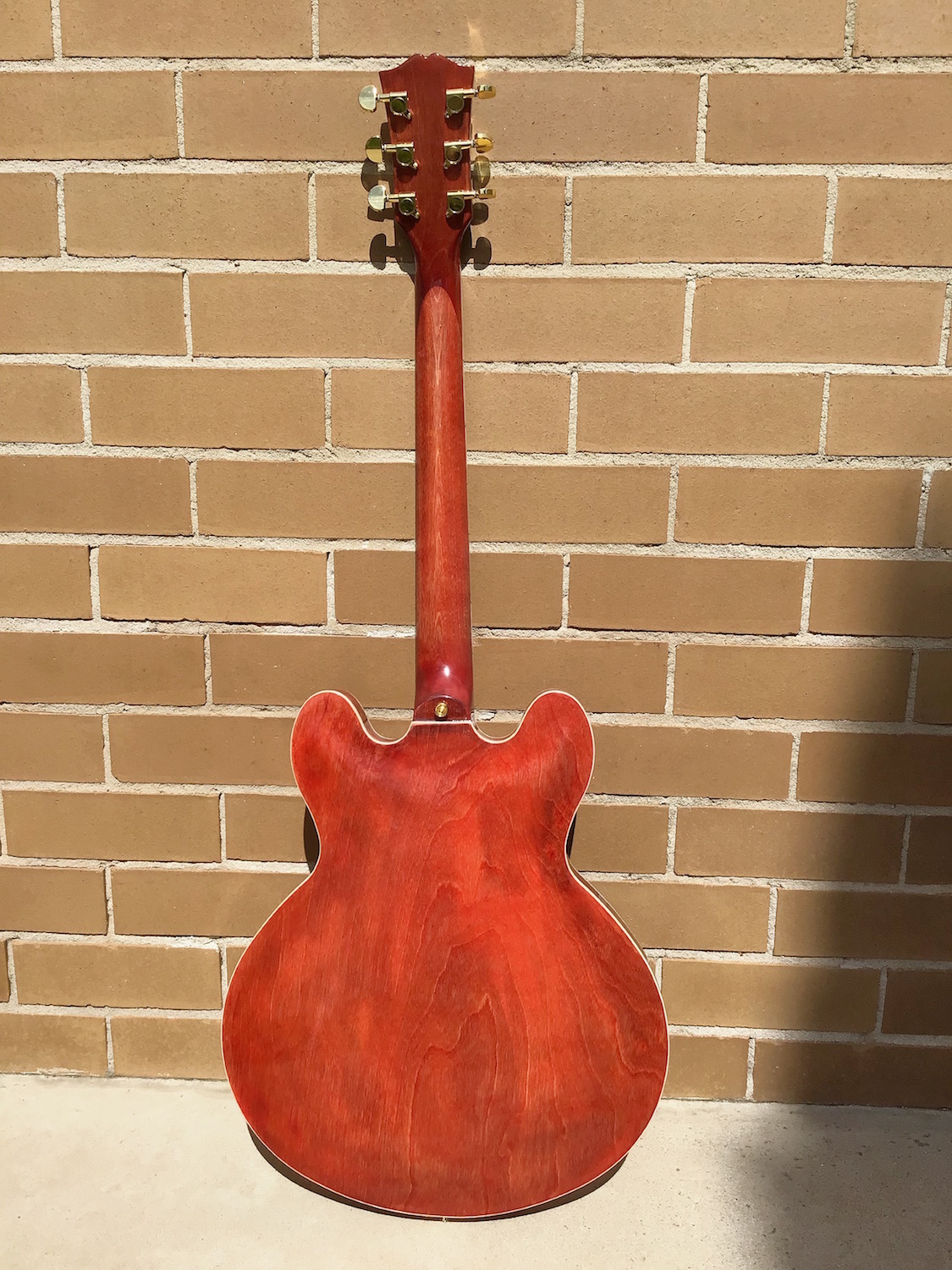

    ES-1GT Kit
    Grain filled using Timbermate Mahogany.
    Vintage Cherry Red custom colour, mixed from Colortone Cherry Red with Mahogany and Walnut Stain.
    Sprayed clear acrylic lacquer, then cut and polished to high gloss finish.
    Standard kit other than truss rod cover and orange drop capacitors.
    November 2013 GOTM Winner
    Standard kit in custom orange stain. Gloss face and steel wool rubbed back and neck. Custom pick guard and pre-wired harness (vintage style). Reworked nut and 12-54 wound third Jazz strings. Sounds awesome.
    I love this one!

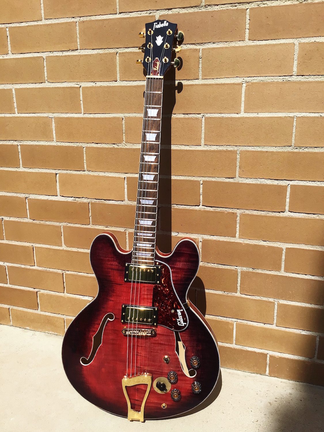

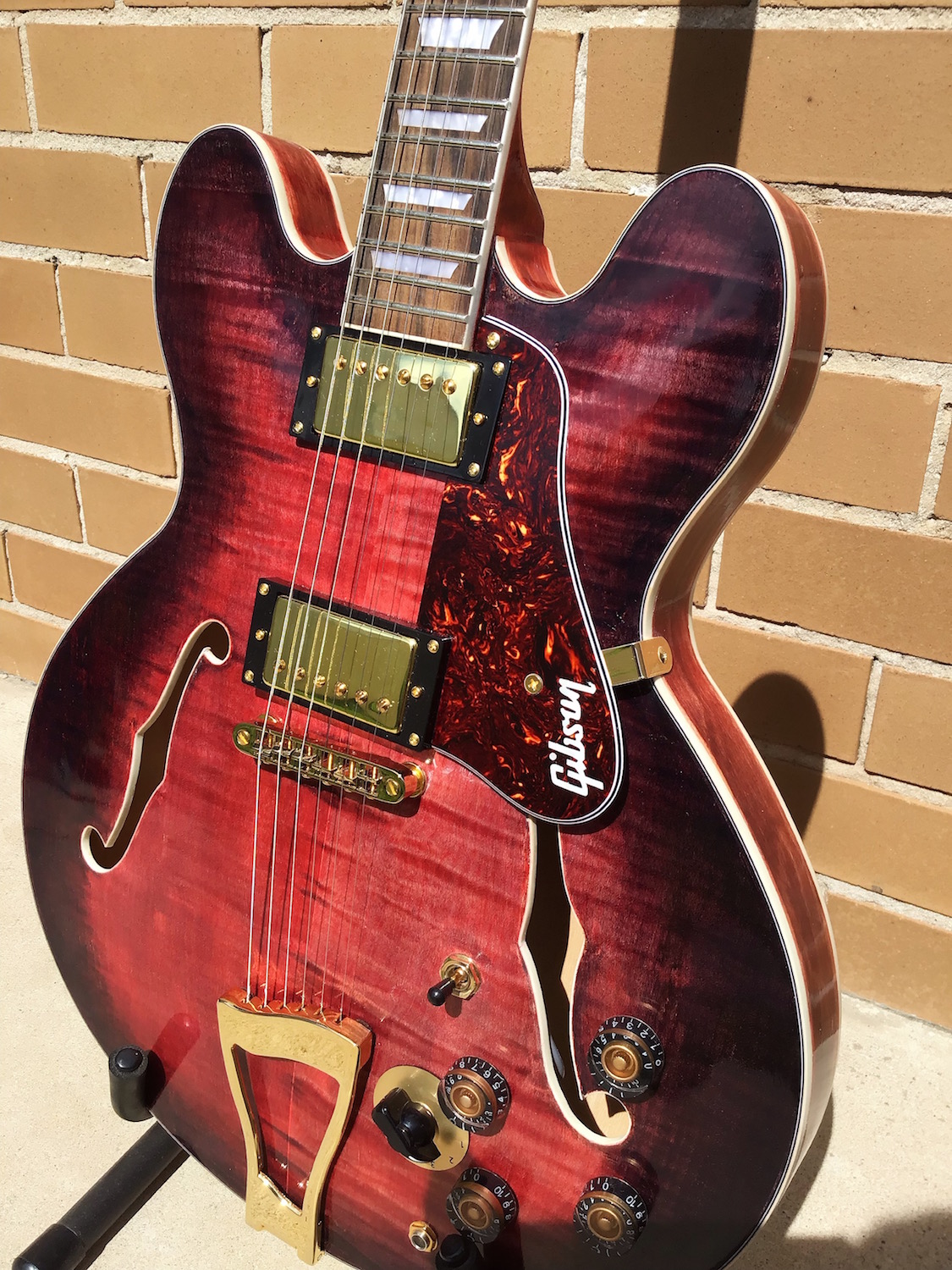

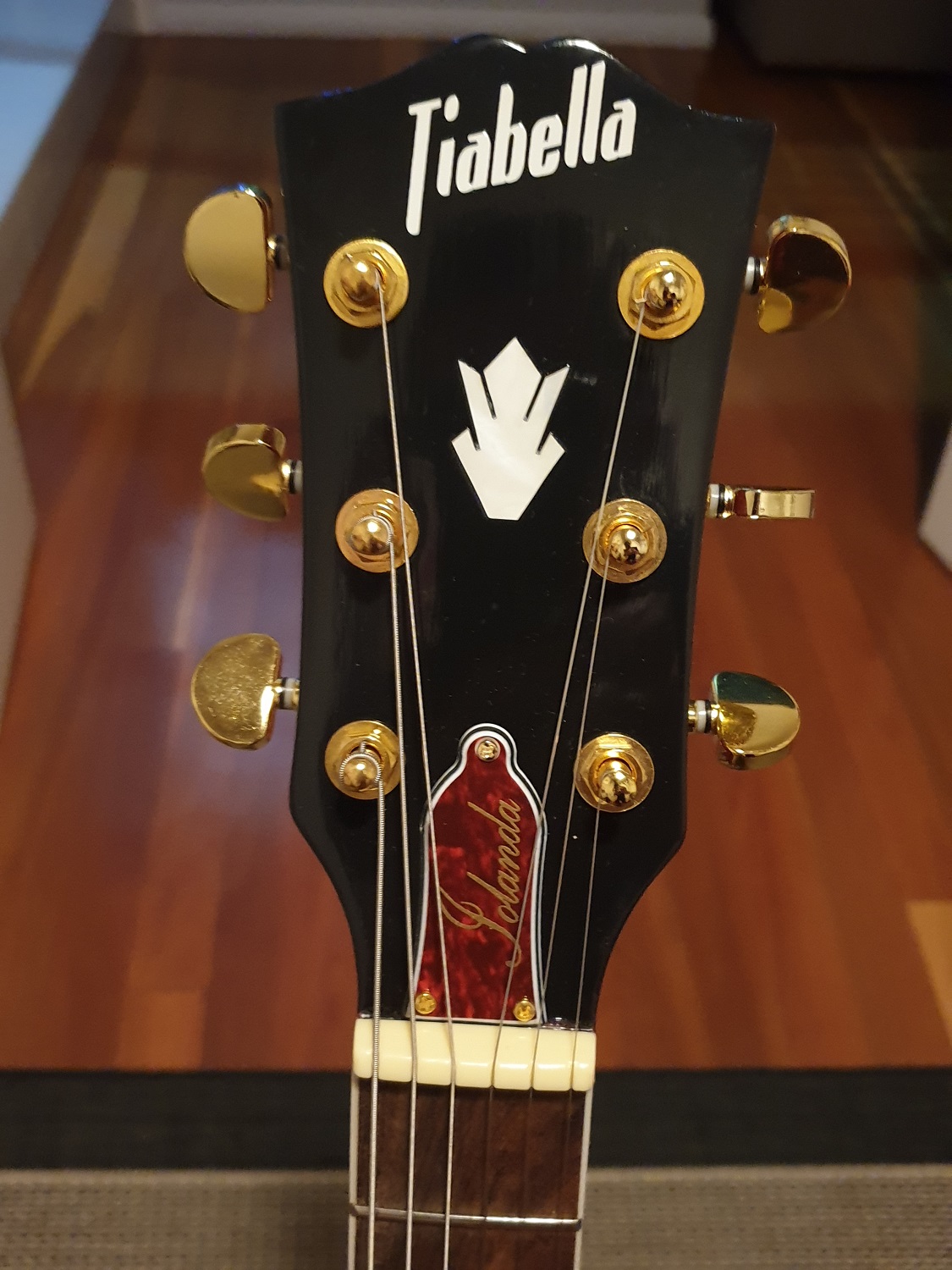

    My ES-1GT Build
    Customisation
    - Varitone 6 Position Switch ( B B King magic switch)
    - Gold Tailpiece inspired by the Hagstrom Tailpiece
    -Changed volume and tone knobs in a two tone gold and black
    -Changed bridge to Nashville style
    -Custom decal on Headstock and Truss rod
    -Tortoise shell pickguard and truss rod cover (a nod to Lucille)
