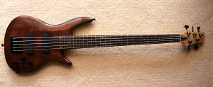

    IB-5
    All Standard Parts
    Walnut Stain with Tru-Oil finish
    Maple neck
  2. Liked by: Whizgig, Wisdom

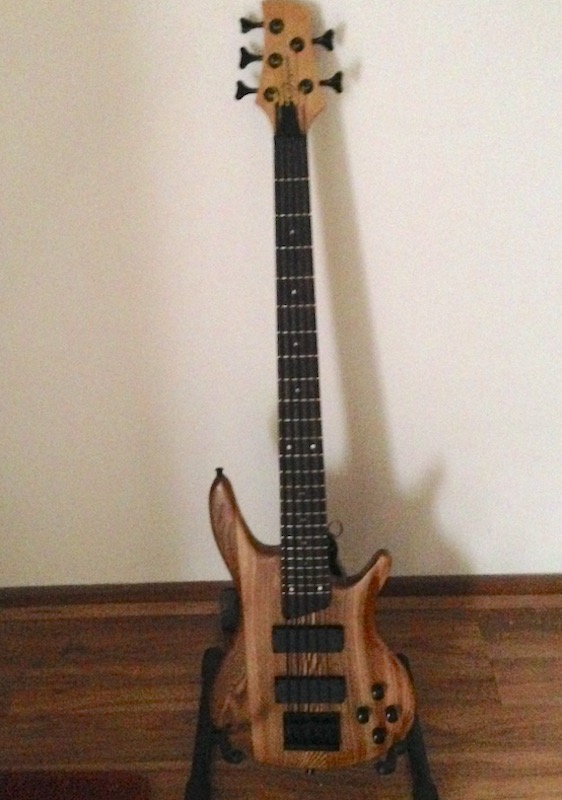

  3. #2
    Finished in Wudtone Dark Tease. Built by Dingobass. All parts standard.
    Adam
  4. Liked by: Whizgig, Wisdom

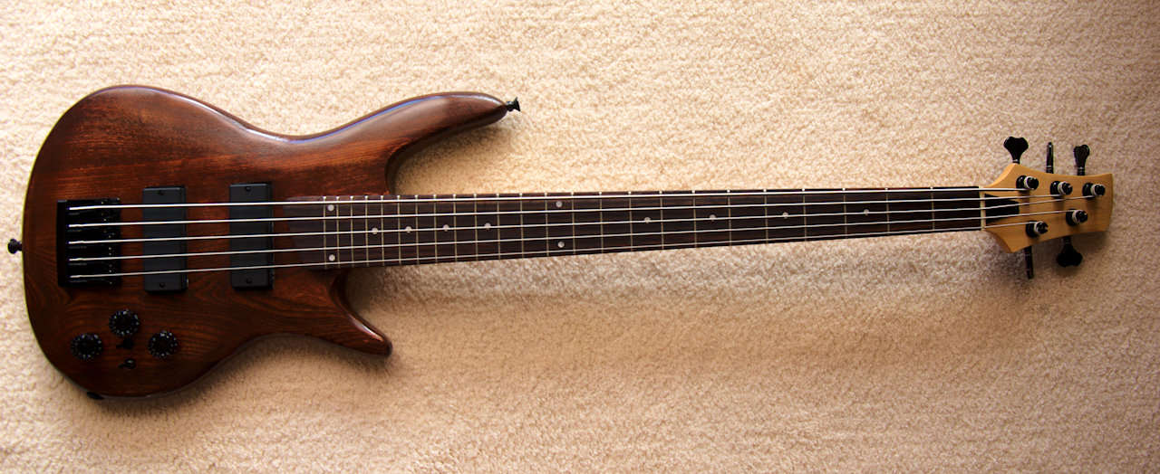

  5. #3
    Finished in Wudtone amber. All parts standard.
  6. Liked by: Whizgig

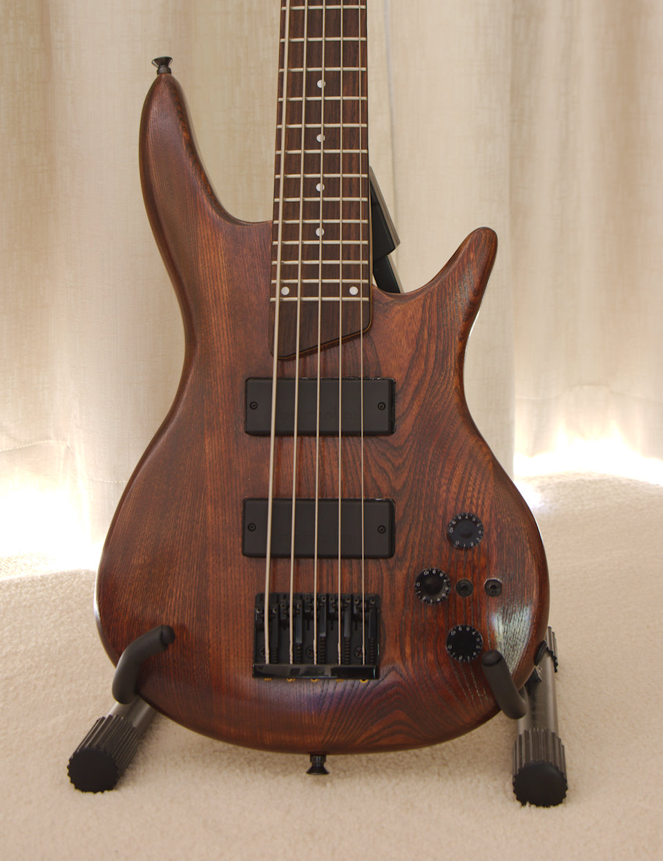

  11. #6
    Nothing fancy from standard.
    Sealed with Feast Watson Timber Primer
    A light stain with Feast Watson Prooftint 'Old Baltic'
    Polished with several layers of a 50/50 mix of FW Fine Buffing oil and FW Clear Satin Varnish.
ID:	14896   Click image for larger version.
ID:	14897   Click image for larger version.

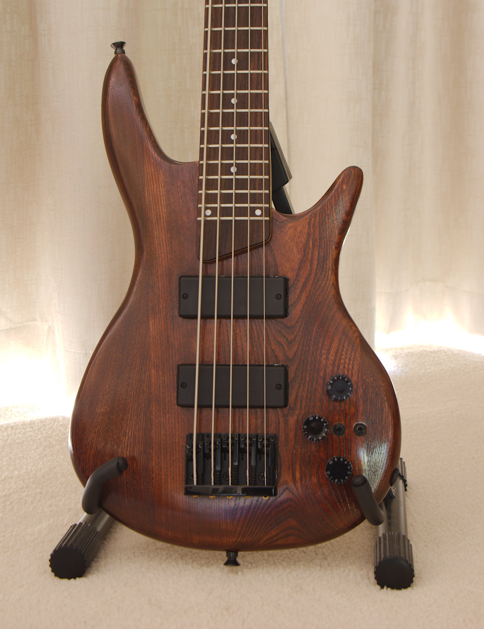

  13. #7
    Here are two shots of my recently completed IB-5
    Basic details:
    Finish: Body - Feast Watson Jarrah stain + Tru Oil. Neck - Tru Oil. Applied Renaissance Wax once the Tru Oil had cured.
    Pickups - Bartolini (switchable between series humbucker, parallel humbucker, single coil), wired as 2 volume pots, single tone pot. Bourns pots.
    Gotoh tuners.
    Schaller 2000 bass bridge
    Copper shielding
    Bone nut
    Dunlop Strap Loks
    I started this build after Christmas 2016, but numerous competing demands meant that the build stretched out over several months.
    For anyone interested, I will share some build details here, in lieu of a build diary.
    The Build: The build was reasonably straightforward. I had no difficulty getting things to line up, and the neck was surprisingly easy to adjust. I spent time levelling the frets as recommended, and smoothing the fret tangs at the edges of the fretboard. Once the bass was assembled, I gave the fretboard a good drink of Guitar Honey.
    I encountered a few little traps along the way…
    1 I had to route a rebate around the back pot cavity so that the cover would sit flush with the body. I did this carefully with a Dremel and a 3mm router bit. This was a bit of a pain.
    2 I had to route more of the pot cavity in order to make the floor more level and create a bit more space for electronics.
    3 The bridge I selected proved taller than stock, so I had to shim the neck to get a reasonable action. I located some nice 3mm thick maple veneer on eBay which, after careful shaping, worked perfectly.
    The Bartolini pickups are marginally smaller than stock, so I lined the sides of the pickup cavity with thin foam sheeting. This was a cosmetic consideration.
    I’ve wired the pickups with individual volume pots going into a single tone pot. I implemented switching options for the pickups, with a ON-ON-ON switch which selects parallel-coils humbucking, series-coil humbucking, and single coil (which Bartolini describes as similar to a Jazz Bass pickup). This arrangement does indeed yield audibly different voicings.
    I’m really delighted with the sound, and there's plenty of sustain.. I haven’t played a bass for over twenty years, having long ago parted ways with my old bass and amp. I decided on a Fender Rumble 200 V3 amp, which is to my ears a very decent sounding system. Once my fingers are less clumsy, I might put up some sound bites.

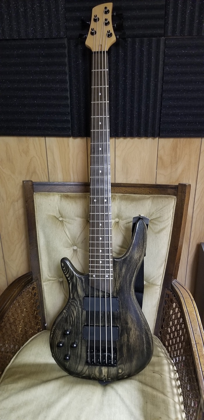

  15. #8
    Jan 2022
    Connecticut
    5
    Standard parts except for longer intonation bolts. Next will come the usual mods, just to make it the best it can be.
