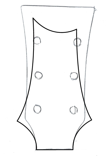

    ...as to the PRS... I haven't found one that will work without modding either the template or your uncut headstock. I have a tracing of my forbidden headstock, uncut, that I have been using to play with potential shapes. I superimposed a PRS headstock shape over it that I found on Pintrest.
    https://www.pinterest.com/pin/492510909227906676/
    Unfortunately, it looks like the bottom is wider than the uncut forbidden headstock. Here's a pic so you can see what I mean:
    PM me if you want a PDF with or without the forbidden headstock tracing under it.

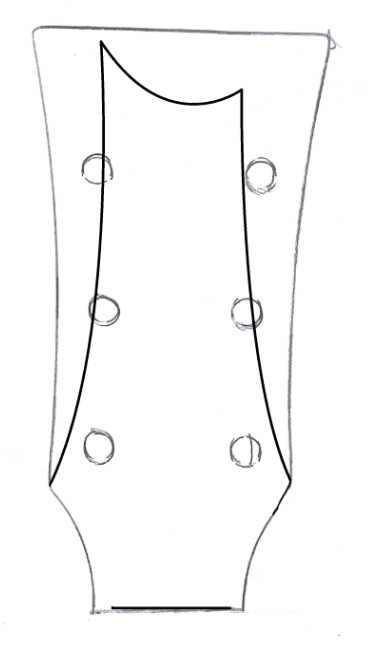

    I played with it a bit, and think, since you plan to plug the holes and re-drill anyway, you might be able to stretch it a bit and get something like a "snakehead PRS"...
    I don't have this last graphic to scale, but could probably get it that way if you like it.
