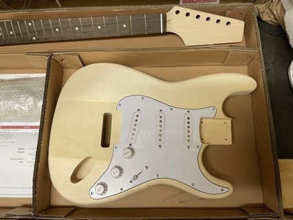

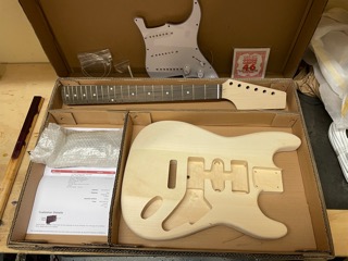

    Kit with bone nut upgrade has arrived. Nice little bit of grain. Let the sanding and fret leveling begin.
ID:	45304   Click image for larger version.

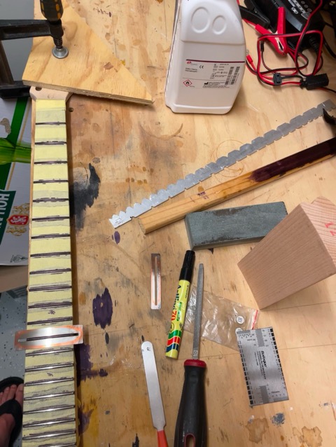

    Frets levelled, sanded and polished in a personal record time of 2 hours. The frets feel really nice, do I really have to give it away?

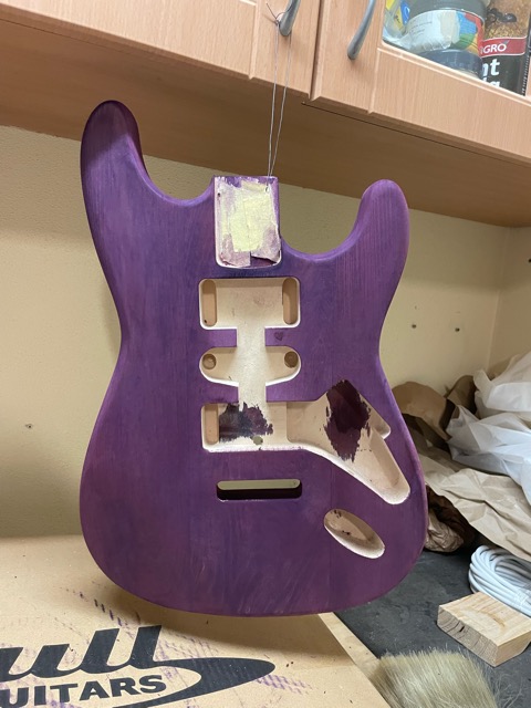

    While I am at it, let’s sand and stain the body. Looks like it’s going to be purple.
