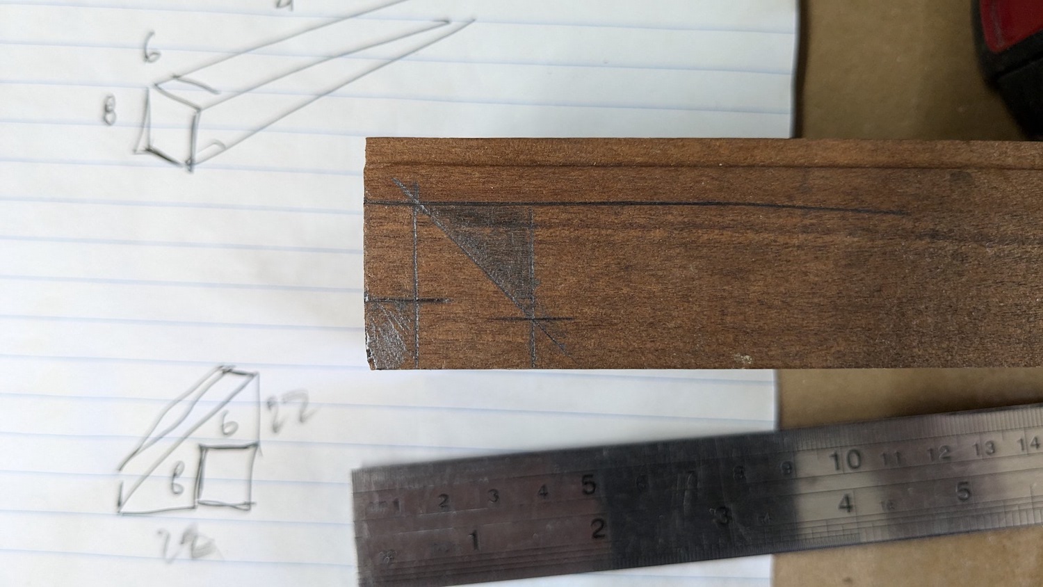

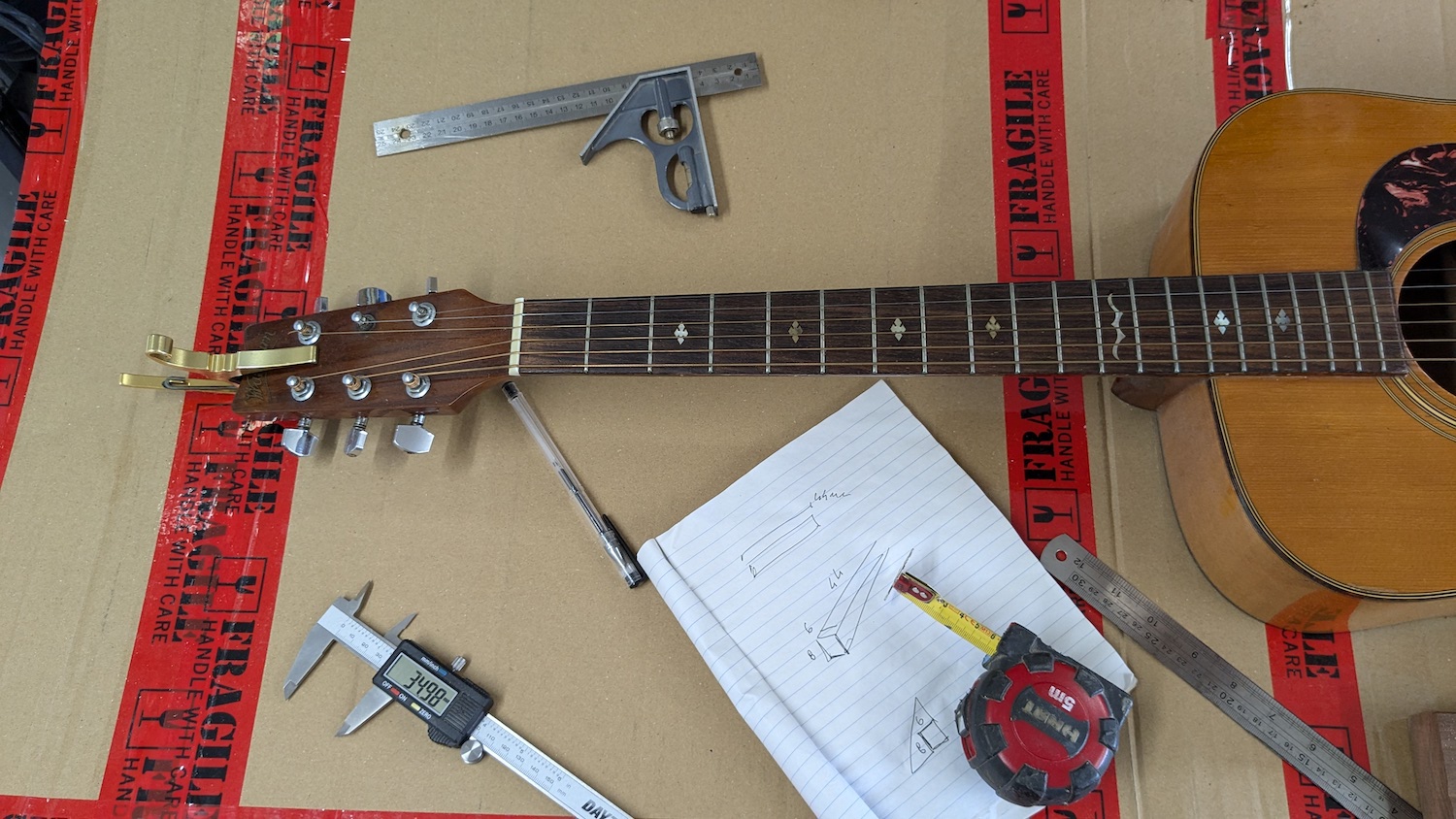

    first I took some measurements and sketched on a piece of paper the general idea. The digital caliper is not an essential, just a little flex.
Name:	2024-10-20 10.37.55.jpg

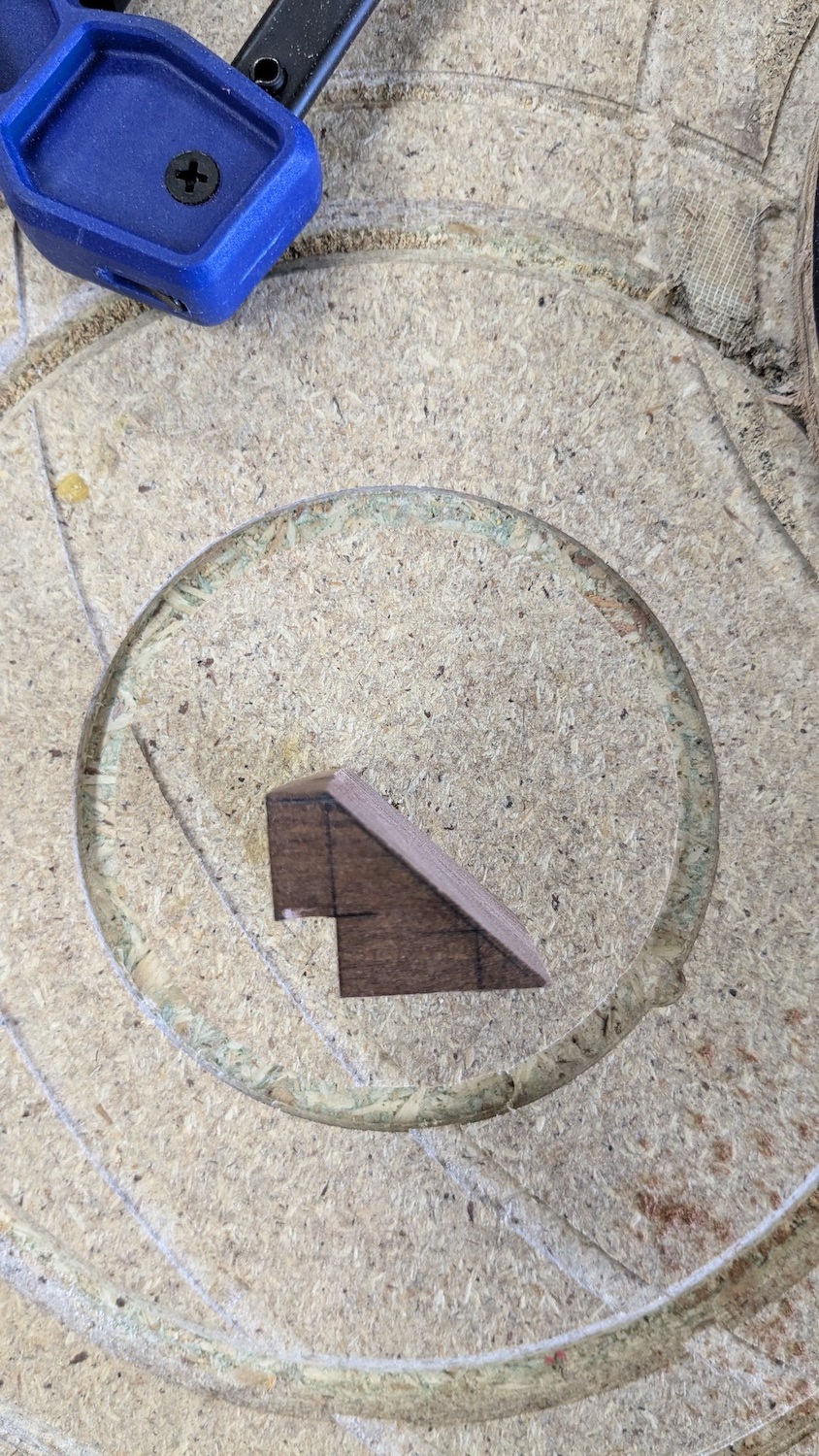

    On a random piece of timber I had hanging around I sketched the model.
Name:	2024-10-20 10.45.29.jpg

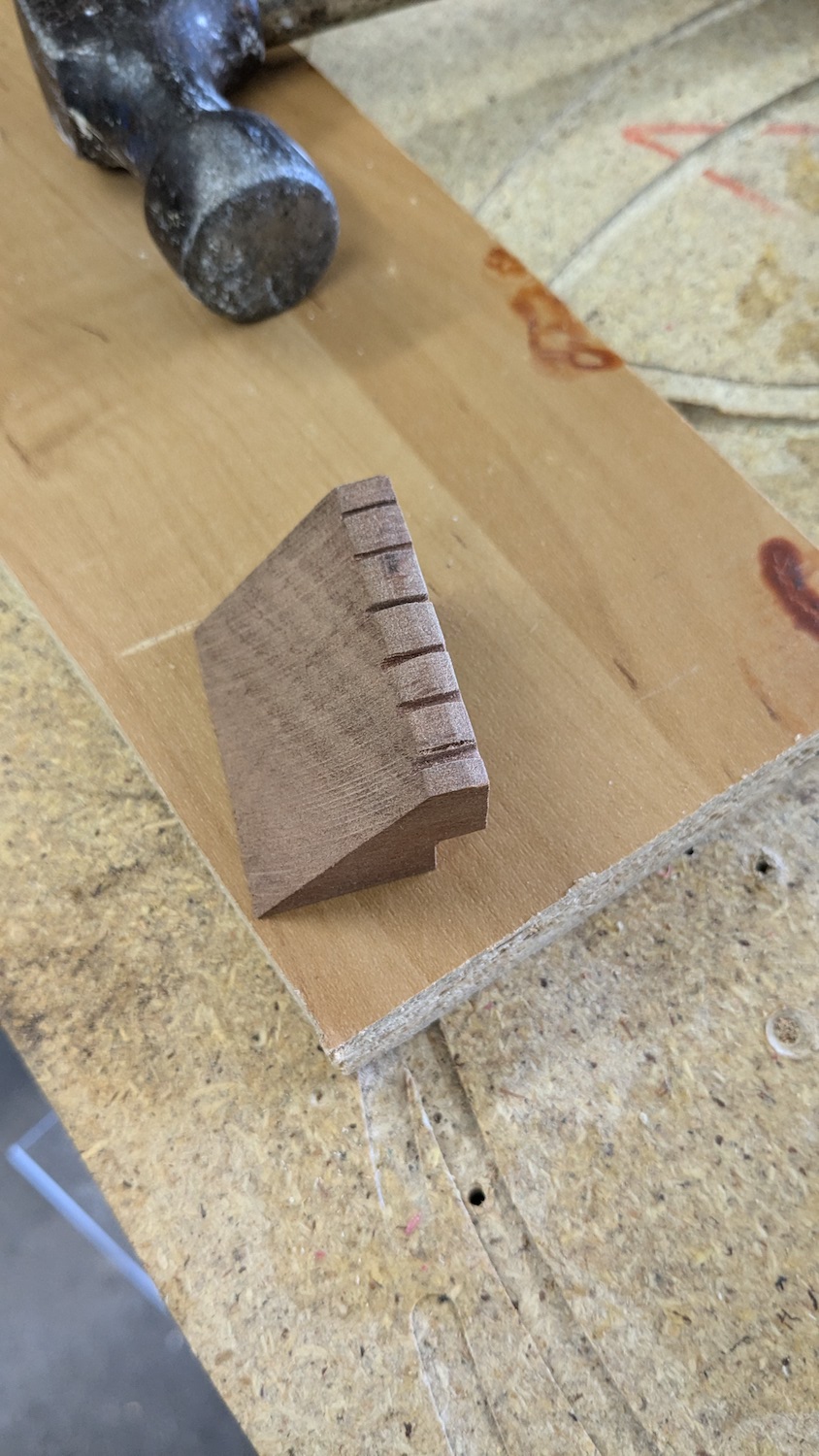

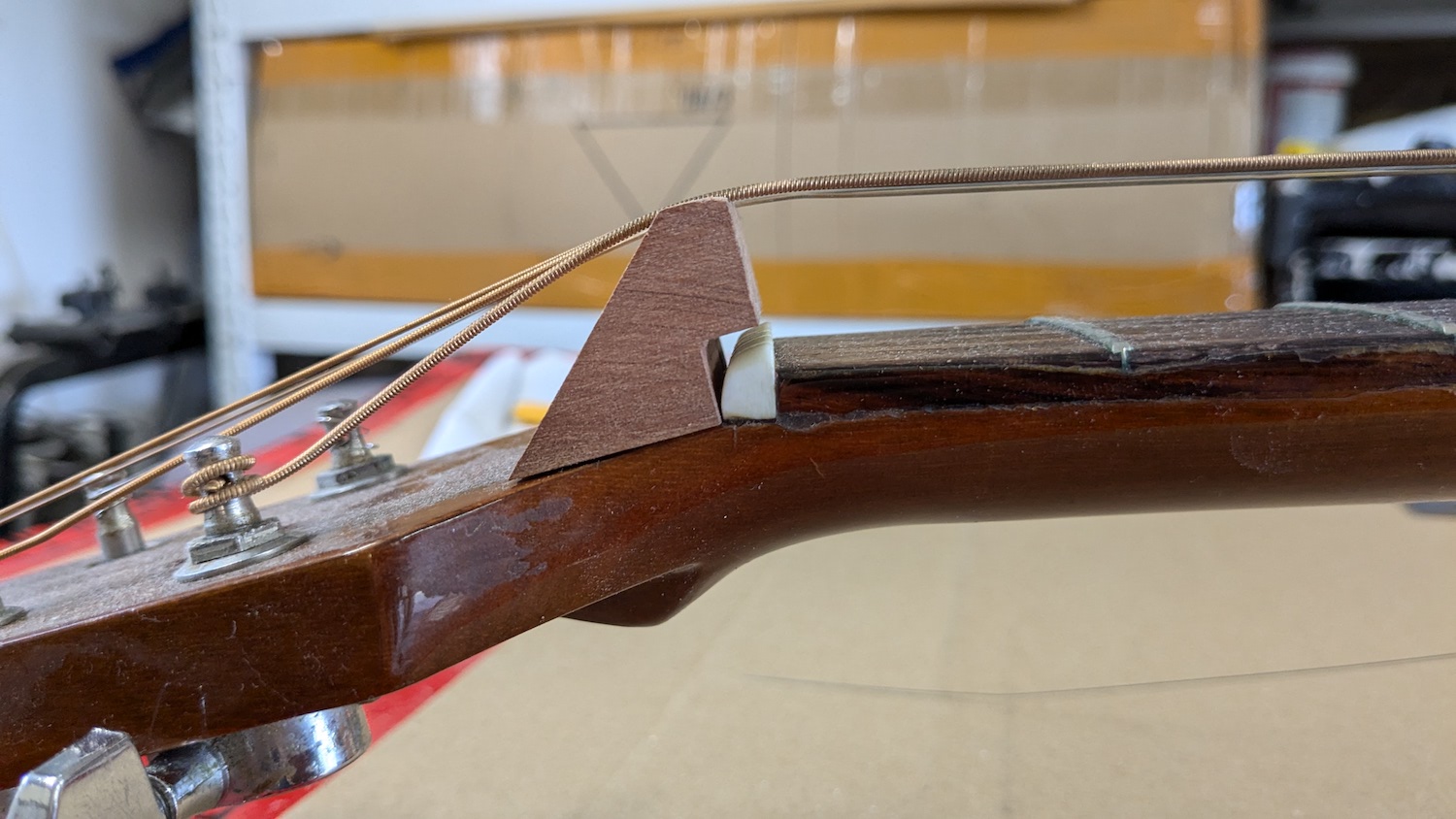

    Using a disproportionate amount of tools I finally cut the thing
Name:	2024-10-20 11.20.52 first cut.jpg
    The timber nut looks like this
Name:	2024-10-20 11.30.16 looks like this.jpg

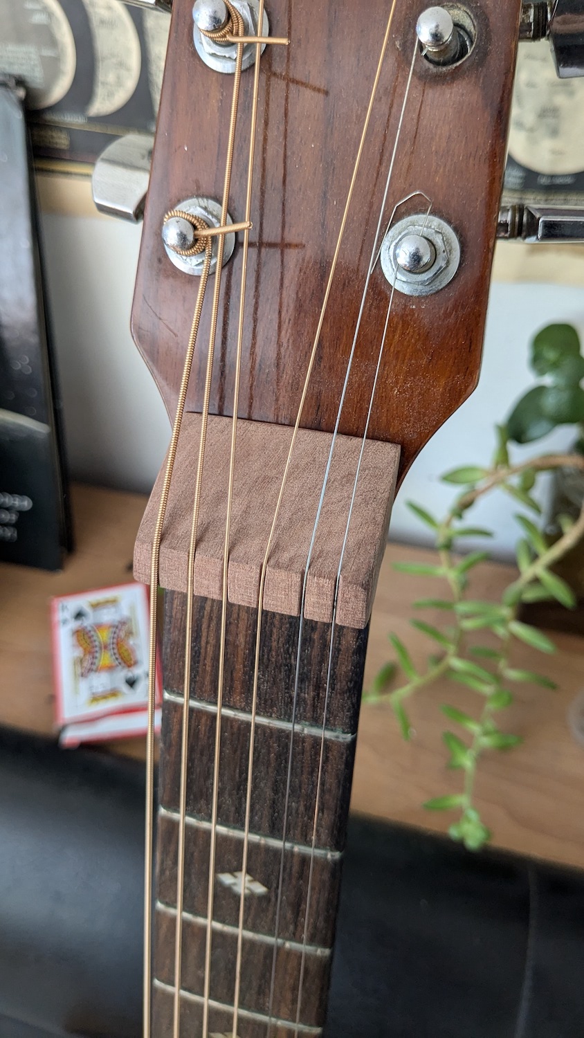

    First dry fit... quite off actually! I'm too good at this
Name:	2024-10-20 11.33.15 first dry fit.jpg

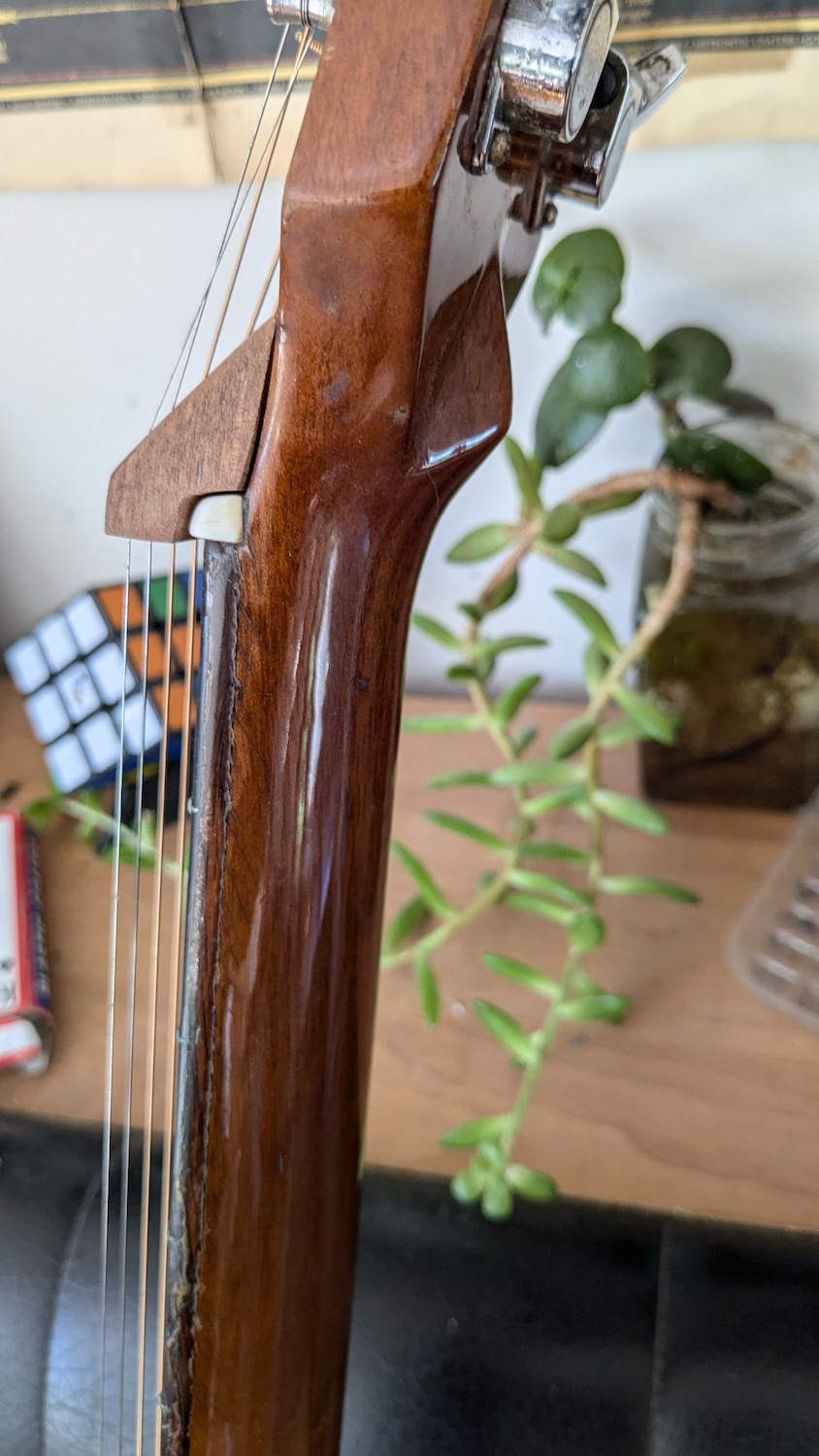

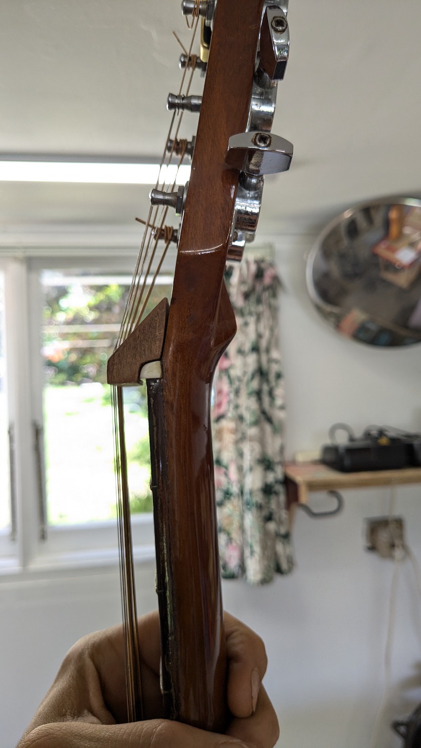

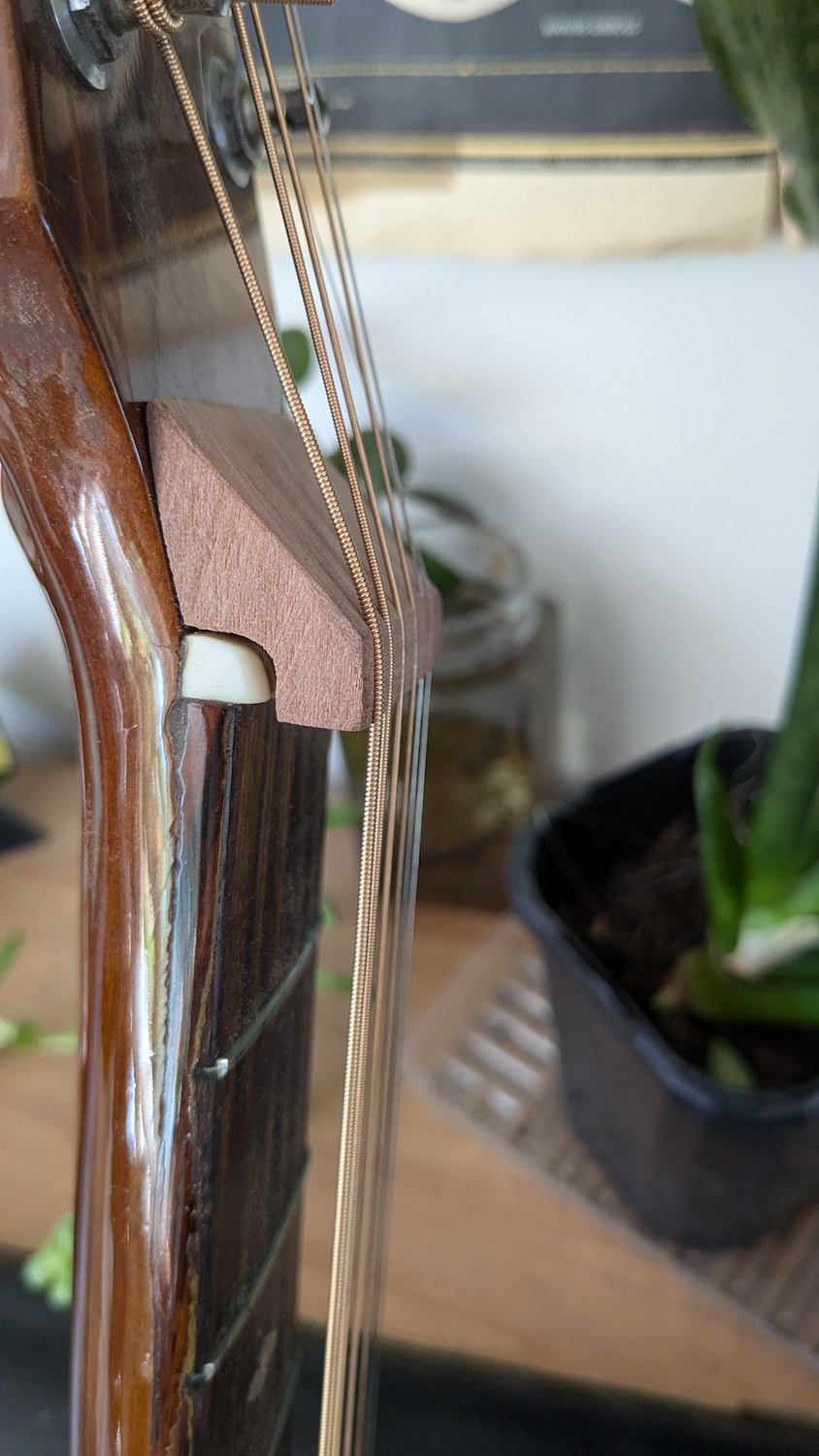

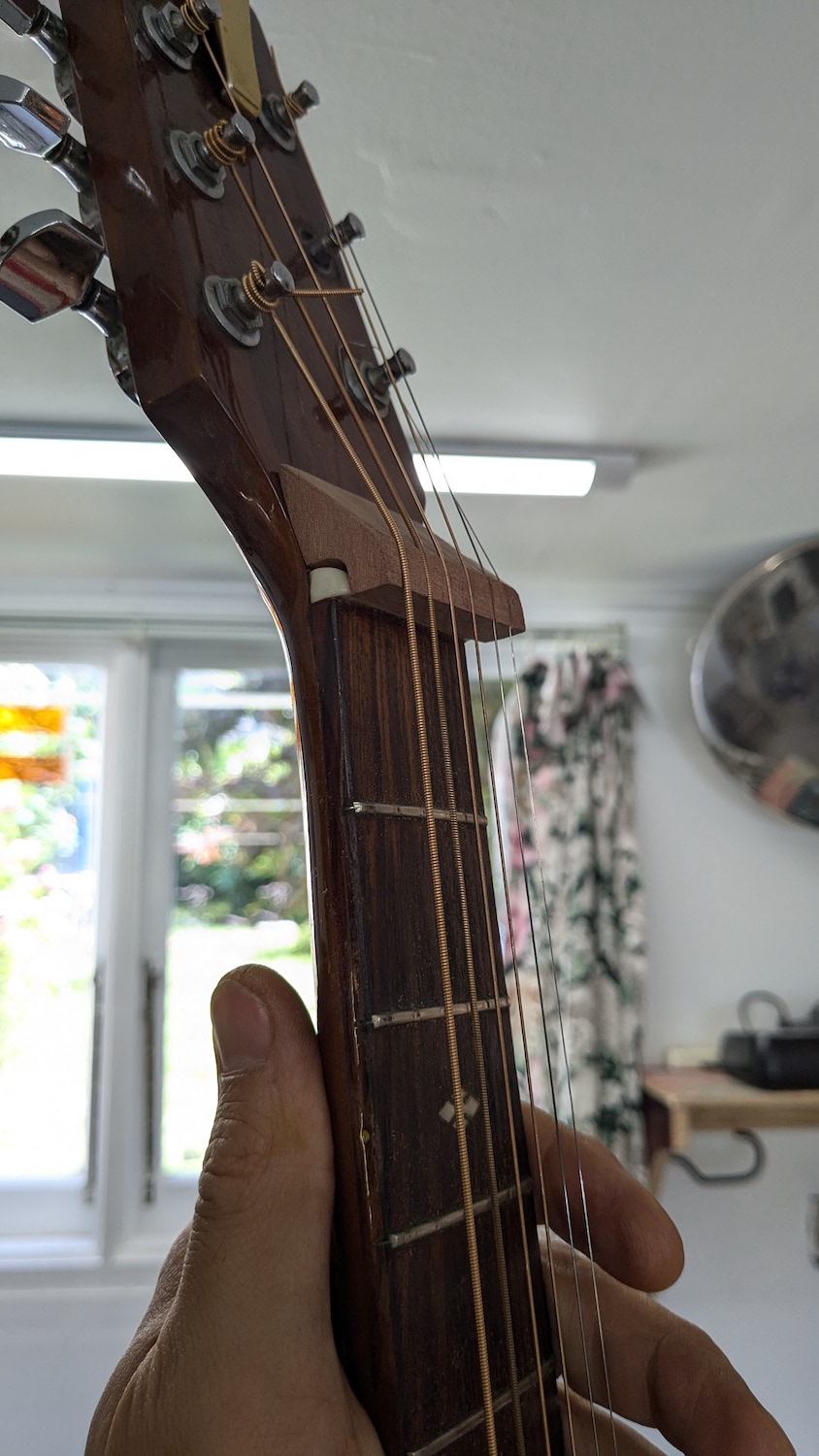

    the next 20mins or so was about shaping it and making it not so high, until it looked like this.
    no glue nothing, it just holds there
Name:	2024-10-20 12.45.25 done 1.jpg
Name:	2024-10-20 12.45.29 done other side.jpg

    here a clip of me playing the mod just fresh after the mod itself

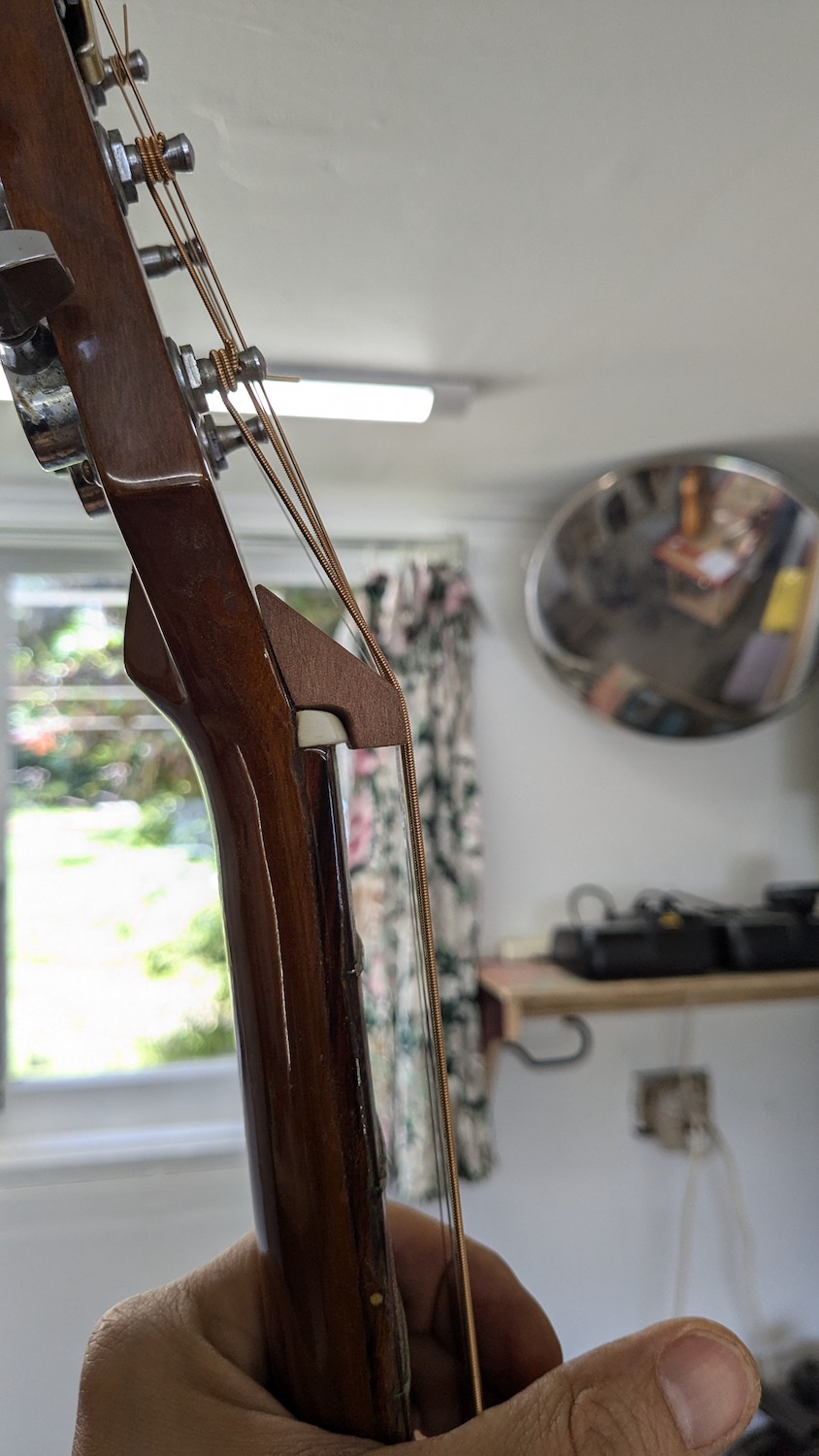

    the good thing is that it sounds pretty decent, it costed nothing and it was fun to spend an hour making something
    the "downside" is that I had to tune it down to open C (CGCGCD), that was the only string tension that seemed reasonable. In theory the whole idea was to make this mod to have a second lapsteel in a different key, like open D or open E since I already have a DYI made (electric) lapsteel tuned to C
    in any case good fun, highly recommended, non intrusive mod
