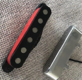

    In other news, I think I am about to complete the parts list for this build with the arrival of long awaited pickups. They shipped yesterday. The US Postal Service tells me that overnight they have gone from Marina California to San Jose...about 100 km. That means they have just around 4800 km left to get to Miami.
    This is the first time I have ordered pickups like these. I have had good luck with a small custom pickup winder called "Epic Custom Shop." My favorite bass has one of their "black gold" p-bass pickups and it's the best I have heard. I also have a set of their D2 Strat pickups for a build I did for my daughter. On the website (https://epiccustomshop.com/) they have a limited range--just P-bass, J-bass and Strat pickups. But since I have had good luck with them, I asked if they had Tele pickups as well. The proprietor asked me to send him some ideas of what I was looking for, I sent some sound clips, and he wound a set to get those sounds. They have been a long time coming, but I am really looking forward to hearing them.

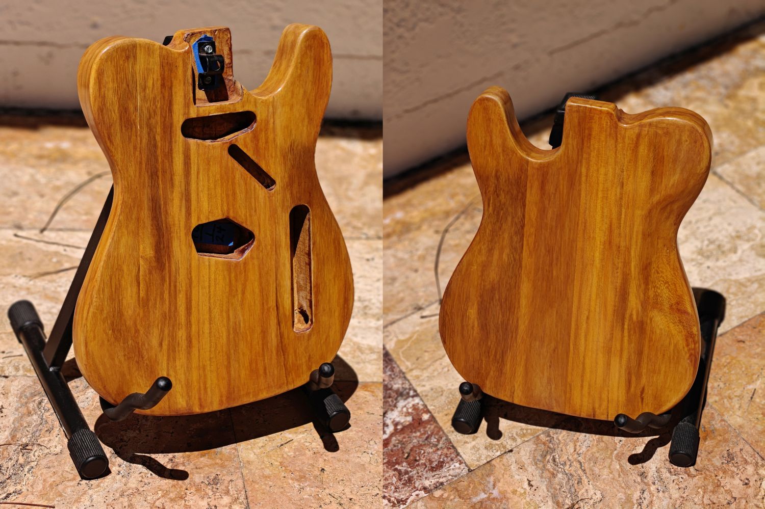

    Small progress. I managed to get the body buffed. Still need to use the scratch compound and polish, I like the new buffing system so far!
    I only used brown bar buffing compound on the body. I used a sort of weird sanding mesh to get it flat sanded that is somewhere between 220 and 320. Then just used 3M sanding pads of maroon and grey.

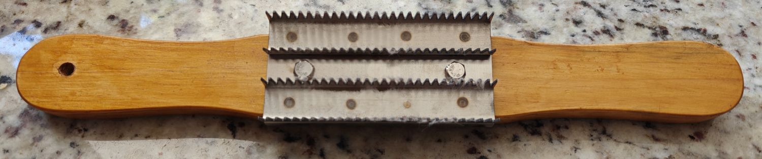

    I have decided not use use the Garnet shellac as a color, and the tool for cleaning buffing wheels came unfinished...so you may notice a striking similarity in the color...

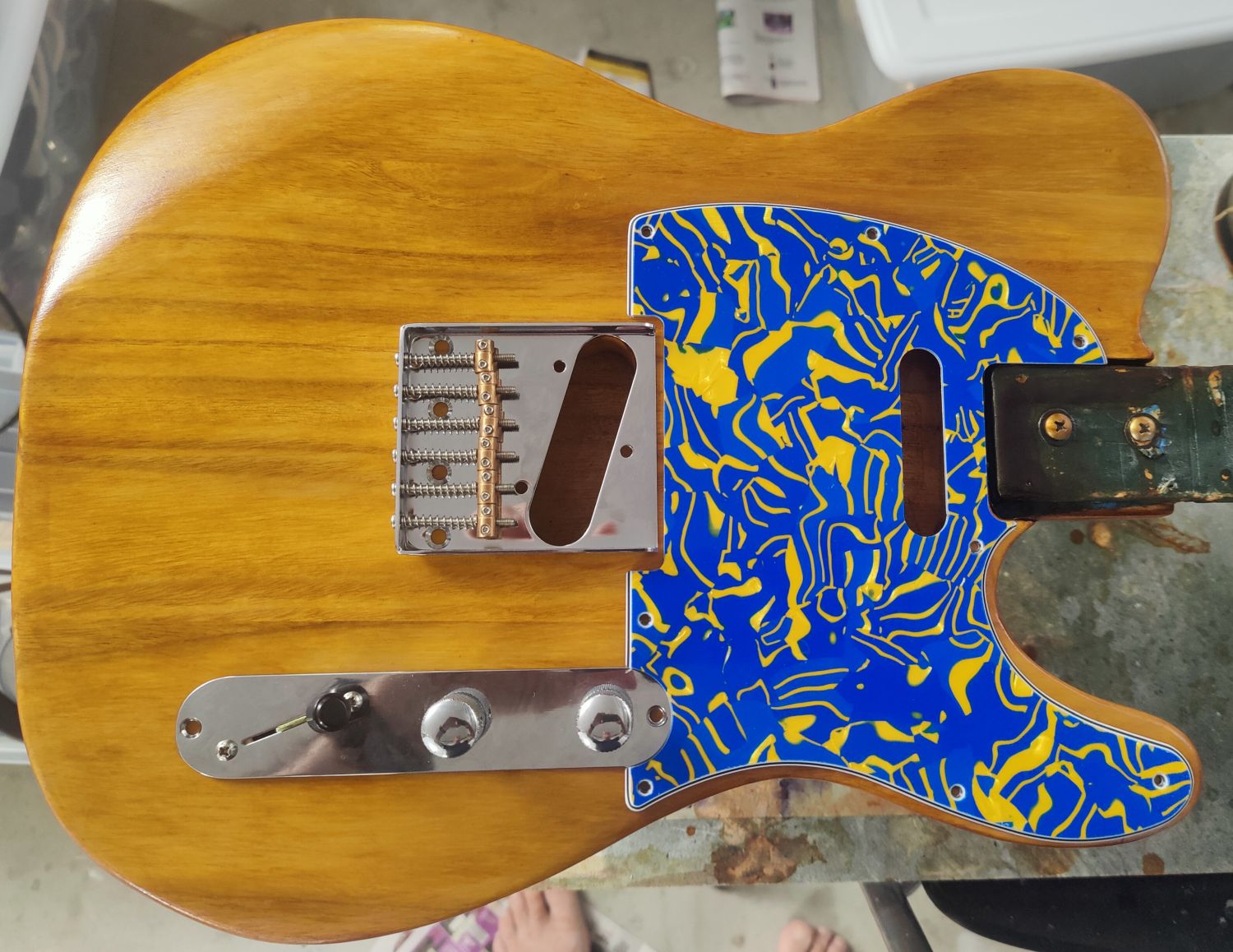

    ...not maybe the smartest thing I have ever done. I have not finished finishing this thing, but have now used up all the matching color of shellac. Oh well...
    Could not resist taking a look with the parts in place...
