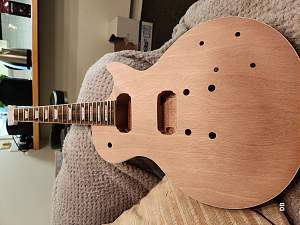

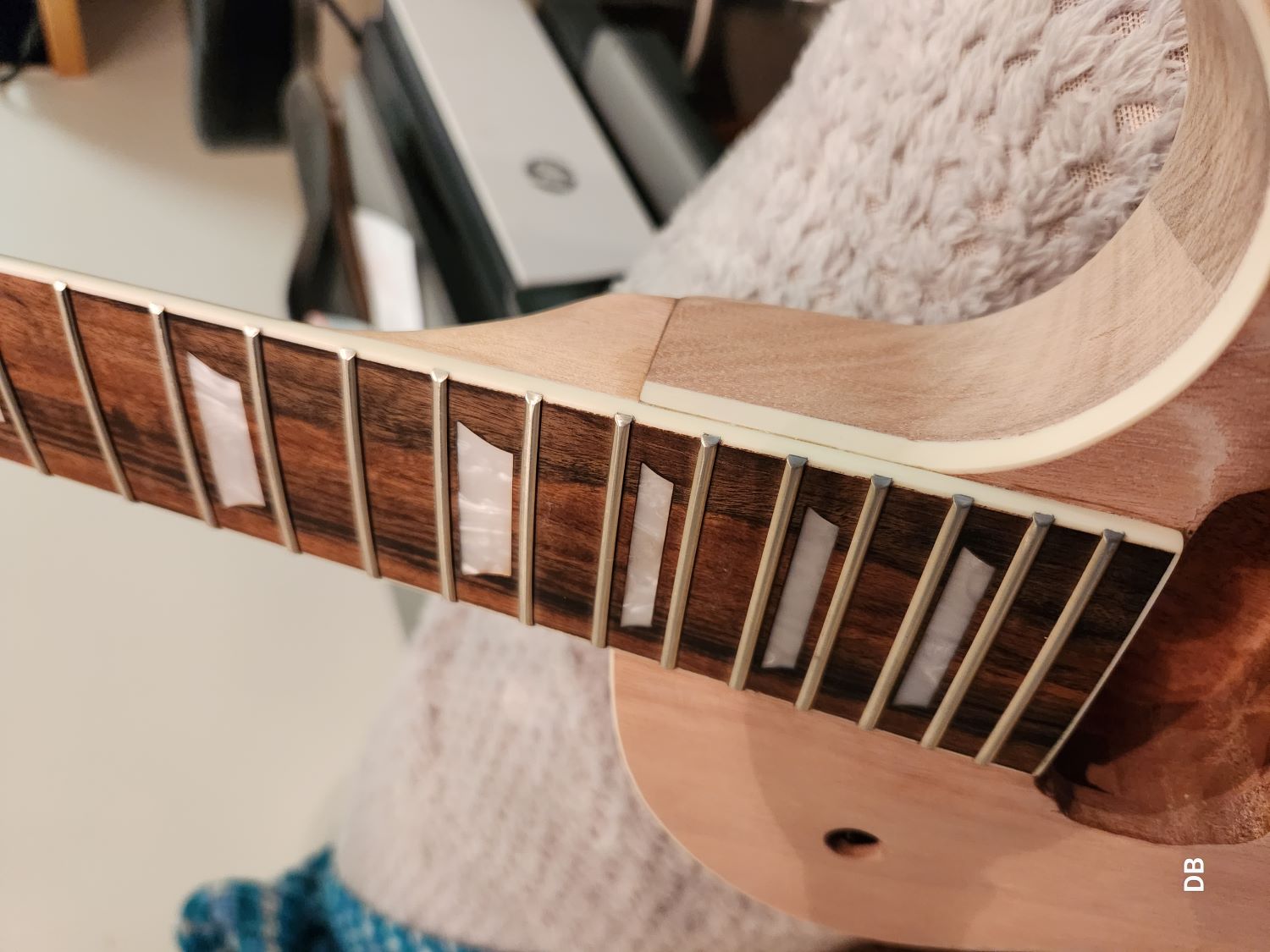

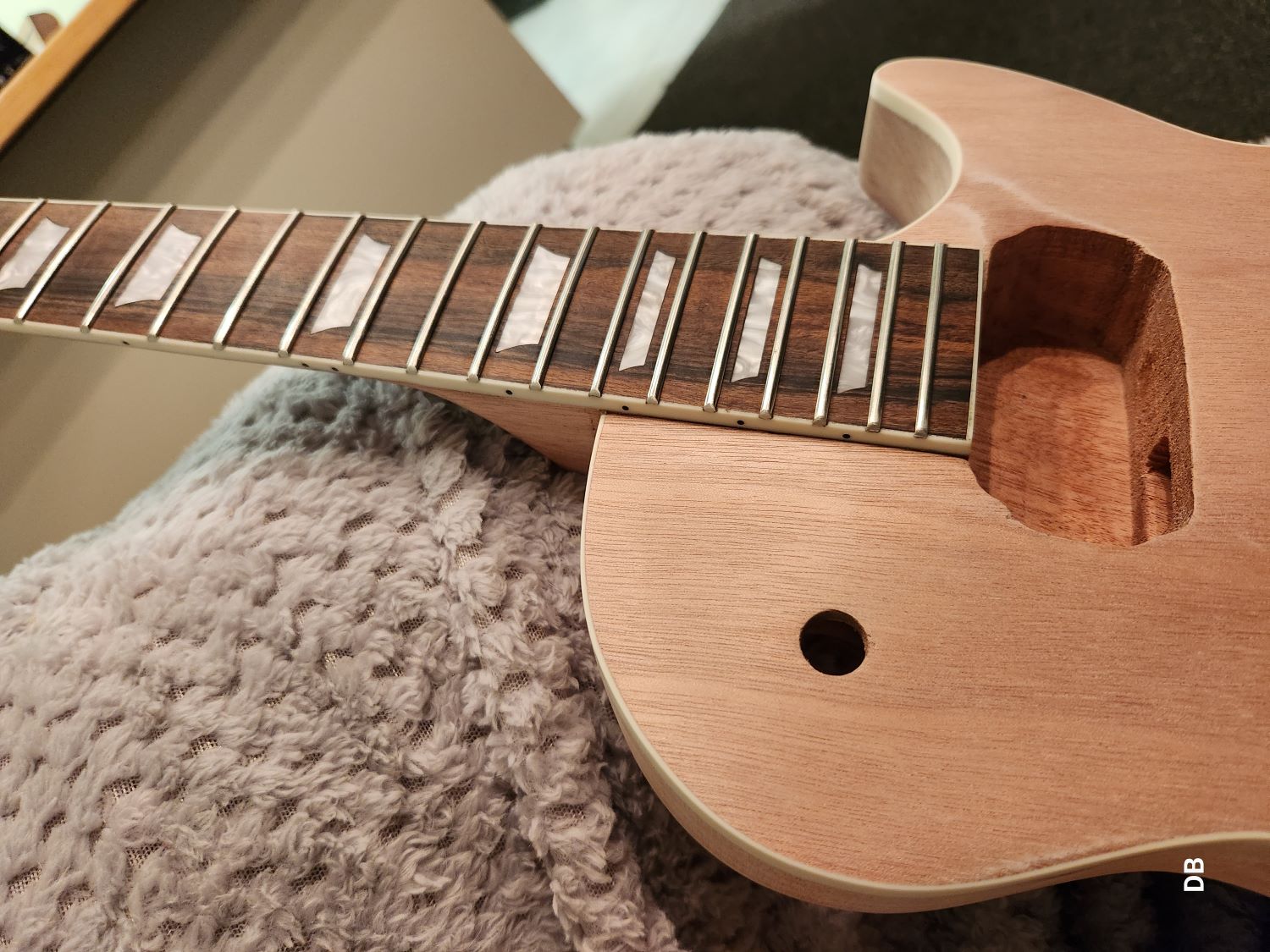

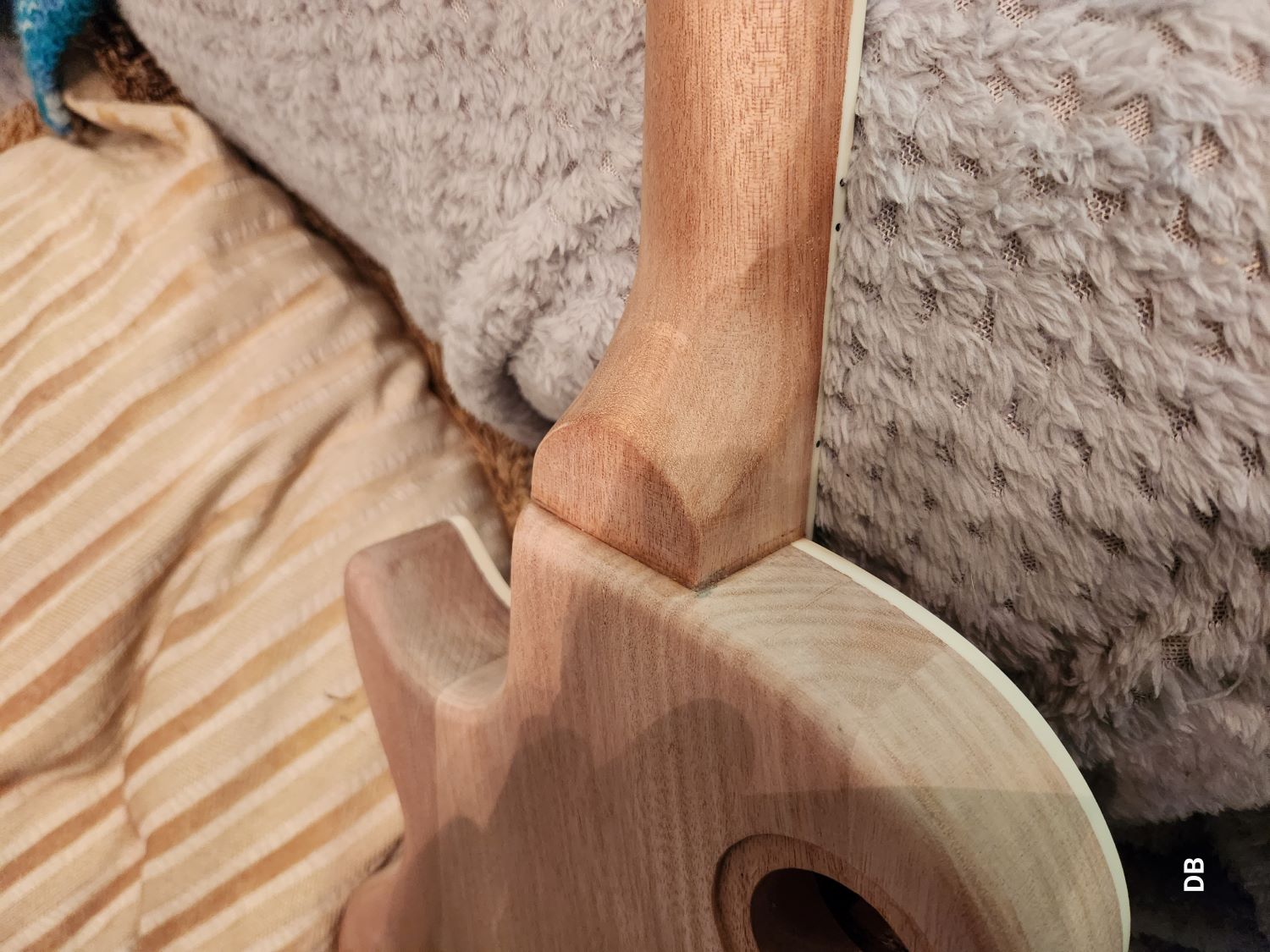

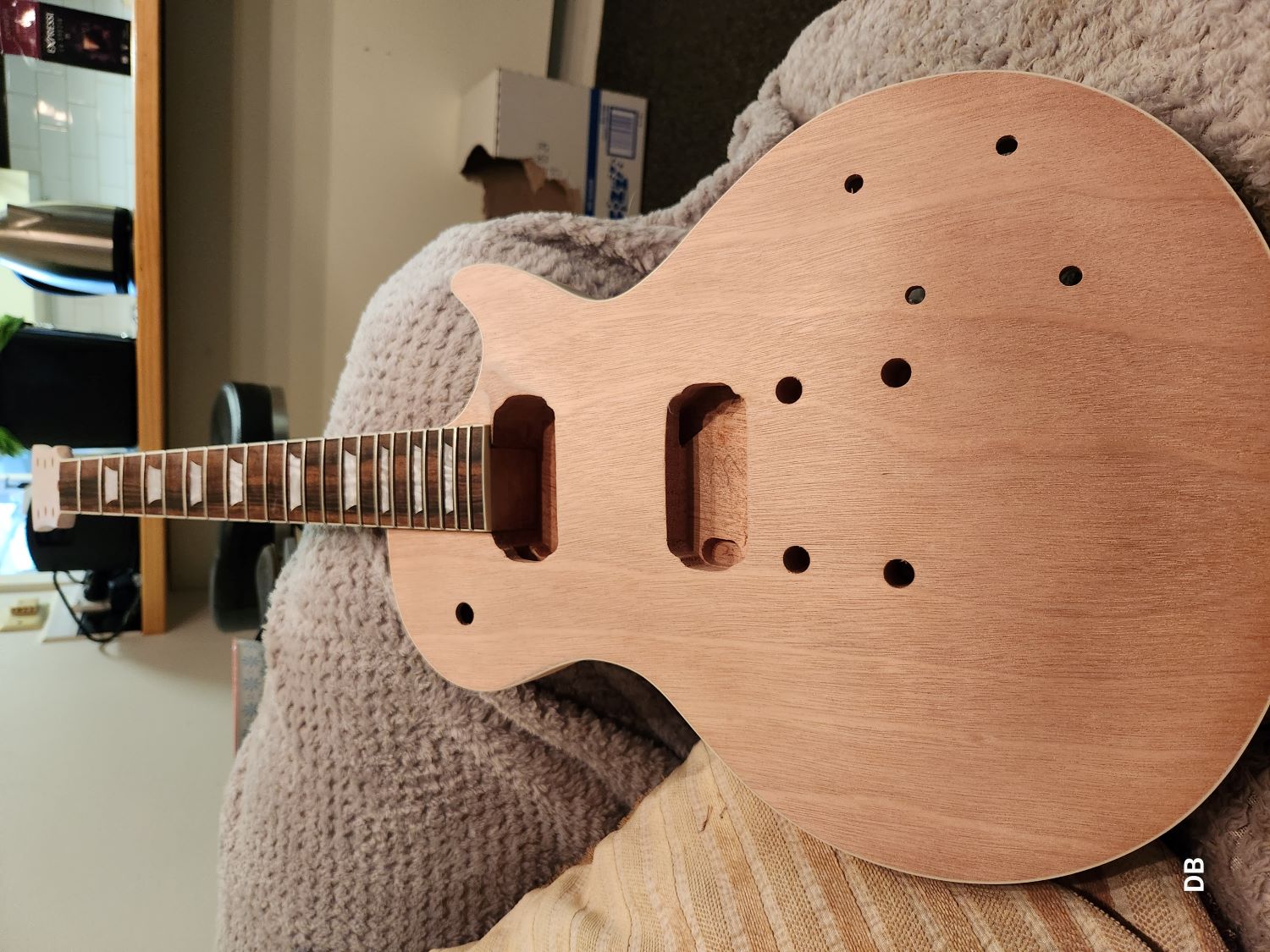

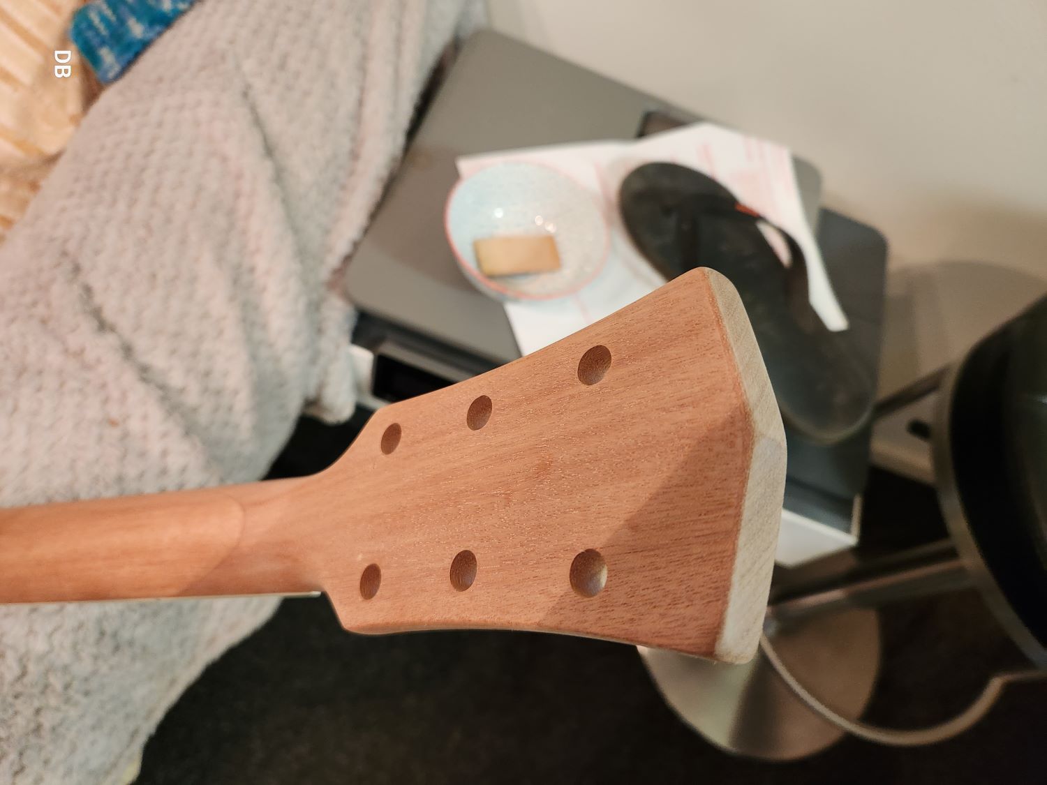

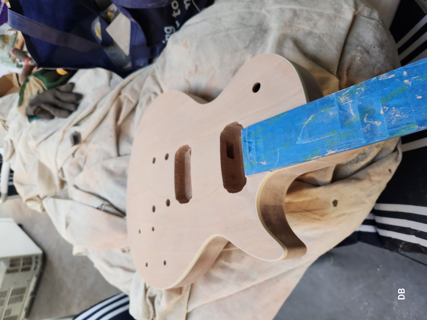

    Gidday everyone this is my diary of the Les Paul build so far, here are some fotos of the neck join i fettled the wood to get the best tolerances i could between the body cavity and neck i wanted it streamlined and smooth with no gaps or noticeable protrusions in that area.
    Here are some images if you dont mind.
    So far so good hehe.

    I am going to spray it with nitro in a light blue colour with clear over the top lightly sanded between coats for a hi gloss finish, cant wait for the paint to come and the next kit i have ordered the tele also, they are great kits and with some care and thought and research you can build yourself a nice axe.
    The neck needs some truss rod adjustment but i always forget which way is up or down lol righty-tighty-lefty-loosey il ask or googles it again before i adjust to get the neck dead flat before stringing it up and theres also the intontation has to be done proper good as well if you want it to ring properly.

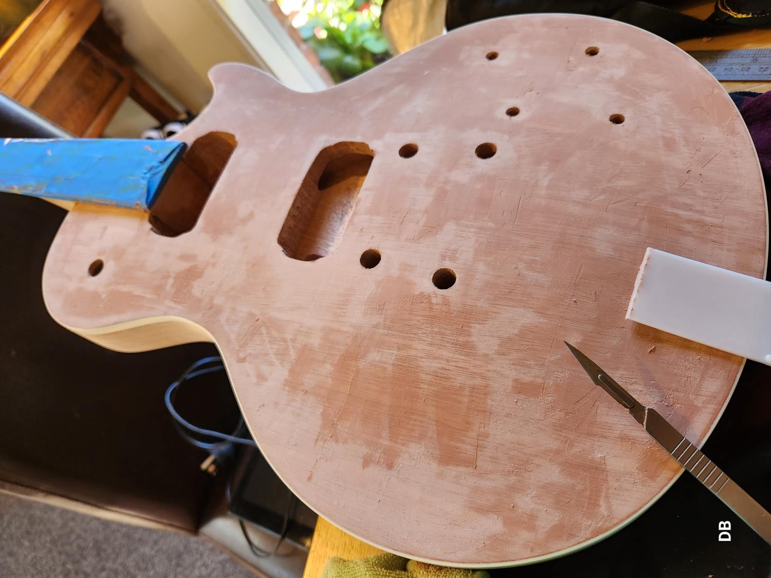

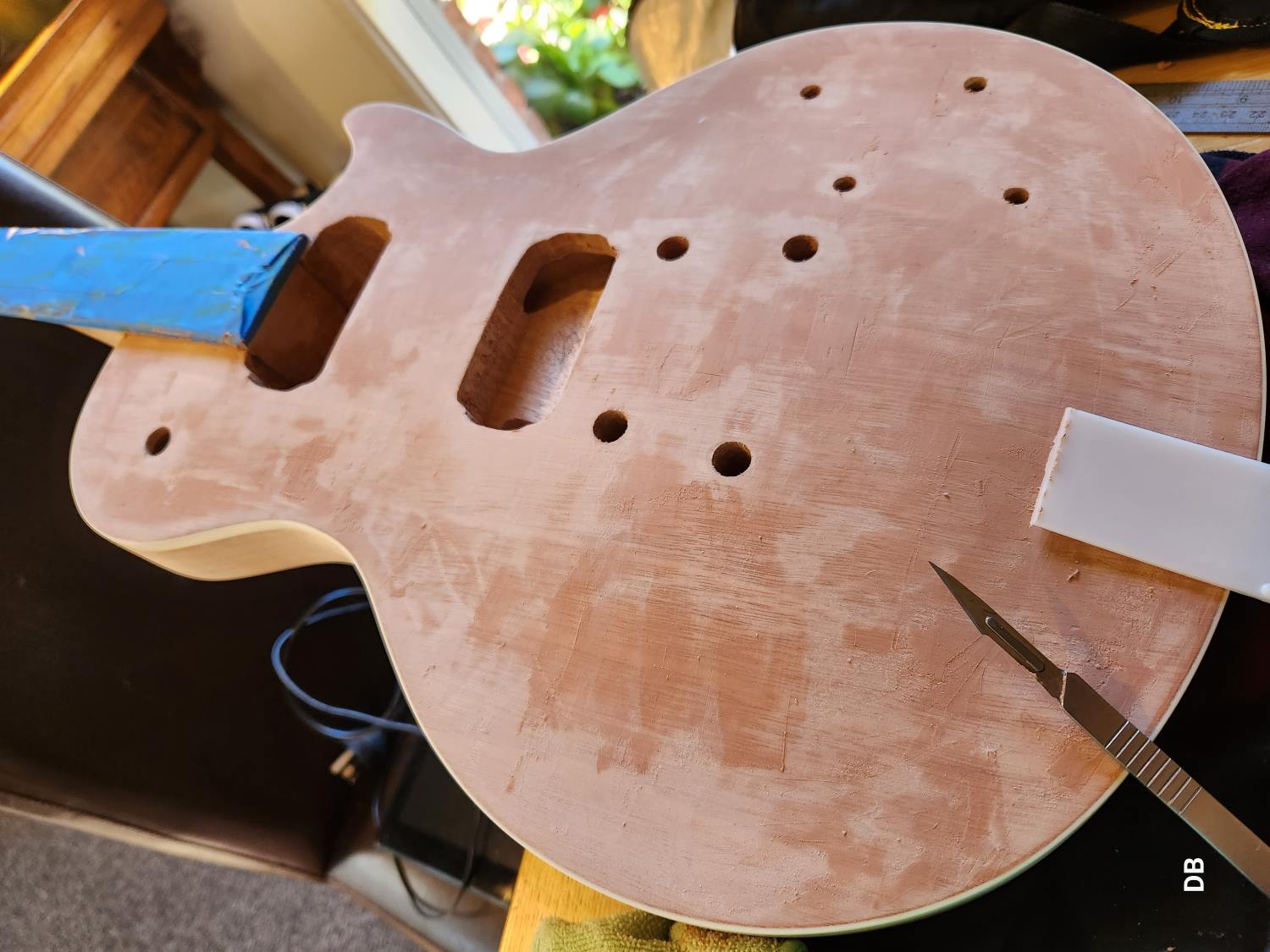

    With mahogany, you are definitely going to have to grain fill the surface first as it does have a lot of pores that will take a lot of paint to fill if you don't grain fill it first, and nitro isn't cheap.
    I'd also then apply a couple of coats of shellac as a sanding sealer before spraying nitro on the surface. I've used nitro sanding sealer/filler from Rothko and Frost/Dartfords in the past, but it is very soft and powdery, so best used as a coat to sand down almost back to the wood, and just use it to do a final grain fill IMO.
    I personally wouldn't sand each coat of nitro unless there are big dust particles or insects that need removing. And then only very lightly. If you get a paint run, you can leave it until the final flat sand to remove if you want. Otherwise, wait at least two days before sanding a run, as it takes the centre of it quite some time to dry hard enough to sand. Sand too soon, and you'll create a pit where you've pulled away at the soft centre where the solvent has softened the layers underneath.

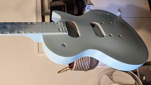

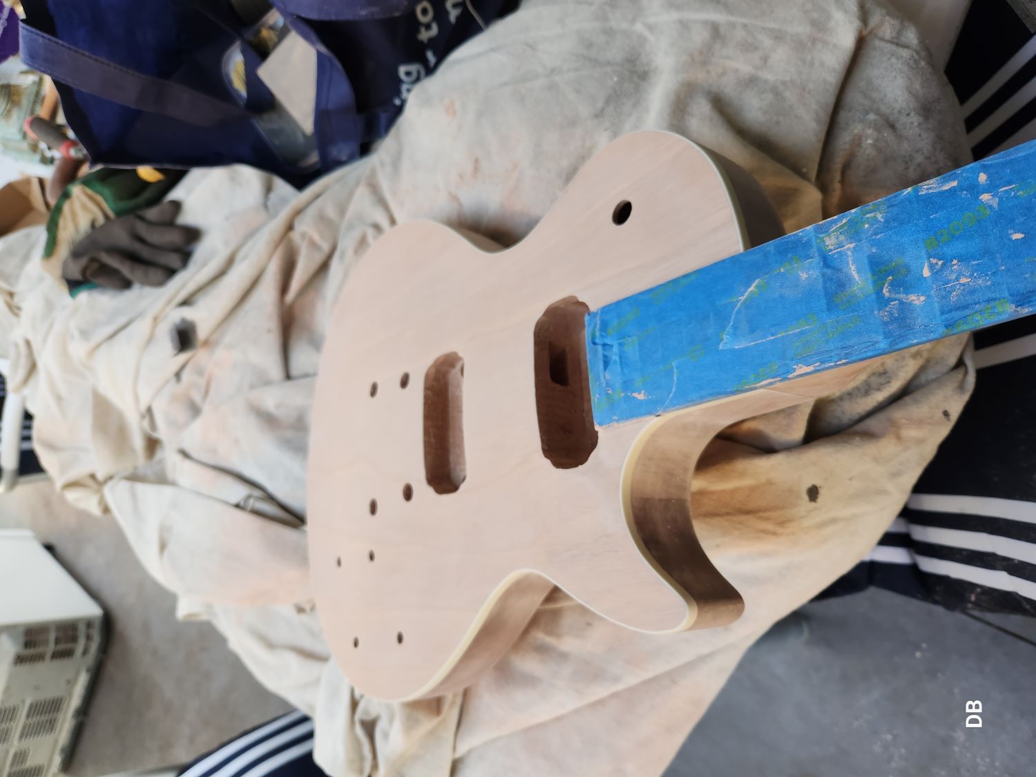

    Heres the sanding fill done now, the nitros arrived, its coming along quite well so far, the kits from here, i was thinking of doing some inlay but decided on the next one. Hope the spraying goes well and thanks @ Simon Barden for the advice above it all helps, thank you sir. Il take your advice on the sanding between coats if i dont have to i wont and yes you cant spray your way out of mistakes lol learnt that the hard way before. Daphne blue is the colour with a white nitro undercoat. Doing the whole body & neck, might get a pearlised sticker made up through a mate for the headstock, my brothers asking him today hes got 100k printing machine apparently that can print stickers and bang it on before the clear, if i was to lightly dust sand between a coat id probably use 1600 - 2000 wet/dry but il see.

    Hope it goes alright very much enjoyed the process so far.
    If you plan on fitting full-size CTS pots, you’ll find the shafts are wider than on the mini-pots in the kit, so you’ll need to drill or ream out the potentiometer holes at some point so they’ll fit. If so, it’s easiest to do it now without risk of damaging the lacquer later.

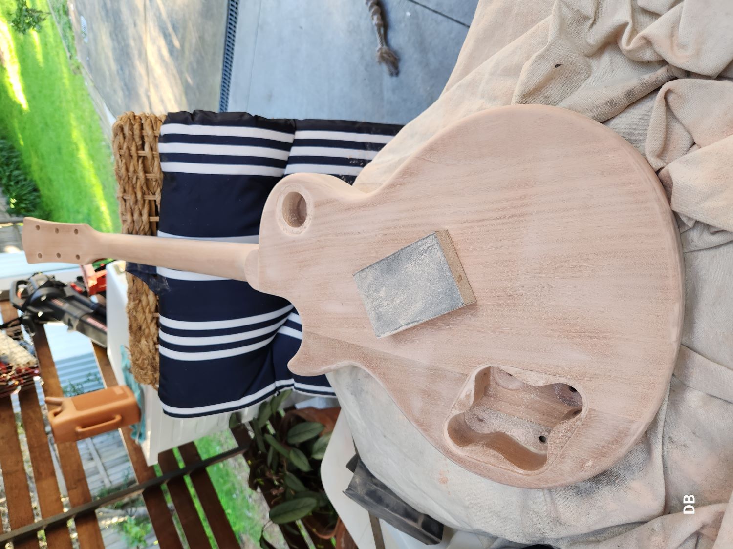

    Heres after the sanding, im going to get some 1000 grit to go over it now as well, the fine foam pads are great but not quite fine enough.

    Im doing it for my brother so its up to him on the pots, i know he was going to get some pickups later on, il let him know tonight before we go ahead spraying etc. I dont have a dremel but i can loan one.
    Its decent of you to give me the heads up as it would not have occured to me either.
    Thank you sir. david.

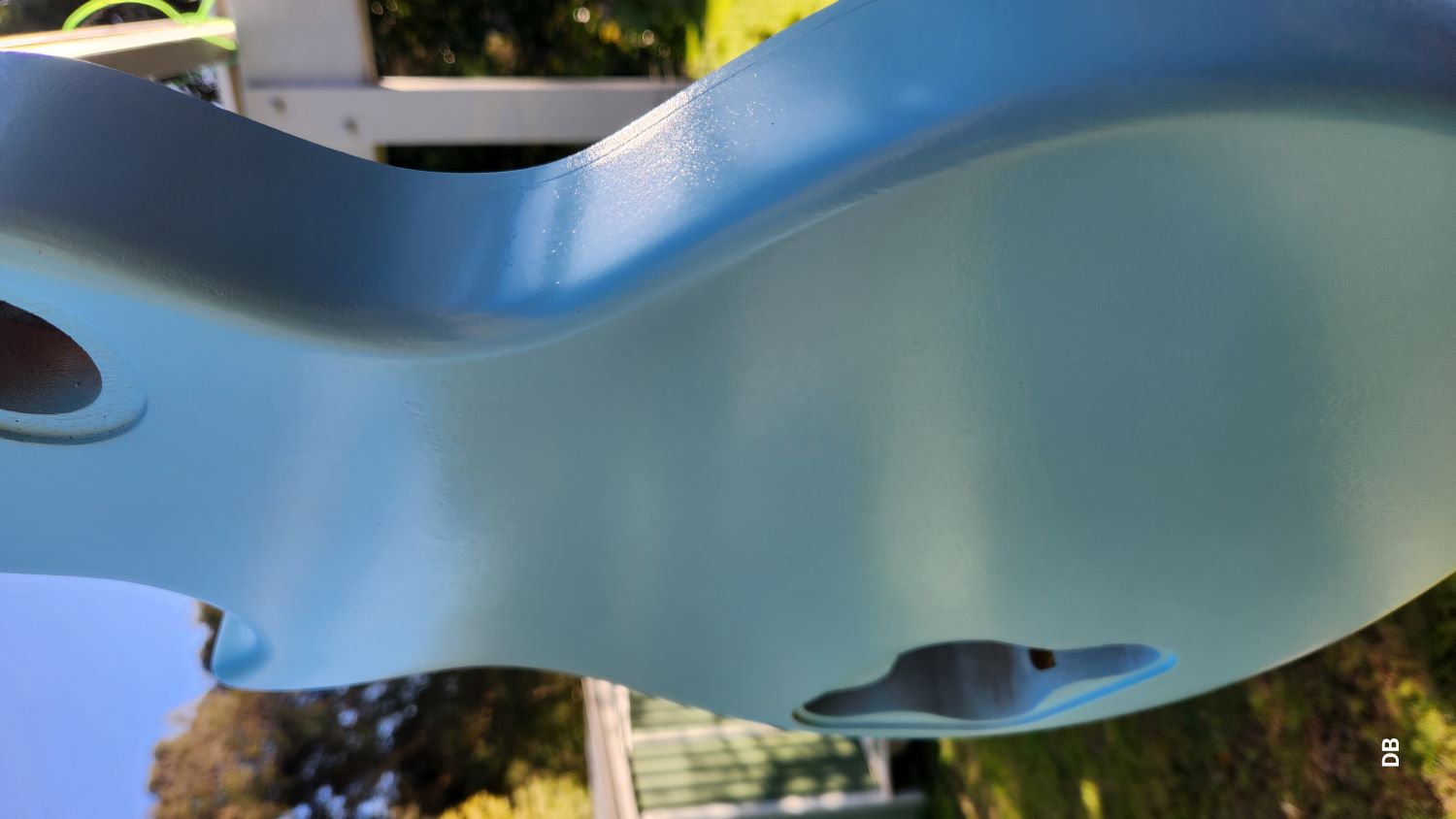

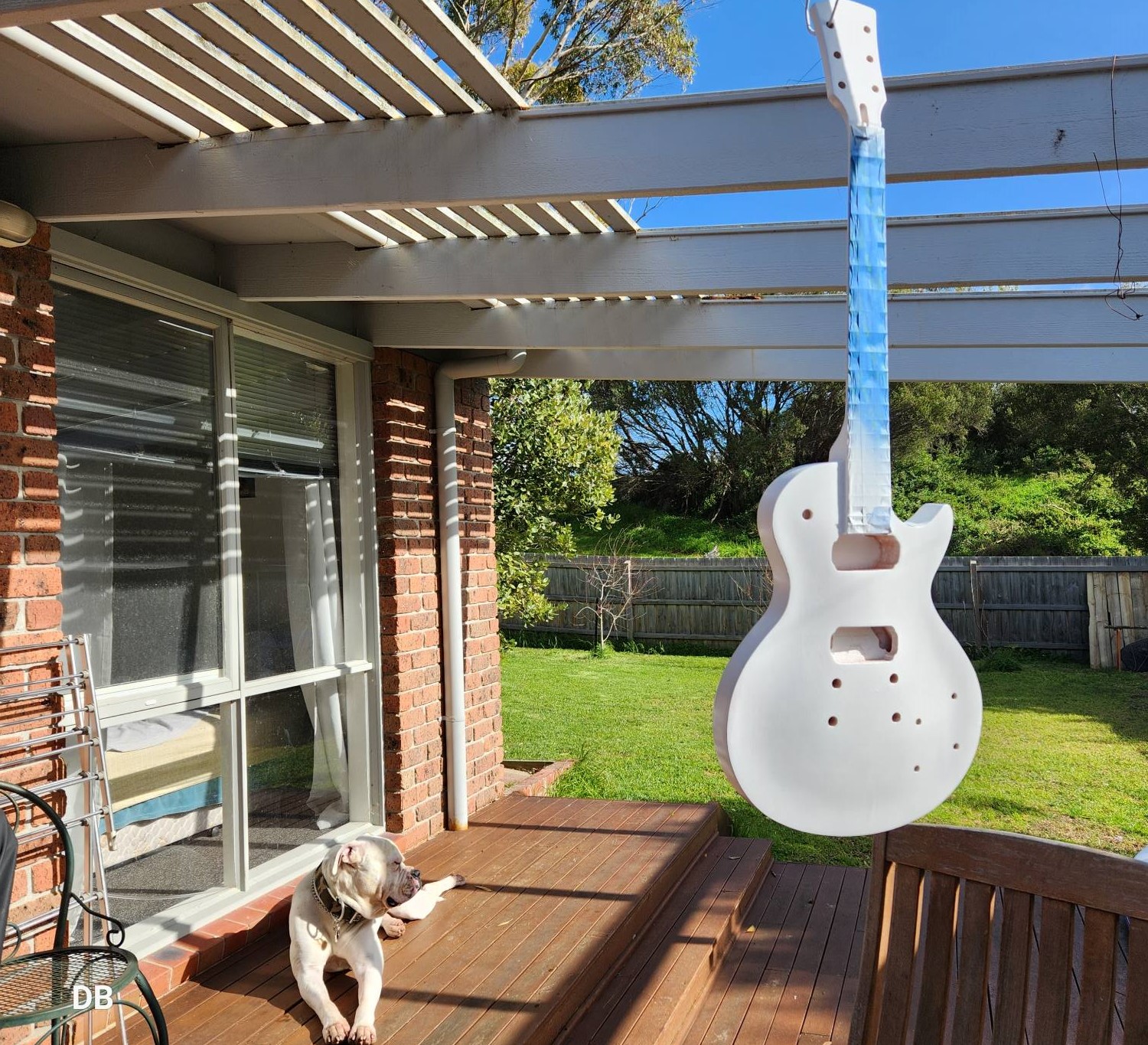

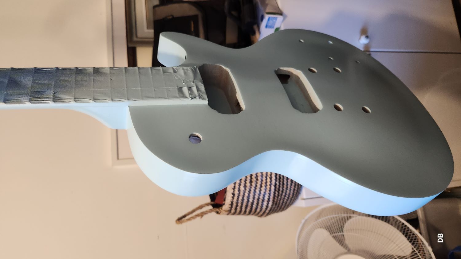

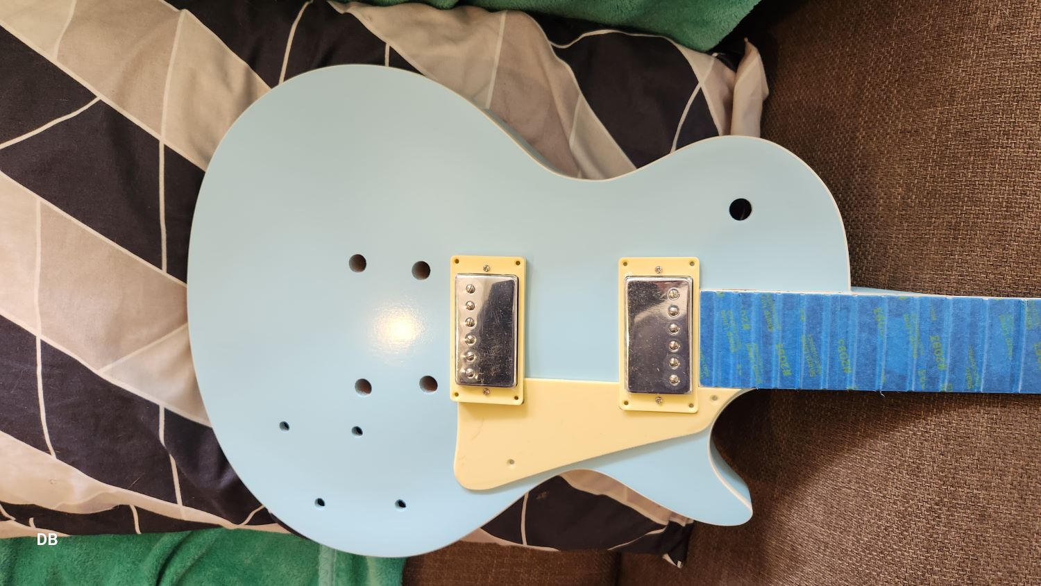

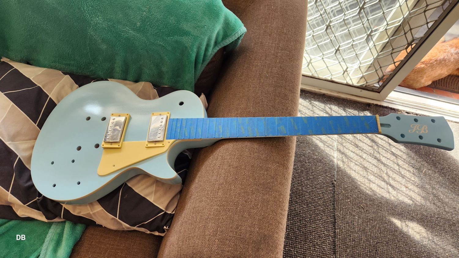

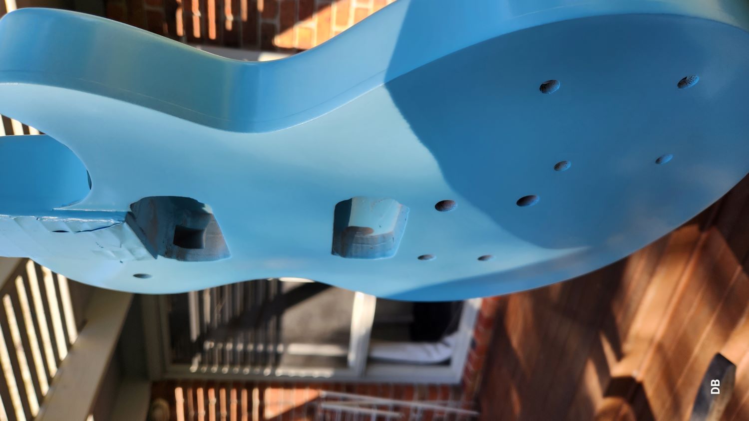

    Its coming along pretty goodlies so far this is the first guitar ive built but not the first time ive sprayed or worked with wood.
    Im up to the 2nd coat of colour and its gone on great, must make sure the cans warm before application i used a saucepan with water and gently warmed can in it over the stove on lowest setting for 15 mins there are some slight flaws but im under the pump to finish it for my brother and hes not as fussy as me lol.
    Its his axe.
    I rekon by the 3rd coat of colour it will be pretty ok il do that coat tomorrow 2 a day is enough.
    ive never spray painted a guitar before only semi trailer tankers a while ago but i have done a lot of house painiting so theres familiarity, i sanded the primer and refilled the grain ive also straightened the neck with truss rod to set it almost flat so far so good, few more coats and then il be soldering, Simon the kindly gentlemen above has suggested to upgrade the pots which will happen when the pickups are upgraded later on, im pretty handy with a dremel and can carve out the cavities without damaging the surface cos its my brothers its up to him when he buys some pikups.
    Ive got a Tele from here happening too now so il get some pics of that up soon why not?

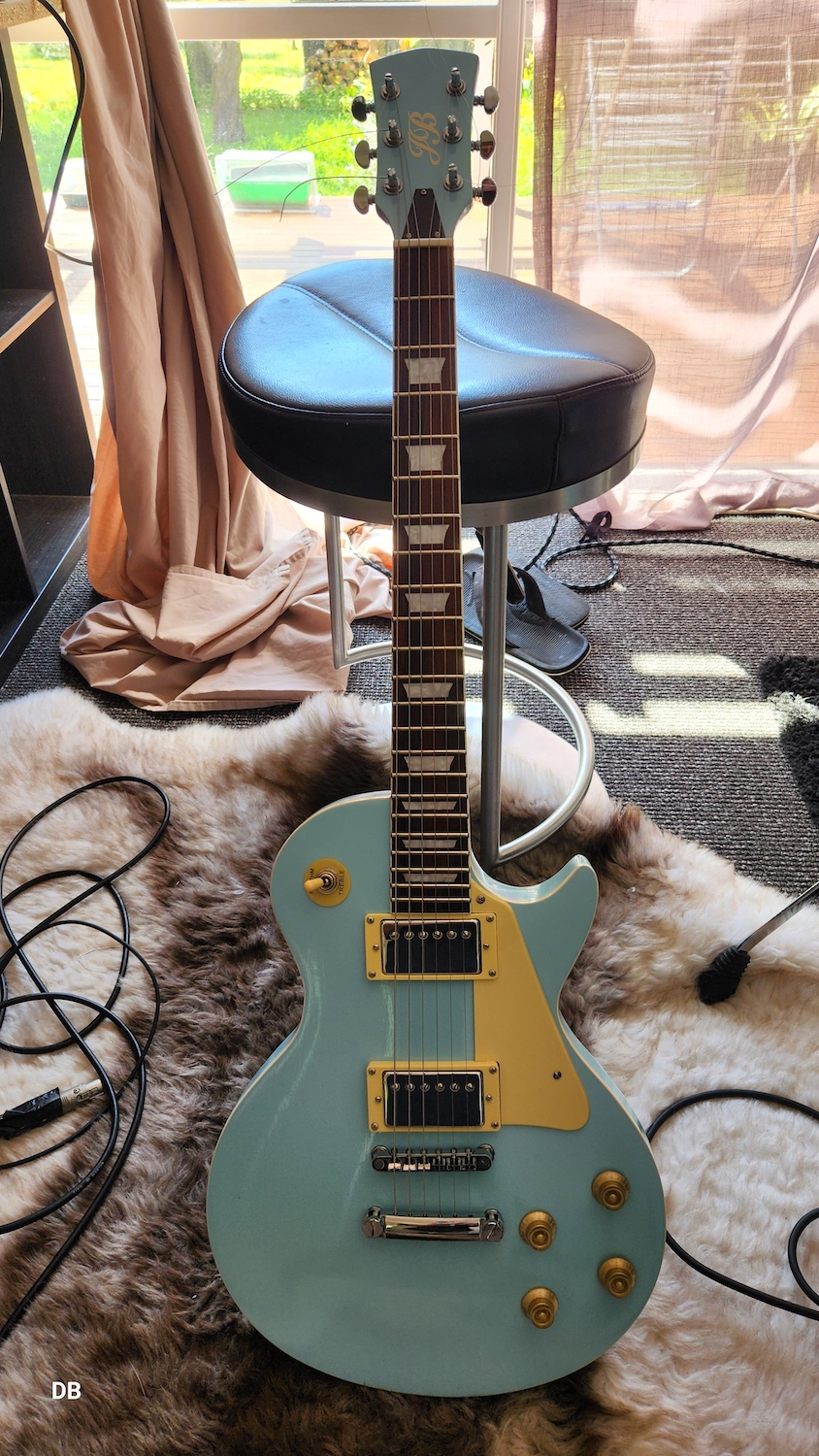

    Good on you and enjoy if you are methodical and think before you do things and research take your time [best you can lol] you can do it just follow the process and learn as much as you can first, kind regards from david.

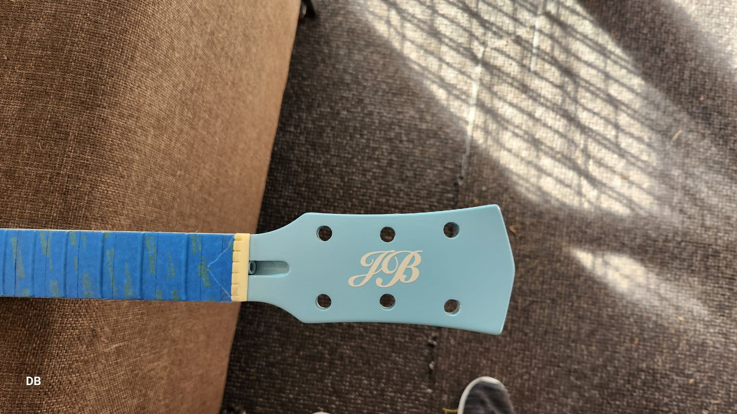

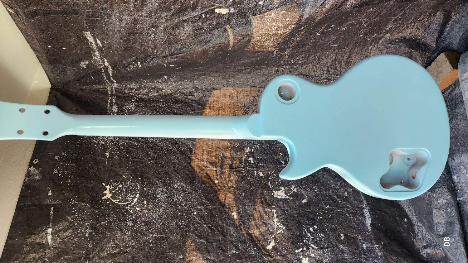

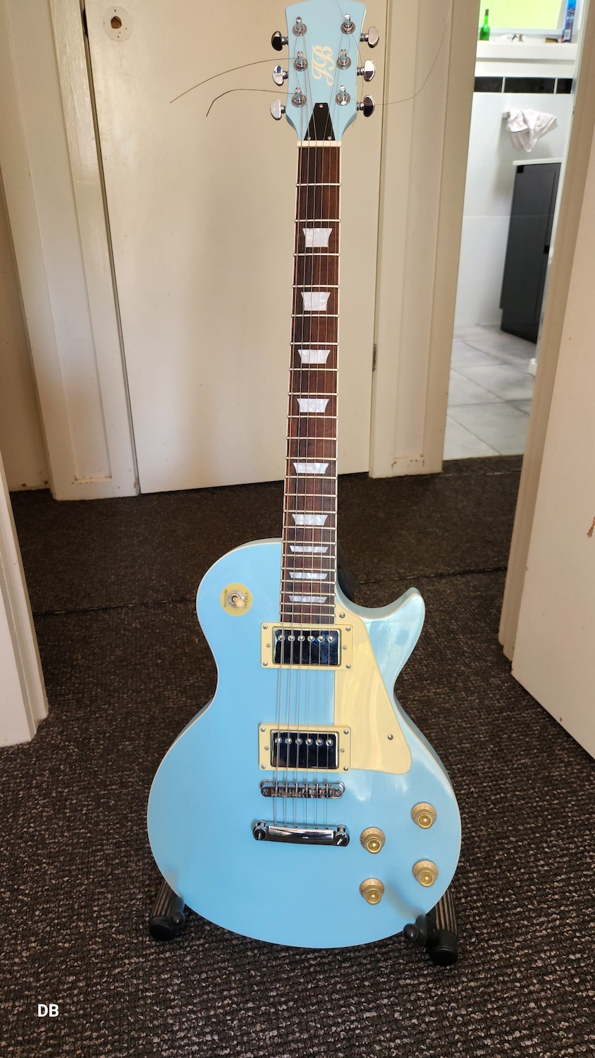

    Its curing outside today 3rd & 4th coats over the wkend now im loathe to sand without ity being somewhat cured there are some small flaws nothing to worry about when i do the next coats im only going to coat the front & back & headstock the rest is really good i will sand with 2500 first very lightly just a dusting with the sander helps the coats adhere and to produce more perfection over the few slight flaws.
    Overall im very happy with the results so far and i love the daphe Blue colour with the cream scratchplates and covers its knockout vintage aesthetic appeal and looks great to my humble eyes.
