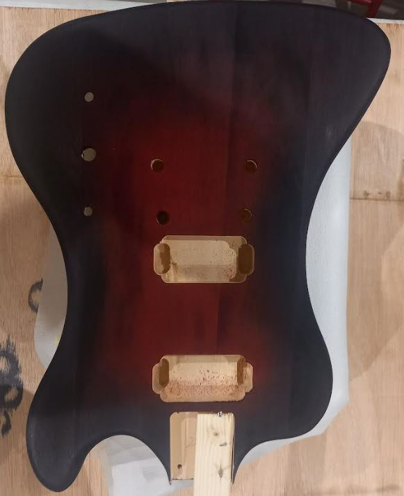

    So finishing plan was the use Crimson water based stains to attempt a black to oxblood red burst. May not be the best idea for basswood but this is intended to be a learning experience to pick up as many skills as possible. Backup plan is to sandback and do a arctic white nitro finish
    before staining body I did a little practice on some A4 sized basswood sheets from Amazon. Inital samples were very blotchy (as expected to be honest). Then tried with a preconditioner and got better results. Did some experiments with multiple pre conditioner coats and found 1 coat to be the best. Also found saturation with brush/cloth followed by wipe off, as expected the basswood really did soak up the stain (preconditioner help a bit though)
    This is what I was left with, not perfect as I rushed a bit, would have preferred darker edge and for the burst to follow body shape a lot better. It was still a more blotchy then I would like but I hoped oil finish may help to even things out

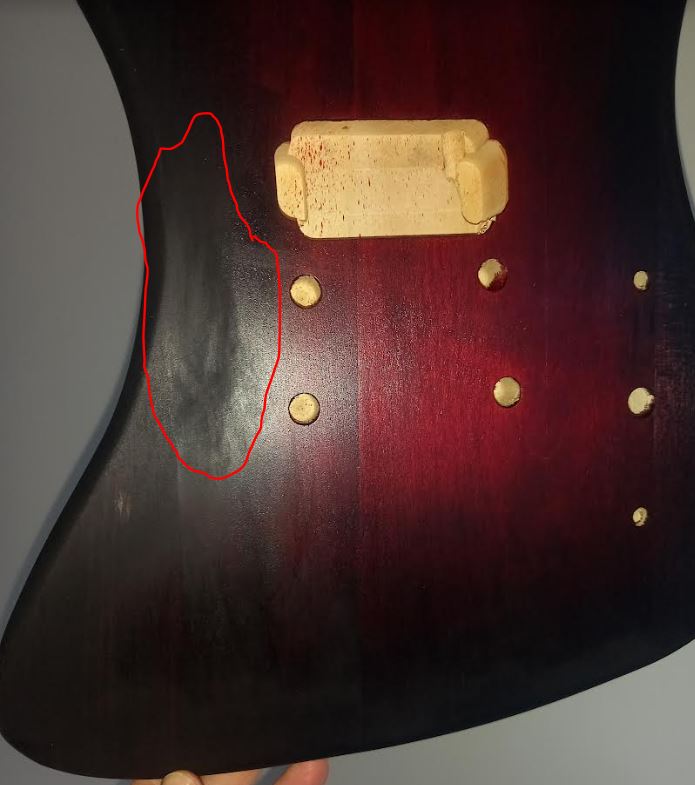

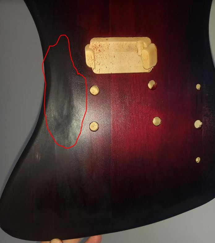

    So this is where things started to go sideways, the plan was to use crimson penetrating oil initially followed by high build oil
    The penetrating oil went relatively ok, I followed the procedure, it cured ok, went on pretty smoothly. The problems arose with the high build oil, basically it didnt cure even though instructions were followed, maybe it was compatibility with the pre conditioner, more likely the basswood soaked up too much finish. Worried the humidity in shed was too high I tried to bring that down, a day later I noticed two slivers of cracks in the body. Was this due to humidity change or were they there all along and filled with fine wood dust that got pulled out while removing oil , I dont know probably the former. Another issue was fibres of the shop towel sold by crimson remained in the finish, even though I removed oil when just starting to go tacky
    Below you can see the areas that remained oily to the touch and failed to cure. Lesson learned, dont use high build oil on basswood, stick to the penetrating oil
    Next stop, sanding back and we move to nitro finish

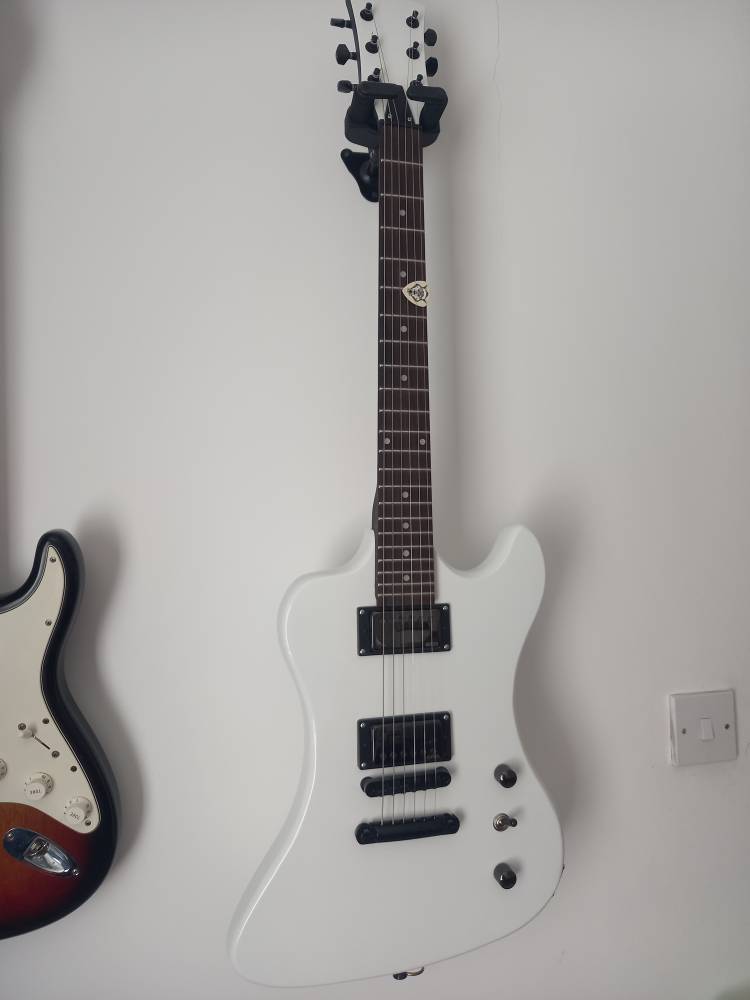

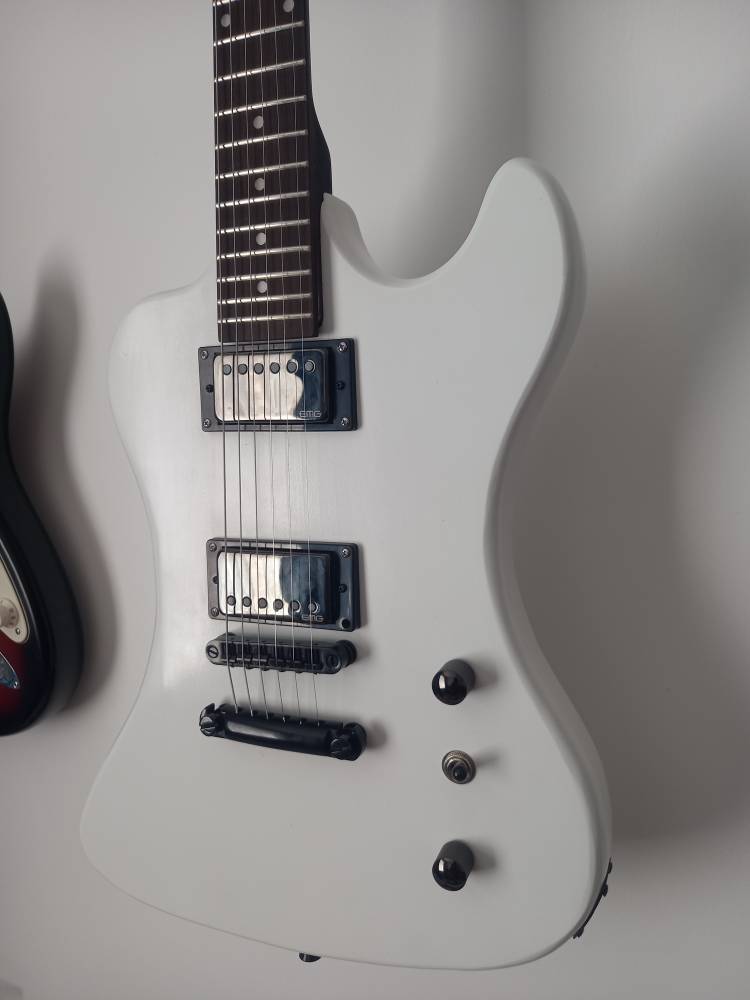

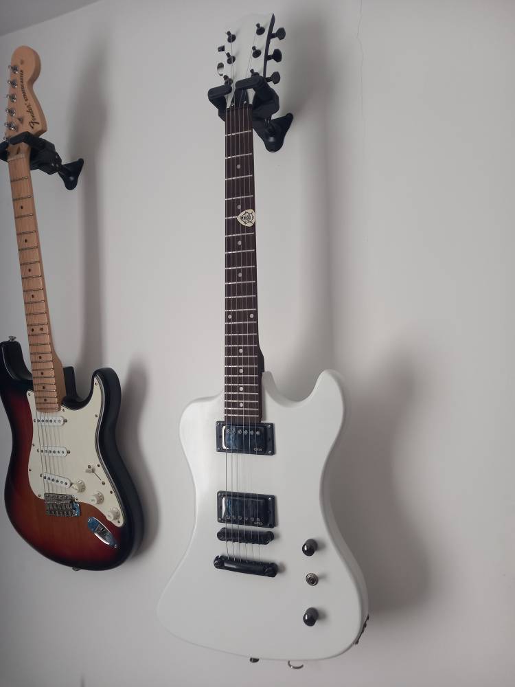

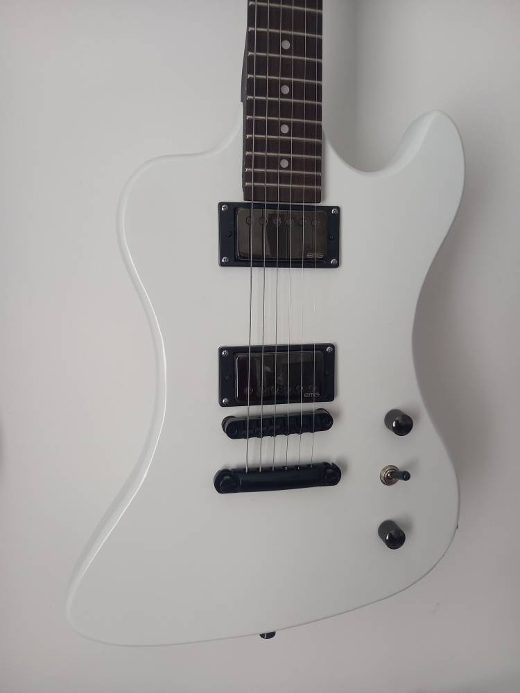

    So this is where we stand, only thing remaining is to make a pickguard and decide to add it or keep as is.
    Used the guitar fabric hand polish kit. Couldn't recommend it highly enough. Picked up james hetfield emgs on cheap. Guitar is intended for metal so wanted to try actives, a little extra space needed to be made in control cavity with dremmel, but no big deal. Emg solderless wiring was a dream
    Happy enough with the cheap hardware from northwest guitars. Though post holds in bridge were a bit too snug and needed to be widened.
    After setup guitar is playing as well as my american strat, i just had one fret that i needed to take down a touch that i missed during fret levellingClick image for larger version.
