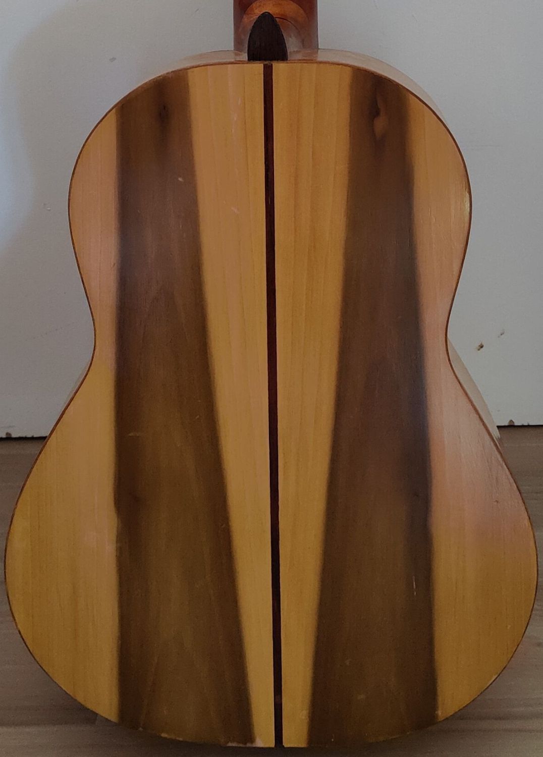

    You guys were so much help with the telecaster kit i received from PBG, I thought i would start a thread here for this build. It's a T style, single cut, left handed guitar in poplar, with a rosewood fretboard and mahoghany neck. I wish I could have purchased this kit from Pit Bull Guitars (bc the quality and community here are top notch), but the custom guitar orders were down when i needed to order it. So it came from a retailer here in the US. Parts got backordered, so I've only had it about a month to design and start working on it. My deadline is the 1st of September to have the art done, finish dry and be ready to assemble.
    This one will also be wood burnt, painted and finished with water-based, wipe-on poly. So far, I've mostly completed the wood burning, and started on some color test swatches. It's supposed to be a surprise for my son's birthday (well, he knows it's an LP guitar, but not the specifics about the art), so you guys don't spill the beans about it!
