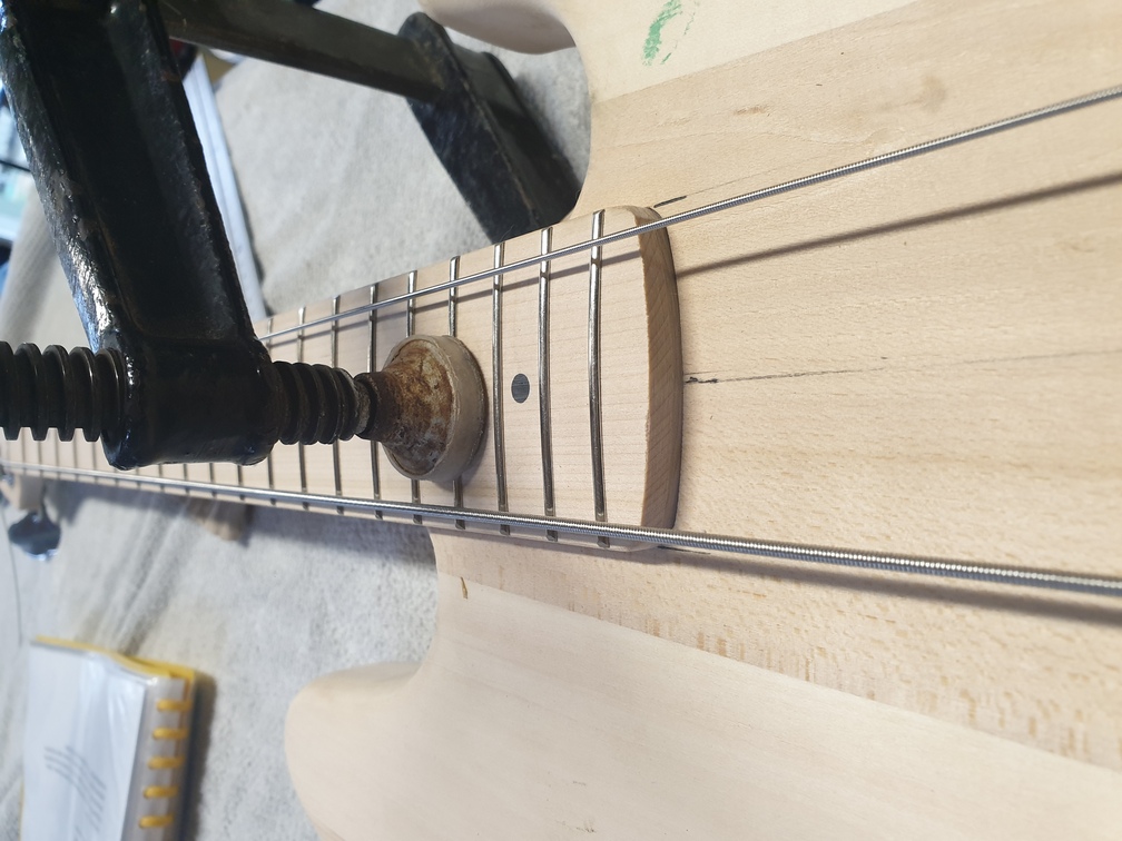

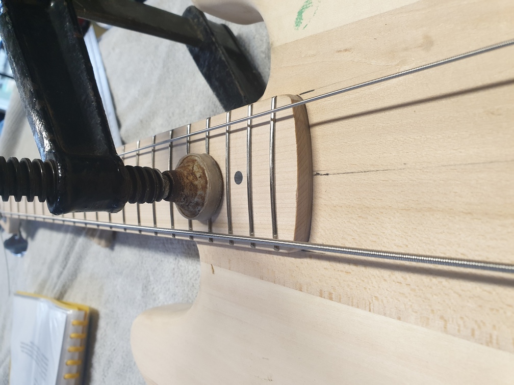

    I have encountered a problem here i was wondering if you could assist me?
    As you can see the space between the string and the edge of the fretboard is different on each side
    There is 3mm gap at the 12th fret on E string and
    7mm gap on the G string side
    How would I go about correcting this?
    It says in the pitbull instruction manual that I could sand down the inside of the neck pocket?
    I'm worried that I might make things worse
    Please help 😅Click image for larger version.

    Here is the problem
    As you can see its pretty far off from.being straight
    Do I need to re install the bridge?
    Sand the neck pocket?!
    How would I fix this ?
    Thankyou everyone 🥰

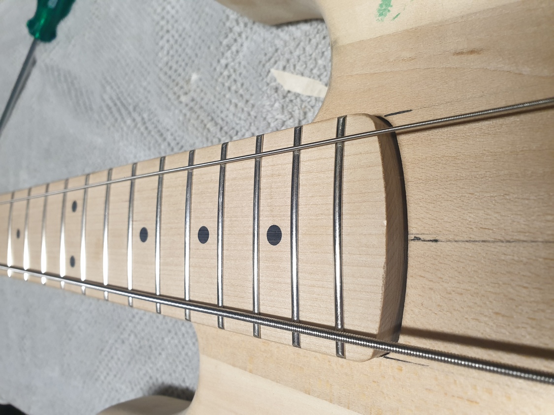

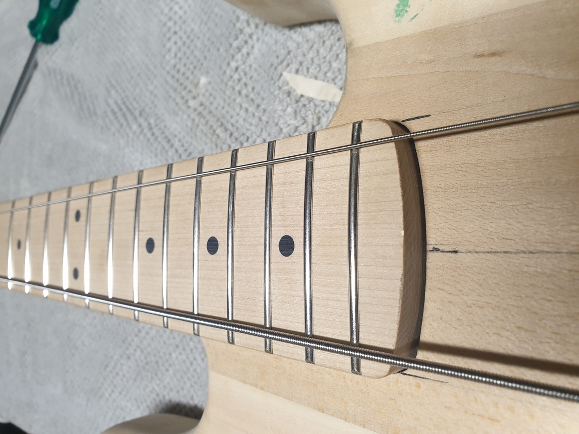

    FIXED IT!!!!
    Bit of a light sand in the neck pocket then drilled and installed the neck on a slight angle to get string alignment and its perfect now!
    I was stressing over nothing really it was an easy fix

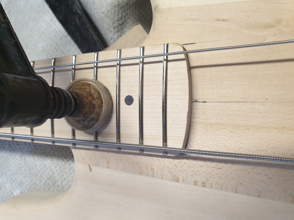

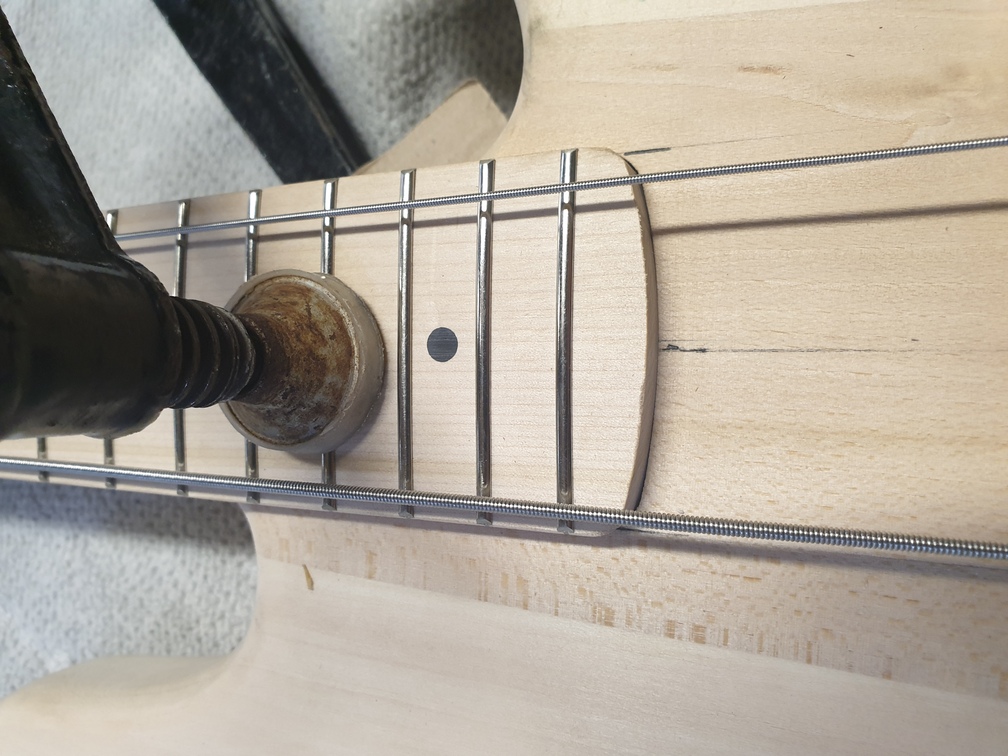

    Cool, but it looks like youve shoved a piece of wood in between the neck pocket and the neck ?!
    Yes that a piece of veneer had to glue to side of neck pocket. The neck alignment in my kit was off. I couldn't relocate the bridge as it was a semi Hollowbody kit with a very small centre piece. @fender3x have me this idea to whack the neck from bass side to see if there is a play and if a small wedge opens up. And there was a small wedge. I had to shove in some veneer one by one and mark it as far as it can go into neck pocket and check the alignment. And it did align well after that. Then I had to take the neck out and glue those veneer to side of neck pocket until the markings on top of each. Now all is well.
