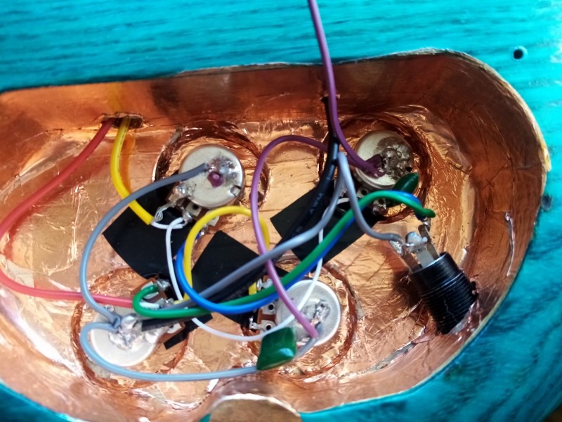

    Finished the whole guitar, wired it up the same way I've done for years, no sound - check p/up signal 00.0 - dud pickups? is there something different about HB pickups? do I really have to send them back to Oz to get a new pair? what a let down.Click image for larger version.

    Took earth wire from long terminal - hot and earth to the shorter term/reversed them - signal still - 00.0- I have shielded the cavity so - tomorrow I'll try that - tomorrow . .
ID:	43551 - I'm hoping someone can see the problem - Ive rewired the jack a few different ways = my meter is alway 00.00 - even the pickup - you'll have to excuse my soldering and unfamiliarity witth electric language - but my question is - why is there no signal from either p/up when using the meter - I mean not connected to anything . . Ive even wired the p/up directly to the jack and nothing .

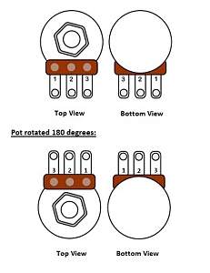

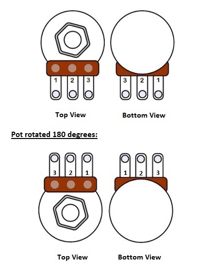

    There are several things wrong going on there. Mostly caused by interconnecting the pots via the wrong solder lugs on the pots, and at least one of the volume pots (top left) is grounded by the wrong lug. I'm also not sure why there are 3 wires going to the output jack
    I would suggest de-soldering the lot and starting over; cross-reference to the pot lug reference chart I've attached; and methodically following the wiring diagram again.
Name:	Pot lug numbering x 2 e2.jpg

    Ive soldered them the same way as my jazz - Ive always earthed the top right lug to the pot - hot signal in the middle with out put - using separate wires for each pot - 2 wires to the jack - and again - why is there no signal from the actual pickup? = I'll start agin, yes - but I dont see the problem. When I put the meter on the HB p/up from my guiatr I get 8.5 - when doing the same to these bass p/ups its 00. Thats my question.
    Member noproblam's Avatar
    Jan 2020
    Westportal, New Zealand
    19
    No - youre right - I've earthed the wrong terminal on the volume pots - oh the shame. . . Got my sunday morning lined up . .
