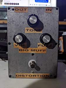

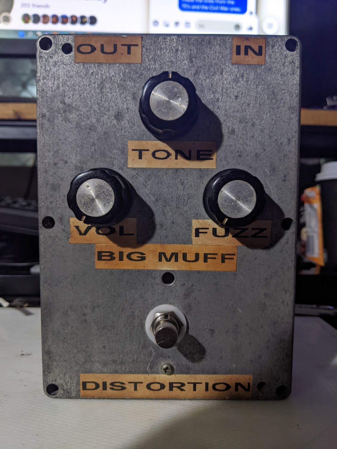

    Here's a couple of pics of the pedal as-is:
    The front:

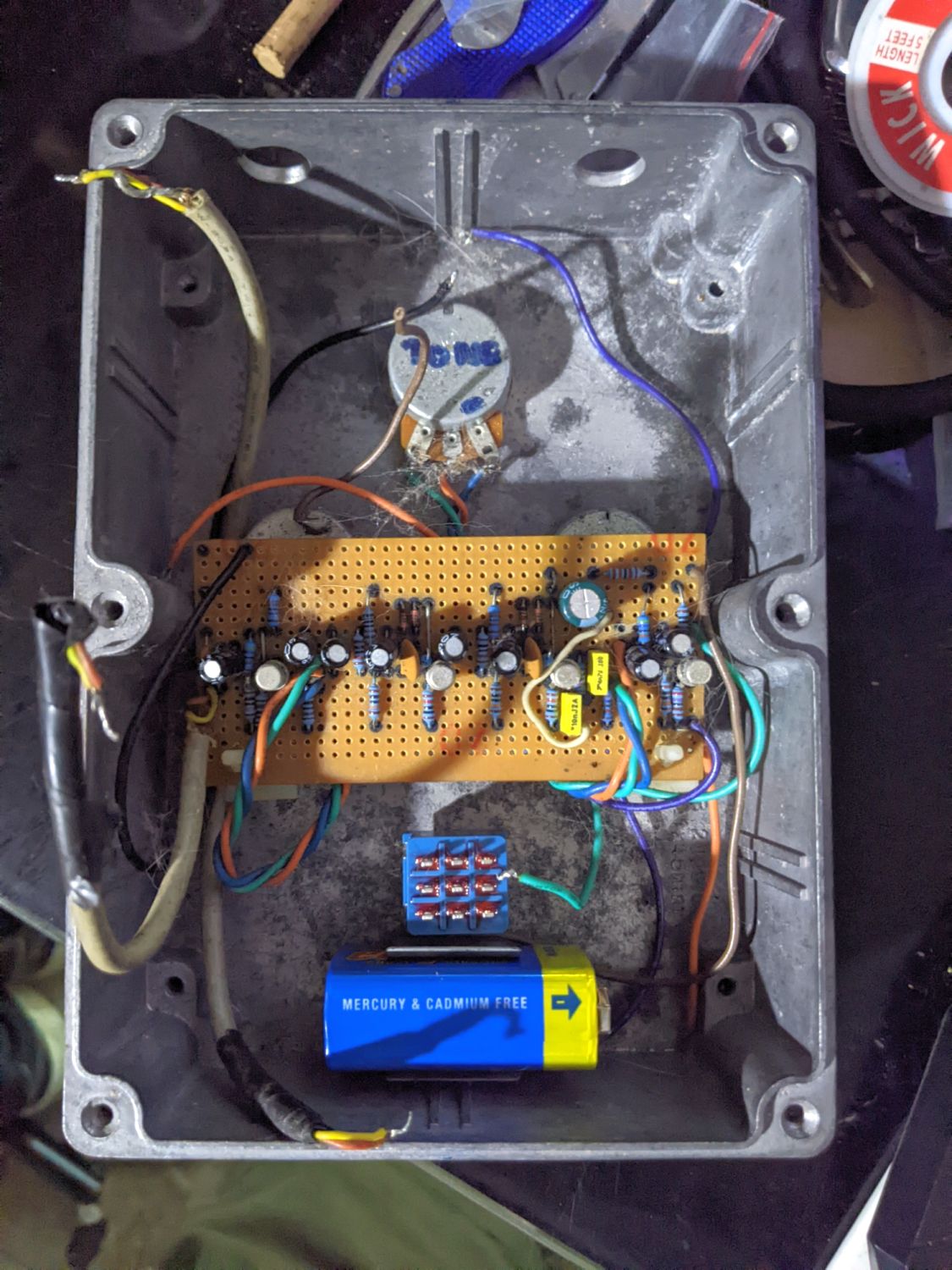

    And the insides:
Name:	DIY Big Muff Insides_resized.jpg

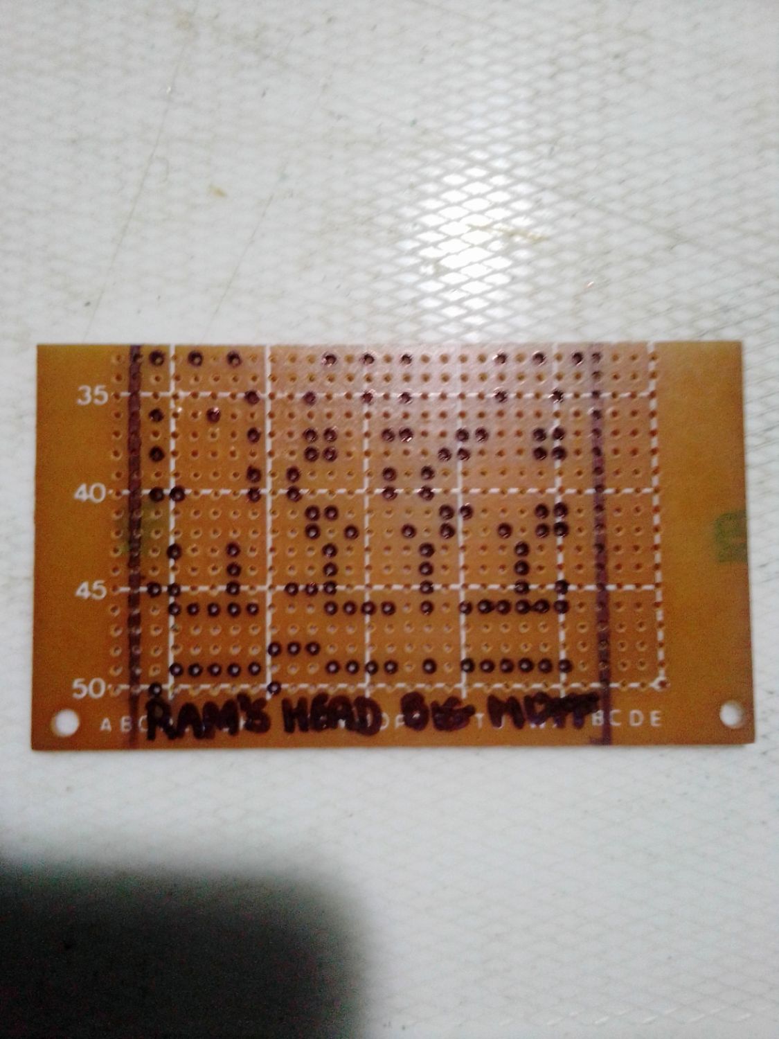

    Here's a pic of the new pad-per-hole circuit board I'm making for my Big Muff pedal, I took this pic after cutting the board to size and marking the component positions using a black sharpie pen, I'm going to be using some tinned copper wire to form all the tracks joining the components together after they are all soldered in place, one day i might do a mini-tutorial about how to build circuit boards for pedals, using pad-per-hole boards, anyway, here's what I've managed to get done so far:
Name:	New Big Muff Board_resized.jpg
    For those wanting to do the same, you need to cut the pad-per-hole board so that the board is at least 18 by 23 holes, you can make the board wider so you have plenty of room for making mounting-holes for circuit6-board standoffs, which I've done here.
