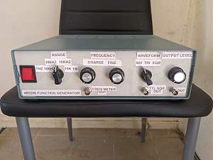

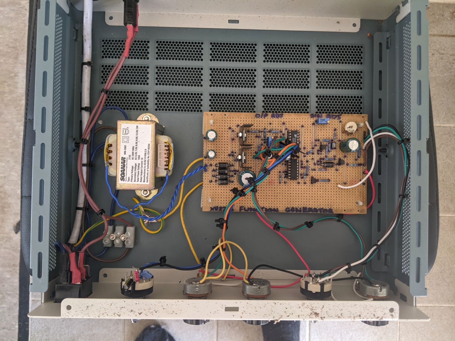

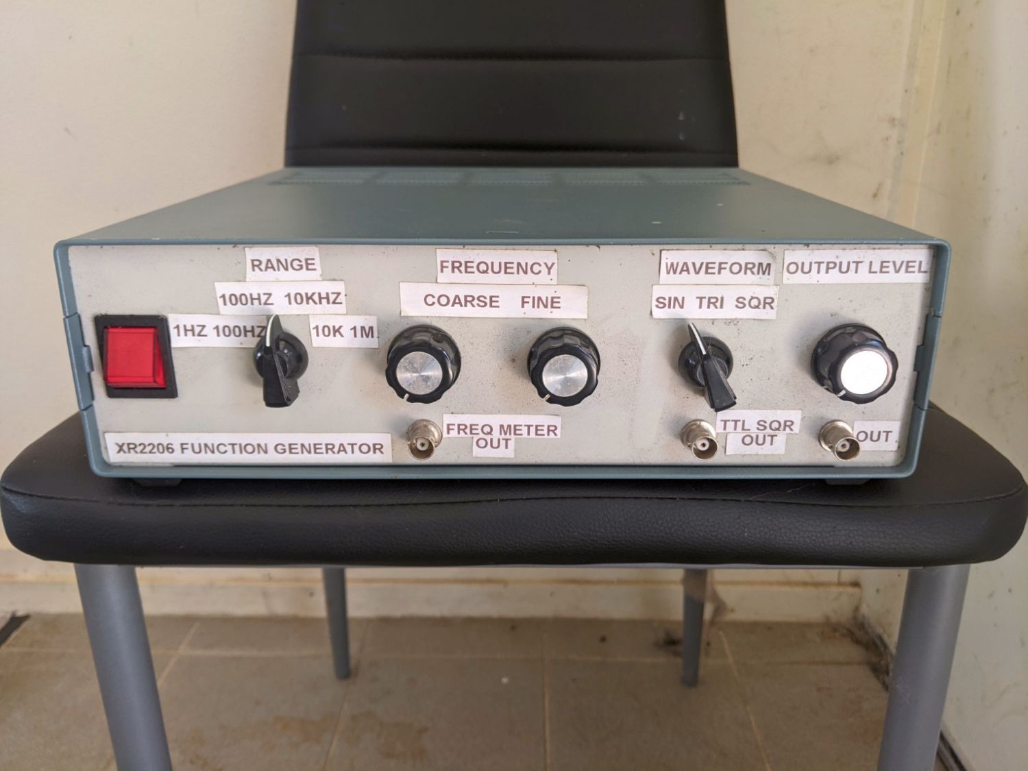

    Here's a couple of pics of my DIY Function Generator:
Name:	XR2206 FG_1_resized.jpg
Name:	XR2206 FG_2_resized.jpg
    As you can see, there's not a whole lot inside the case, of course I could have used a smaller case to house all the internals, but I like the "aesthetics" of the case I chose, it has a Laboratory test-equipment look to it, my DIY Function Generator uses a mains power transformer to power it, but since I'm going to have to re-create the circuit board layout from scratch anyway, due to my old studio computer breaking-down last year and the original layout was amongst all the files I lost as a consequence, I'm going to re-design the circuit board layout from scratch so you can safely power it using a standard DC plugpack adaptor, I do need to make a minor mod to the original circuit so that you can control the output level of all three signal waveforms though, the Sine and Triangle waveforms are variable in level, but the Square wave level is a bit too high for practical use, I will include the mod in the re-designed circuit board layout once I know the mod works perfectly.

    Here's a link to the webpage where I got the original design for my DIY XR2206 Function generator build, it includes a circuit diagram:
    https://www.eleccircuit.com/xr2206-function-generator/
    This design uses two ICs, an XR2206 Integrated Function Generator, and an SN74LS00 Quad 2-Input NAND Gate, I bought the ICs I used in my XR2206 Function Generator build from my local Jaycar Electronics store, they had some XR2206 ICs in stock but didn't have any SN74LS00 ICs in stock So I had to substitute a functionally equivalent one that they did have in stock, I ended-up settling on using a CD4093BE which is a CMOS Quad 2-Input NAND-Schmit Gate IC, the SN74LS00 Is a TTL IC, but as far as I'm concerned, the CD4093BE is practically functionally identical to the SN74LS00, although the CD4093BE includes hysteresis, anyway, in practice I can't see any difference in operation, it seems to function perfectly well in the circuit.
