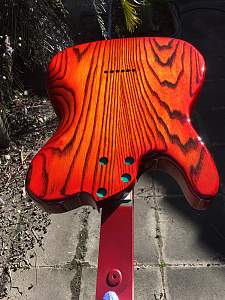

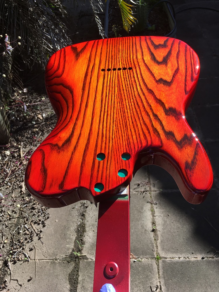

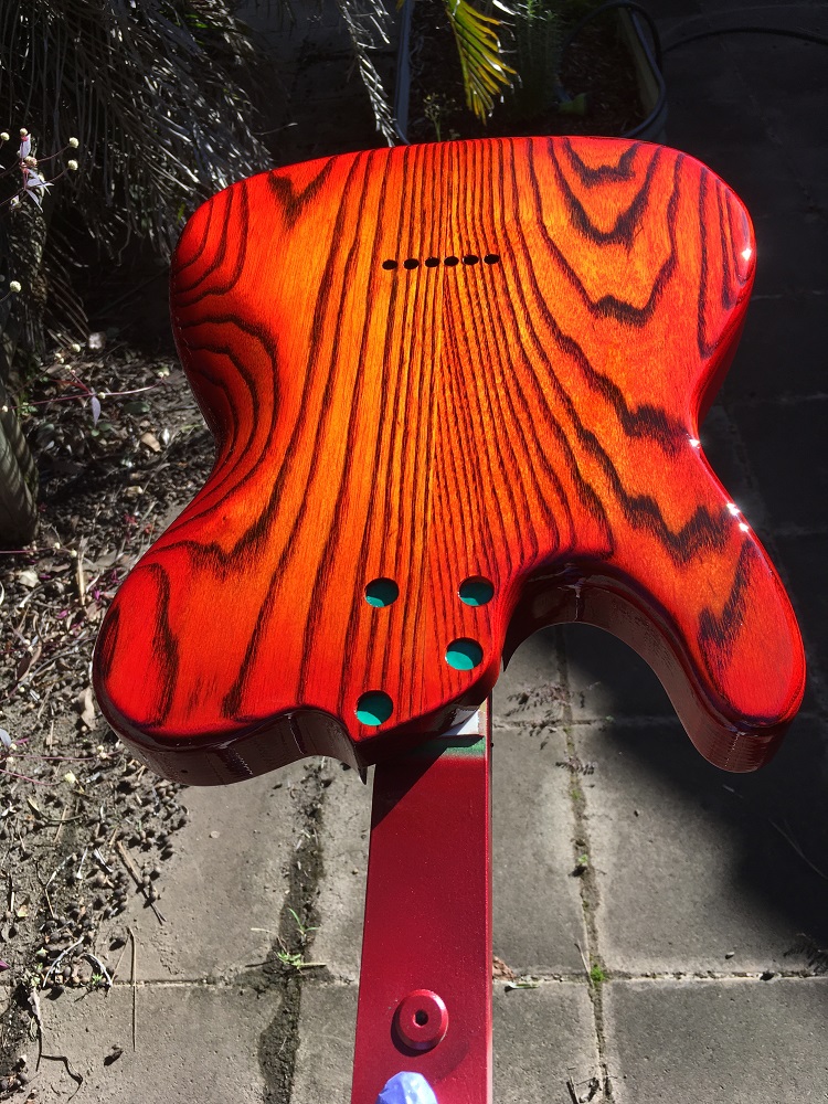

    Ash is a very open pored timber and requires grain filling if you wish to have smooth finish (satin or gloss). There are numerous products available for grain filling nowadays, so pick your poison! If you want to accentuate the grain, you can use a contrasting coloured grain filler before staining.
    This is my TLA-1 (ash tele) that I'm currently refinishing, and I used Ebony Timbermate grain filler followed by alcohol based dye then polyurethane:
