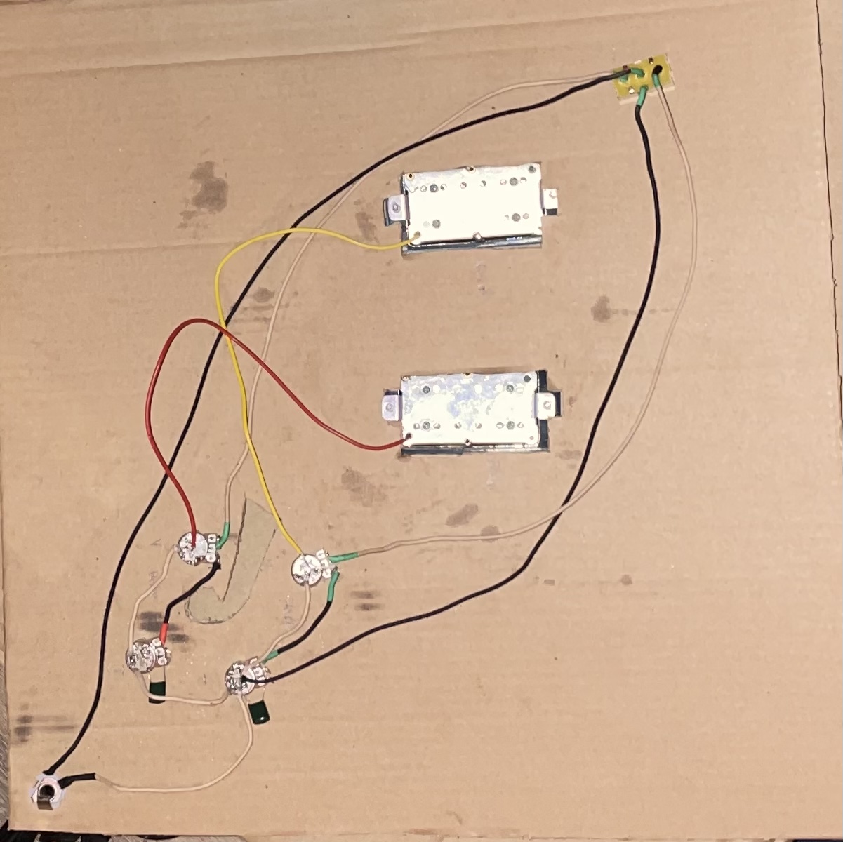

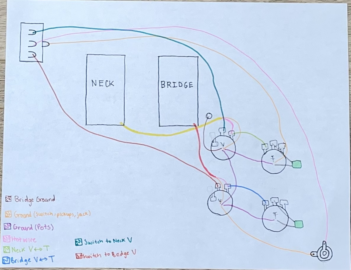

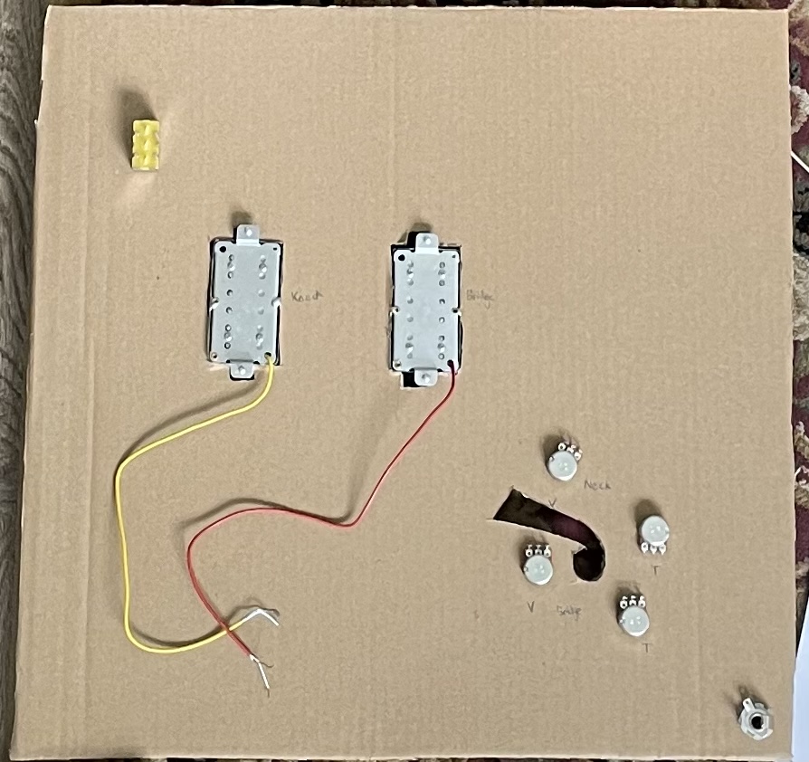

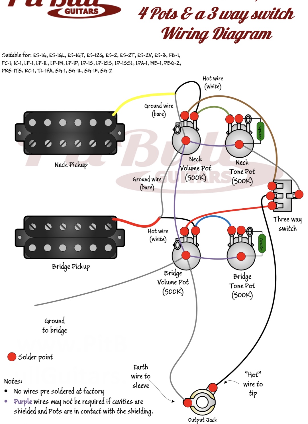

ID:	43256 Hello! I am beginning to work on the wiring for my ES-3 while I let the poly cure. I am making a wiring diagram that is more accurate for the ES-3 in terms of the placement of the parts, but I知 a bit confused about some of the connections on the PitBull diagram. Am I correct in saying that the switch is grounded to the neck tone pot, the jack and bridge wire are both grounded to the bridge volume pot, and both pickups are grounded to the neck volume pot? Also, does the diagram want you to ground the jack and bridge wire to the bridge volume using separate wires? Can I ground wires to different pots in order to avoid overcrowding, or does it matter which pots the wires are grounded to? Anything helps!!
