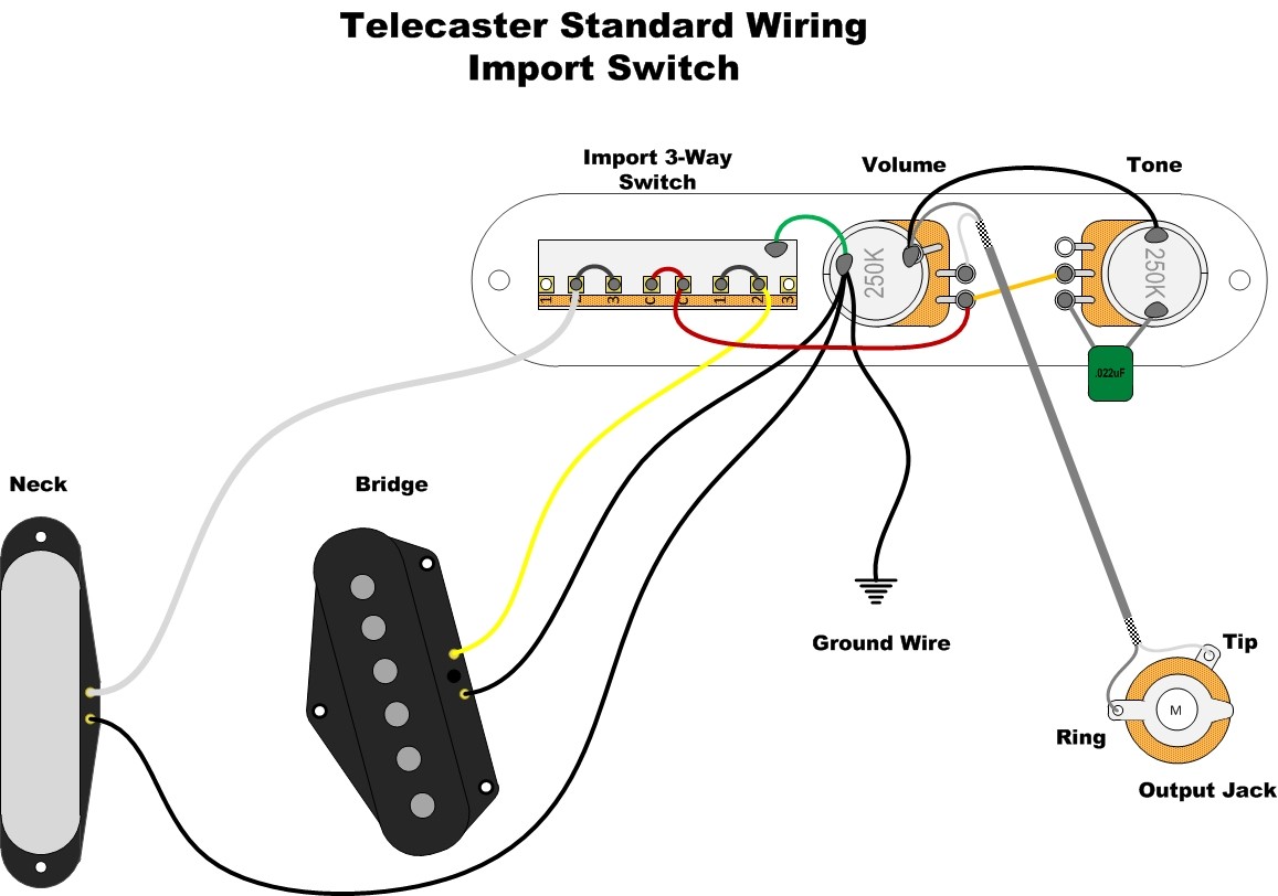

    The switch is not wired correctly. You have lugs linked like it was a CRL-type lever switch.
    The internal routing of the "import-style" switch is different.
    Try this diagram for a tele with 8-lug import switch:

    Thanks mate I saw your previous advice in another thread on this. I had tried the initial wiring that came with the switch and put in both sets of pickups using that wiring. Then after I saw your comments on this in another thread I rewired for the import switch. Still no dice.
    So then I bought a new 3 way fender switch and replaced the import and tried wiring it again and no dice.
    I have it currently wired under Broadcaster wiring diagram. But have down modern Tele and Nocasters recommended wiring using these same new pots and switch. Still just buzz.
