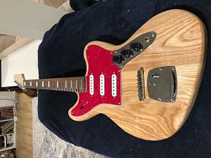

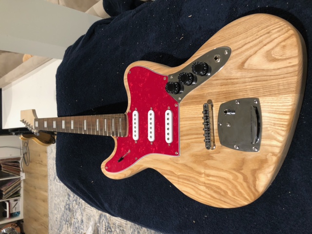

    First, the good news...the kit already arrived! Way in advance of when I anticipated, which is great. Secondly, the wood is really gorgeous!
Name:	pretty wood.jpeg
    I was planning on matte white...or some sort of very, very dark charcoal grey or something like that, but I have to at least attempt to give this thing a natural finish. I think I will be sticking with my trademark black hardware where I can (I will attempt to fabricate a pick guard, get black tuners, swap knobs) The knob plate, bridge, and tailpiece are a maybe-down-the-road-swap type situation. Right now I will stick with the chrome. I think that will look good with the natural finish and black accessories anyways.

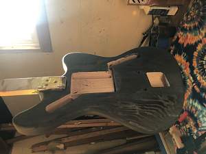

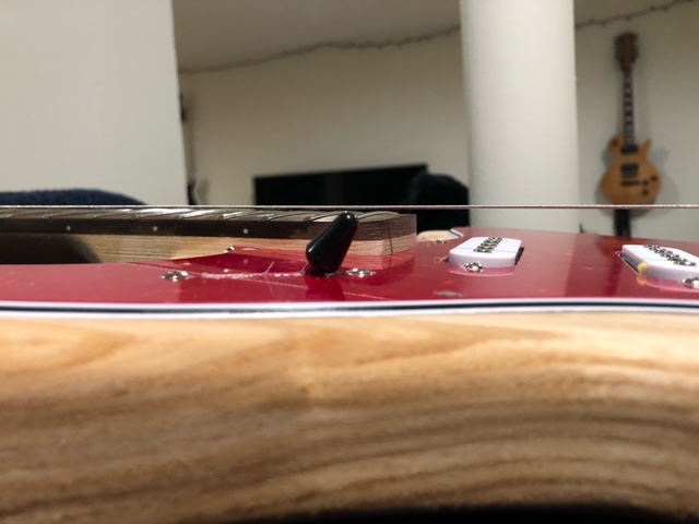

    Something seriously funky (not the good kind) is going on with this neck pocket.
    Pictured here, you see how high the heel sits above the pick guard. I mean..you can see quite a lot of neck under the fretboard, I don't know. That stuck out to me.
    And...yeah

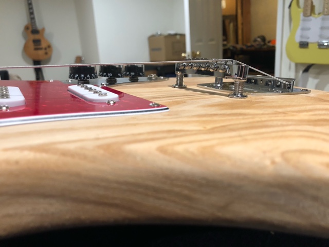

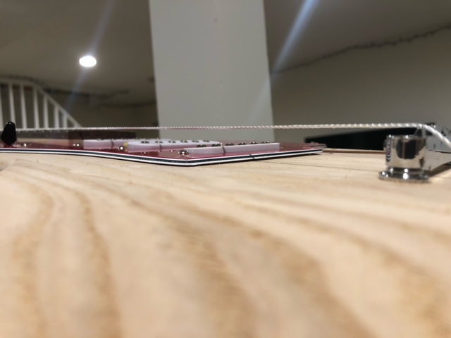

    Then I threw a string on there just to see what was happening there (regular guitar strings are definitely not fitting on this 30" scale but you all probably knew that already and were just waiting for me to figure it out)
    but the 6th string reached the tuner so I tensioned it up and raised and raised and raised the bridge to get it off the neck and....whoops!
Name:	crazy bridge.jpeg
    That's not supposed to be like that!

    I think the next move is to....deepen the neck pocket? Which is something, even after 9 other builds I have yet to do...so. Wish me luck? Give me some pointers? It's back to the research stage it seems.

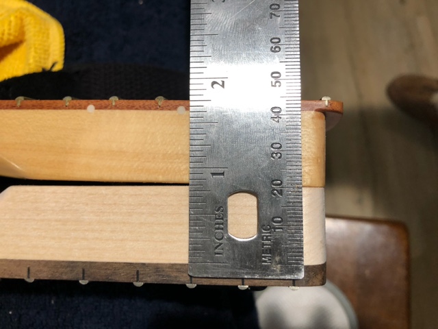

    I removed the neck to measure various things.
    The necks were an exact match. 21mm of neck from end to fretboard
    But about 2mm extra thickness on that fretboard!

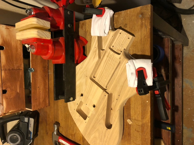

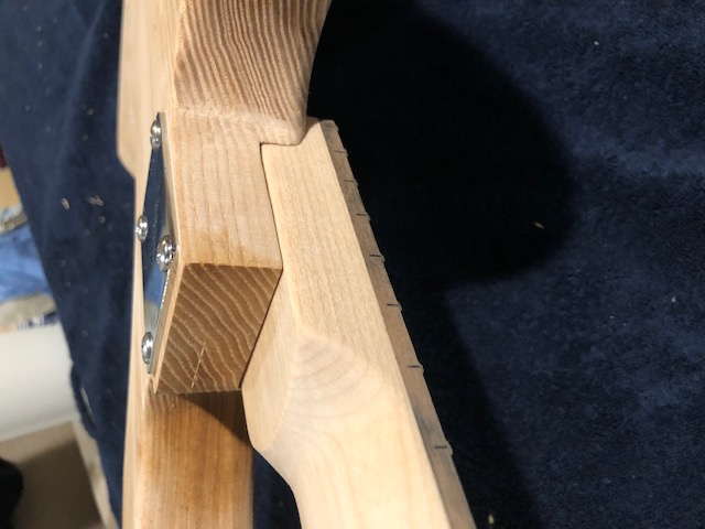

    Also, whilst daydreaming today I realized that I did indeed have to dig into the body-ward, more difficult end of the neck pocket in order to remedy the crazy-a$$ situation I had going with the gap between pick guard and string. Again, you all probably realized this and were just waiting for me to figure it out.
    After measuring it appeared as though I had about 3mm of pocket to remove (not including the extra thickness on fretboard...we will see where I net out)
    ...in as exact as an angle as I could eyeball without a protractor, using my rudimentary basement tools.
    So I got to chiseling and rasping and filing and measuring and chiseling and rasping and filing and measuring....etc.
    It was hard to be patient and work slow, that is not my rock-n-roll MO.
    But it turned out well
    Much more appropriate. And that bridge is flat on the body, with the faux-string resting on the fretboard, so I have some room to mess with.

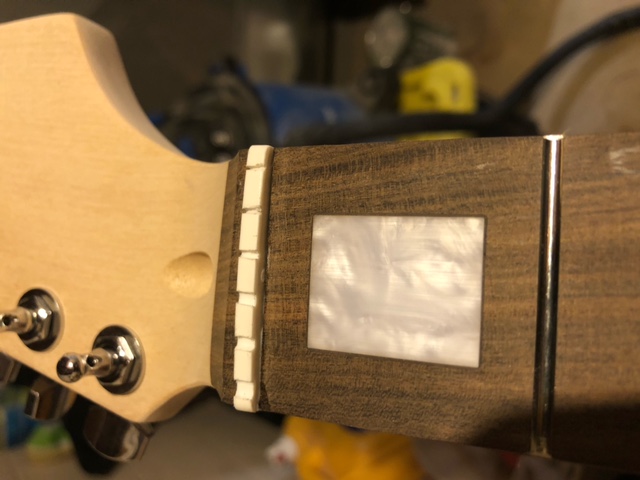

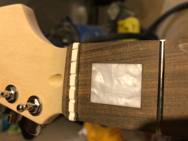

    But I did want to try out my nifty new nut files. So, although this looks god awful, it was mainly a proof of concept to see if filing would get the gauges to where they needed to be
    I am going to upgrade to a bone nut before the end of this build
    Next time I attack a nut with the files I will have some sort of jig set up to make sure the files go straight down the neck, and stay at the right angle.
    All for now! back for more in the next couple days.

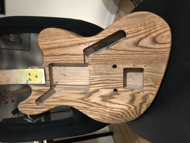

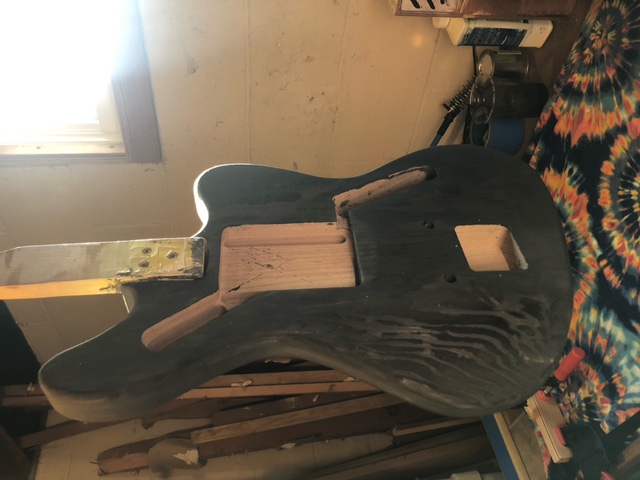

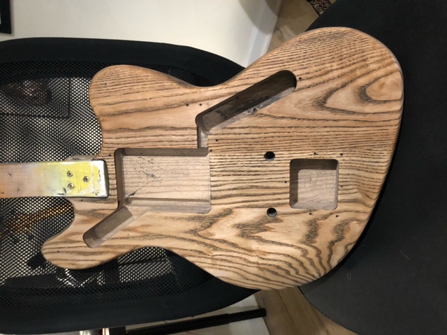

    I didn't expect to get much done this weekend, as most of the pieces for this project are current en route to my place.
    But my grain filler showed up like 4 days early! Huzzah! That was one thing that was holding up any work I was going to do on the body.
    I got some of stuff called Gork's GoodFilla, and thus far it's been great. (Buy straight from the manufacturer if possible, no need to cut Bezos in on this)
    Here's the body slathered in black goop
    Then sanded back
    And finally with the first coat of stain on it.

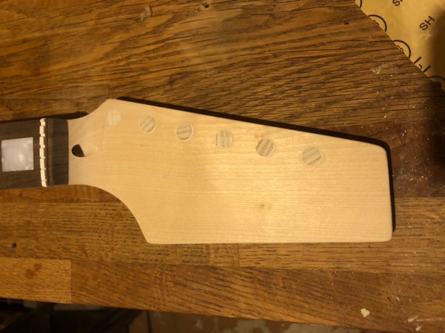

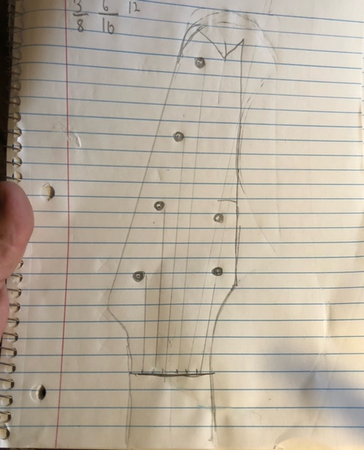

    Also, I'm moving forward with the crazy-ass idea of filling the original tuning peg holes, drilling in slotted bass tuners and putting 4 on the bass side and 2 on the treble side.
    I will have to abandon the classic "Fender" style headstock design in this case.
    I sketched up something rudimentary, at least to see if it was feasible without looking too dumb.
    I was worried about the strings fanning out above the nut, break angle, etc. Typical design worries.
    I was worried that what I think is called the "deflection angle" being too great, and the string popping out of the nut slot.
    In a reddit post I found while researching, someone said something that totally blew my mind ( Link to give credit where credit is due )
    "It's a little counterintuitive, but there's still only a single bend over the nut. If you look down the neck (from the headstock end) of a guitar that isn't straight pull you'll find that if you rotate the guitar about the axis of the neck, there is an angle for each string where it appears to be straight."
    Wild. Anyways. The sketch appears at least grounded in this reality so I'm moving forward with the idea. Also, contingency, I found some baritone conversion necks for sale on eBay if everything goes pear-shaped.
    You’ll need a set of 4+2 tuners if you go that route. You can’t just rotate two tuners from a standard set and hope it will work well. You want the string tension to pull the round tuner gear against the worm gear, and if you rotate a standard tuner the tension pulls the gears apart, not together. The effect is more immediately noticeable on smaller diameter guitar tuners than good quality bass tuners which have a much wider post, but engineering-wise, the correct way is far better in the long term as the incorrect-way tuners will wear out far faster than the tuners with the correct orientation.
    You should still be able to arrange the tuners for a straight string pull if you play about with paper and pencil. Given the relative thickness of bass strings to guitar strings, you’ll find that to get equal distance between the outside edge of each string, there’s a noticeable offset between the centres of the nut slots on a bass. You can’t just draw the centres of the slots an equal distance apart.
    It is better if you can get the strings pulling in the line of the strings along the neck as much as possible. That way you only get the string pulling against the bottom of the nut slot, not the bottom and side. You need to consider the 3D force vectors. You get less overall friction, and less is better for tuning stability. A well cut nut slot can minimise friction, so you can get away with some splaying of the strings. But if the slot isn’t smooth, excess splay angle will exacerbate this, and you could find it hard to get the string in tune to start with, and then find it’s more prone to slipping out of tune when playing.
    This is going to look great
