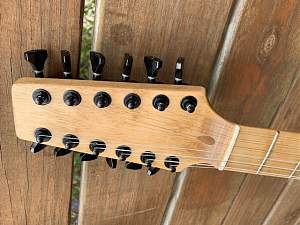

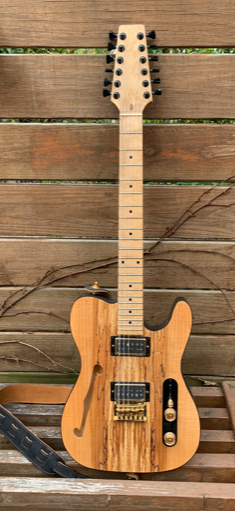

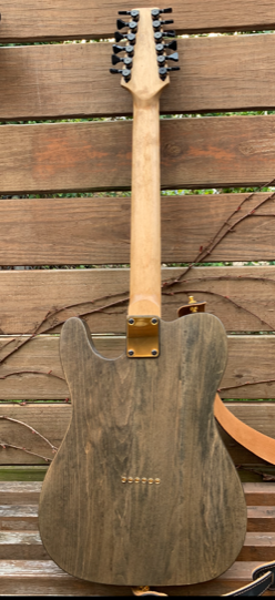

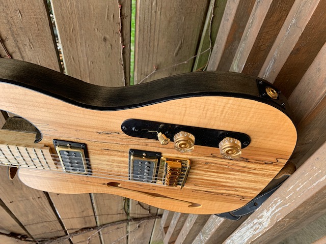

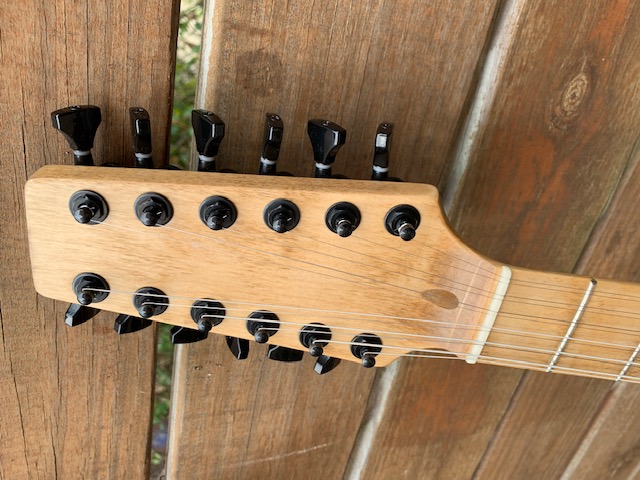

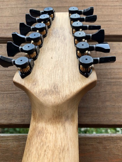

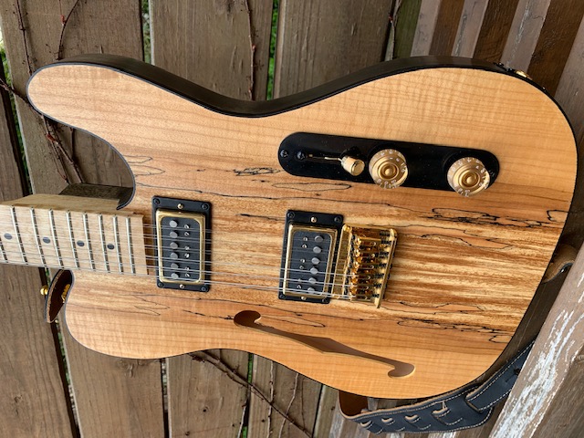

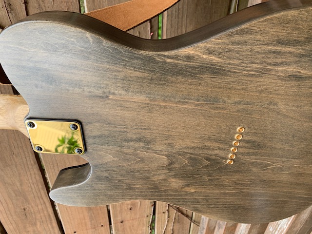

    Hello,
    Here is my submission for my build that has taken a good bit of time.
    Custom 12 String TL Tele w/ Humbucker sized, single coil pickups, and staggered locking tuners
    Photos may come out sideways, but if you click them it should be in the right orientation.

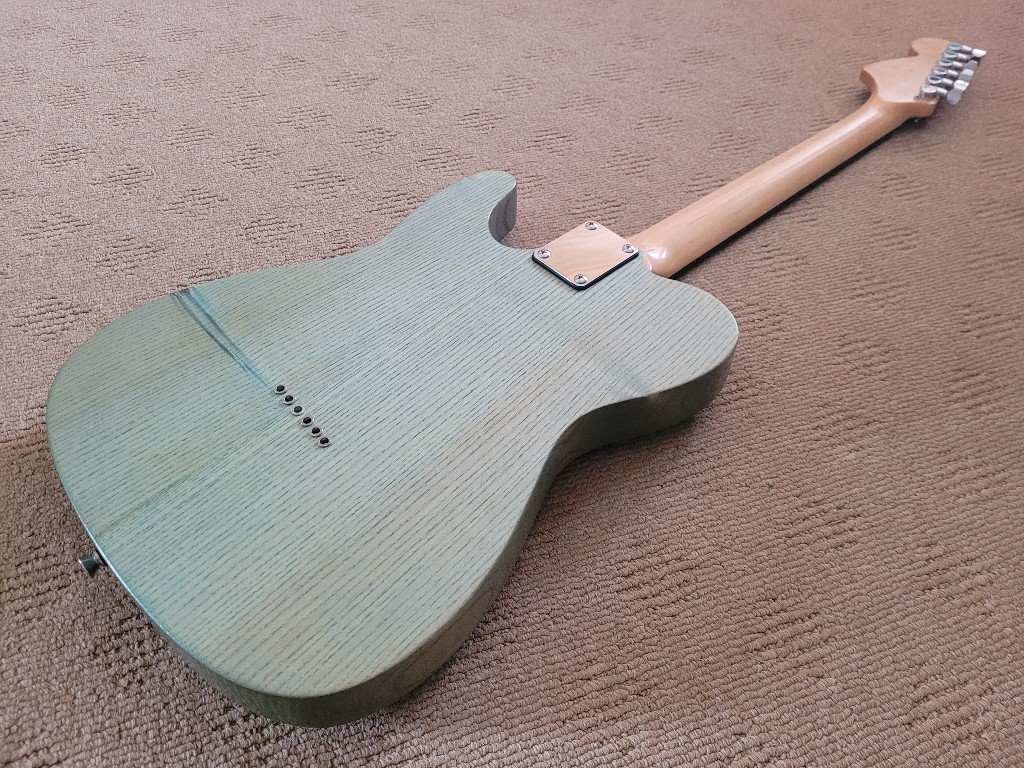

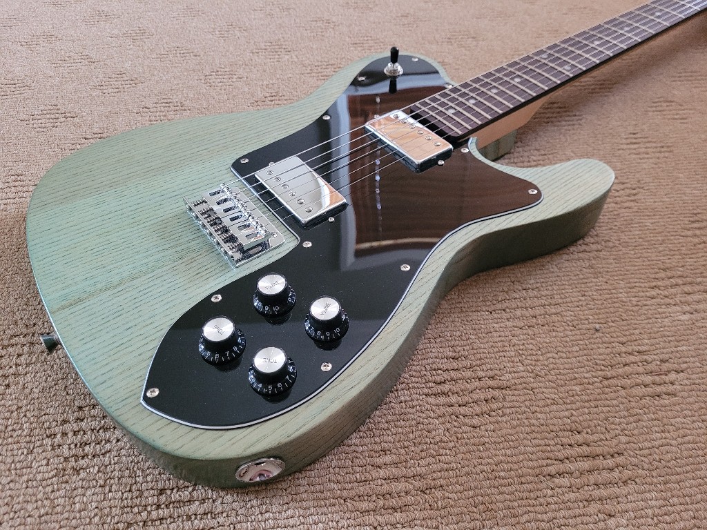

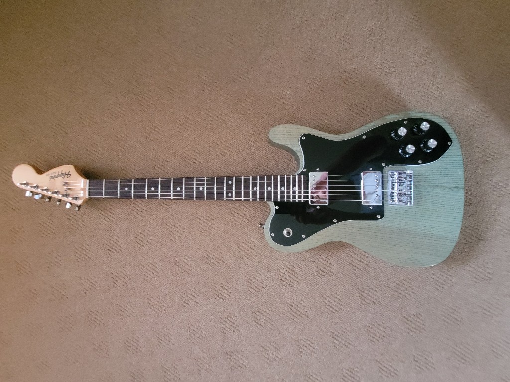

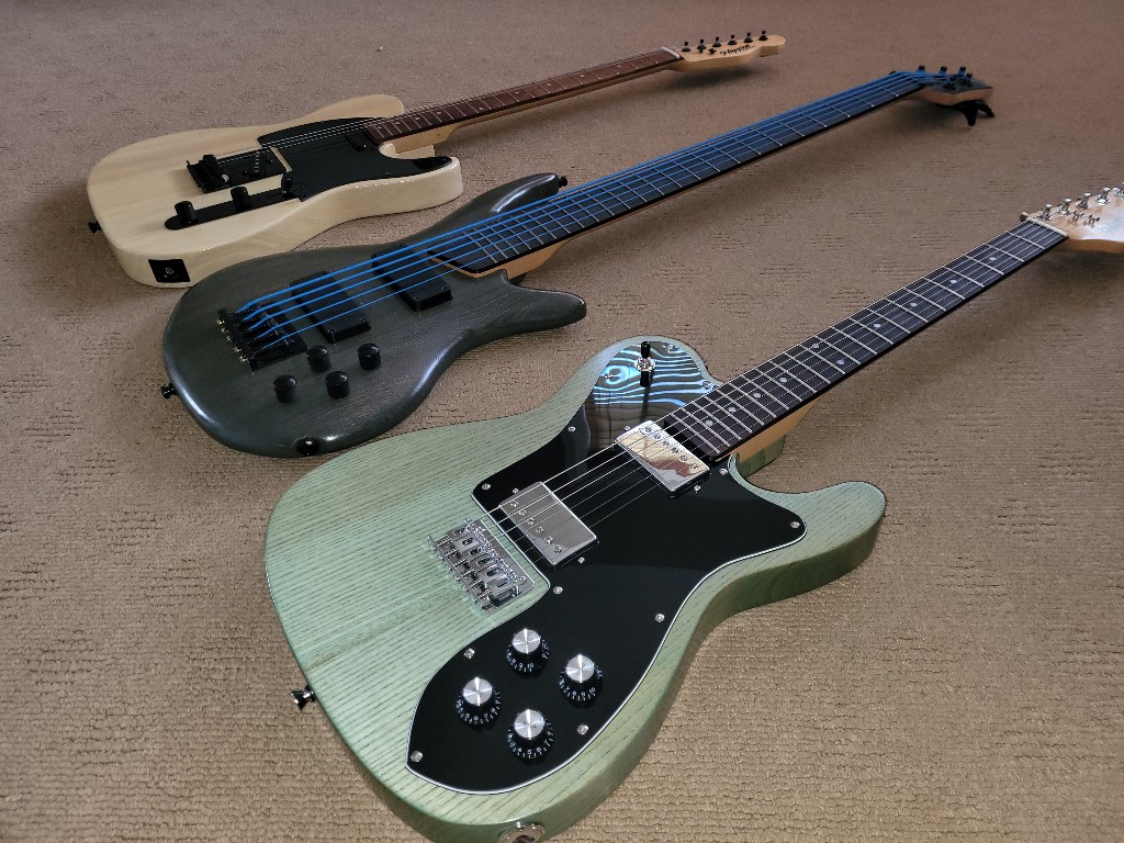

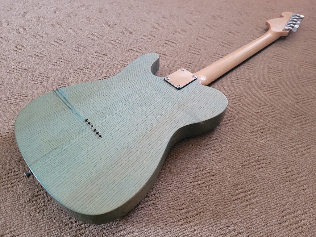

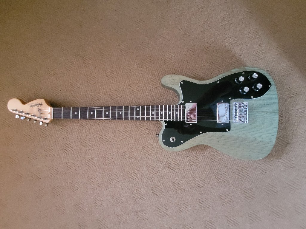

    Hello all.
    This is my tele deluxe style build for my niece. Finished in colortone dye and tru oil cut back to a satin. Only changes to stock kit spec is bone nut, cup style jack and cut a new pickgaurd as the kit one did not follow body lines or cover control pocket with pickups in

    Last picture is with previous builds

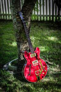

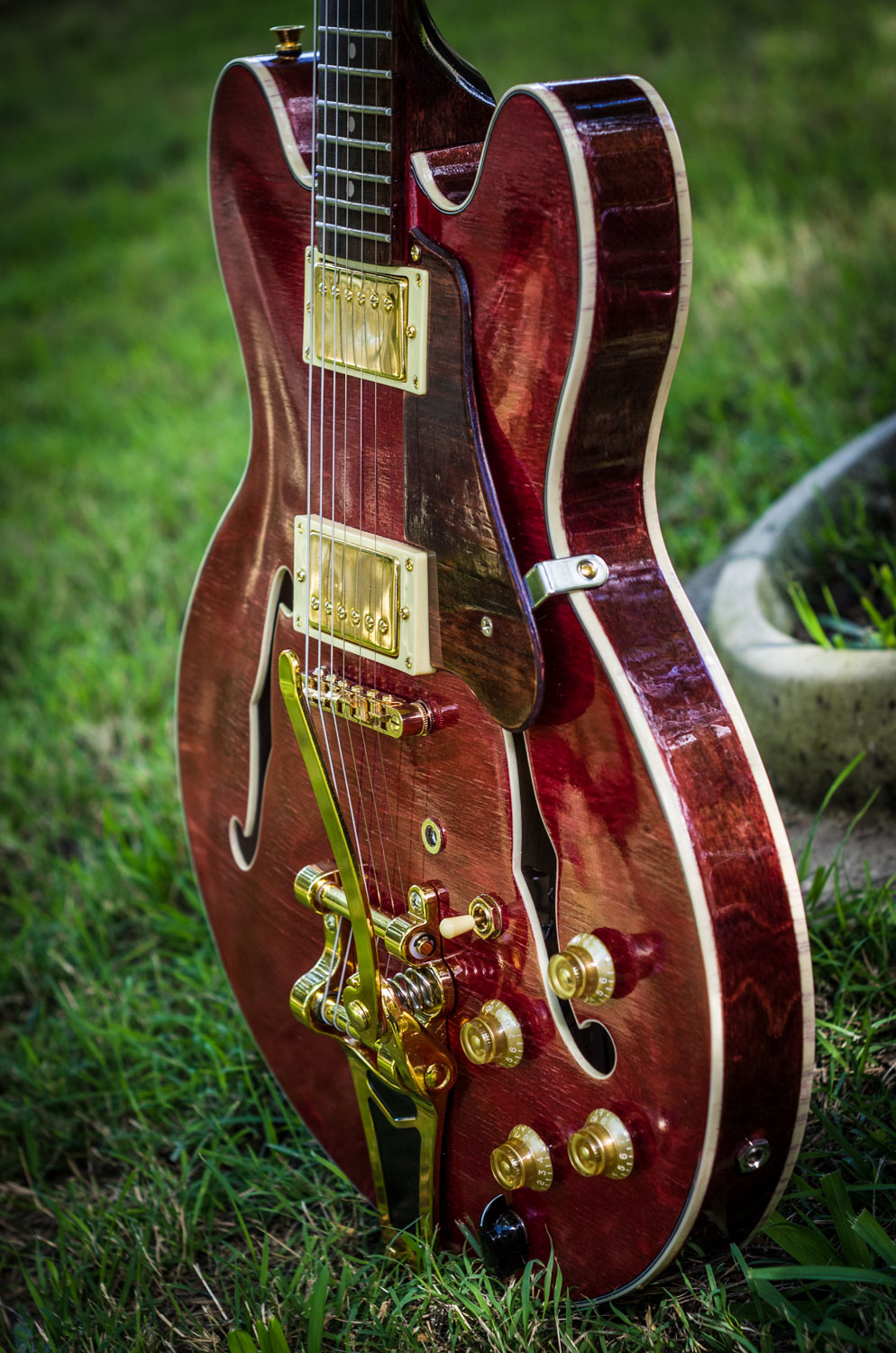

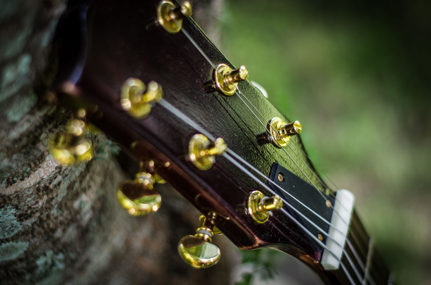

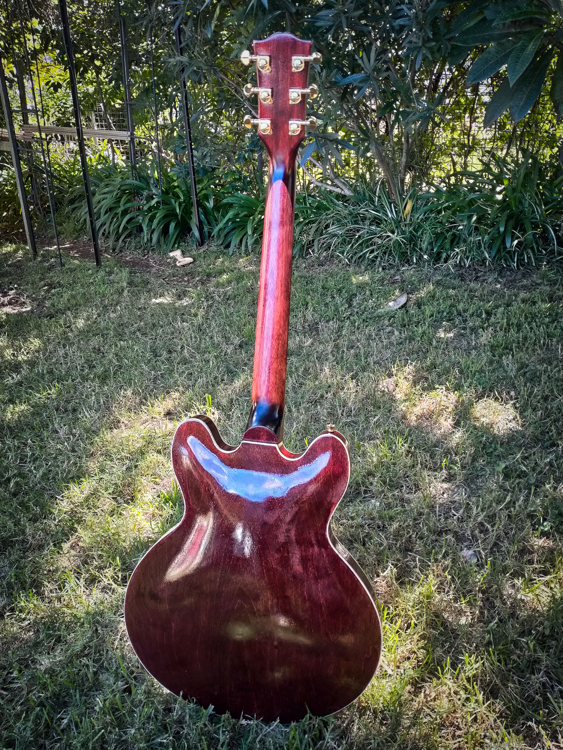

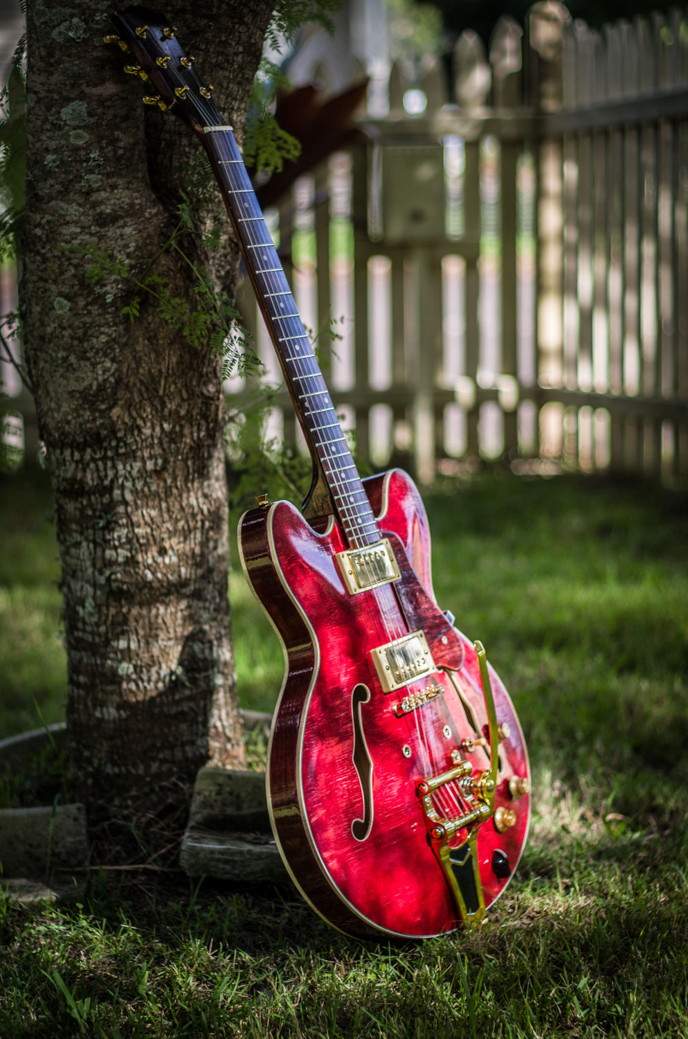

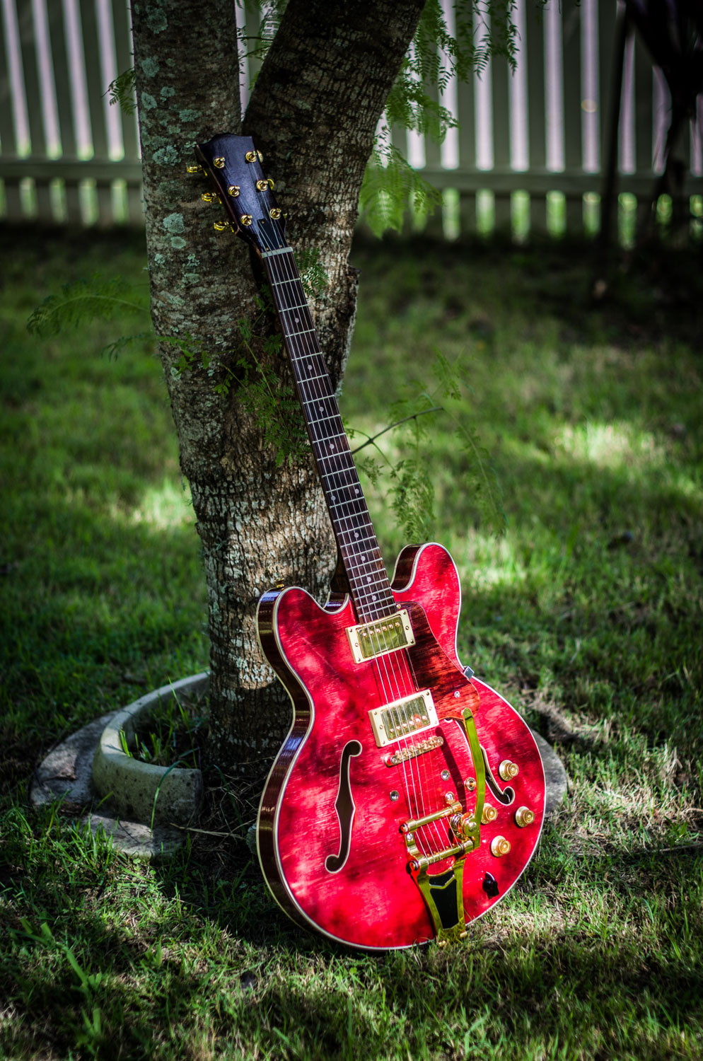

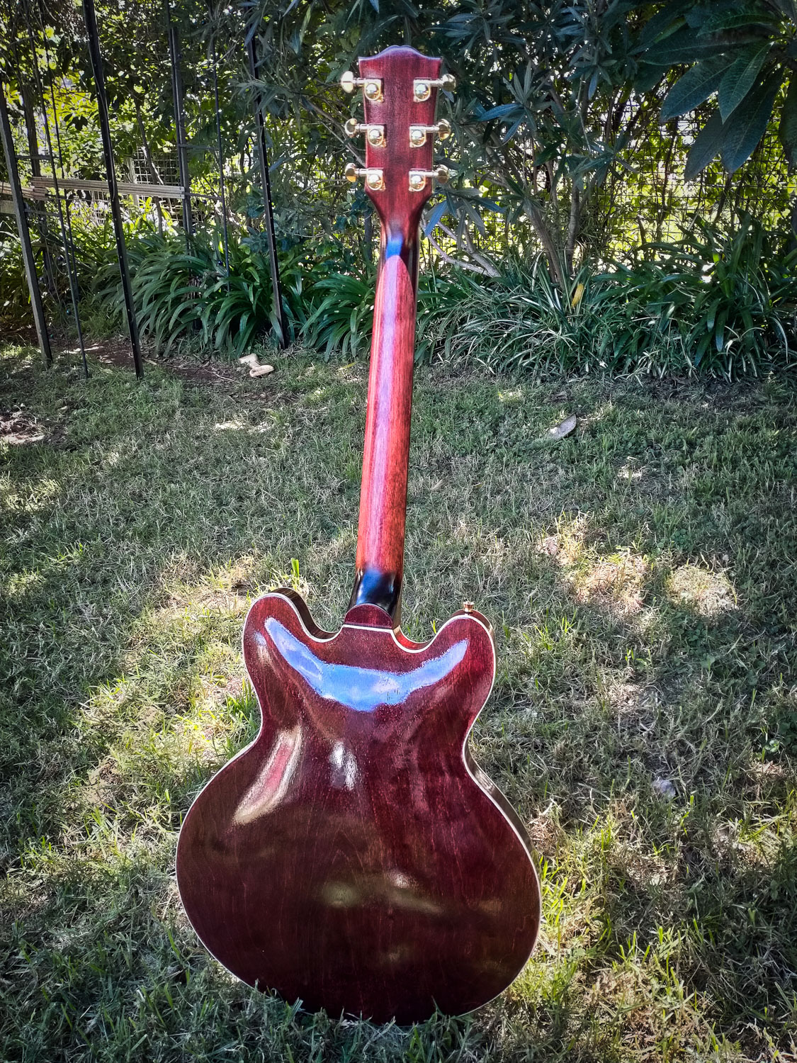

    Here is my submission - an ES1-F kit that was a 30th birthday present from my wife, parents and in-laws.
    The body top has been stripped of the flame veneer, with a cherry red/black blend of Colortone. The rest of the guitar (including the pickguard) has a diluted mahogany/wanut blend using Feast Watson prooftint. The top coat is Cabots Exterior clear gloss, with the neck and fretboard dulled to a satin finish for smoother playing. The pickguard is 3mm plywood.
    Upgraded/custom hardware includes Grover mini locking tuners, bone nut, Bigsby B700, Alpha full-size pots, switchcraft output jack, terminal blocks in the pickup cavities (for easy pickup changes), shielded wiring and a custom 3-way rotary selector, switching between bright, full and mellow tones.

    DrJackalope's TL-12:
    The 12 string paddle on a TL always messes with my head, but in a good way. Great natural looking top of the body that works well with the contrast of the back. Interesting mix of gold and black hardware that suits the overall natural wood grain really nicely. Way better than I would have expected. Nice choices for hardware and upgrades. I really like it.
    Nicely done – not a great fan of the 12 string headstock, but you’ve made it all work together nicely. Classic choices of colour highlight the grain rather than hide it. Nicely done. Would be nice to see a logo somewhere.
    Thigg88's TL-1A:
    The subtle colour with the visible grain works really well with the classic TL deluxe style and black plastics. It looks clean, classic and something you'd want to pick up everyday and play. Very nice.
    Nice and clean colour choice – the result speaks for itself. Classy guitar that would not be out of place in anyone’s collection.
    kman43's ES1-F :
    I love the colours on the top and back, and great result from removing the flame top. Gold hardware look spectacular and highlights the excellent choice of upgrades. Headstock face isn't as smooth as I expected, but great overall look. Well done.
    Spectacular finish – love the level of gloss. Great work. Only real detractor is the headstock and lack of a logo.

    OK - just a winner this month - and that is:kman43's ES1-F - great job and nicely done!
