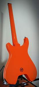

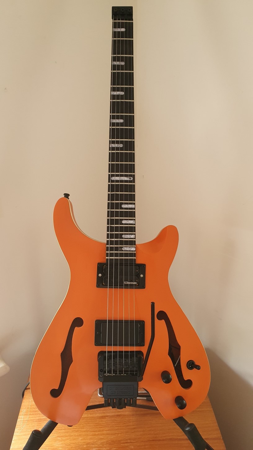

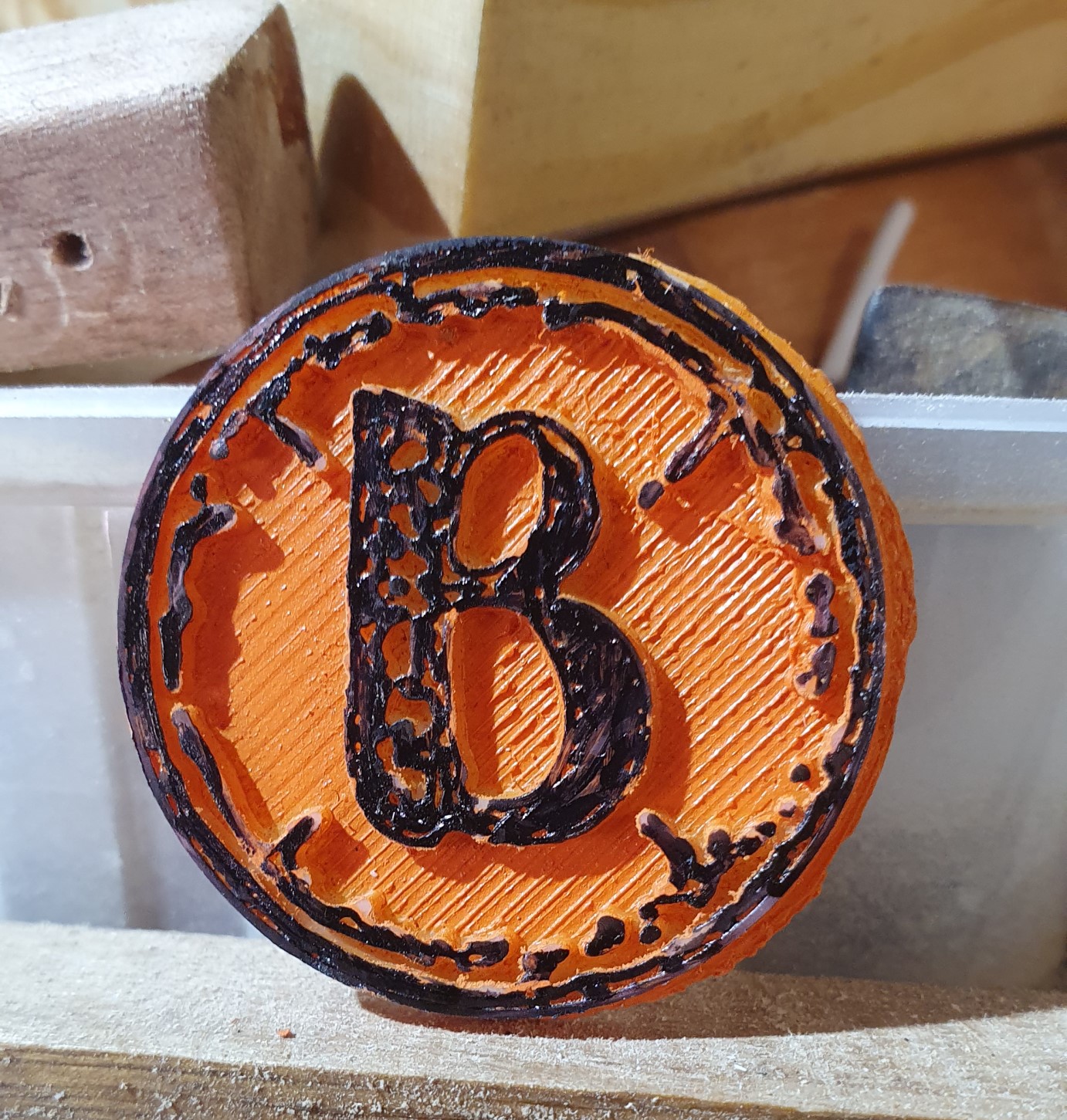

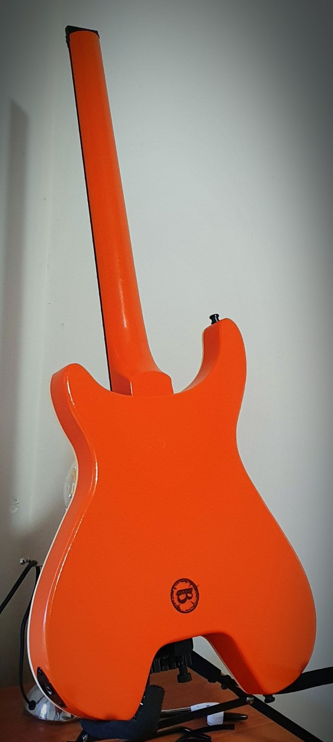

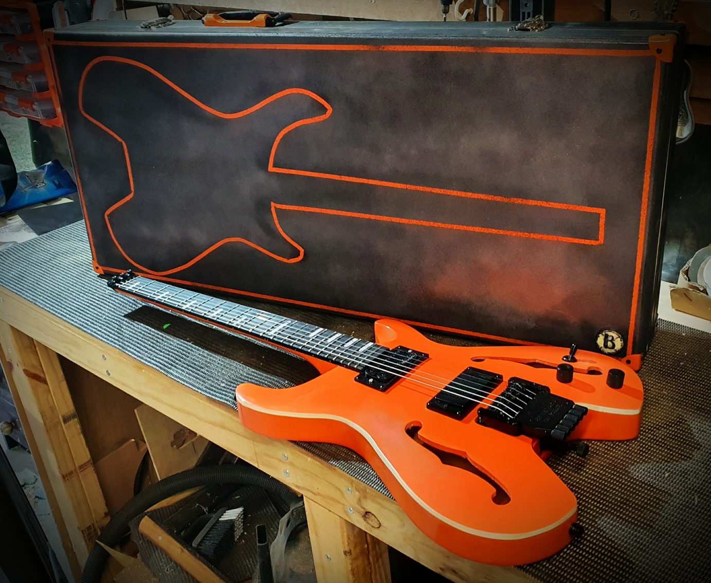

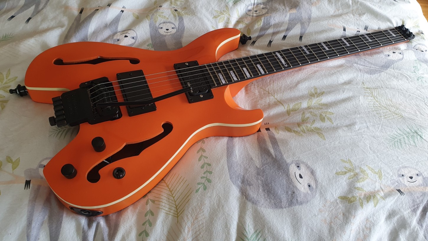

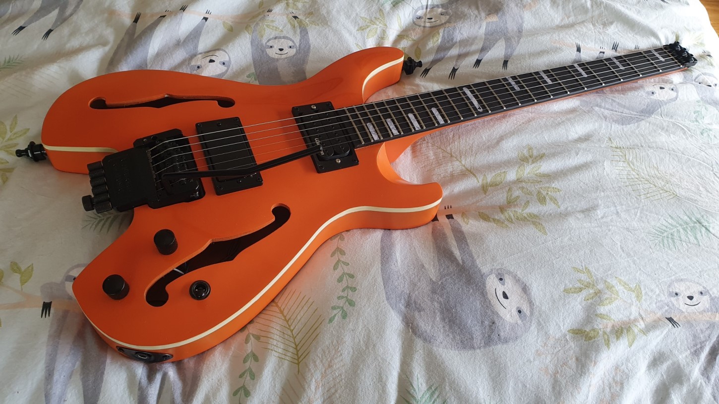

    Here is my entry for this month.
    GHQ-1
    – FACTORY SECOND
    Mahogany semi-hollow body with F Holes and single ply cream binding
    Headless Mahogany set neck with Ebony fret board
    22 frets 25.5″ Scale length
    Dual Humbucker pick ups, The neck is a high output Warman unit, bridge is stock.
    Volume and tone knobs and 3 way switch
    Double locking bridge

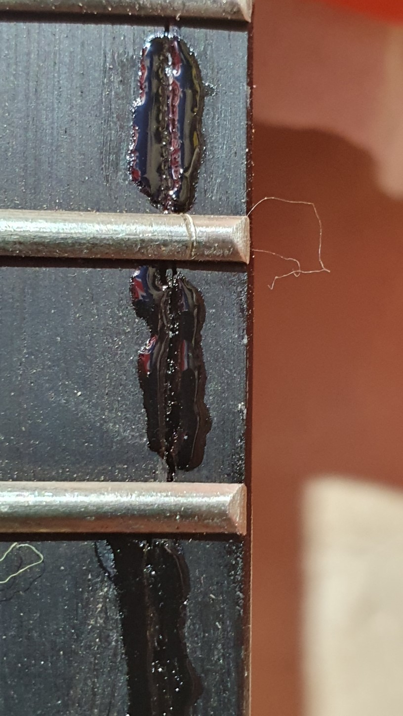

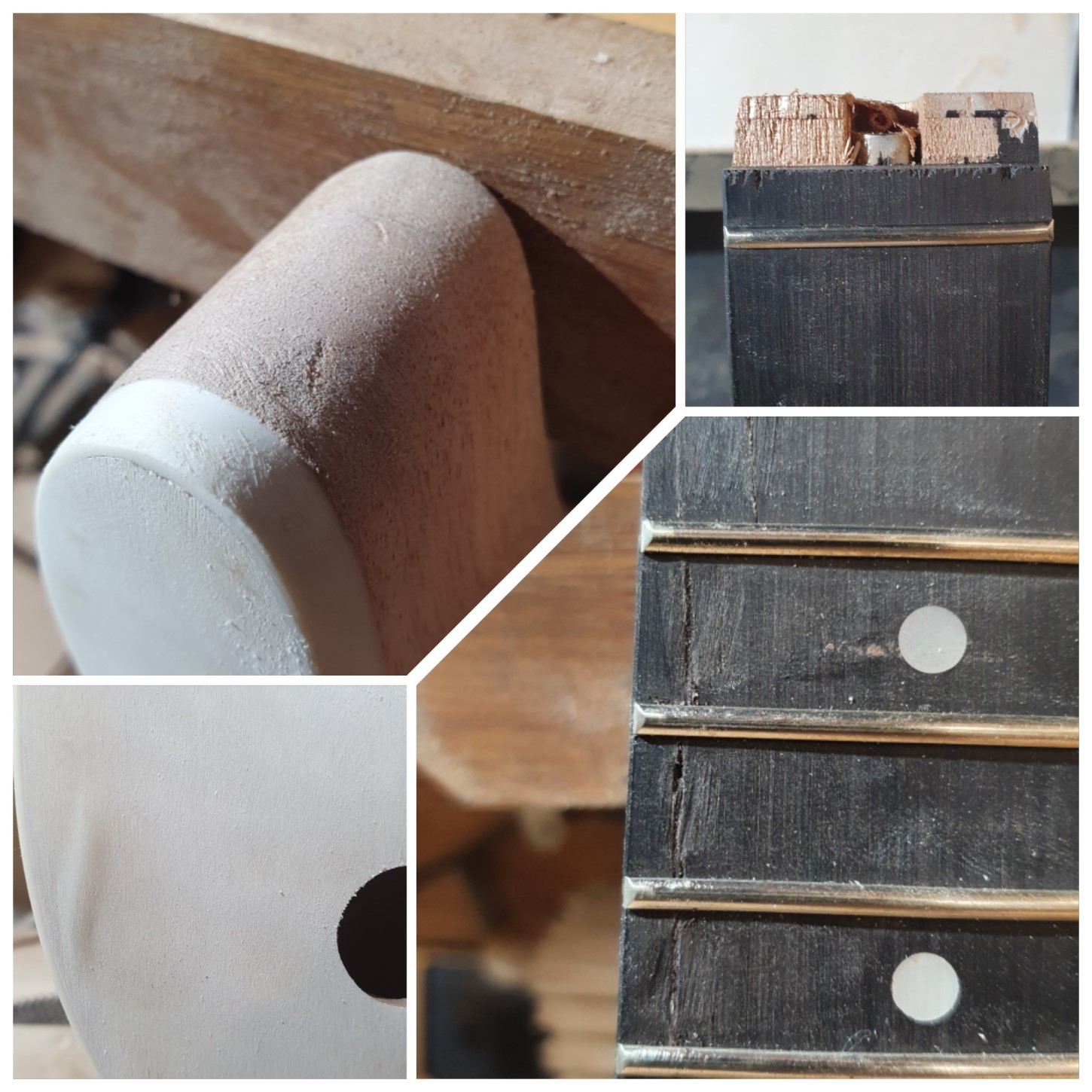

    I had been watching this kit for a few months as it had just sat on the seconds page unloved. I have wanted to do a headless for ages and the price i got was just the push i needed.

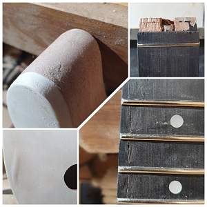

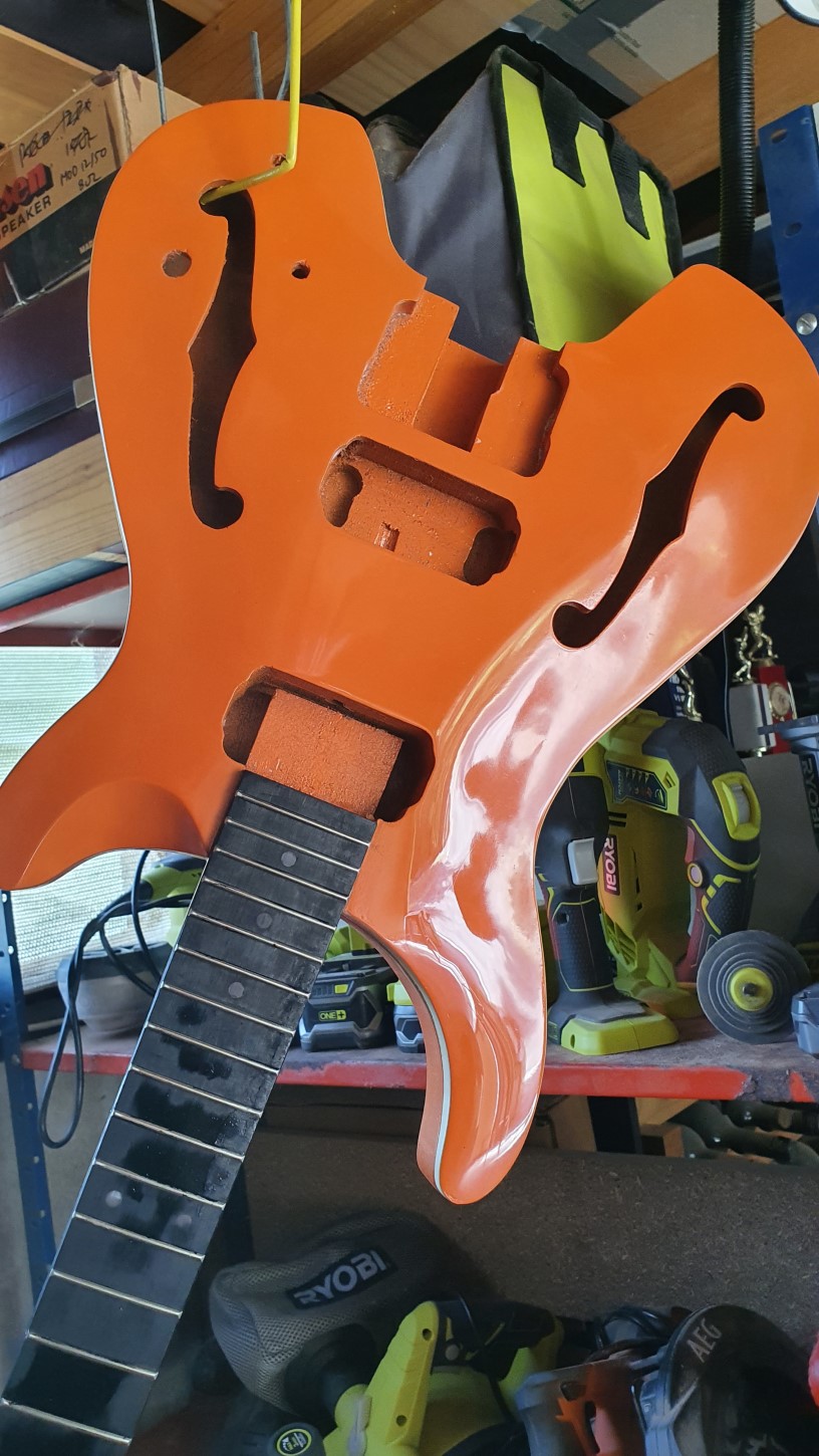

    This kit came with some significant issue to overcome. The Fret board damage was the first part and the veneer was in a pretty poor state. A bubble, several chips, dents and lots of glue issues. (I knew all this before i ordered).
    Just in case the veneer was salvageable i did stain it to see if it could be rescued. Lets just say it didn't look good.
    My choice was always to do a solid finish and the veneer made a nice flat (Once I has sanded it) surface to start on.
    I laid several coats of primer, sanded then used Venus Orange followed by the gloss top coats.
    To repair the fret board i sanded back the affected areas and kept the dust to mix with super glue. Some fine sanding and careful Dremel work and you can barely see the damage. To finish the look I have added some interesting fret markers as well.
    The zero fret was also an issue but i had a plan for that as well. I was getting buzz and tuning issues as the string were not in contact with the fret.. It is strung with a 7 string set from the top down. Effectively a 7 without the high E. It is tuned to B standard and it is a beast.

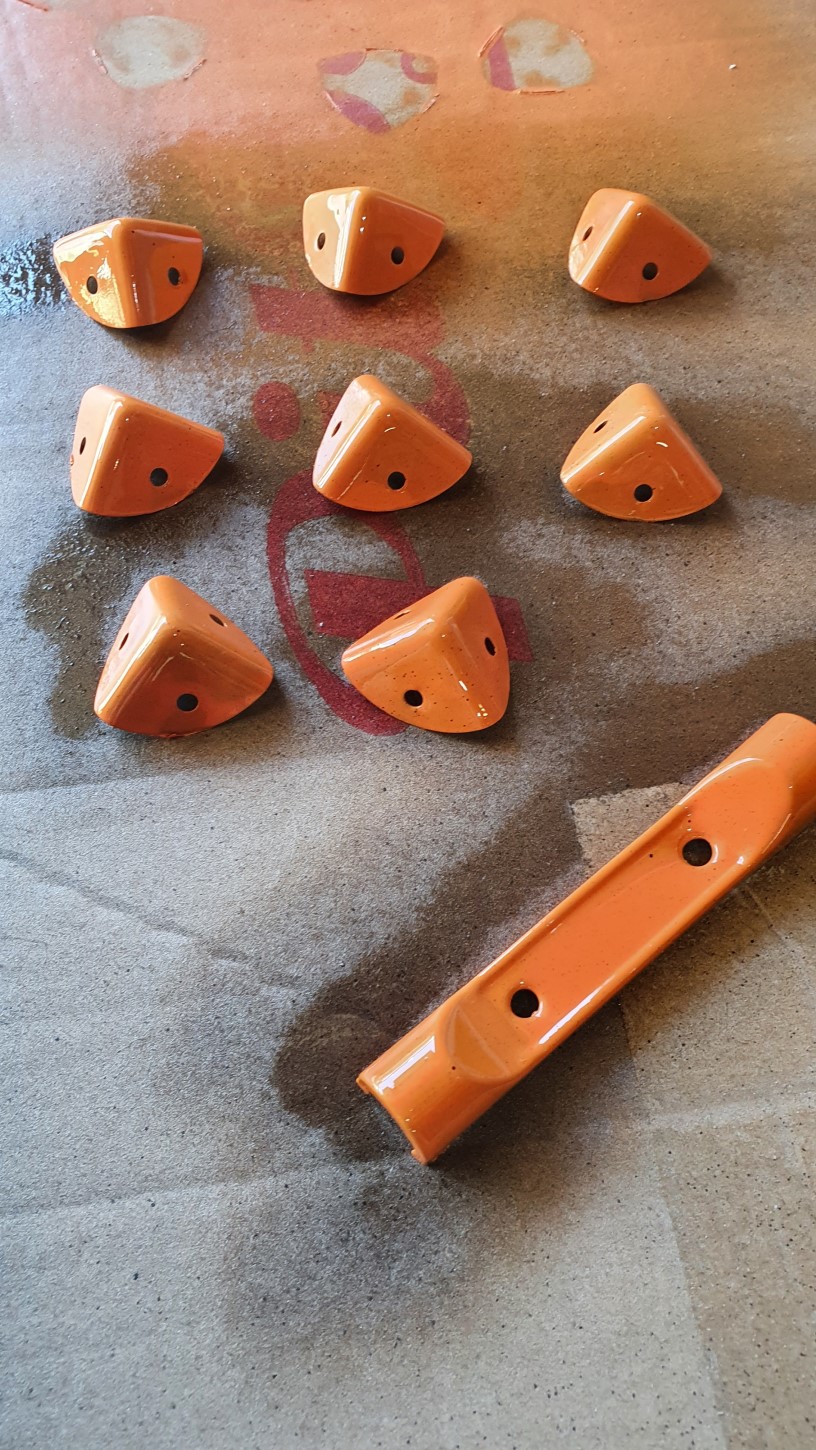

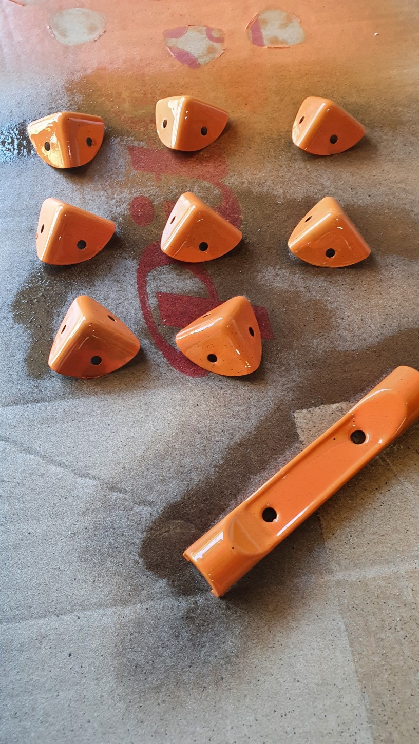

    To compliment the guitar I have also made a carry case utilizing the left over orange paint and some car painters tape.

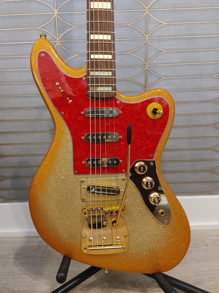

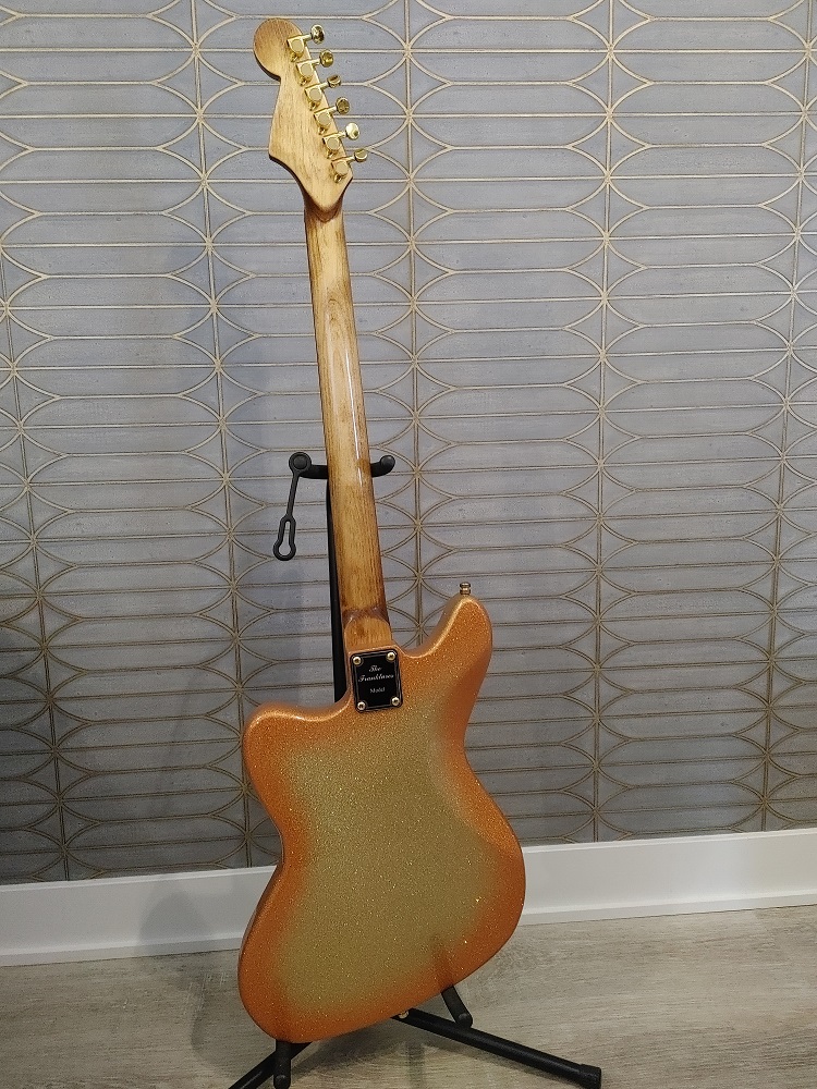

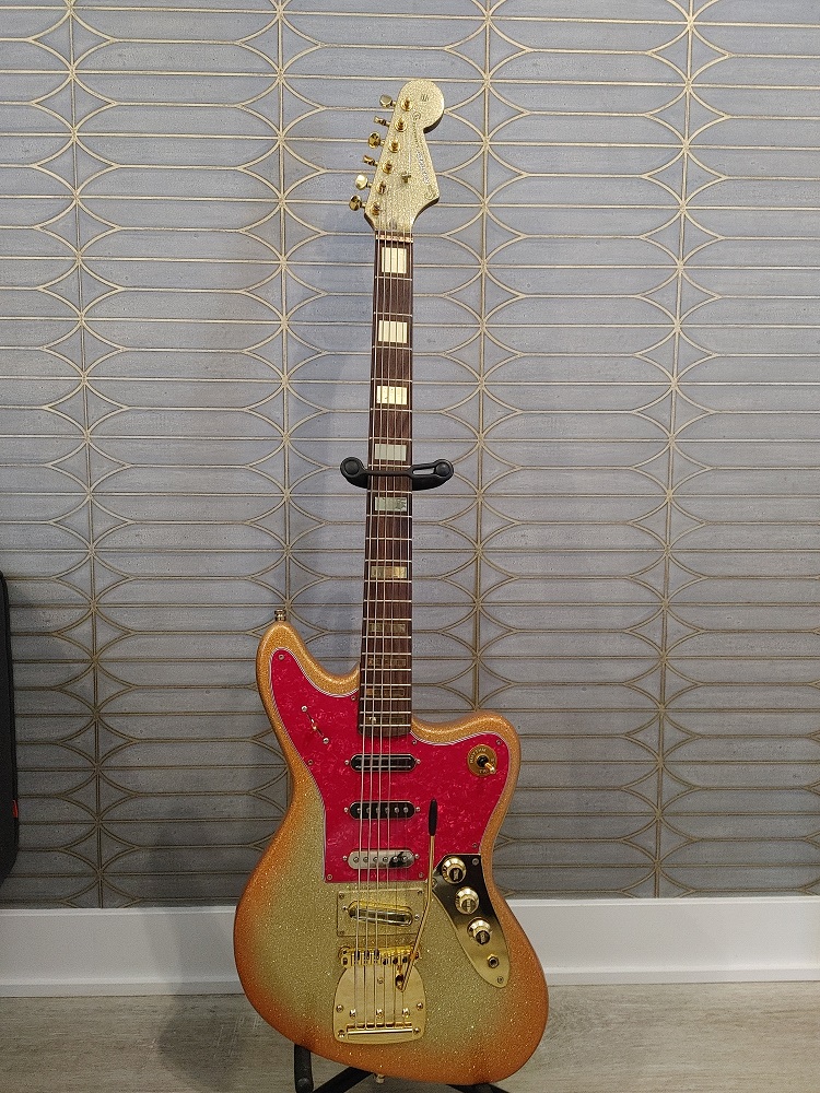

    JZ-6 modified kit
    My latest project

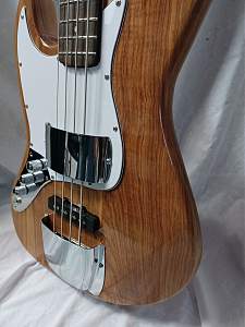

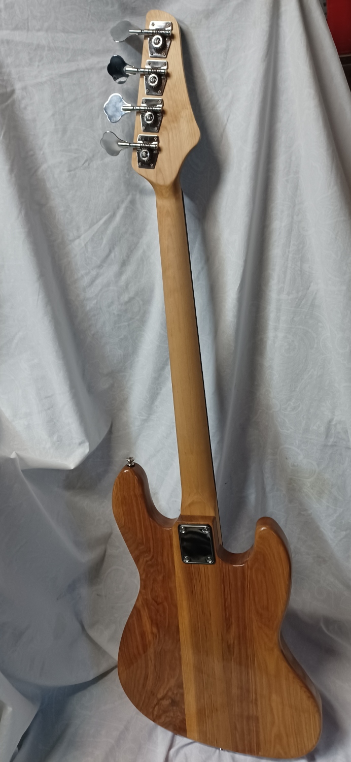

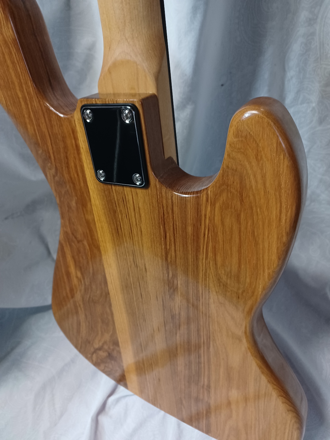

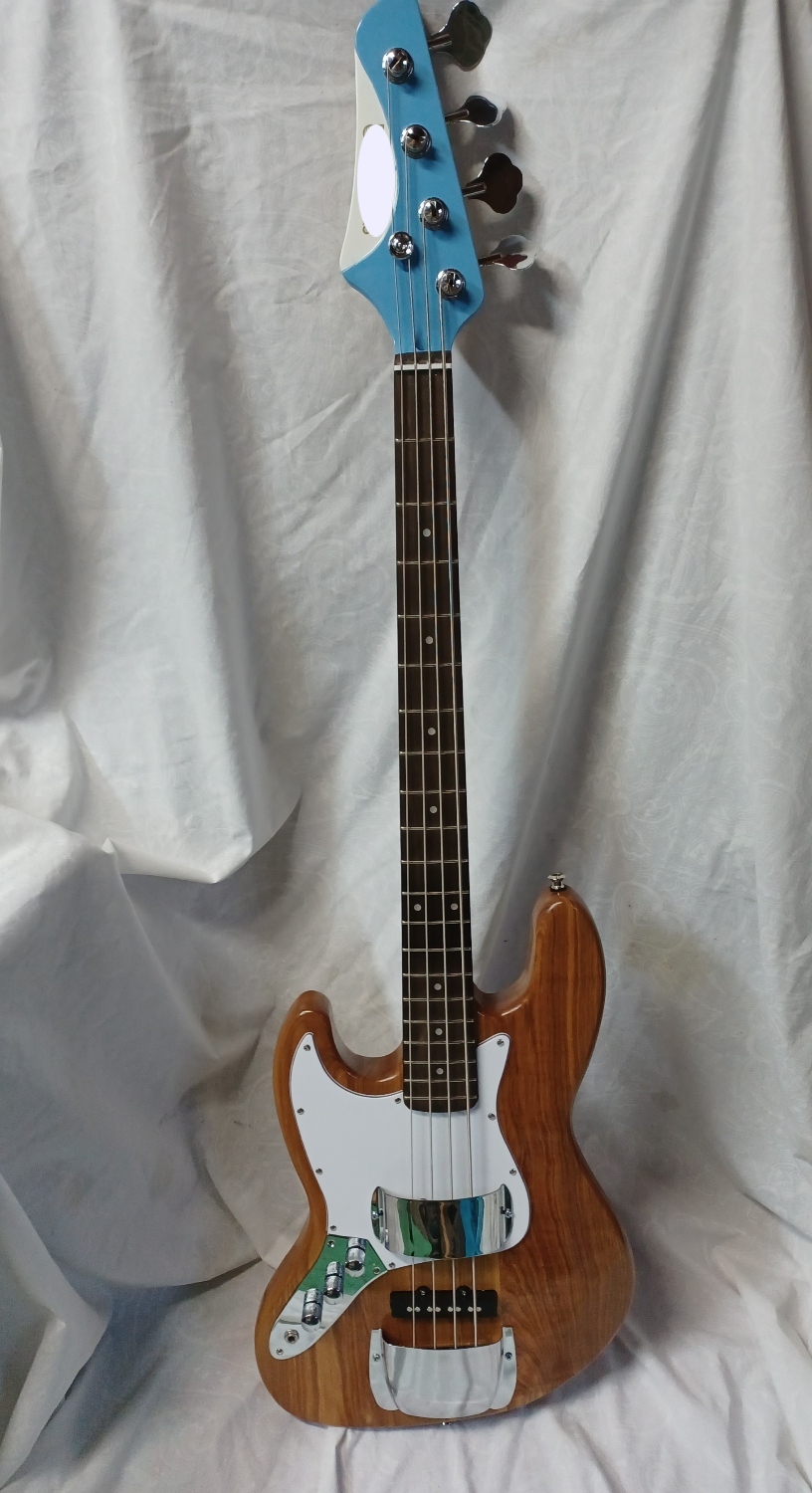

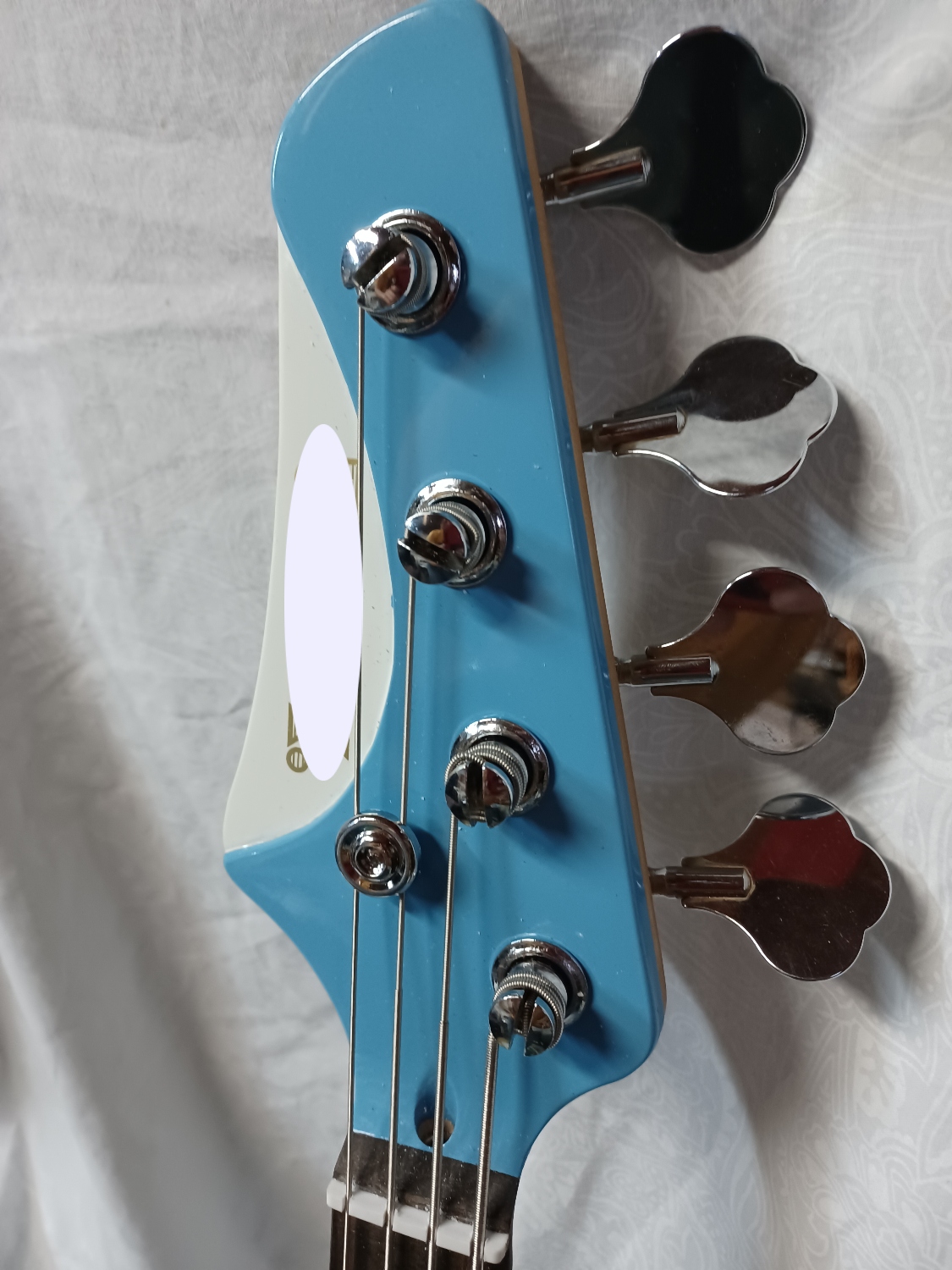

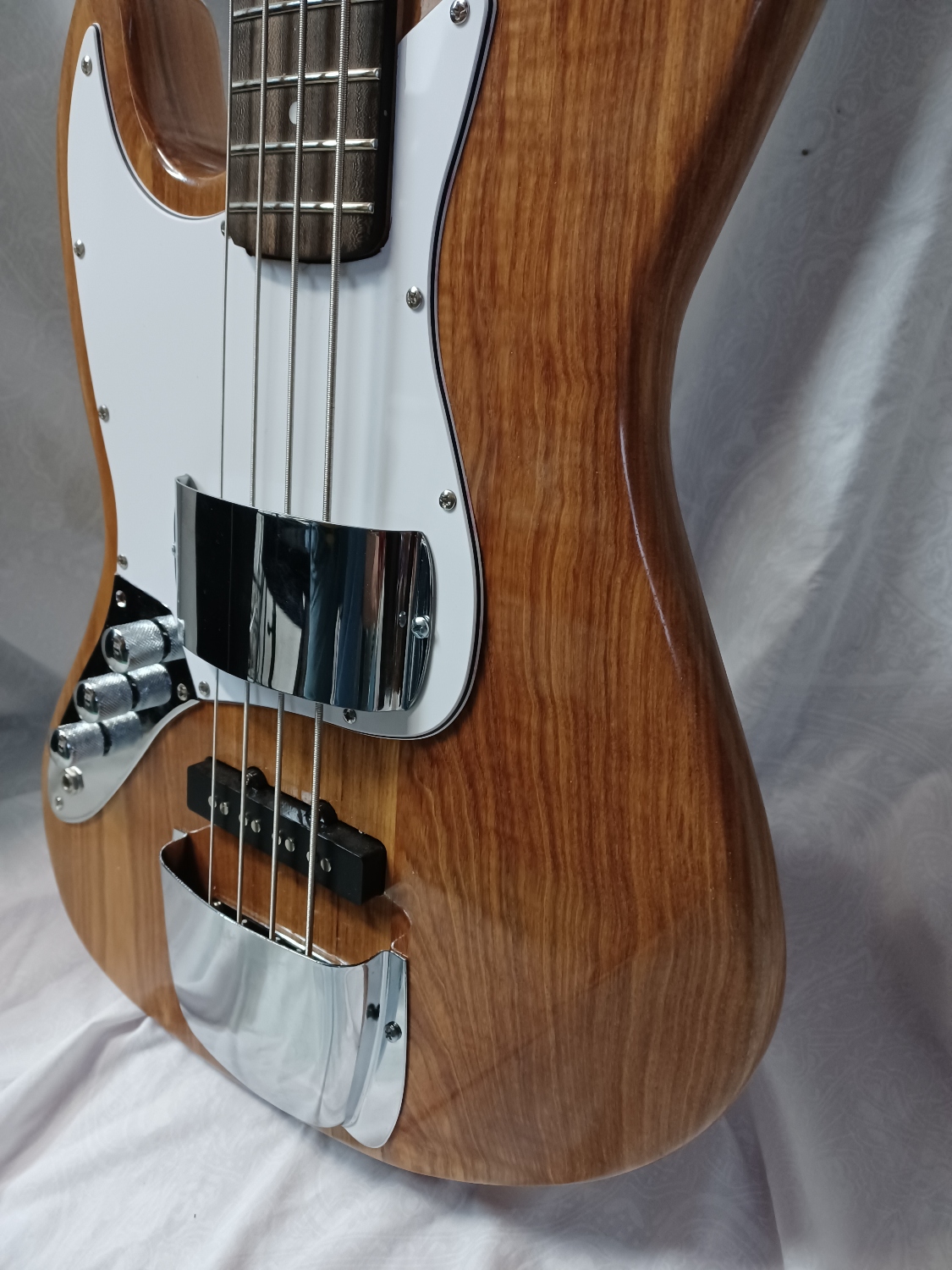

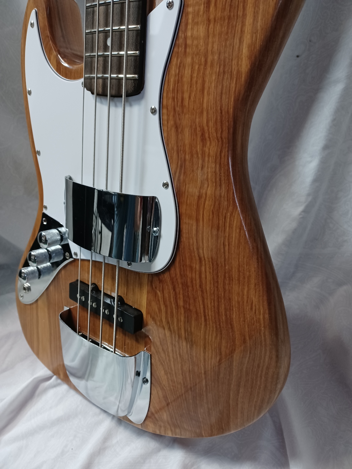

    Greetings! This is my first build and I think it came out decently, although I admit that it's a crude attempt compared to some of the other guitars I see on this site. I play a lot of surf rock and I thought it would be fun to give the kit a bit of a nostalgic vibe. It was a fun project and I learned a lot to be sure!
    Kit JBA-4L Swamp Ash Body
    Finish: Body -natural boiled linseed oil with Polyurethane clear coat
    Head stock: Enamel two-tone (decal was from a defunct brand but I covered it for forum rules)
    Modifications: Minimal. Replaced kit screws with better quality hardware, installed Fender style ashtray bridge cover, Ernie Ball Super Slinky strings.
    The kit went together fairly straightforward. My only note is that next time I will not go with a natural finish on swamp ash because the pores are very deep and nearly impossible to fill via slurry sanding and poly coat. If I do a swam ash natural in the future I will go for a more rustic finish and spotlight the deep grains instead of fighting them. I have a bit more smoothing to do on the back of the neck to get it silky but it's coming along nicely- I think 2 more coats of BLO applied with steel wool should do the trick.
    It's a wonderful playing guitar. Heavy because it's hardwood, but it's got a really powerful sound and the neck is just right for how I like to play.
    Sorry for the photo quality, my photography skills are as poor as my building and playing

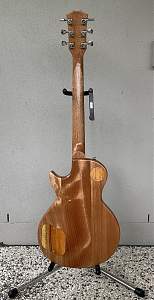

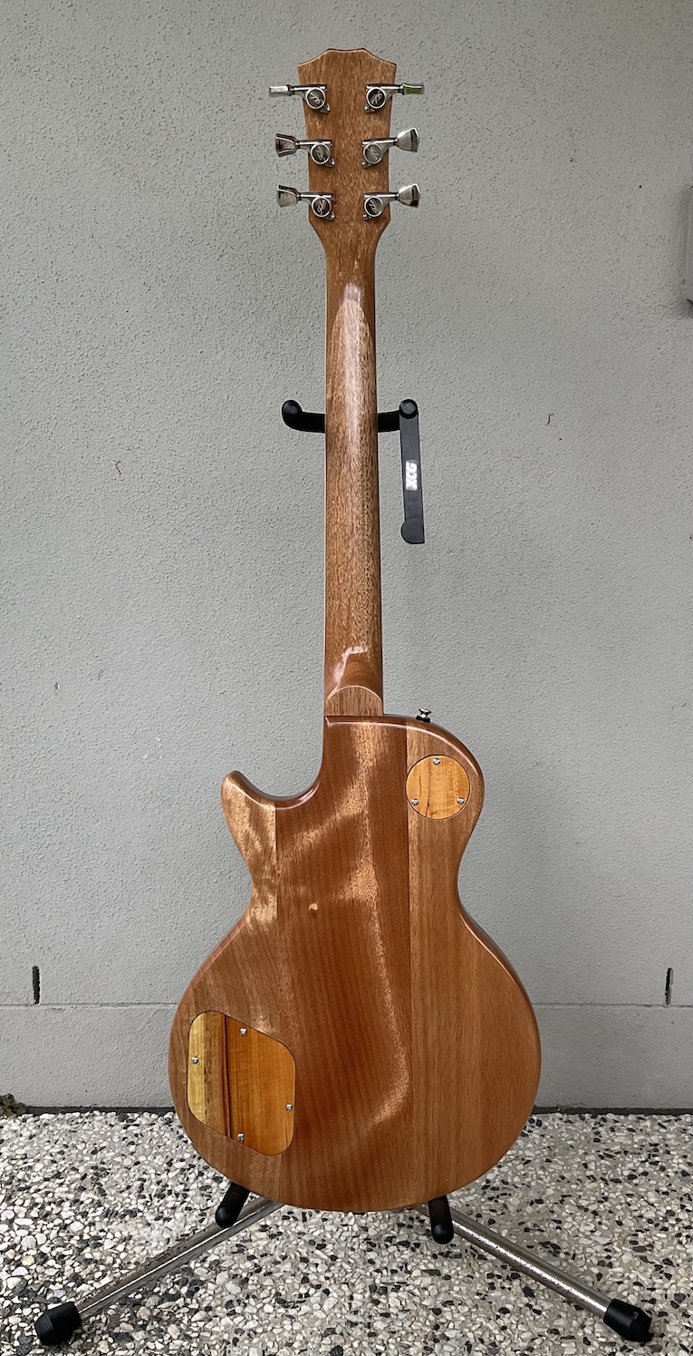

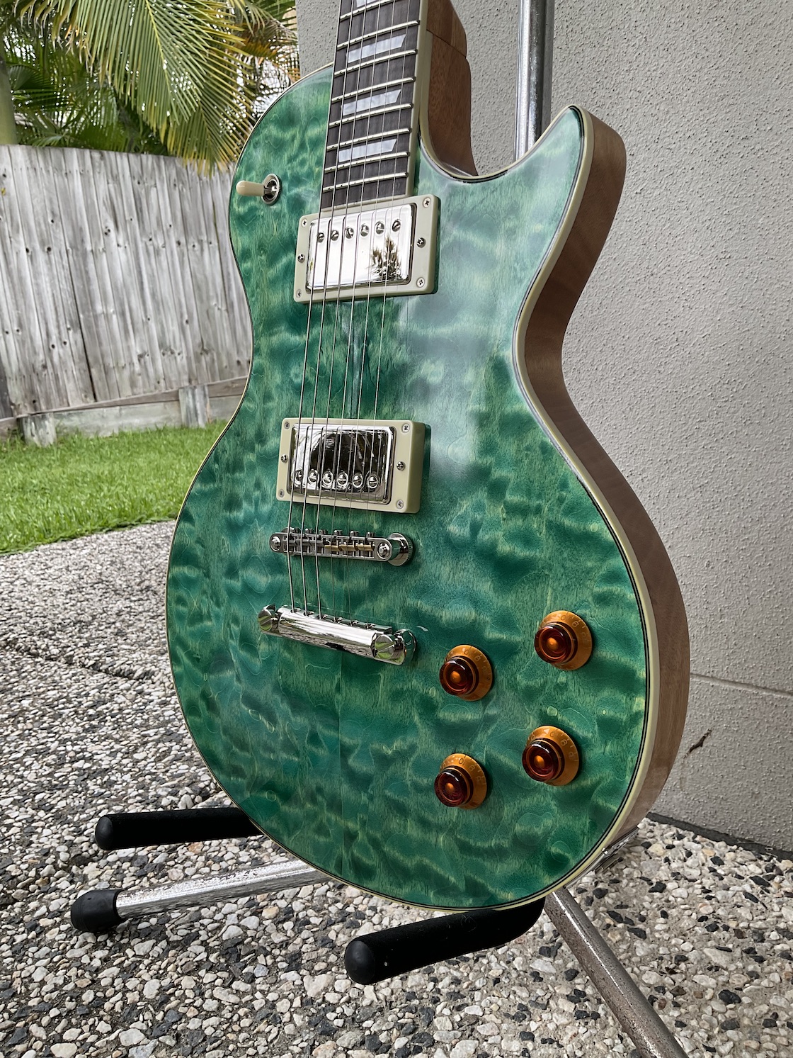

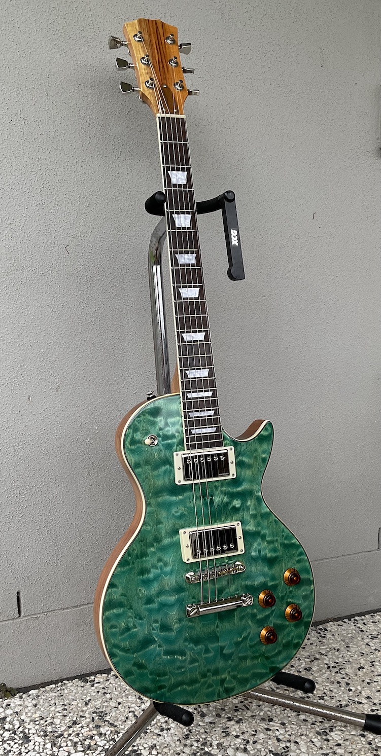

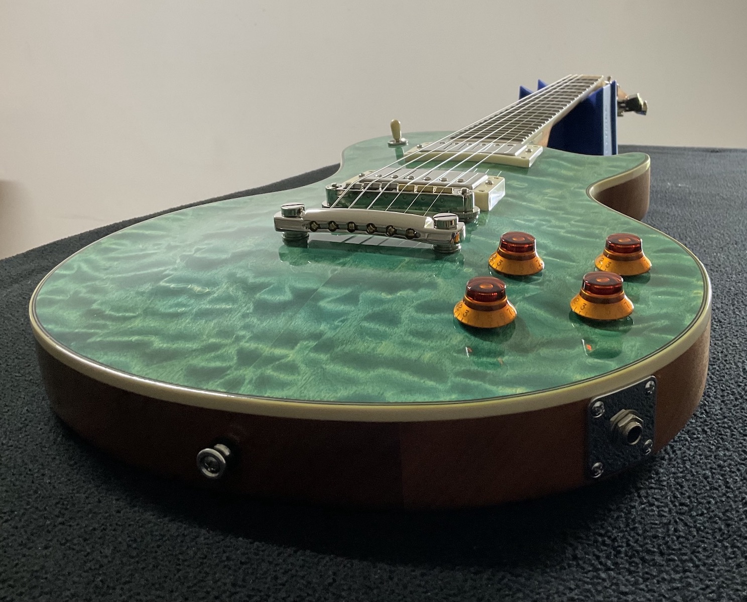

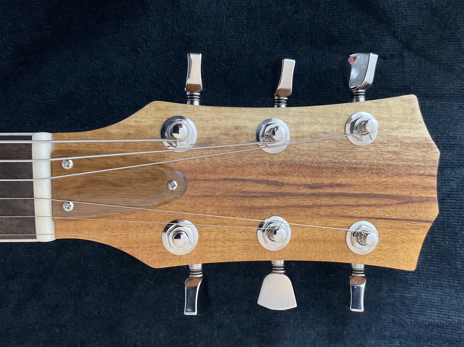

    Here’s my entry for April GOTM….
    This was my first build and I really enjoyed the process. The project was great as a switch off from busy work/family life so I was in no hurry to get it finished. I took my time over every step doing the best possible job I could taking no shortcuts and I’m very pleased with the finished results.
    As a well seasoned player with a fair bit of experience of fretwork and set ups, my priorities for this build were tone and playability over looks, but obviously I also wanted a great looking guitar so I still spent plenty of time on the finish.
    I prefer a taller fret wire than the wire that came with the kit so before I set the neck I took the time to do a refret. I used Jescar 55090 fret wire which has the same dimensions as Dunlop 6105. I’m really pleased with the results, it feels and plays great, really nice for bending.
    I fancied a pretty headstock veneer as opposed to a decal. I was very fortunate to source a local piece of Red Ash veneer with beautiful figuring and contrasting sapwood and heartwood for the headstock. I had enough of this veneer left over to make the control cavity covers for the back of the guitar. I also made the truss rod cover from a piece of Ironbark Eucalypt which was also from a local source.
    I choose the LP style kit as I wanted a nice humbucker equiped guitar as an alternative to the strats I usually play. I upgraded all the components and hardware from the kit, infact the only parts of the original kit I used were the body and neck. Here’s a list of the upgrades I made….
    Lollar Imperial pickups
    Faber Germany bridge, tailpiece and locking tuners
    Montreux pick up rings
    Switchcraft jack socket and switch
    CTS pots with .22 orange drops
    Bone Nut
    Finished with Crimson Stains and lots of Tru-oil
    Thanks for reading, any feedback would be appreciated.
