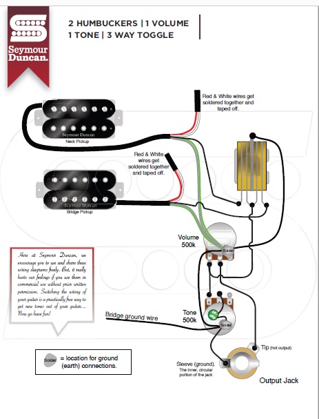

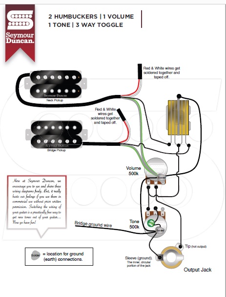

    Here is a Seymour Duncan diagram for your configuration:
Name:	2H_1V_1T 3w tgl..jpg
    Just be aware that the SD wire colours are different from Dimarzio (SD: positive = black, DMZ: positive = red). Just follow the same signal paths and you'll be right.
    Also note that the diagram shows a different 3-way switch, but the connections follow the same as the import box toggle type.
