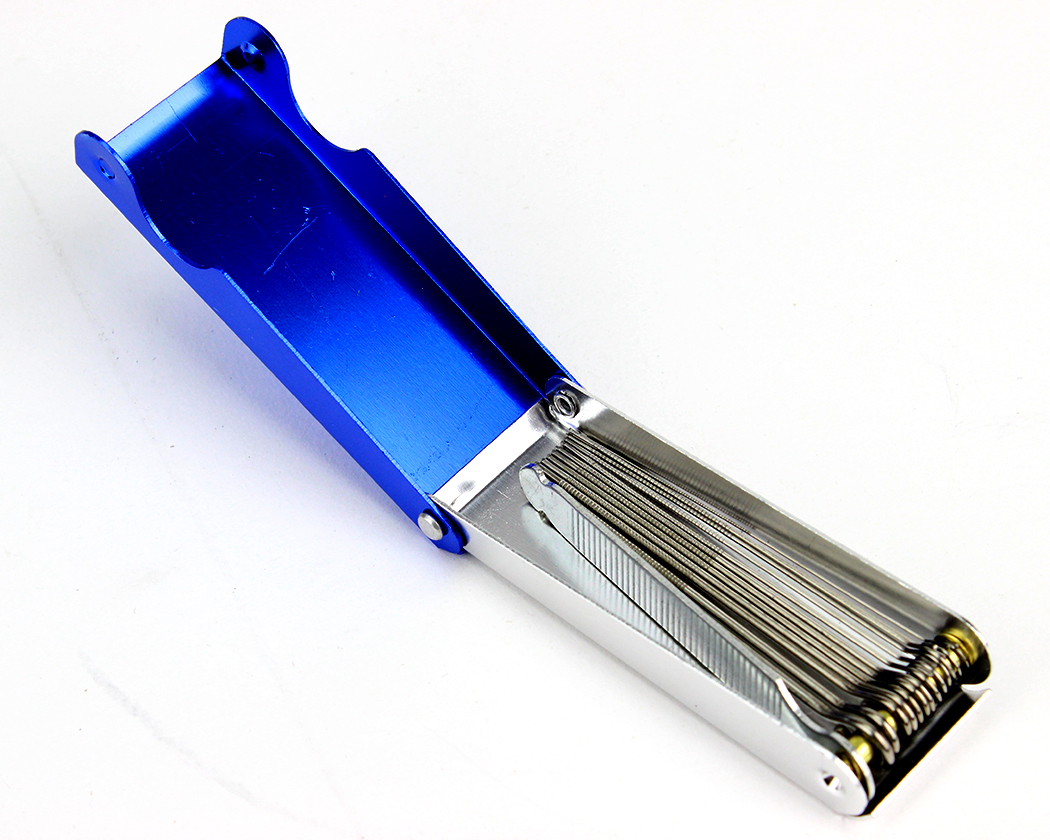

    So I've got a bone bridge that I swapped onto my tele, and it needs the slots to come down by a good amount, maybe 0.5 to 0.8 of a mm.
    I bought one of these nut file sets.
    Working on the low E for some time, and while I can see some dust after a minute or two of filing there has been almost zero change to the depth.
    Do I just need to spend 15-20 minutes per slot, or do I have a dud set of files? Or do they just not work well for bone?
    I'd prefer a flat file set like these at stewmac, but I can't really justify the expense..

    After a small amount of research I've disovered these "nut file sets" are essentially repurposed welding tip cleaners. I think I might spring for a proper guaged file set for my next build.
    Yes, I've never tried the tip cleaners, but I remember them from high school metal shop! I can't imagine trying to cut a nut with them.

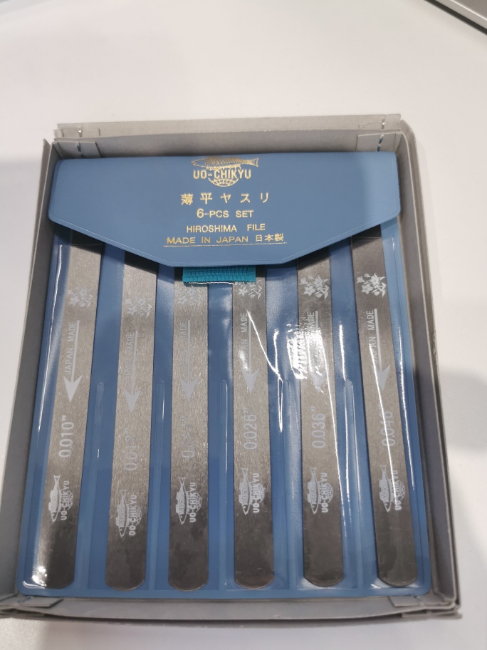

    I just had a look at the StewMac ones and the Uo-Chikyu Hiroshima ones work out cheaper with free shipping.
    I bought a set at Bunnings and gave them a go. They will cut but it is very slow going and you need to push the tip cleaner down over the nut with your finger. They will do to get you out of trouble but that's it.

    FWIW, Hosco make these that a bit more affordable. They are the V shape ones, which I personally don't like, but that's just me.
    There are different schools of thought on whether the sides of the slot (angled like a V or vertical like a U) even matter because no more than 50% of the string circumference should be making contact with the nut anyway, and I'll point out that the Hosco files don't have a sharp bottom exactly like the letter V, they do have a radiused bottom cutting edge (.010" - .046") but the sides are pitched, creating a "V-like" slot.
    I know the files I linked are currently out of stock, but I posted them as an example of a slightly more affordable alternative to search for.

    I am sure that the best option is to buy a good set of nut files. I definitely want them, but just don't feel like I can justify the expense if there is a cheaper way of doing things reasonably well. I have heard too many horror stories about cheap nut files to think they are even worth a try. So here's what I have been doing...
    I do use tip cleaners, but only on bass nuts. Anything much smaller than the G string, and those little rods flex too much for my taste. They work reasonably well for bass, though.

    FWIW, on a bass, I actually really like the tip cleaners. They are slow...but I am by nature somewhat imprecise, so the slowness is a protective factor. Also, with size and proclivity of bass strings to buzz, it's nice to have a cutting device that puts a nice round-bottom slot in the nut. Again, I don't know how much this matters, but for bass the tip cleaners work about as well as the feeler gauges work on guitar nuts in my experience.
