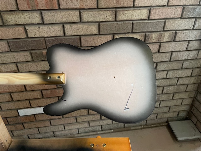

    Some cooler weather in Perth today, so I have practiced spraying a burst. It is Cabot's w/b Stain and Clear Poly, Gloss with black stain. Besides being a bit thinner than the straight poly, it has gone on OK.
    I practiced on a chipboard cutout first (the white body), and then tried it on the blue tele. I do need more practice, but pleased with my first go!

    Geez! If that's an early effort, I can't wait to see what it looks like once you've practiced! I have always loved a blue burst.
    I am also impressed by your attention to detail. Even your turning stick is a work of art. There's a curve on the back side, another on the front and lovely countersunk screws. All of mine look like they were made by a dyslexic third-grader.
    (BTW, I am not casting aspersions on dyslexic people or third-graders. I was, once, a dyslexic third-grader. My jigs were no prettier then either.)

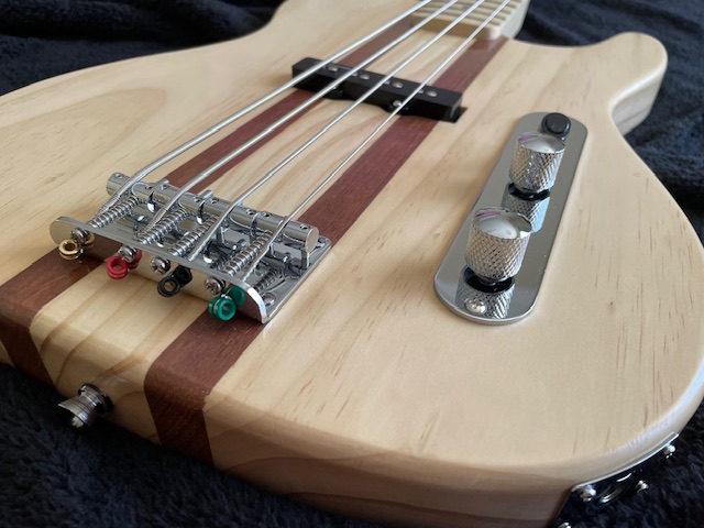

    I have now completed the pine with jarrah strips tele bass.
    Wet sanded the body with 1200 to 2000g.
    Polished the body with Kustom Creations Kustom Grit step 1 (cutting compound) by hand, and step 2 using a Random Orbital Polisher and micro-fibre pad. I then applied Maguire’s Scratch X with the Polisher and micro-fibre cloth.
    Added the neck.
    Soldered and added the electronics electronics (though I still need to get a capacitor to try Wierdbits wiring diagram (from https://www.buildyourownguitar.com.a...l=1#post202915).
    The pup is an Entwistle Jazz neck.
    Strings and setup also completed.

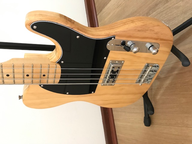

    Interesting to notice how different the finishes are on the Tru-oiled pine tele versus the Cabot's water based poly on the pine. The Tru-oil definitely adds an amber tint.

    I used a water based finish (General Finishes High Performance) on my hybrid bass and got similar results. It added almost no color. Worked well mixing with a solid daphne-ish blue. But I wanted a bit more amber on my p-bass project, so put some shellac under it. The good news (and bad news if you want a deeper color) is that water based finishes don't yellow at all, or very little. Shellac is some shade of amber to begin with but is stable. So, if you finish with shellac and/or water based, it should continue to look the same as it ages. Oil finishes tend to become deeper over time. I have a maple guitar neck that I bought, and put a light coat of oil-based finish in the late 1980s. It looked almost completely clear back then. It's now a deep amber. Lovely...unless that's not what you wanted ;-)
    But, one thing's for sure. The finishes look great on both...and good to have the contrast in your collection.
    I am curious what you are doing with the switch? I tried clicking on the link, but it didn't work. Is it like the Esquire tone circuit? I can see that with the J pickup. Did you do the same with both? or did you do a coil split with with the
    Filtertron?
  10. #210
    1,726
    Thanks Rabbit and Fender3x.
    @Fender3x: I fixed the link which is to Wierdbits "3 way import with high cut". ATM the pine bass with the humbucker uses the switch as a kill switch only. Maybe I could try the coil split!
