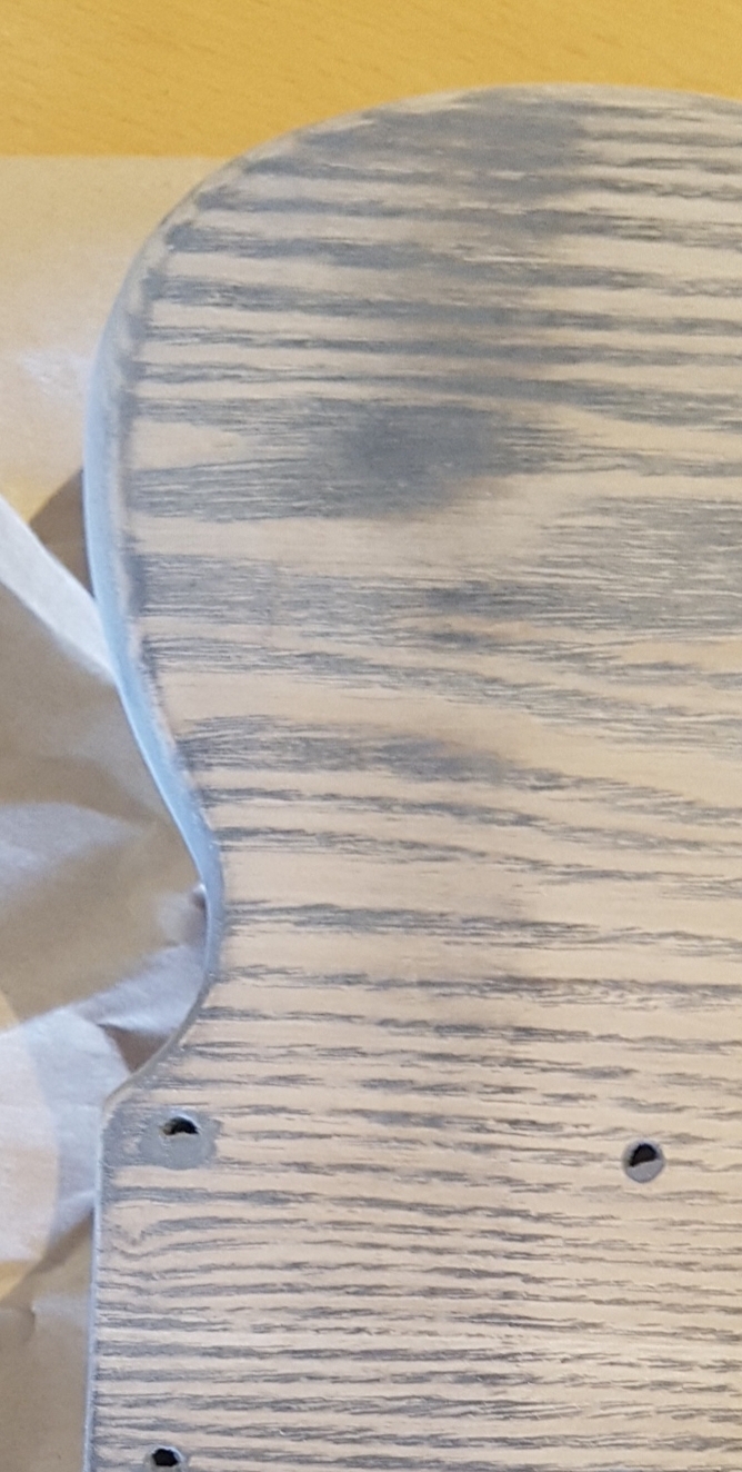

    Hi all
    What am I dealing with here? This obvious straight line won't disappear.
    This is the second application of ebony timbermate. I've tried sanding with 240 grit but this is not showing any signs of moving.
    Thoughts, please?
    I would theorise that you potentially have a very slight hollow across there, almost as if that blank has been run through a planer or barrel style sander and it has "Nipped" slightly at that point. This would allow more timber mate to sit in it giving you the darker line.
    Are you machine sanding or hand sanding with a flat block?

    Thanks for the reply.
    I'm hand sanding with a cork block and the 240. And I've been going along the grain and not in the direction that this line is going.
    There doesn't seem to be an obvious edge to "bite" into. If the answer is "more hand-sanding" then I'm prepared to do that

    I would have a look by putting a ruler across. If you can't really see a dip, you can also try to start the ruler in what Frankenwashie theorised a dip so it might start to 'wonk'. If so, more sanding...

    Okay, being a relatively low cost kit, sometimes the planes on each of the body surfaces is not totally "Flat". Often you only find this out one you've started with a colour or timber mate etc.
    On the kits I've built, and the scratch bodies I have made, before I get to colour, I tend to get a flat piece of MDF or a sanding beam that will go the full width of the body. I use 120 grit on the block, and give it a rough sand, then scribble a pencil across the surface until I've got a mass of pencil lines covering the body. I then sand again for 3-4 four strokes, dust off and see if there are areas where the pencil lines haven't been removed.
    Where the pencil lines remain, it indicates a low spot. (Others do this with a dust coat of spray paint in a highly contrasting colour to get the same result). This will tell you if you need to continue the wide block/Beam sanding to get a truly flat surface. I continue this process until I can do my scribble and see it completely removed from the body. Then you flip and repeat on the other side (making sure to put something nice and soft under the now flat side!). once both faces are flat, I move up the grades to about 240-320 to get a good surface for paint or stain or timber mate etc.
    You need to be sure that your block/beam is straight and flat and won't bend or distort as you work. 19mm mdf or a 25mm straight piece of timber 50-75 mm wide should do. You need to work in one direction and dust off after every couple of strokes (Both the body and the
    sanding block/beam to prevent the paper clogging).

    I believe Frankie & RnR have identified the issue and given you good advice.
    However... I don't want to sound like a dick, but this is the same advice Simon offered you HERE about sanding flat before applying the grain filler and using mist coats of spray paint to identify low spots.

    I'm ok with the likely reason being a cutting issue from the factory. And I figure that this is the first guitar where I learn the ropes and just do my best. Everything else is a bonus.
    I'm glad that this is on the back of the guitar and I hope that the front doesn't have this problem. But if it does then I'll deal with it then.
    I've given it a really good go with some 240 and the line is starting to disappear. Huzzah!!
    I think I know the answer to this next question but I'll push on anyway.
    The area that I've now been working on is showing a lot more ash (ie is a lot lighter than the remainder of the back) - I assume that I now have to re-sand the rest of the back just as vigorously to match it all up before I throw down another application of Timbermate?
    I think I might need to head down to Bunnings and buy a few more more sheets of various sandpaper grits.
    Thanks again, everyone. Very grateful.
