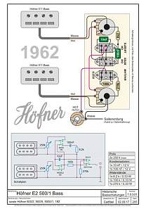

    This is the original wiring for a 500/1, which looks pretty close to what you want. Hope this helps!Click image for larger version.

    Thank you, but not what I'm looking for. I'm looking to change one of the pots to a master tone. The other will be a master volume that effects both pickups. After that, just switch them on/off individually with the switches. I don't know if its possible to run both humbuckers in series or not....... that's what I'm wondering about the third switch..... I don't want to control the tone with resistors and switches.

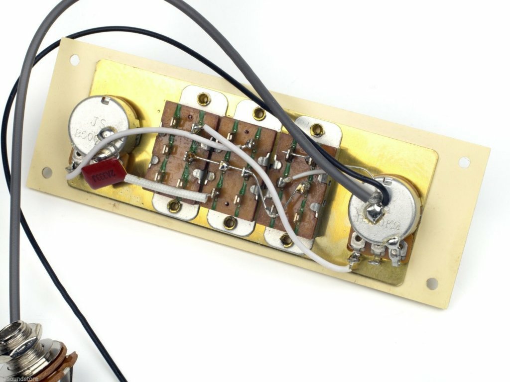

    I looked at it, and it is a circuit board. Maybe simplify it a bit. Wire it like a regular pair of humbuckers. Make a custom control plate. Not even worry about the series/parallel thing. Volume/ tone/blend......or volume/volume/tone.

    Can you send a pic of the control plate back. Slide DPDT switches are not hard to get...

    There's the resistor for the rhythm switch. Think I'll simplify this a bit. Open the sound gates a bit.

    The kit board is a bit upside down from the original (see pic). If you wanted to, you could keep the control panel, and make a plate out of pickguard material or metal (like the original), to mount the switches and the pots. I think the whole assembly mounts to the control plate just using the nuts from the pots. FWIW that would preserve the classic aesthetic, but allow you to upgrade the components.
    If you decide you just want to use knobs, cutting a new control plate is probably better. Setting it up with jazz bass wiring (either with VVT or VBT) would also allow you to use push pull pots to do the series parallel wiring with the humbuckers if you mentioned.
