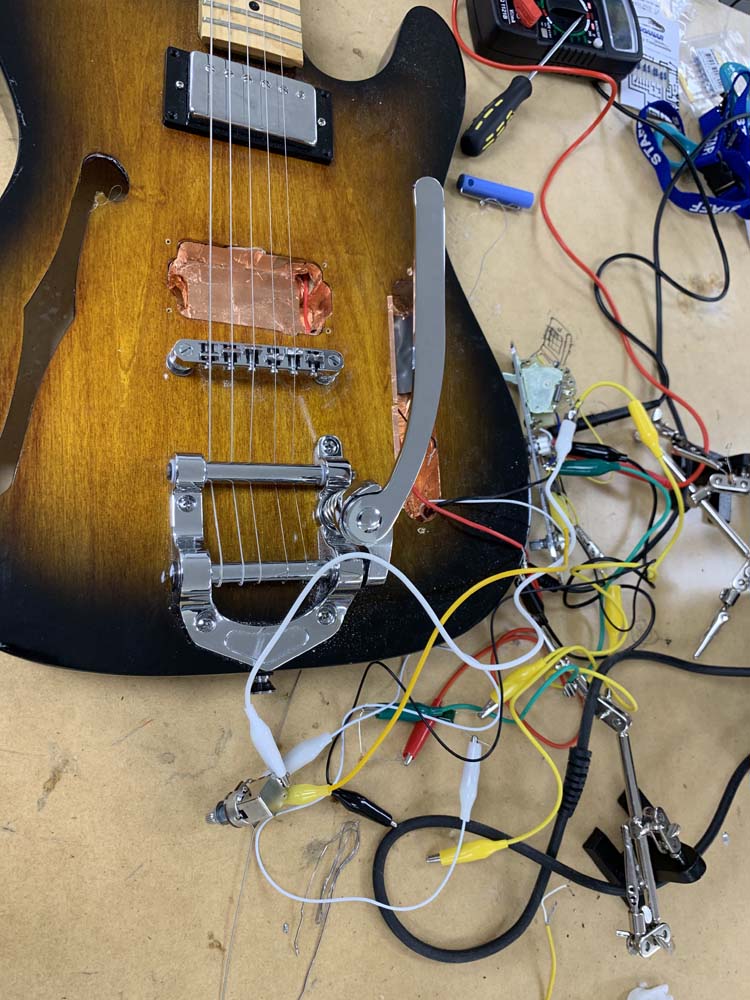

    Dec 2021 Mod:

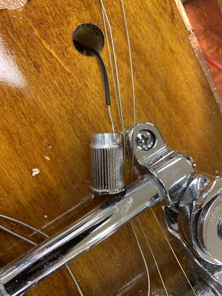

    Ground the bridge. Used the dremel and got the tune-o-matic out. Soldered a ground wire to it and got it through to control cavity.

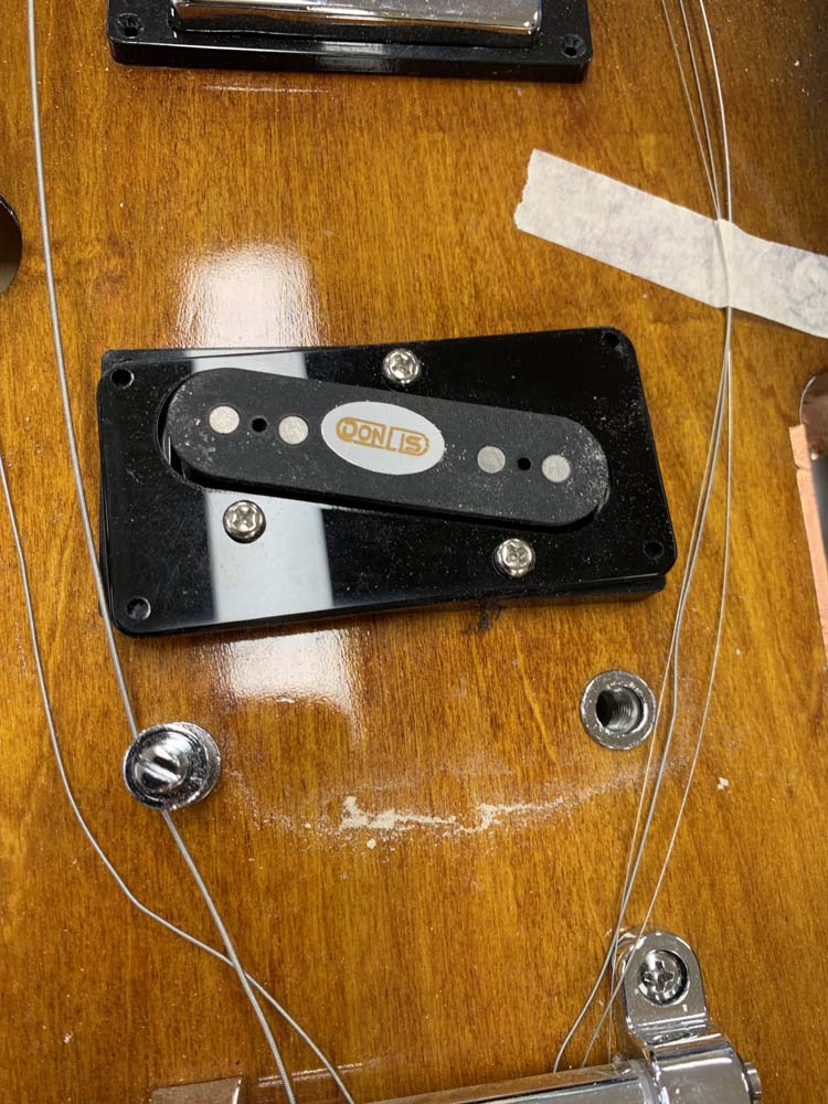

    [ATTACH=CONFIG]42174
    Replaced the bridge bad coil split humbucker and replaced it with genuine single coil. I had to laser cut a conversion ring. Doesn’t look perfect but does the job in the end.

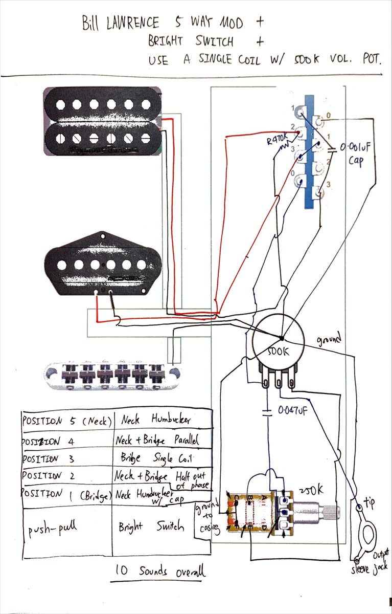

    New switching layout.
    This is called the Bill Lawrence 5 Way Switch Mod
    - Position 5 (neck) - Neck Humbucker
    - Position 4 - Neck Humbucker and Bridge single coil parallel
    - Position 3 - Bridge single coil
    - Position 2 - Neck Humbucker and Neck Single Coil Half out of Phase
    - Position 1 (bridge) - Neck Humbucker with capacitor (seymour duncan mod to reduce a hot humbucker)

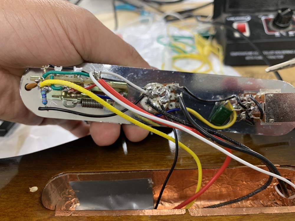

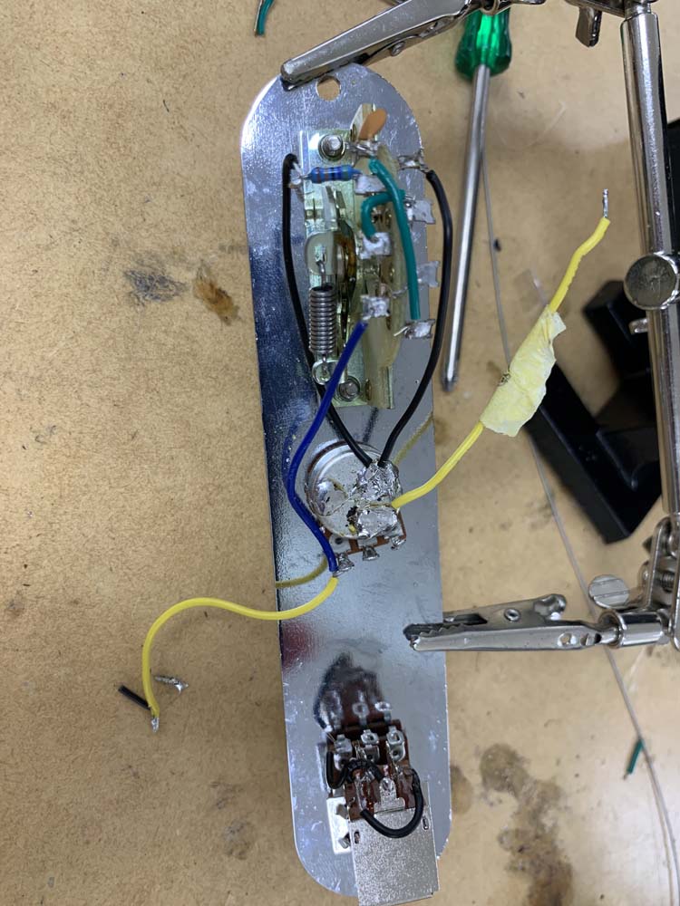

    Potentiometers while mixing humbucker and single coil. Humbucker in the neck is a generic one as I didn’t want to splash too much cash while doing this for the first time. It measures roughly 8k impedance. The two stock potentiometers are both 500k and this is not recommended for the single coil. I ended up swapping out the tone pot for a push pull 250 k potentiometer. I placed an additional 470k resistor in parallel with the single coil to ground to simply balance the volume.
    I was interested in the bright switch and implemented that on the push pull tone pot. This is in part to see if it balanced the previous muddy neck humbucker.
    What I didn’t realise last time was that the 5 way switch possibly requires a deeper cavity otherwise the copper tape can get in contact with the switch and shorting everything out. I’ve placed some electrical tape where the contact may occur to stop this
    The results exceeded my expectations. Experience definitely helps - I pre-measured every wire, minimised bare wire length, tested by alligator clip and soldered one part at a time and tested one part at a time - this definitely minimised accidental shorting (which happened a few times).
    The neck humbucker still sounds a little bit hot but with the series cap definitely make it sound sweeter.

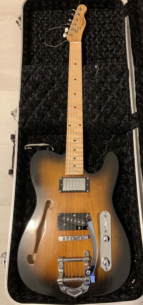

    Final Product Click image for larger version.
    Not as "good looking with HH arrangement but it is more practical in my opinion.

    Wiring DiagramClick image for larger version.
Name:	wiring diagram Dec 2021.jpg
