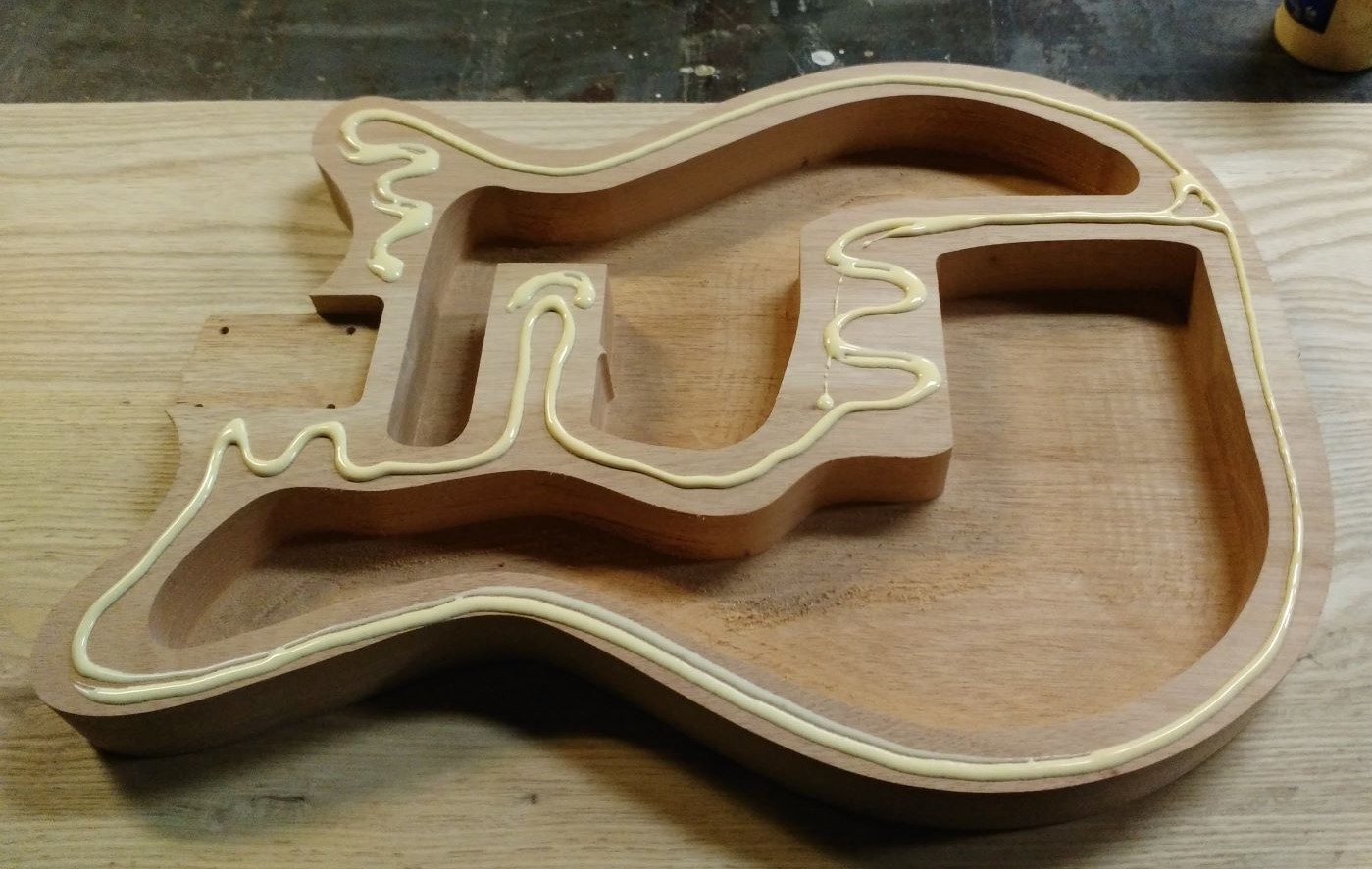

    Those 'solid' Gretsch guitars are almost hollow inside, so regardless of the shape, you'd end up with quite a different guitar.
    They are all rather like this inside:
    So it really depends if you just want a look-alike or a fairly close replica.
