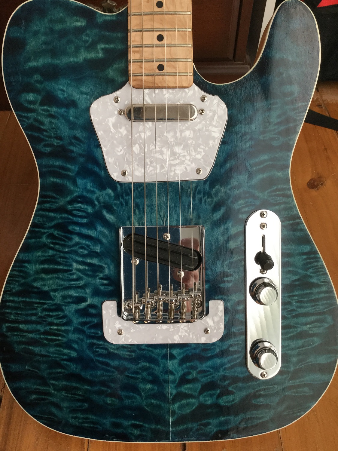

    Hi everyone,
    Got two upgrade questions that I couldn't find in the archives, your help is much appreciated!
    GAS starts to play up again, but as opposed to building something new, I am thinking of perfecting what I have:
    - TL-1A
    - Kit bridge pickup
    - GFS goldfoil Alnico Single coil < Link >
    - Kit electronics
    - Shielded
    Some notes:
    - Really like the sound of the GFS pickup, but want to make my Tele a true tele before building something else.
    - Seldomly play the kits bridge position as I find it a bit too harsh.
    Questions:
    - What electronic updates would you recommend and how will it make a difference?
    - I have seen a set of Tele Wilkinsons, tone riders and fender 52 classic's, Will I notice a big difference in swapping these for the kit pickups?
    Thanks!
    Again your input is much appreciated :-)
