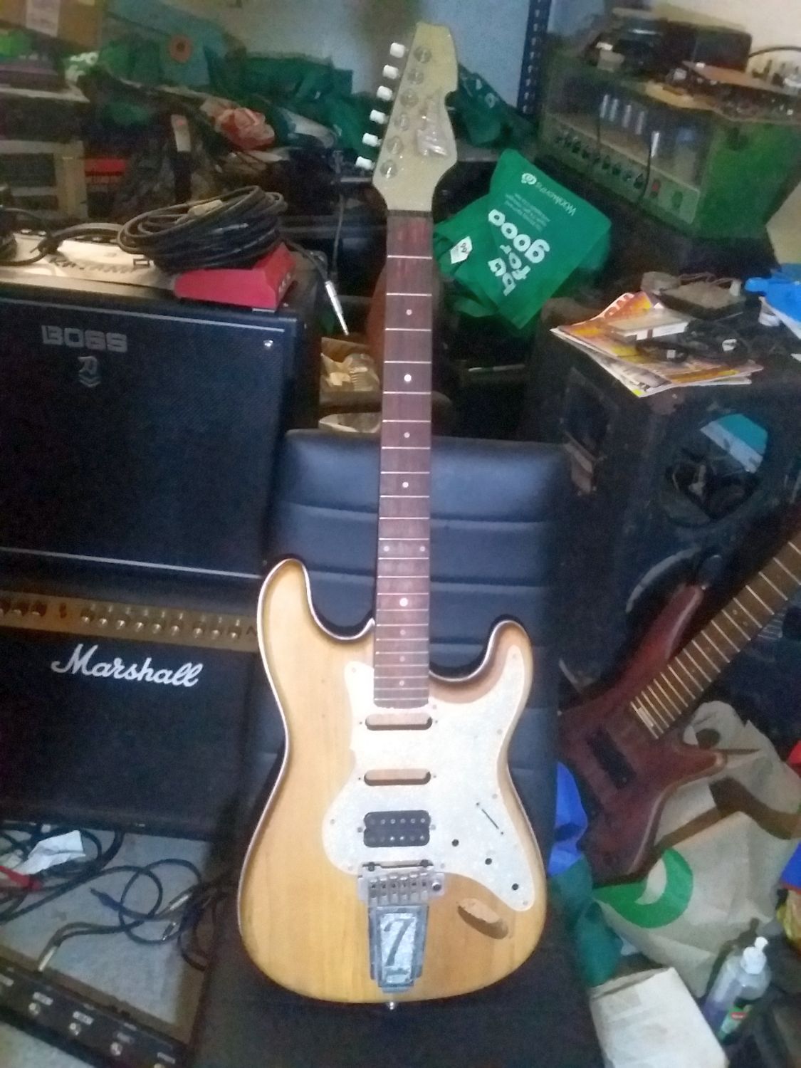

    Okay, here we go, have any of you seen one of these before?

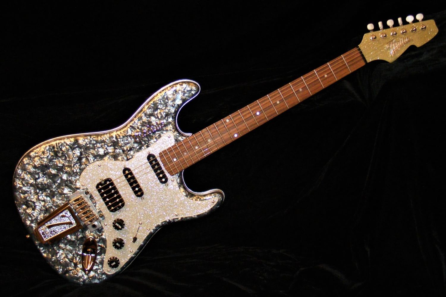

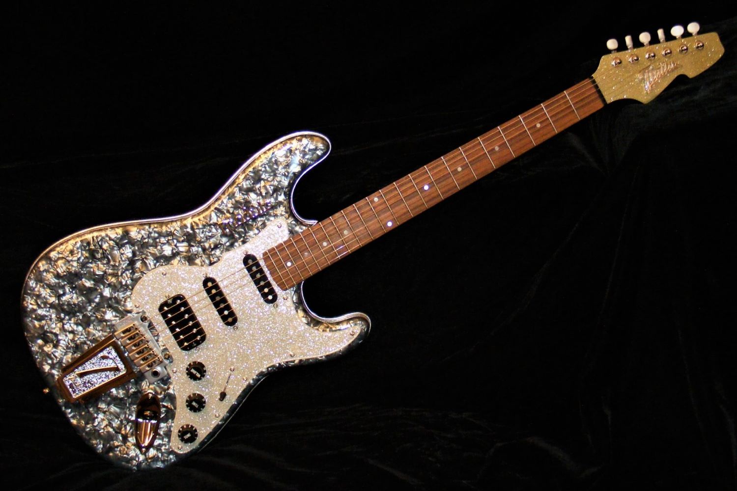

    It's another Trevor Wilkinson design brand, (like 'Vintage' was), that concentrates on modern interpretations of quirky 50s and 60s European guitars, especially Italian brands (hence the Itallia name). Made in Korea. Very decent guitars, even if the looks are far from mainstream.
    https://www.italiaguitarsusa.com/
    Been going since 1998, so there will have been a few models that have come and gone in that period.

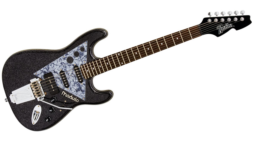

    Yours looks like an Italia Modula Tipo 3, though heavily modified since the original finishes were quite 'out there'. This is one of them:

    And another:

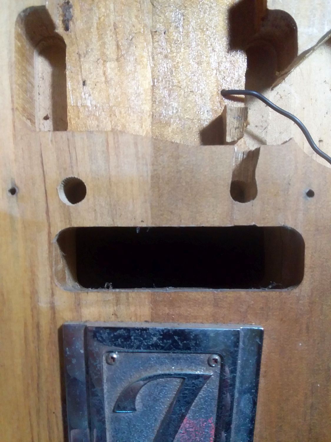

    One of the mounting-holes for one of the bridge pivot-studs needs filling in with some wood dowel and then re-drilling cause it's very loose and the pivot stud leans too far towards the bridge pickup, the other mounting hole for the other pivot stud could do with some filling and re-drilling too.
    The rest of the guitar looks in pretty good condition, although the body needs re-finishing cause all the old vinyl (I'm guessing that's what it originally was), has come off.
    The body looks to be made from a few pieces of solid wood laminated together, and there's a piece of silver plastic triming running around the edge of the body at about half the thickness.

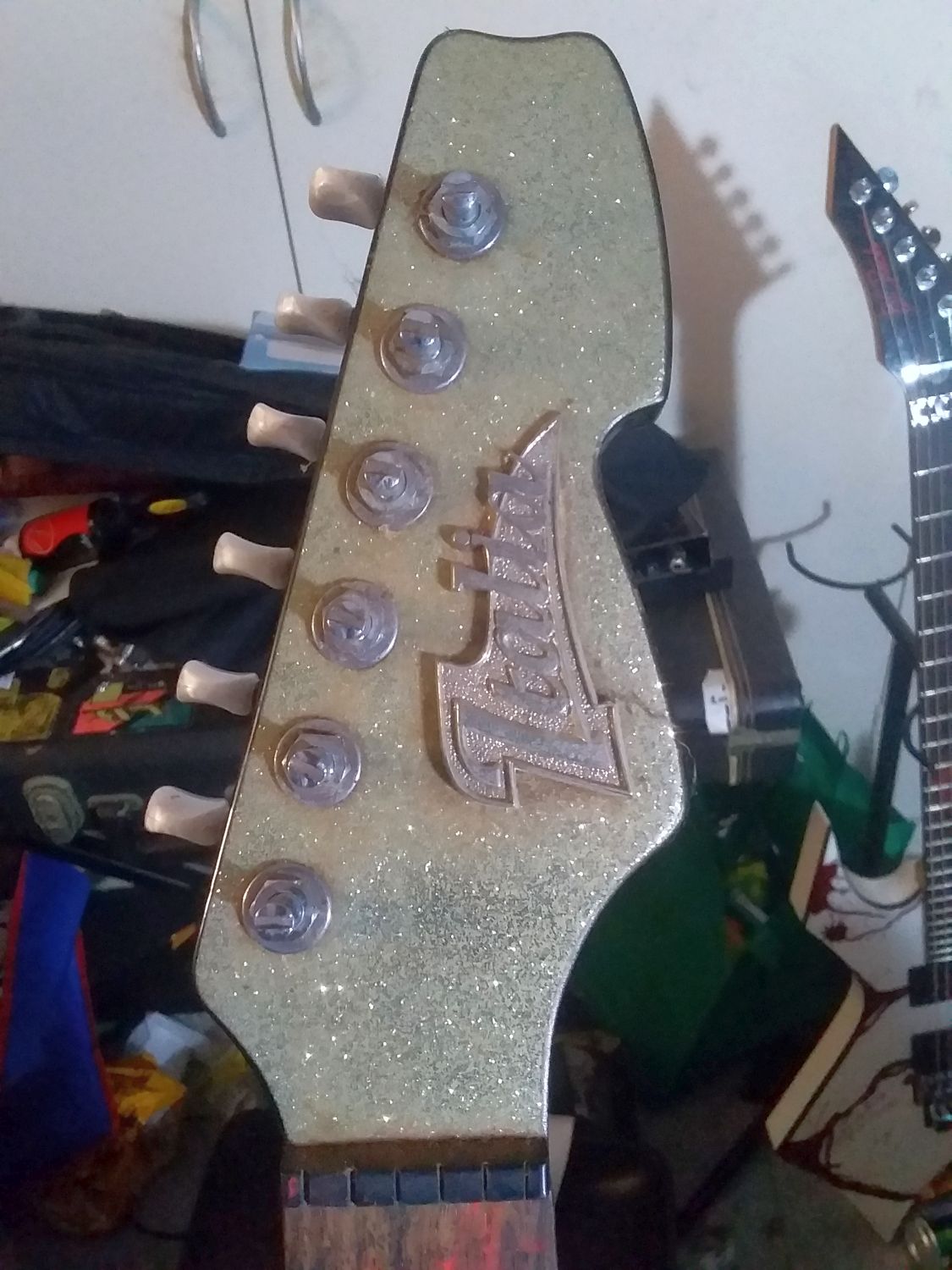

    Closeup pic of the headstock:

    I had a closer look at the hole for the right-hand bridge pivot-stud that felt a bit loose and wobbly, I soon found out why the stud was leaning towards the bridge pickup, as the saying goes "A picture is worth a thousand words", I thought that the problem would be best explained by posting a closeup pic of the pivot-stud mounting holes in the body of the guitar, as you can see, the cause is only too clear:
Name:	Pivot Stud Hole Break_resized.jpg
    Notice the bridge pivot-stud mounting hole on the right?, my theory is that the piece of wood just above it was pushed-out of it's place due to the string-tension, the direction of the wood-grain contributed to it, so, I'm thinking of using some 2-part epoxy adhesive, like some Araldite, to glue the piece of wood back into place, I might need to add some reinforcement while I'm at it.

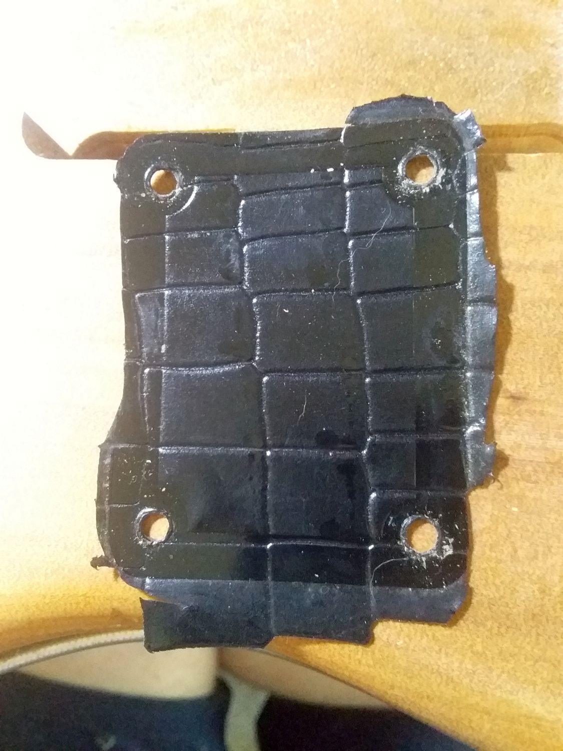

    While I was working on sorting-out the bits I needed for re-building the scratchplate, I decided to remove the neck from the body, to make it a bit more manageable, in the process, I discovered a piece of the original vinyl covering (I'm assuming that's what it is) of the body underneath the neck plate, here's a pic of it and I think this gives us more of an idea of what the body must have originally looked like:
Name:	Original Italia Vinyl Covering_resized.jpg
    The colour seems to be a very dark chocolate-brown colour, but then again, I'm red-green colourblind so it might look like a totally different colour to you, thickness of the vinyl is about 1mm.

    That vinyl just looks black to me. Black Alligator to specific! A very rare species btw.
