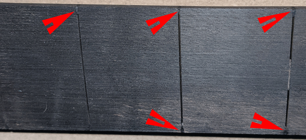

    My first, huh, what to do moment: My friend/customer wants gold frets, so I bought a custom shop neck that has been kerfed but without fret wire. The odd bit is that they seem to have "filled in" the edges of the kerfs so that it acts a bit like binding (but isn't). It doesn't seem to be the same thickness everywhere, though, so if I leave it, I'll need to clean it up some.
    Would probably be easier to fret without it -- but I'd probably need to buy a kerf saw and lightly resaw the kerfs. I don't think I can safely just scrape it out (though worth a try, perhaps). I have a tang cutter, so doing it as if it were binding is a possibility and may lead to a better looking fretboard. Just a bit worried about how stable it is -- will it crumble away over time, creating trouble? Picture shows several more visible spots, but it's the whole board.
    Anyone know why they might have done this (I didn't ask for it)? Is there something I'm missing as to why it's important and should leave it?
    Thanks...MillardClick image for larger version.

    Looks like the factory have done it as they normally would, which is to fill in the ends of the cuts. They would then use frets with the end of the tangs cut off. This came up recently here and I looked at my guitars and there was roughly a 50:50 split as to whether the fret tang ran to the edge of the neck, or whether the tang ends had been cut off and the fret slot end filled. A small dab of CA at each fret end should keep them in place.
    If you assume that the neck will shrink slightly over time, and a lot of necks do, then a full-length fret will poke out and you'll need to file down the whole of the end of the fret, almost certainly requiring some refinishing work on the sides of the neck. With the tang ends cut off, only the very top of the fret needs to be filed back, which can be done with the edge of the neck masked.
    I would like to know what the fret slot width is. You can try measuring the slots with feeler gauges or maybe Pit Bull can find the info for you from the factory. Whilst a lot of fretwire has a 0.02" wide tang and wants a 0.022"-0.023" wide slot, some is slightly thinner and some slightly thicker. So if you are ordering some Jescar EVO gold fretwire, you want to know that it will fit properly and not be too loose, or the slots too tight for the frets to seat well.
    I can't tell from the photo, but just check that the fretboard has been radiused before you start to hit the frets in.

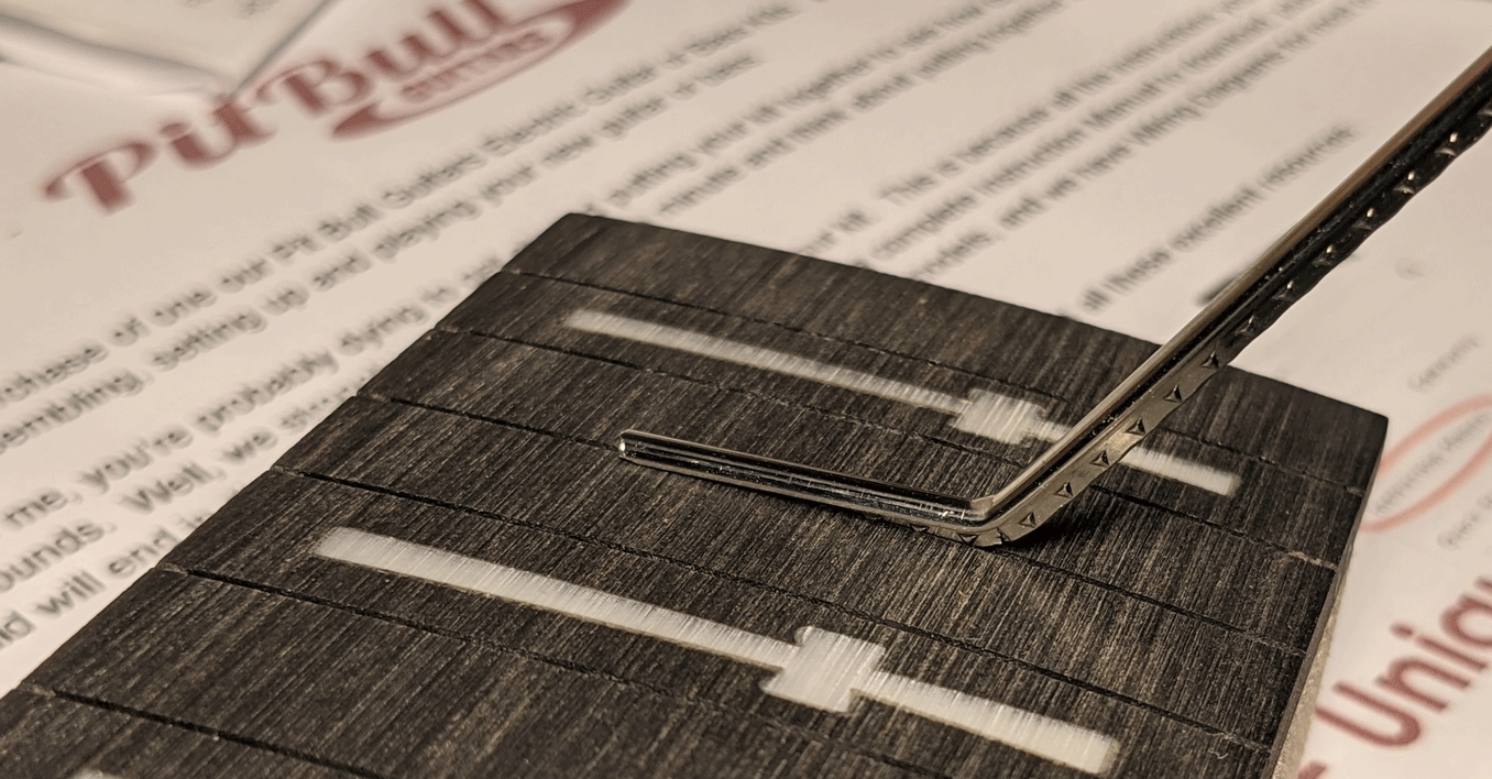

    .026" will go in and come out without much effort. .024" leave some wiggle room.
    I ordered the fret wire from StewMac. They say "Our fretwire is sized to fit a 0.023" (0.58mm) fret slot width." So you'd think I might have a bit of a loose, sloppy fit. That seems a bit better than creating compression on the board by having it the other way round.
    I may need to buy the crimper to make the barbs a bit fatter, maybe. I did the hockey stick test and I had to hammer it to get it in and it didn't exactly pop out when I pulled on it (and, of course, it made little chips near the slot).
    It might be okay as is.
