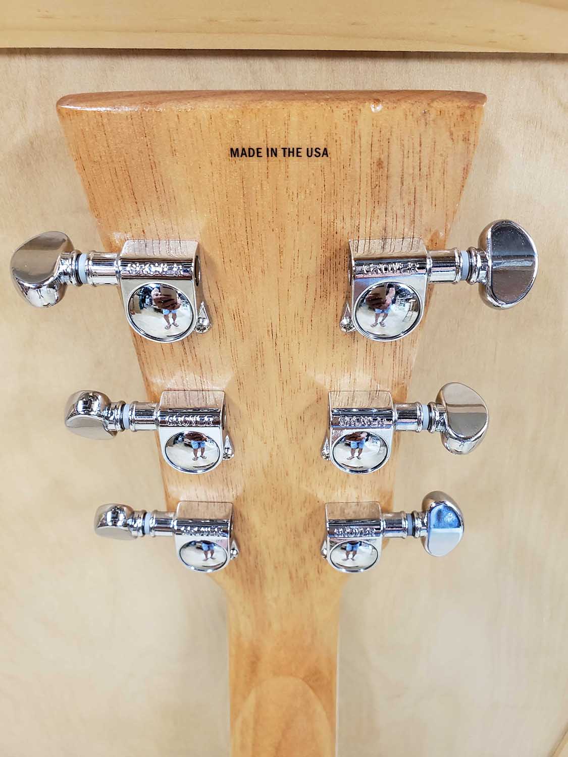

    Rear of the headstock showing the Gotoh SG381 locking tuners. These have a great 16:1 gear ratio:

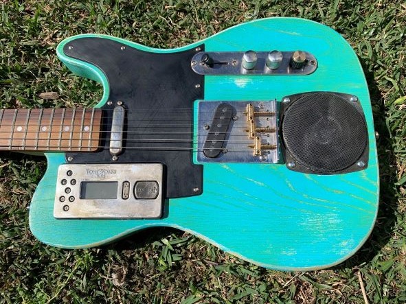

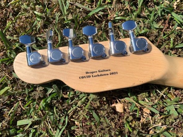

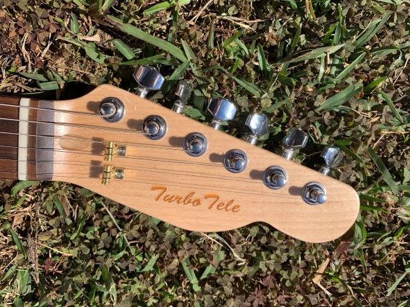

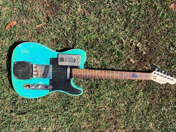

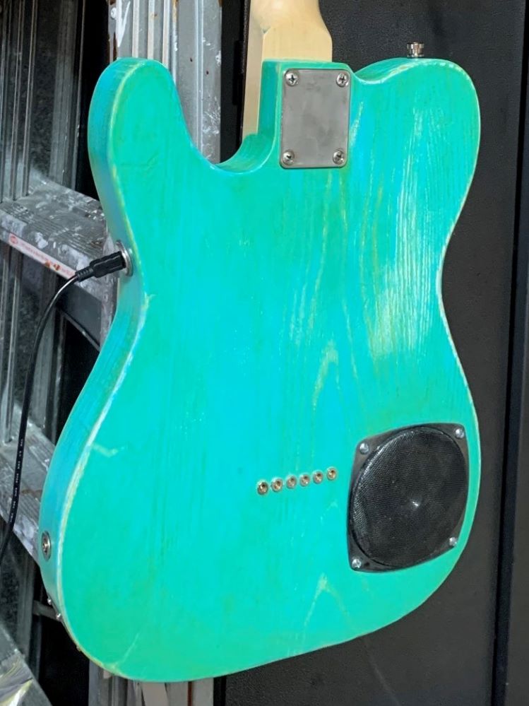

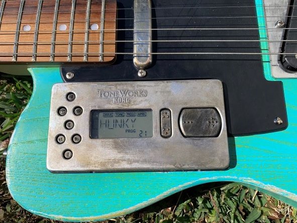

    OK here's my shot, I don't seem to be able to upload better quality photos, am I the only one that struggles to get pics uploaded?
    It's a TL-A with a rosewood fretboard
    Most of the guitar parts are from the kit, pickups, bridge and machine heads.
    5V, 6W stereo amp, $5 from eBay
    Built in Toneworks Pandora PX2 that was given to me years ago with a dodgy input and output jack.
    5V phone backup battery under the scratchplate, dropped to 3V for the Pandora. 2x 40W ultra slim speakers from a caravan
    Here's a short video of a sound demo using the onboard amp and speakers (apologies for the playing )
    https://www.youtube.com/watch?v=PM02fk-JuKo
    The output jack still functions, so the effects can be played through an external amp with or without the onboard amp and speakers operating
    The control panel works in the standard way with the pickup selector and the vol/tone, the third knob is for the amp(it's off a Marshall amp) and works as vol/on. The small switch next to the Marshall knob turns the Pandora on and off
    There's a miniUSB input for charging and a 3.5mm jack for input to play along with music (pics below)
    It's super-useful to pick up and have a quick play without faffing around with cables and amps. The battery seems to last ages, I have not run it flat yet! It is fairly big physically, I didn't note the claimed energy storage as most of the time they are fairly fantastical!

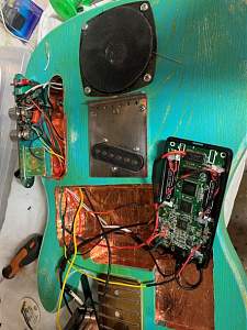

    I'll pop in some more photos below of the wiring

    Here's a few more:
Name:	Headstock front (2).jpg
Name:	body neck (2).jpg
Name:	finishing wiring.jpg

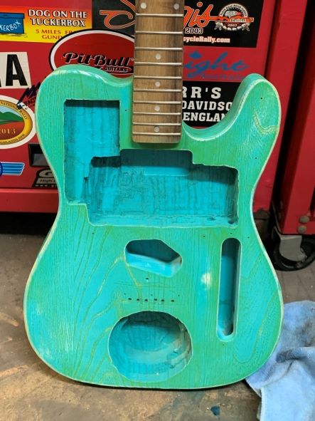

    The paint is a Rustoleum white primer and surf blue with a wash of oak Feast Watson stain thinned with Meths to turn it to a green from blue, with a light sand with fine paper to age it.
    It is a bit heavier than a standard TL, because of the weight of the speakers (although as you can see I removed a lot of Ash!)

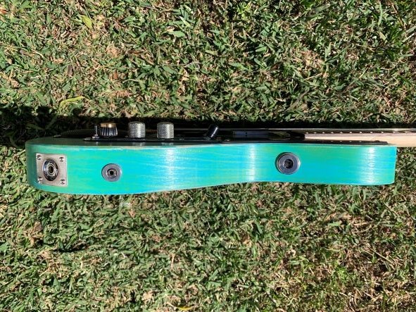

    There's the standard output jack, that allows the use of the onboard effects through an external amp, a mini USB port for charging the onboard battery and a 3.5mm input to allow me to play along with input music through the onboard speakers:

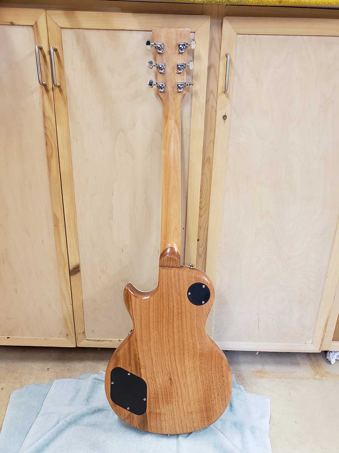

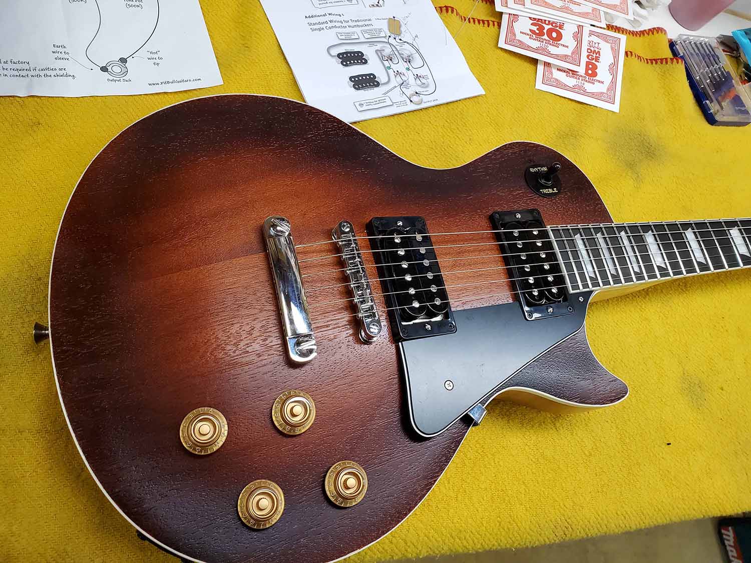

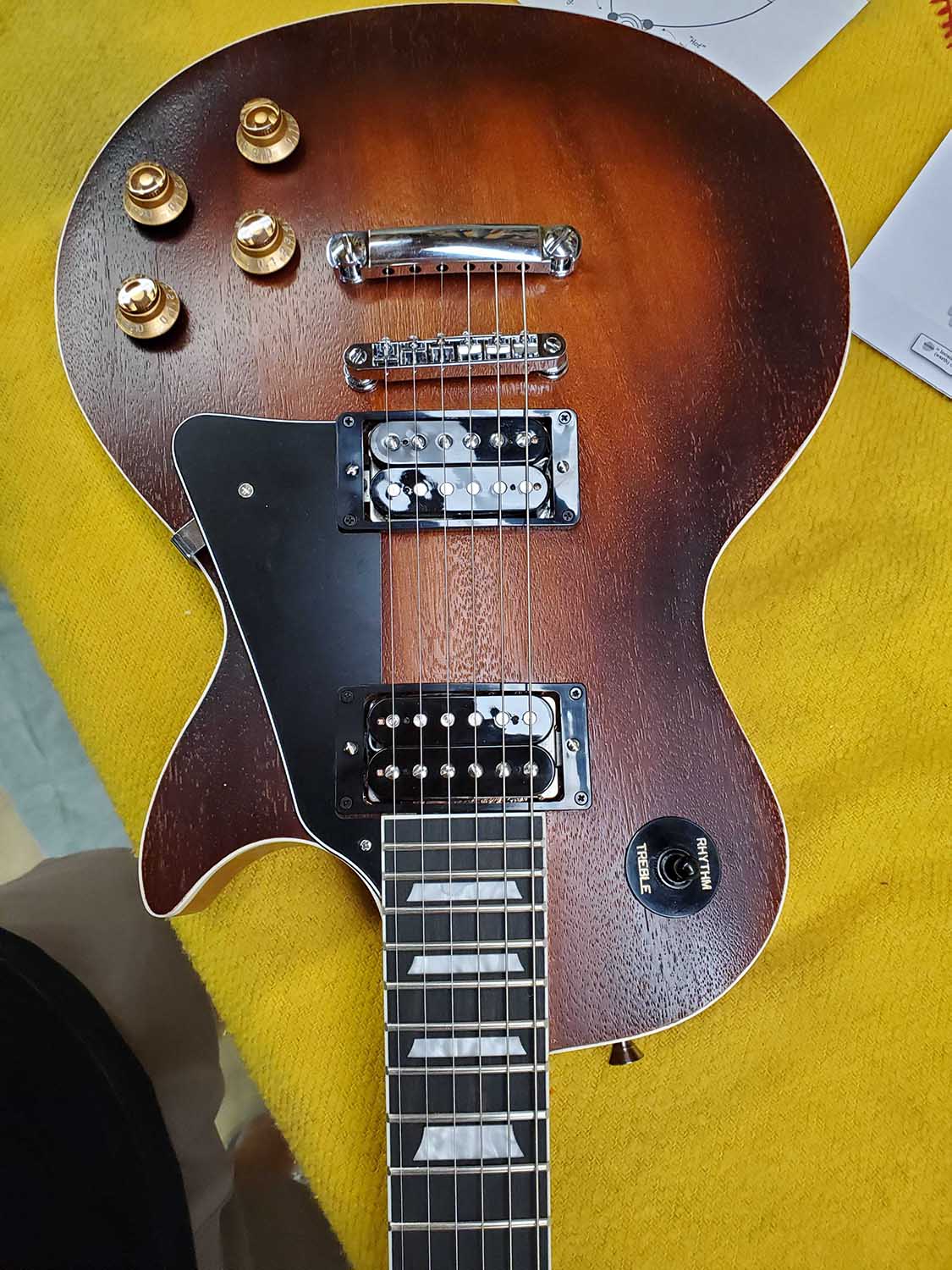

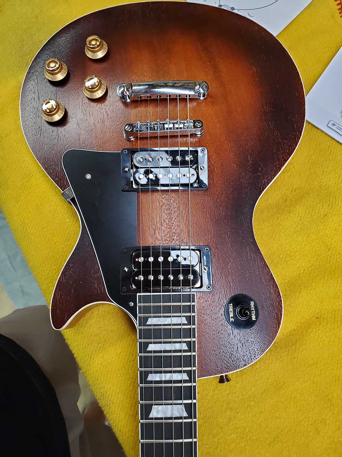

    This is a first build for me, learned a lot! . Upgraded to SD Slash pickups, and orange drop caps. Plays and sounds great!

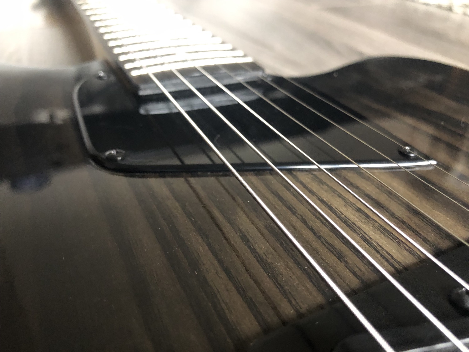

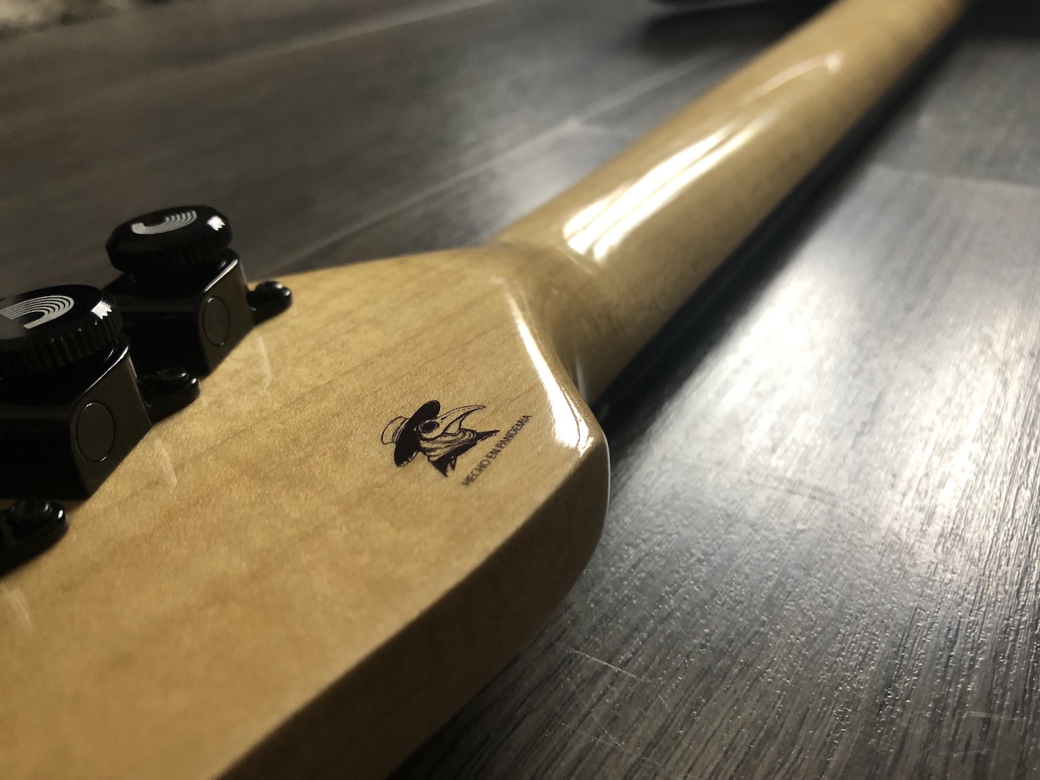

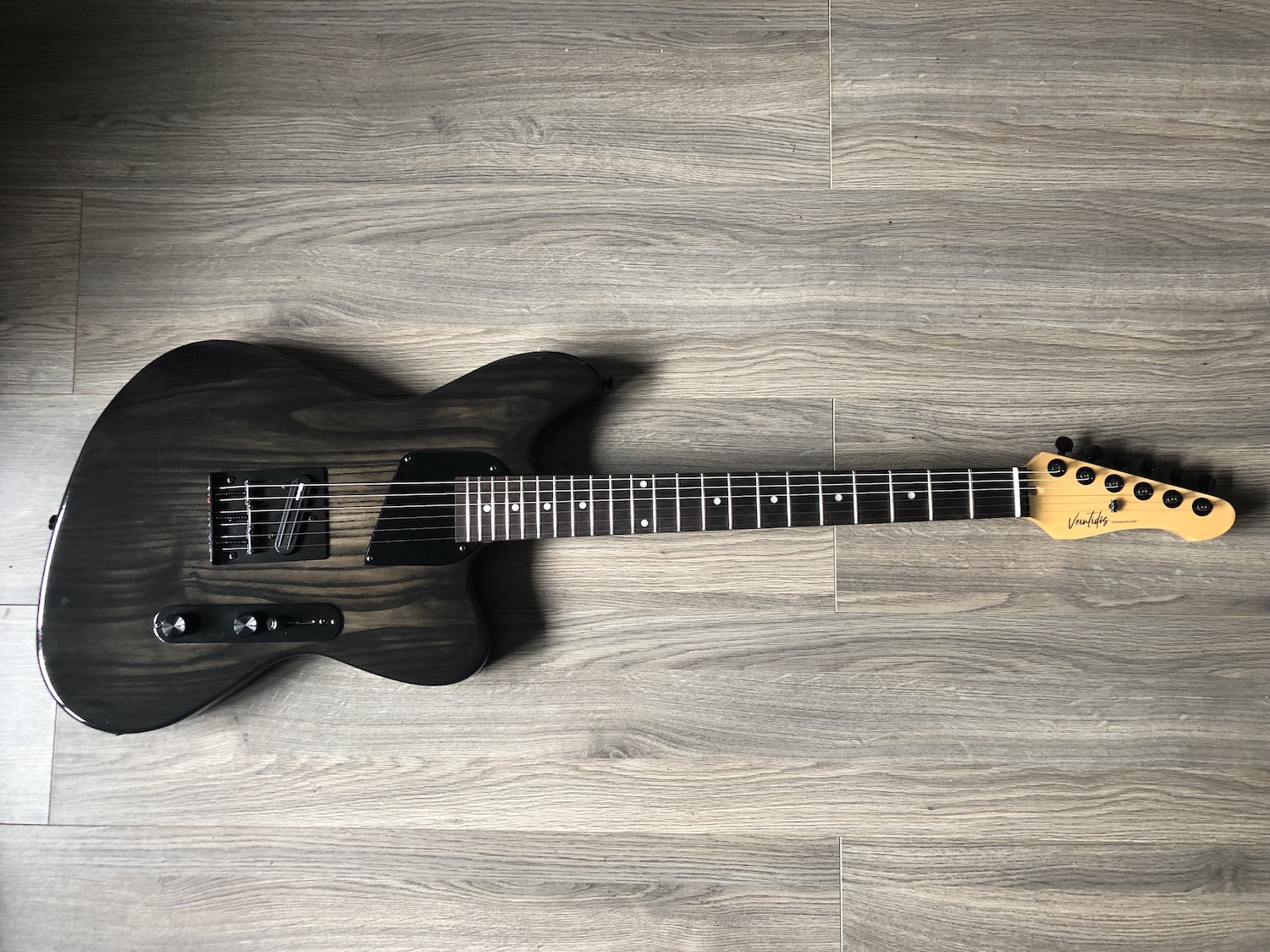

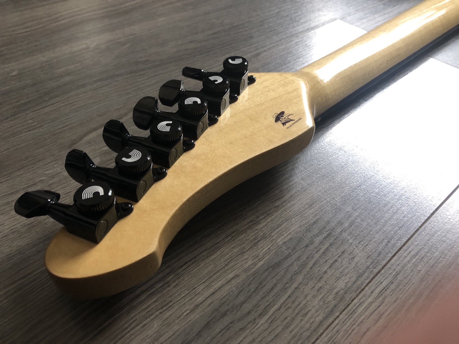

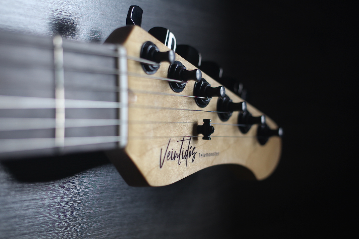

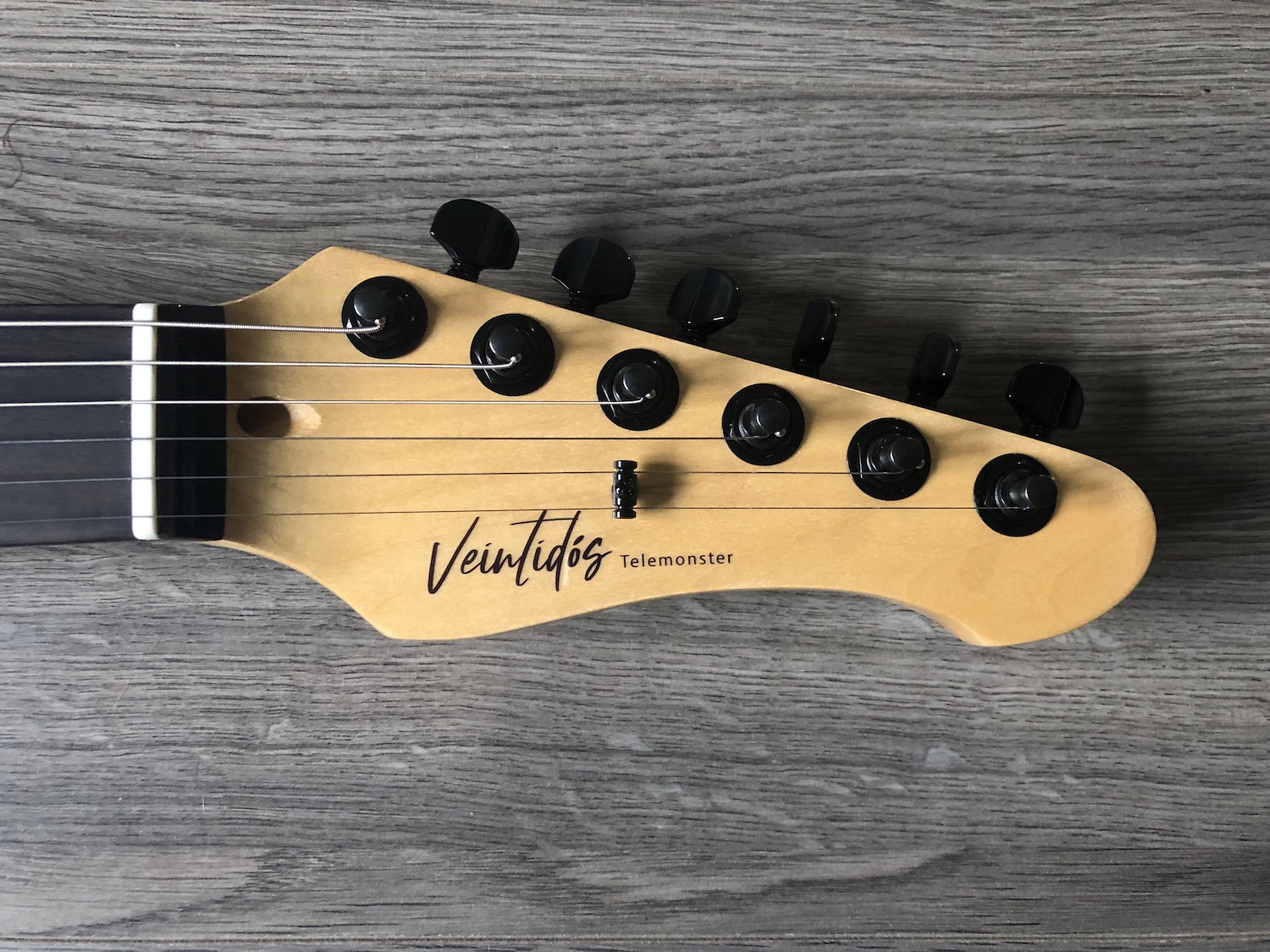

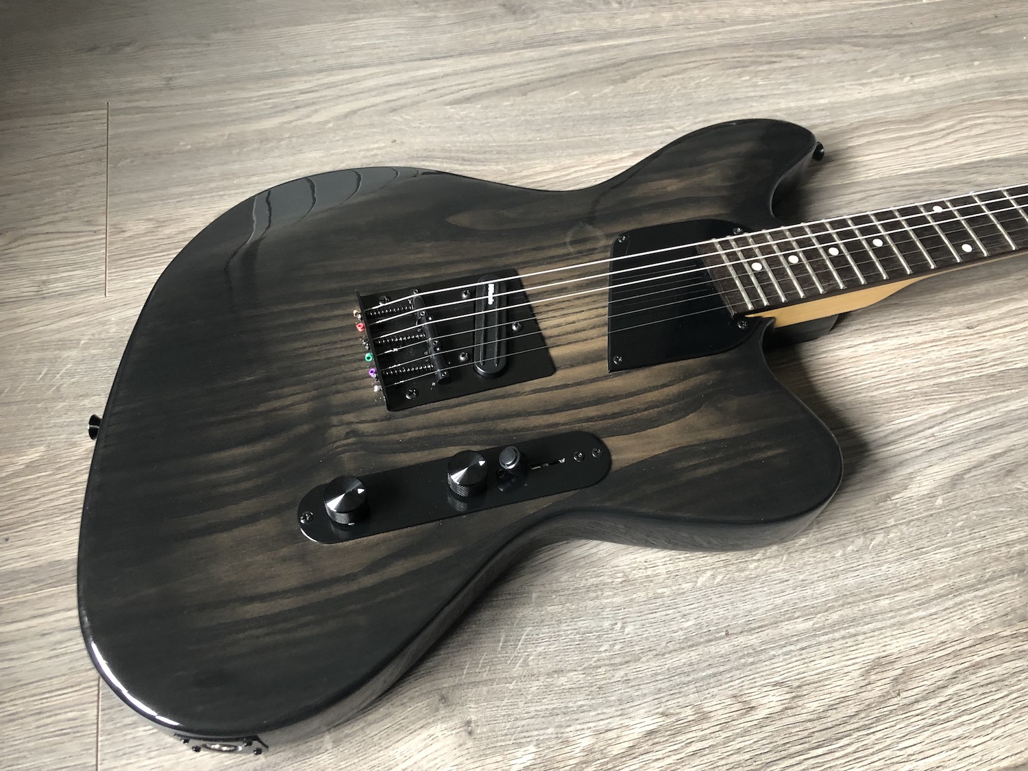

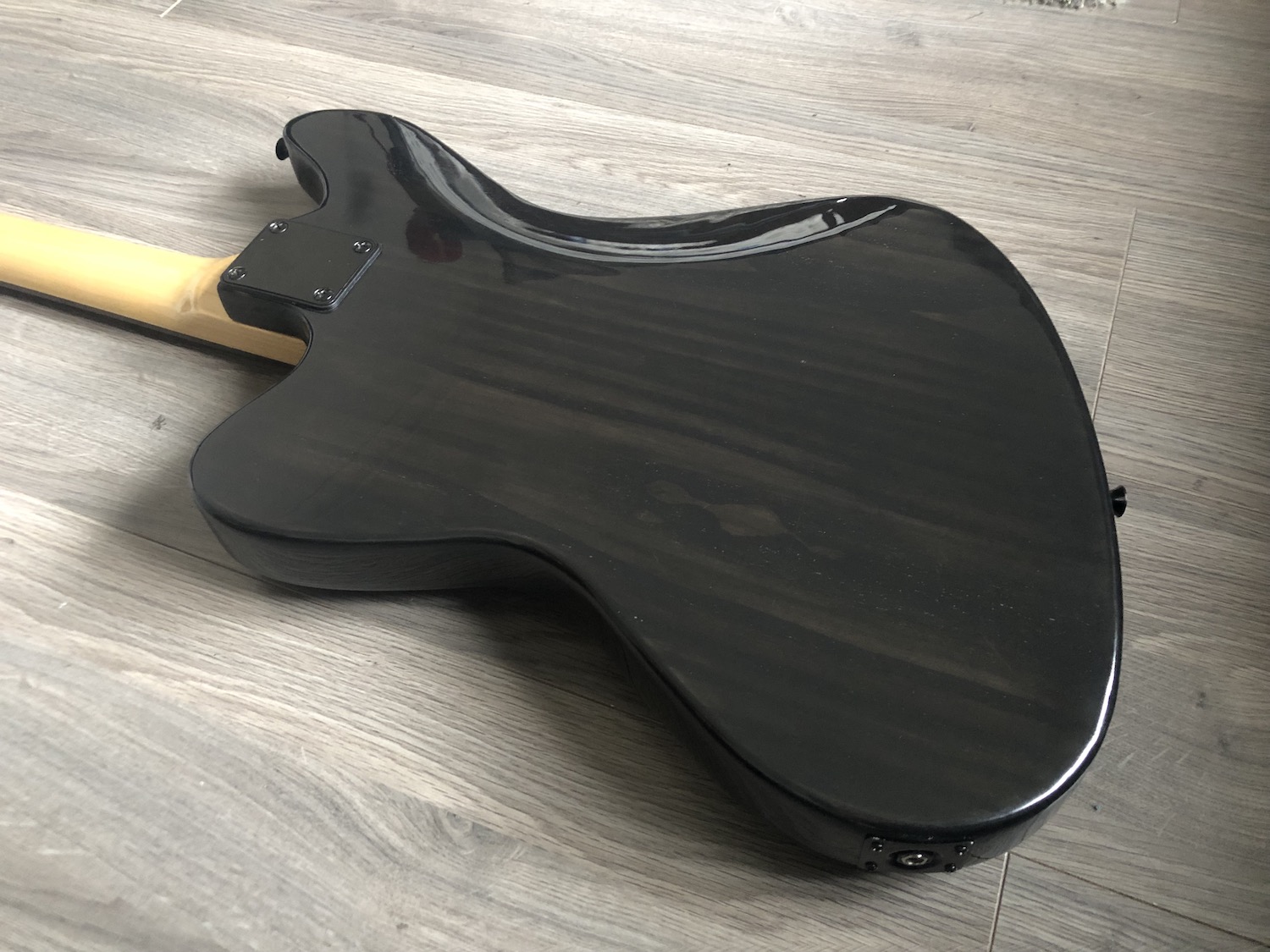

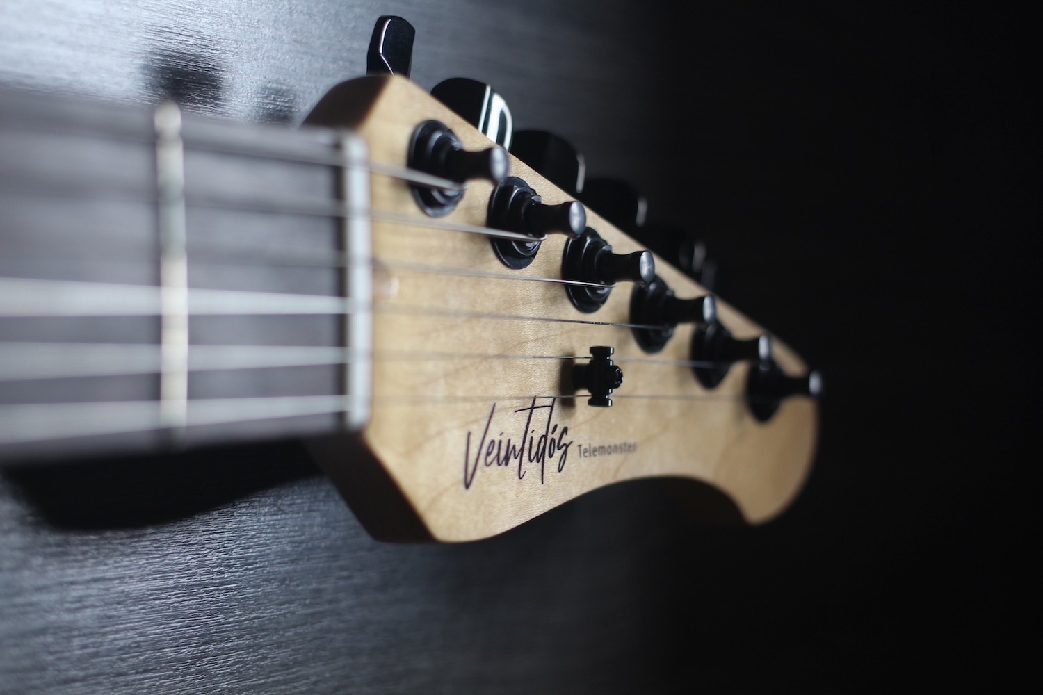

    Hi everybody,
    here's my entry, first build.

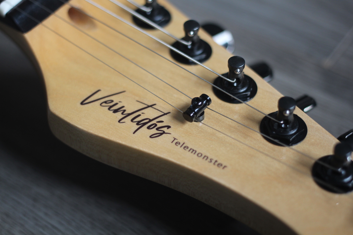

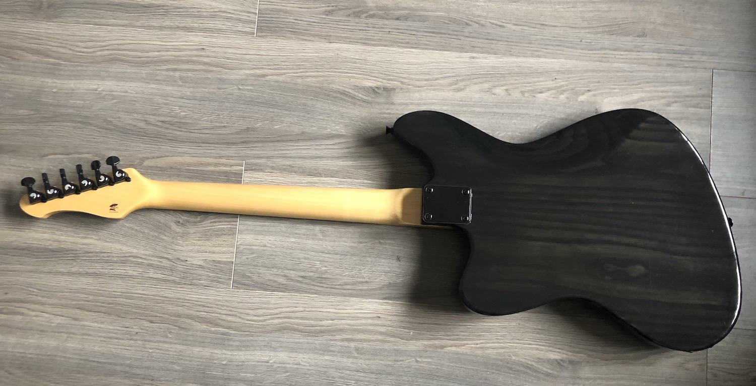

    Veintidós - Telemonster (DJT-1)
    Body finish: water based black dye and spray can acrylic varnish
    Neck finish: tru-oil
    Dimarzio ToneZone T bridge pickup
    D`adario auto-trim locking tuners
    Bone nut upgrade
    Custom decals
    Custom neck pickup cavity cover
    Kill switch (pickup selector)
    Alternative knobs
    Round string tree
    The rest of the hardware and circuit is from the kit.
    I enjoyed building this kit and im really happy with the results, plays nice!
    Here's my diary, if anyone want to take a look
    https://www.buildyourownguitar.com.a...ad.php?t=11356

    More pics!
