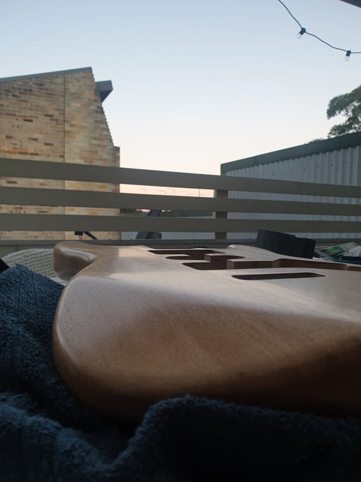

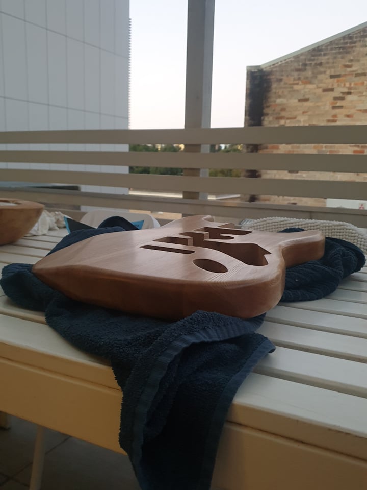

    I'm sure its nothing special but I'll attach a photo of the finish I went for, its my first build and I have no experience with anything like this so I'm very proud of what I've got as the result.
    Thanks again for your help.
