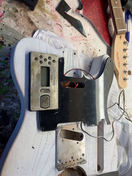

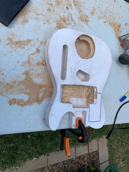

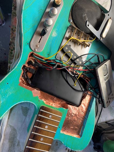

    Routing out the body, the speakers give about 4mm thickness of wood left. There's one in the back too as the PX is stereo.

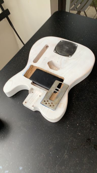

    TurboTele - not the best name but meh...

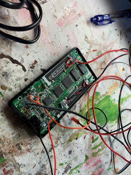

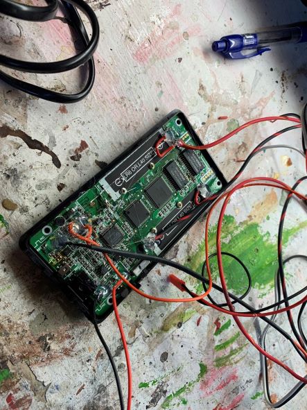

    Butchering the back of the Pandora, ugly, but it all works

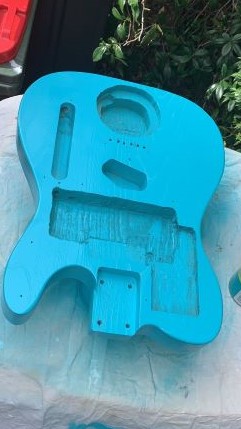

    Paint - it will be a relic body and hardware, surf green (when I have finished with it )

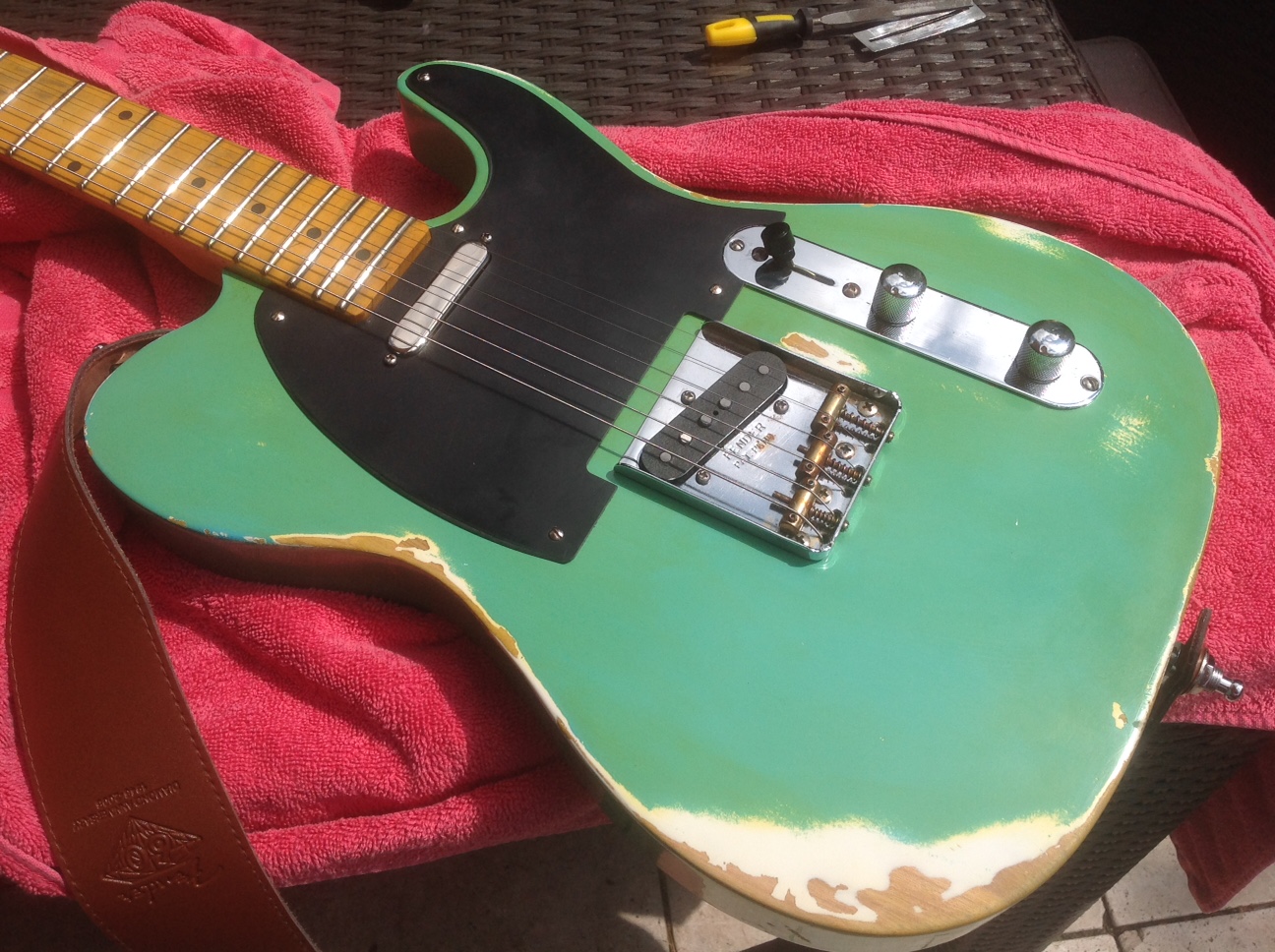

    This is the TL51 I did a couple of years ago, and this is the way the finish will come out on this one when done (same basecoat blue):

    5V battery - a mobile phone charger backup, with USB in and out (Micro USB for charging).
    I'm running an extension to the charge circuit, and it doesn't need to be switched on as the demand turns it on and off so I can hide it under the scratchplate
    It's a 5V digital amp, 2x3W
    Class D amp, rather than digital? D does not stand for ‘digital’ in class D, it’s a pulse width modulated amplification system.
    What current draw does your Pandora have? 6W of class D amp output is about 6.6W input power, or just over 1.3 amps at 5v. That leaves about 700mA at 5v for the Pandora from a 2A 5v USB output. If your rechargeable power block has two outputs, it might be best to power the amp from one and the Pandora from the other just in case any current limiting kicks in when you turn it up. I’ve tried reading the Pandora manuals but they don’t state any current draw values, but a digital processor is going to consume a fair bit I’d have thought.

    My version runs of two 9v batteries: https://www.youtube.com/watch?v=l-168_dviOw
    Taking it all apart and finishing it properly will probably be next year's project.
    Mentor Andyxlh's Avatar
    1,206
    Hi Simon,
    That sounds right - thank you
    The PX2 says 2 AA batteries will run it for 12 hours, I'm guessing the current draw must be smallish? Even if that's overcooking it, 2xAA won't deliver much current for 6 hours, will they?
    I have tested it at full whack and it seems OK on the single output, it will be easier to wire it up like that, but if it gives me a problem I'll know where to look!
