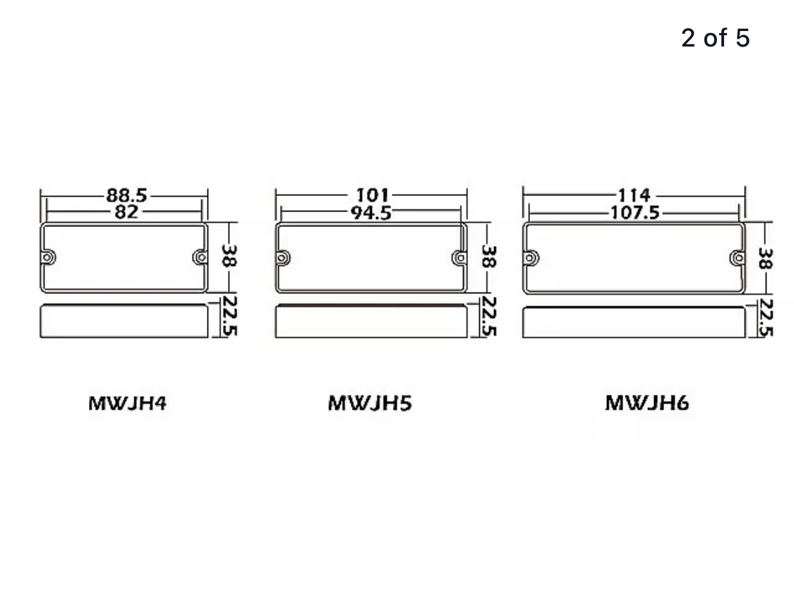

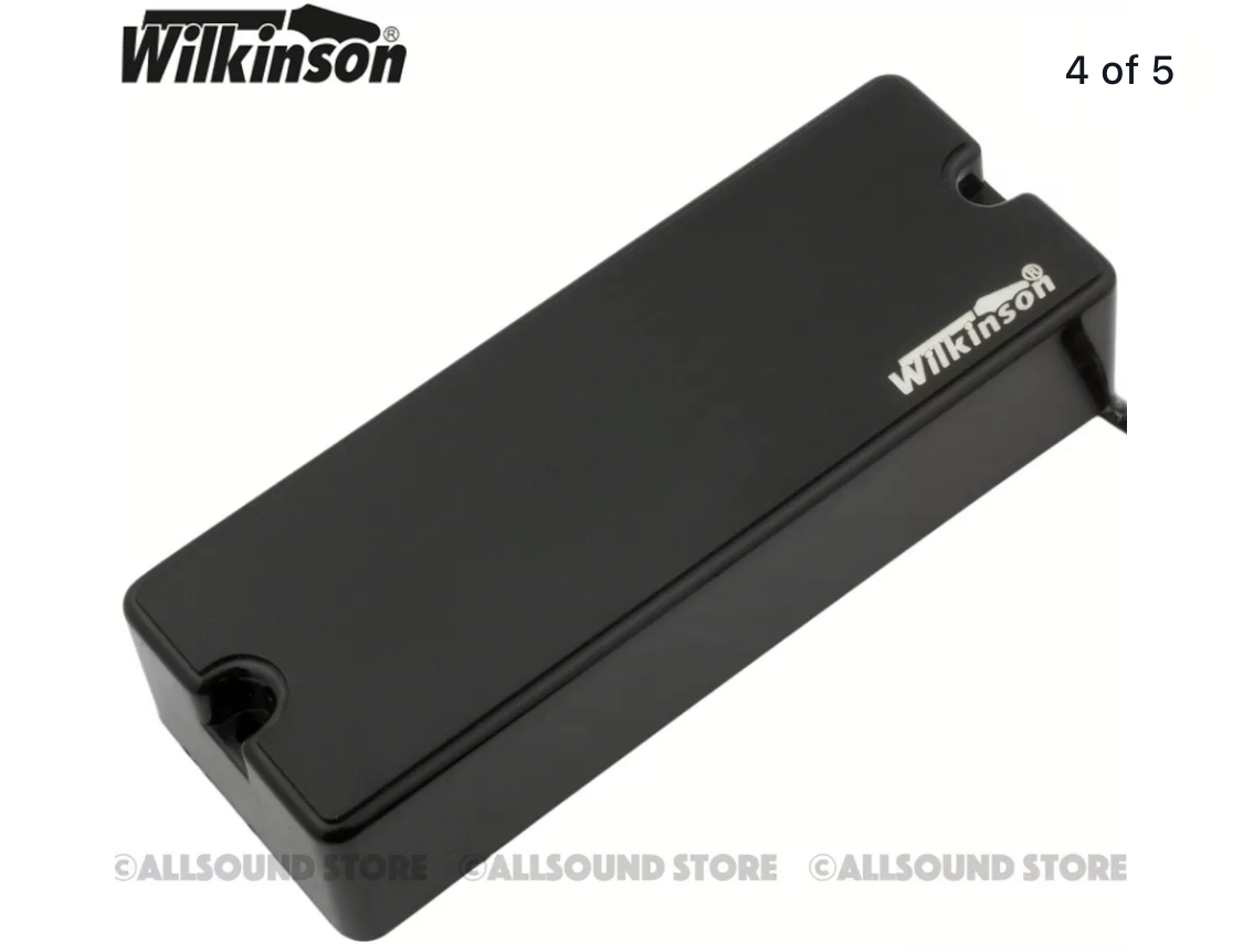

    I don’t want to spend too much and found these Wilkinson MWJH5s that should be a good fit and are cheap. Does anyone have any experience with these?
    I’ve read lots of good things and seen some videos of them and other makes (p&js mostly). Im pretty much ready to pull the trigger, but just wanted some feedback or suggestions before I make the final decision.

    I presume you meant the MWJH4, rather than 5, as you have a 4-string?
    Have you measured the size of the kit pickups, as soapbars can vary a bit in size. There are a couple of common ones, and then a few oddballs

    Nah I mean the 5 because the 4 is too small and will leave large gaps, but the 5 has similar dimensions to the pickups routings.

    You may want to check what the internal structure of those pups are. Some soap bars have a long mag across the poles and some have individual pole pieces, all hidden under the cover. A 5 sting pup may work if a single mag is used, but it will be pretty crap if individual poles used and in the wrong place for the string positions. The Bartolinis I used state the size is a replacement for a Mighty Mite pickup, so you may want to see if Wilkinson have a Mity Mite replacement equivalent.

    At the low price they go for, they won’t have individual alnico pole piece magnets. Almost certainly a ceramic bar magnet. It’s then a matter of whether it’s got steel slug pole pieces or two steel bars. Steel bars will be fine. And with metal slugs the strings will all sit between the poles, so they will all have a pole either side. It’s not the ideal situation, but apart from maybe having to have the pickups slightly nearer the strings to get an equivalent output, it should be OK.
