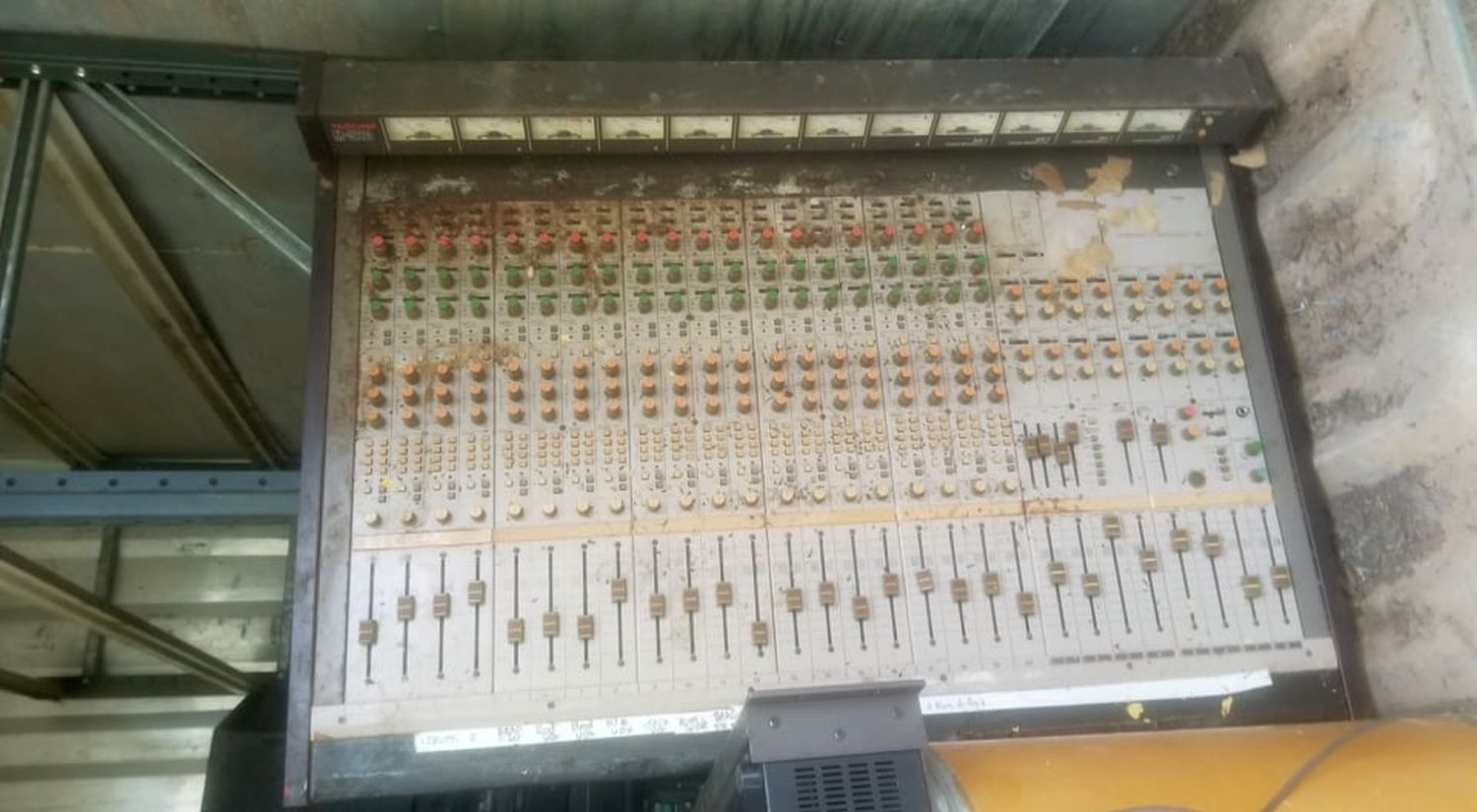

    Geez, you wouldn't believe what a mate of mine will be giving me next week, an old 80's Tascam 20-Ch Analog Mixing Desk, my mate said that it may need some restoration work, but it does have the power supply that normally comes with it, want to know what it looks like?....here's a pic of it:

    I'm not sure exactly what the model number is, but it should be fairly easy to work-out, hopefully I'll be able to find a user and service manual for it online.

    It looks fairly modular, but you'll still have fun taking it apart and cleaning pots and faders. Some recapping probably necessary as well.
    20:8 model, so really for use with an 8 track rather than as a live desk, though you obviously can do that as well using only 2 of the output channels.
    But it's got the meter bridge, which is useful.
    Hey cheers Simon, I can confirm that it is indeed a Tascam M-520, what's more, the service/user manuals are available for free on the internet as a pdf download, my mate is giving the desk to me....for nothing.
