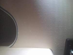

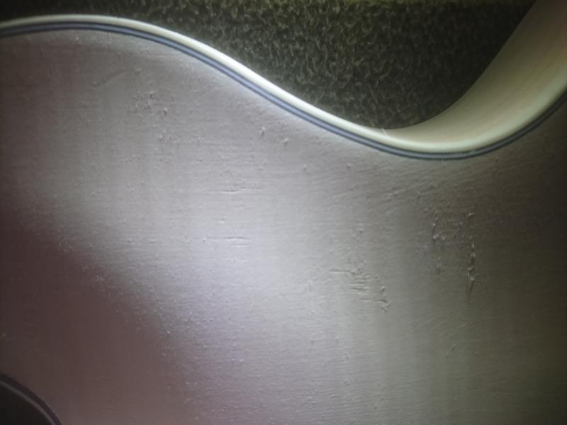

    On the top there are a few places where the veneer is scratched. Normally I would just sand it out, but of course with veneer I am a bit scared in case I sand right through. That would look terrible on a transparent finish, but so will the scratches. What is the best way to deal? Do I try and steam it and see if that works? I would have thought steaming won't work on scratches, but I am willing to try.

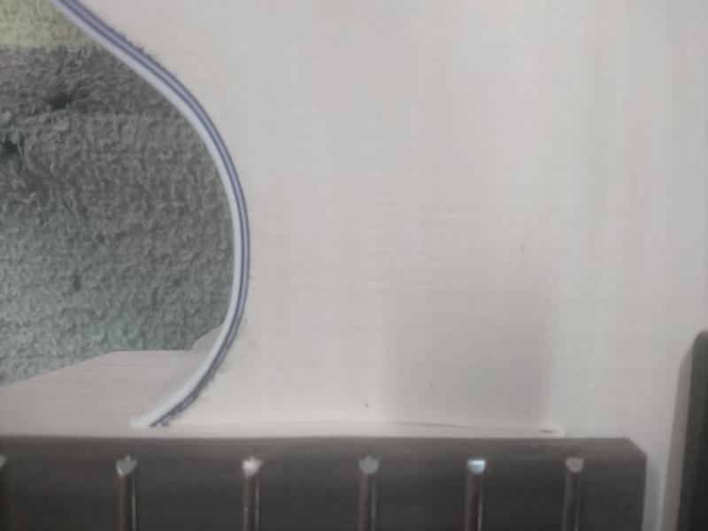

    Next question - the neck fits very well into the pocket sideways, but there is about 0.5 to 1 mm at the end of the pocket where the neck won't go. It is hidden by the fretboard extension, so won't be really visible, but I expect that gap will also weaken the joint. It looks as if the radius of the corners of the neck and the pocket are not quite the same and so it doesn't fit in properly. The neck needs to be a wider radius or the pocket a smaller radius on the curve. The instructions say to adjust the pocket always rather than the neck but in this case it is going to be easy to lightly sand the corners of the neck to fit properly whereas doing the corners of the pocket means getting out the router and making sure everything alights properly before cutting. Any reason not to just alter the neck slightly in this case?

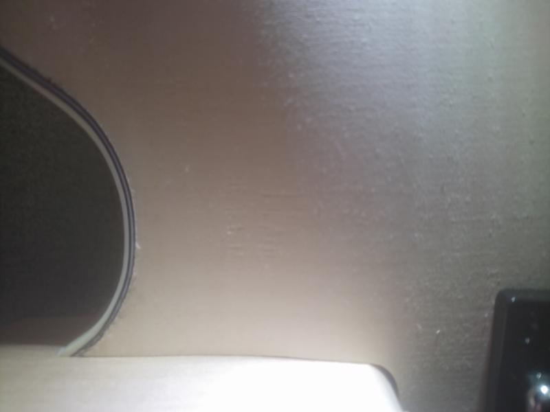

    I took a few more photos of the scratches with side lighting so hopefully they are easier to see. Look like sanding marks for the factory maybe?

    I'd adjust the end of the neck as you suggest.
    You can steam the veneer, it's always worth a go. I'd use the soldering iron and damp cotton rag method rather than a larger iron.
    You can do a light sand of the veneer afterwards, but steam first as it will reduce the amount of sanding required. Let the wood dry out thoroughly after steaming before sanding.
    Be careful when staining as the binding has small stress cracks in it that you'll only see once stain gets in them. The tighter the binding has been bent, the more cracks it gets. So those two front 'ears' are full of the things! Aways mask off the binding if staining. I've found that spirit-based stains penetrates the binding far more than water-based stains do.

    Cool, thanks. So steaming the veneer can't lift it or damage it? If not I will give it a go and see what happens.
    As long as you don't overdo it. The steam and heat can melt the glue in that area, which is why it's best to use a soldering iron so that the heat is as localised as possible, rather than say a clothes iron. Much better to apply just a little steam several times than a lot of steam in one go.

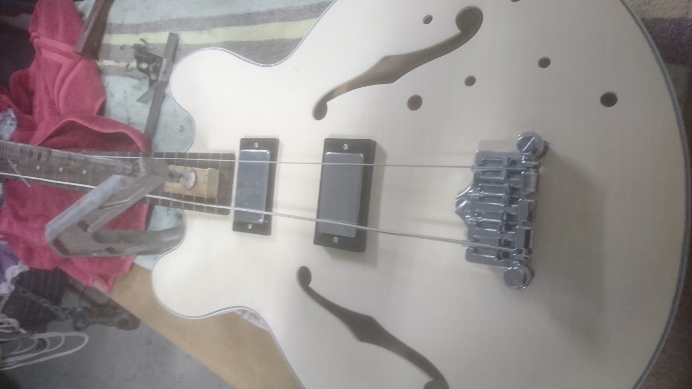

    Just a quick update. I have removed a bit of extra wood from the neck pocket (looked as if the last router pass wasn't quite as big - there was a 1mm high and 1mm wide bit at the base that I took out with a chisel), sanded it square (was just a hair - maybe 1/4mm out) rounded off the one corner of the neck that was a smaller radius and the neck fits very well in it's pocket - I can't see any gaps. Next I have clamped it in place, clamped 2 tuners on and temporarily attached the bridge and 2 strings. Results are in the photo. Everything looks nice and centred to me.

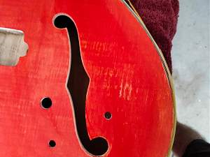

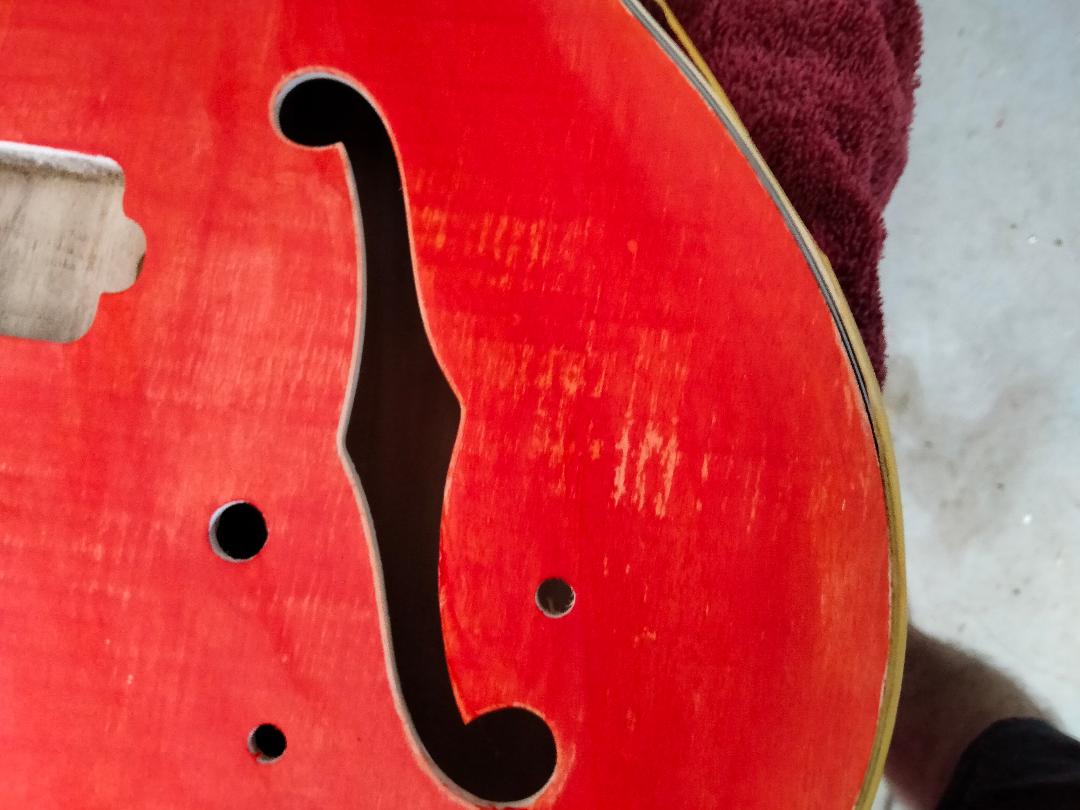

    OK, it has been a while. Life happened and I have taken a long time to do the sanding needed to think about finishing. I have now applied the first stain coat, and there are a few patches that look like glue, even though I cleaned these bits with goof off and nothing showed up when I dampened the front. It just isn't taking the stain in a few patches. What is the best way to deal with this? More goof off? Obviously whatever I do I will need to re-stain.
