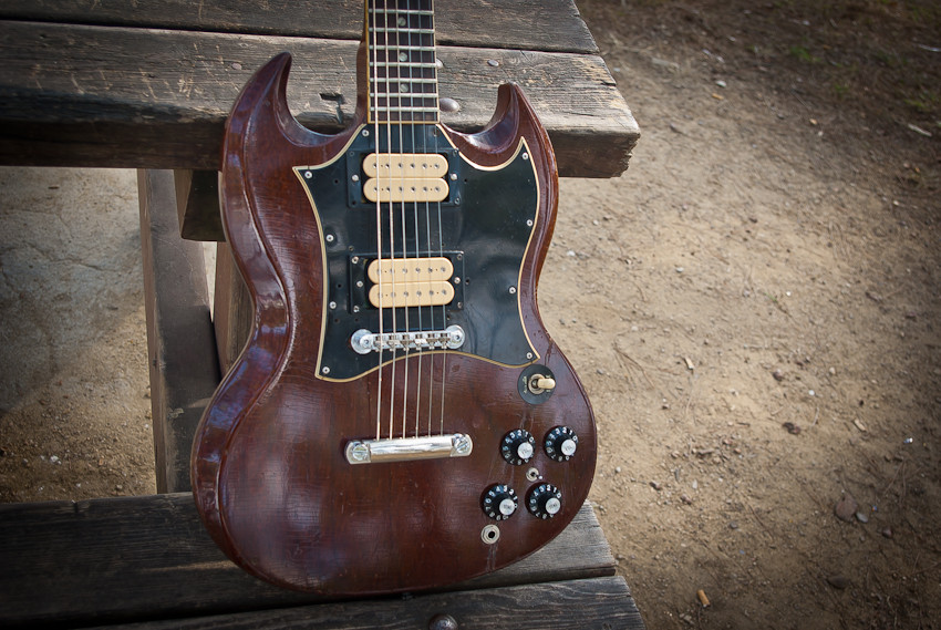

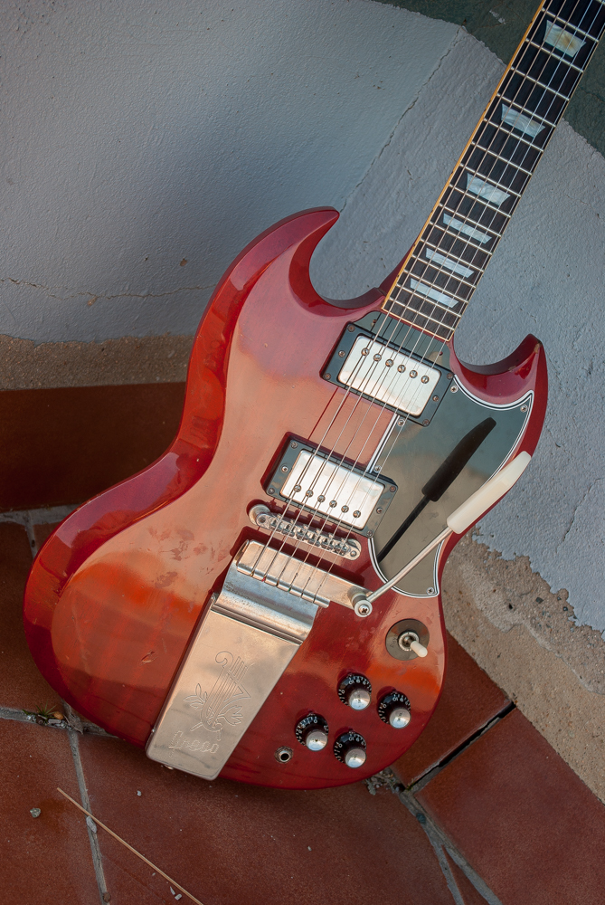

    DingoBass made this guitar and it just hit me that I had to have one.....

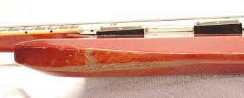

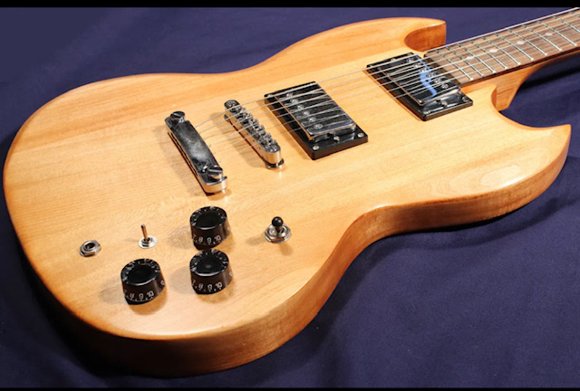

    so i started snooping around the internet and found that i was quite attracted to the SG with deep bevels....like this

    so here we go......
    But will you be able to tune it down to C??

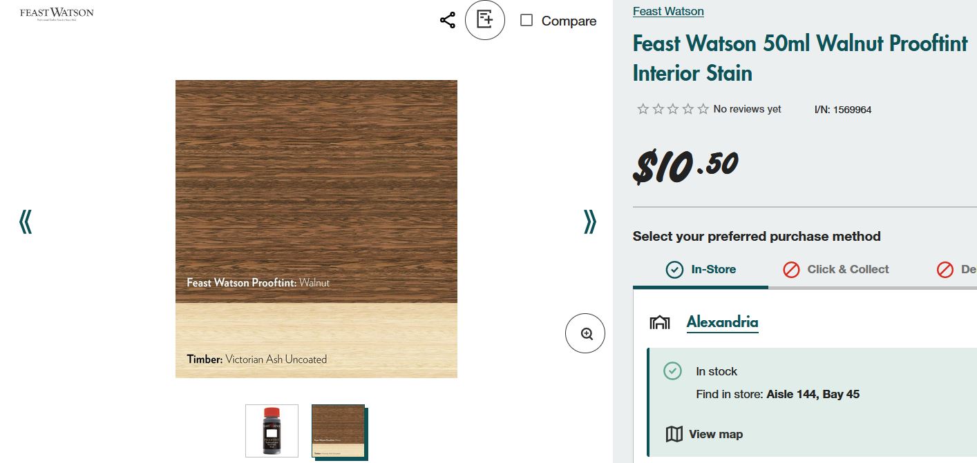

    and maybe even be a walnut colour
    not as bad-ass as Mr Iommi's black.....but that is about as "tough" as i get...

    Gotta admin.... i have been stalking your double sg build which was the incentive for me to look at the photo galleries of finished SG's.... your finishes are gorgeous (damn you, you're a bad influence!!!!)
    Back to the body: currently the weight of the body is 1.070kg.
    I am going to try and get some deep bevels cut into this body and wonder how light i can get it???.....
    dry fit photos to follow...
