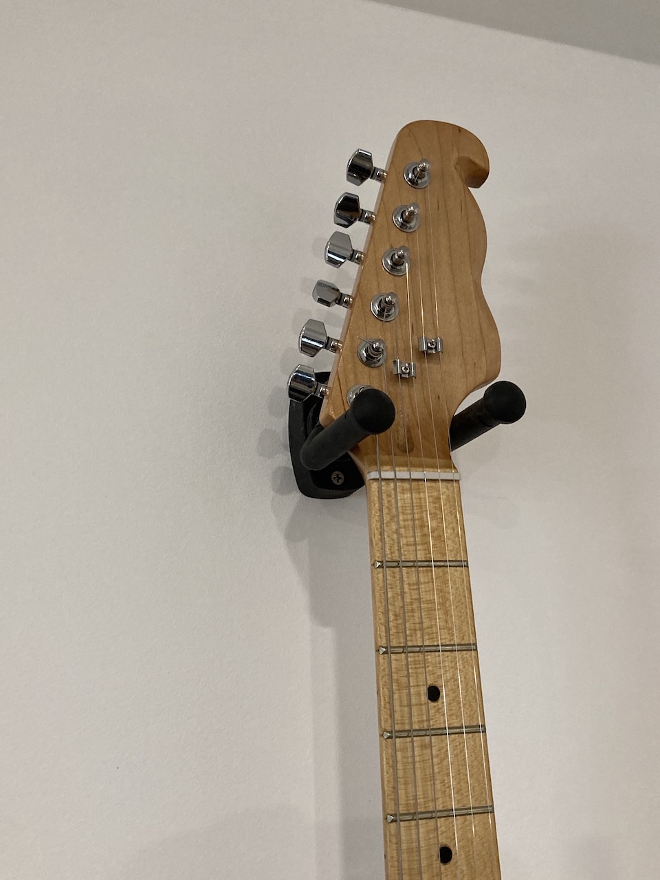

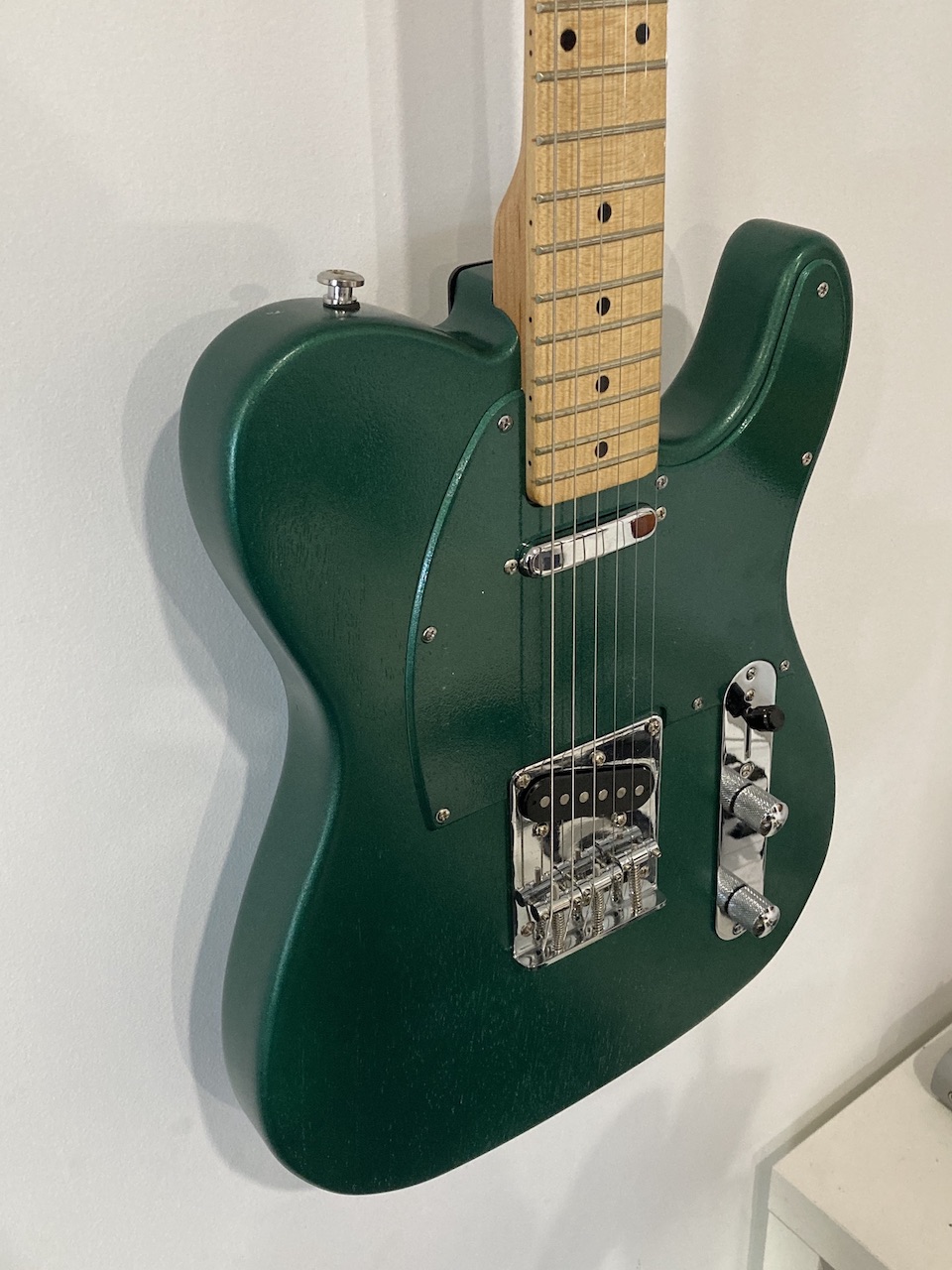

    Hi all,
    got a Tele kit from Pitbull last November, started working on it in Jan, then slowly got my head into the game to get it done this week (June 2021). I started by sanding the body down, then noticed there was no hole connecting the bridge pickup cavity to the control panel cavity. Got the cordless drill out, didn't think about length or angle, just drilled away, next thing I've put a hole through the back of the body!!!!!
    After the sinking feeling in the guts went away I got a longer drill bit and fixed the hole with a wood dowel and glue. Continued to sand the body to a fine grit (800), then went to work on the neck.
    Took to it with sandpaper and a rasp to get the shape I wanted, which was a 'stinger' type effect. A real deadly-looking design as I wanted to steer away from the traditional tele headstock shape.
    Had to think about finishes etc...I wanted a green guitar, that much I knew. I took to You Tube and watched a tonne of vids on how to make guitars etc. decided the cheapest/easiest for a newbie was the spray cans from Dupli Color. Down to Supercheap Auto, bought some grey primer, a couple of cans of Emerald Green, and some clear poly. ended up putting four cans of EG for the colour. One can of poly wasn't enough, so went to Bunnings for some Cabot's cabothane x 2.
    So many options for finishes for the neck...I wanted this thing to shine brightly! got some Boiled Linseed Oil for colour, it looked nice as I wanted a tint but didn't want to use stain. After this I poly sprayed the whole thing, including the fretboard, to get a real nice gloss to it. I'm not fussed about playability re this - I've a CV squire with full gloss neck and it plays fine.
    thought about the pickguard and decided to scuff it up, primed it, then put a few coats of Emerald Green to match the body, followed by poly on top.
    finished the body with maguiers compound and wax, but I didn't get the mirror shine I wanted. Aw well, can't expect perfection. Probably should have used more poly cans, or the wipe on stuff maybe. Don't know how it sounds yet as I've yet to wire it up. give me six more months to learn how to solder then I'll get back to ya.
    cheers from Melb

    Well, slow and steady wins the race...
    However I'll be very surprised if you don't have issues with the poly on the body delaminating in the future.
    Oil based polyurethane over an acrylic lacquer is not a recommended combination due to their incompatibility. Lacquer can continue to expel gas from it's solvents (often referred to as "gassing off") for weeks, months or even years. Polyurethane will cure like a hard plastic over the lacquer trapping the gas which is trying to escape. This will cause the poly to lift, bubble and potentially peel.
    A lacquer clear coat is recommended over a lacquer base coat.
