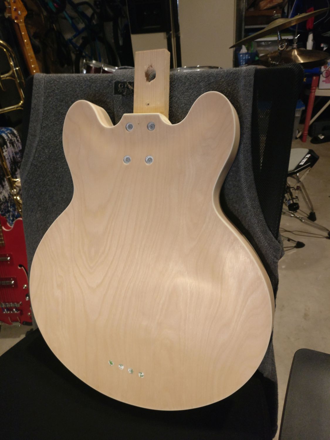

    They're not all bad. As Simon said, the weight is great, and I actually liked the figuring well enough on my ES to leave the back natural.
