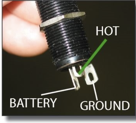

    i just built the 4 string version of this, the barrel jack it comes with is really bad, i would strongly advise to buy a switch-craft one,
    its a little confusing as to which is ground and tip etc on the barrels, hopefully this pic will help..

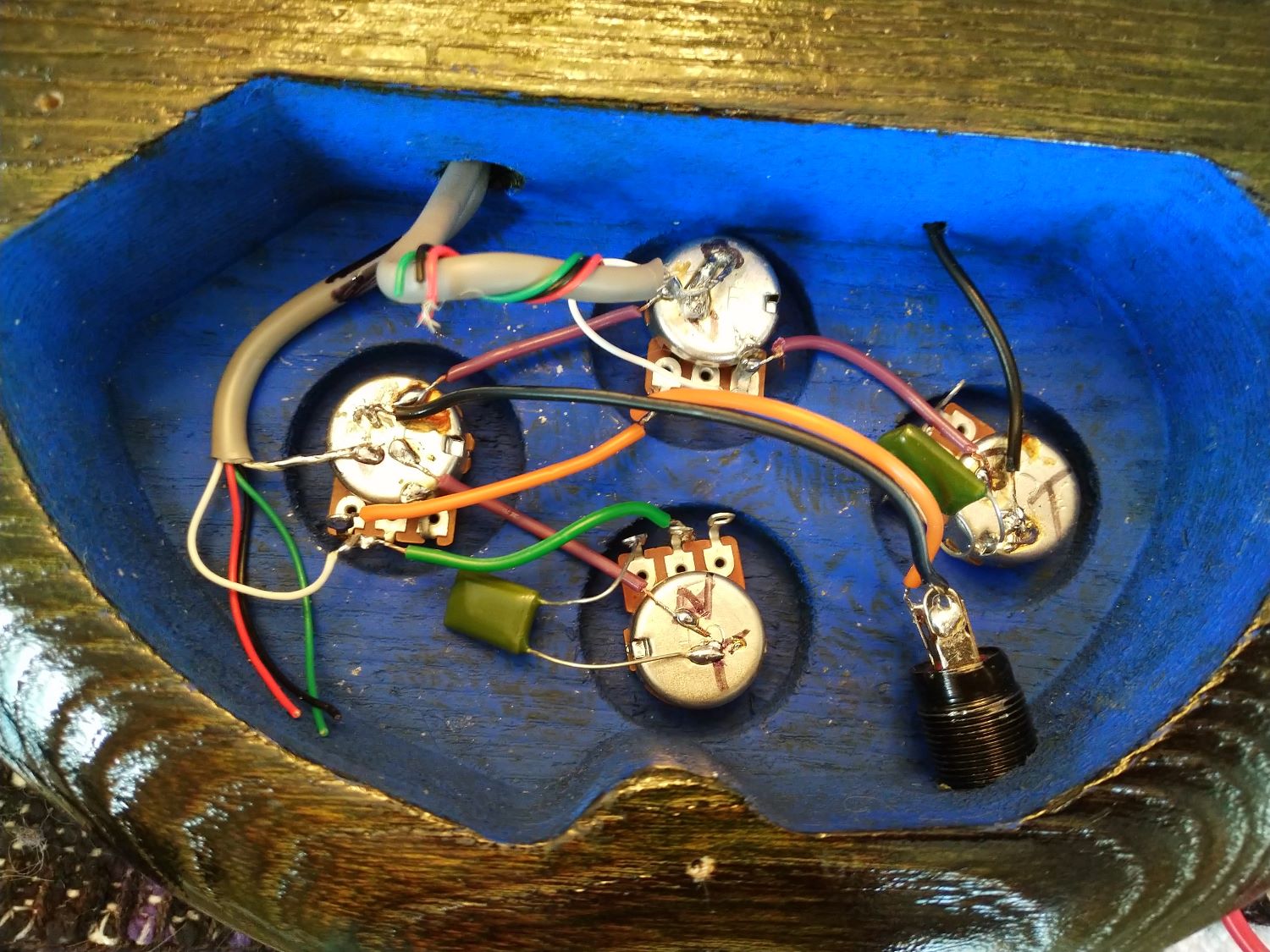

Name:	pickups wiring.jpg
    I've attached a photo of current wiring.
    Pot at top (12 o'clock) is bridge volume.
    Pot at right (3 o'clock) is bridge tone.
    Pot at bottom (6 o'clock) is neck tone.
    Pot at left ( 9 o'clock) is neck volume.
    Both of the volume pots have one of the poles soldered to the shell of the pot. It's the pole on the right, #3 as we're looking at them.
    I didn't think to change how I had them positioned, so they would be more inline with the wiring diagram till just now, actually.
    The braid of wires coming out of the pickups, I've only used one white wire and one ground wire.
    The red, green and black aren't used. (Could be part of the problem?)
    With the 5 wire pickups you need to solder together the 2 unused wires and tape them up,
    I’m not certain on which wires are what here (Simon explained it above I think) but you should only have 2 unused ones and another one goes to ground as well
    At the moment, three out of the four coloured wires aren’t connected at all. Hence no sound. What I don’t know are which the correct wire colours to solder to what.
    We need someone who knows how the pickup colours go.
    This is my guess.
    Green and red soldered together,
    black is the hot
    white and bare is ground
    According to this post, https://www.buildyourownguitar.com.a...l=1#post208393
    the black will be the hot signal, green and the braid shield should be wired together to the back of a pot and red and white twisted and soldered together and the joint insulated and not connected to anything.
    There are many ways to connect up the wires, and as long as all 4 of the coloured wires are connected somehow (just not all to ground) then you’ll get some sort of output from the pickup. But it may just be from one coil, or the two coils in parallel rather than in series as intended.
    I’d try the above wiring on one pickup first and see what it sounds like.
