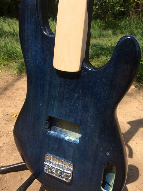

    My girlfriend's brother is a classically trained violinist/music teacher and mentioned that he wanted a 5 string fretless with no markers. I proposed that if I assembled one, he could pay by buying me the kit I had been eyeing for months. He agreed and I ordered the kits from the internet. My intent for my payment bass was a 50's style P bass (with a humbucker) with maple fingerboard. I ordered the "PBG-BN4MF FRETLESS MAPLE NECK W/MAPLE FRETBOARD FOR JB AND PB STYLE KITS" from Pitbull. I also ordered some black Gotoh Lollipop tuners and a black Gotoh bridge, they should arrive soon. I might put an additional humbucker at the neck position, as that was my original plan, but I haven't yet decided. I have dyed the body with a black/blue burst and coated with poly. I now have to wait 30 days for the poly to cure to finish sand and polish the body. This is my plan:

    This is what I have so far.

    Looks good! Very cool headstock. I don't think I have ever seen a maple fretless before. Was that a special order?
    Erm, am I the only one who's noticed it seems to be a string short? I count 4 tuner holes, not 5.....
    I'm sorry if I was unclear. The 5 string is a jazz bass I will be doing for my girlfriend's brother-in-law. This blue P-bass was my payment for doing the 5 for him. I'll post pics of his jazz when I start working on it. I have only seen a few maple fretless fingerboards and they were stunning. I don't know how well it will wear over time but that's part of the experiment! I am still unsure whether I will use CA glue, epoxy or oil on the fingerboard. Yes, it was essentially a special order. The kit came with a fretted maple neck and it was from another website. I ordered the fretless neck by itself from Pitbull. It says on their website that if you order a kit from them (Pitbull), you can get a different neck if you contact them and give them some extra time to match it to the kit. Thanks, my headstock idea was an homage to Leo Fender's original Tele headstock. It was fun getting out the old carving tools and whittlin' in the sunshine!
