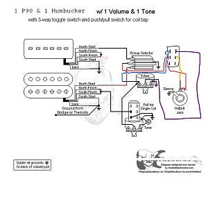

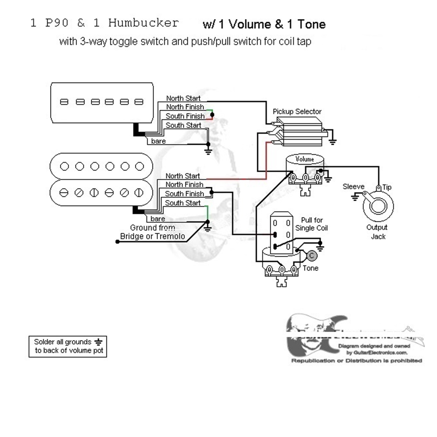

    Hi guys, I want to add a blower switch to the wire diagram I've posted here. Going off what I've seen online I can only connect one pick up to the blower switch. I've been trying to come up with ideas but I can't see a way I could add the 2 pick ups to 1 switch?
    Anyone have any ideas? Thanks, Rod.

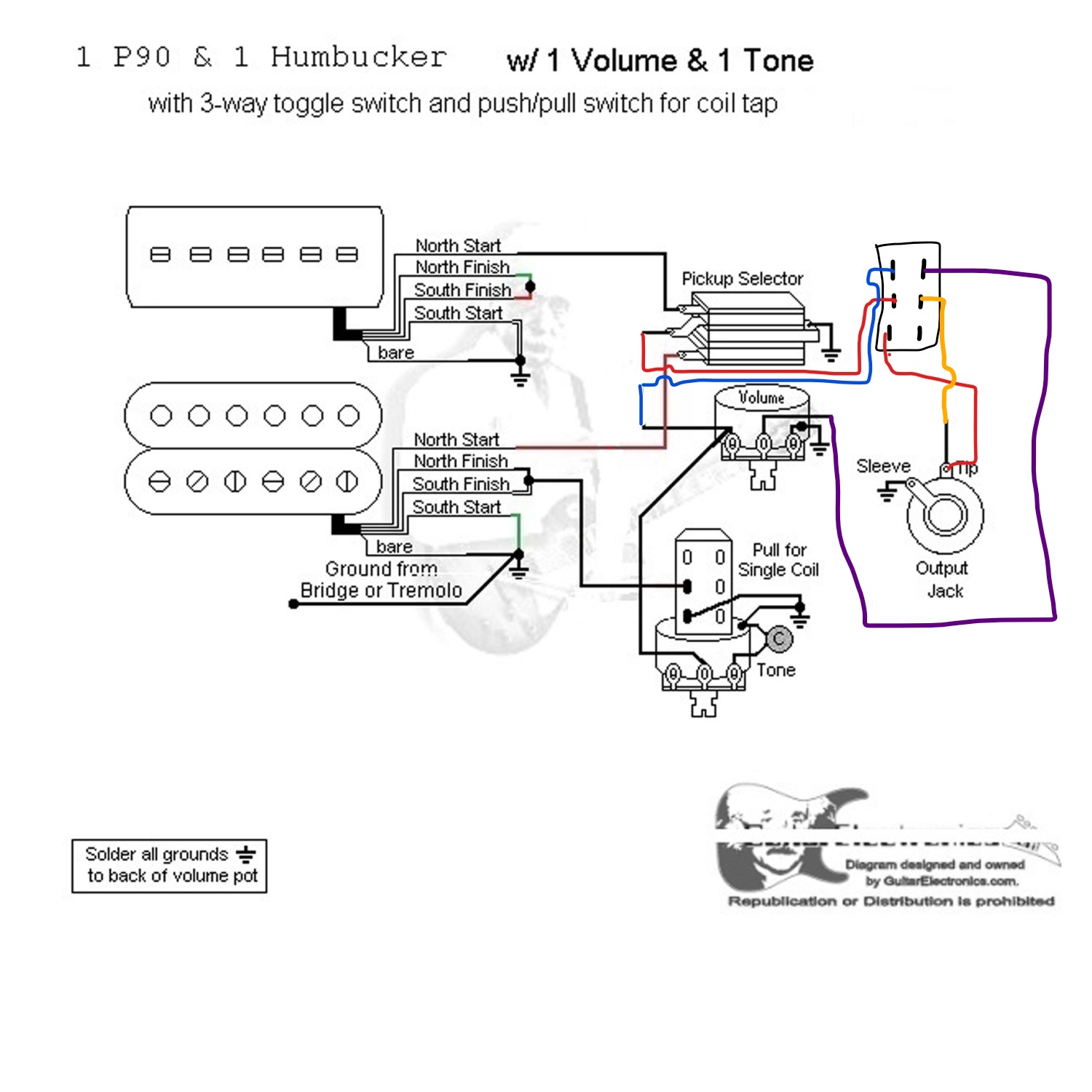

    Pretty easy. The pickups go to the selector switch first, so you've got a common output. So if you make the volume pot a switched pot like the tone pot, then you just take the selector switch output to the common of one side of the switch, take the 'down' position switch output pole back to the normal volume pot connection, and the 'up' switch position output pole direct to the jack socket tip connection.
Name:	humbucker p 90_LI (2).jpg
    But you also need to break the connection on the output side of the volume control, otherwise you've got a path back for the output signal through the volume pot to the tone control. Remember that when the volume pot is at 10, the pot's input and output tabs are directly connected, so the tone control would still be in circuit.
    So, when the switch is pulled up, the pickup output bypasses the volume control and the tone control connection,. When down, it's business as usual. So the blower switch operates for all pickup selections.

    Thank you very much for the diagram Simon. I've got a SPST switch. Looks like I need a DPDT..

    Note it's a double pole single throw switch you need (two position) not a double throw switch (three position).

    Thanks again Simon. It's a on on two position switch with 6 connections like in your your diagram. When I paid $1.99 for it I didn't give much of a chance..
    They don't normally cost much, but there's a lot of mark-up when sold singly. I bought a pack of 5 on/off/on spring return to centre switches for a similar price each and they're fine.
    Might be worth checking the contact switching and connections with a multimeter, just in case the two sides of the switch have opposing connections e.g centre to up one side, centre to down the other.
