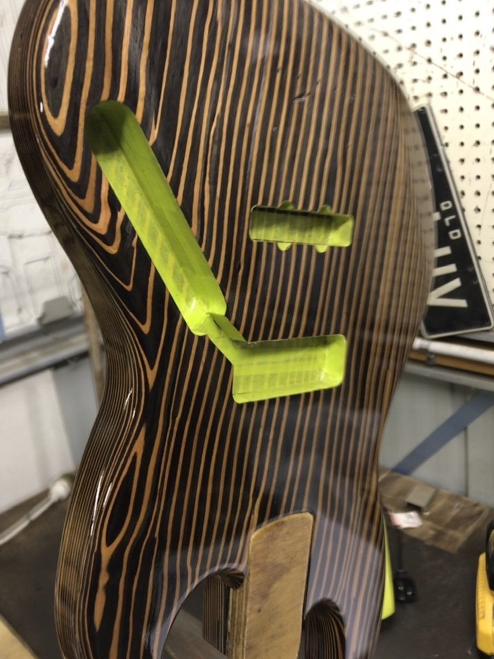

    I am in the middle of the same kit. I sanded round the edges pretty hard to clean up marks but only lightly sanded top and back as I still wanted some “grain marks” to be visible and just feel-able. I did not go through the colour at all. I started at 180 with only light pressure. Body was very flat to start with front and back. Click image for larger version.
