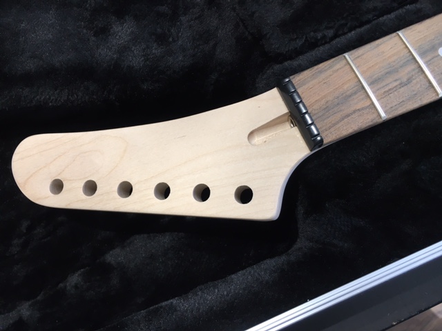

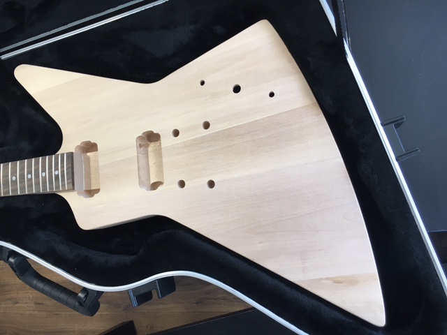

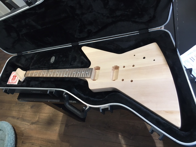

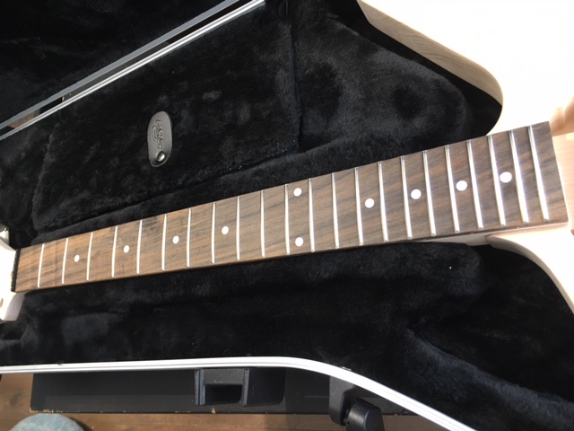

    Some pics straight out of the box and into its case. Kit looks to be solid! no real issues as far as I can tell. Gonna do a mock (dry) build with a couple of strings first and then... sanding begins.

    I found the neck profile on my EX-1 quite chunky and wished I'd sanded it down a bit on the sides of the neck before I'd sprayed it. I may well sand and respray the neck this summer.

    Looks great - every time I see someone's new kit I think that's what I'm going to build next!
    How does the control layout work out? Vol, switch, Tone?

    Hey Groovyman, it looks the biz! its a lot chunkier than I thought it was gonna be too.
    I think that's how the layout goes yeh? This'll be my first time even playing an explorer! its one of the few shapes I don't own haha

    I was talking about the neck profile, rather than the headstock shape (which is a bit rounder than a real Explorer). The neck (on mine at least) has a very chunky 50s Gibson LP profile. Not uncomfortable, but quite a handful and not what you'd normally find on a hard rock/metal guitar. I'll probably sand the sides of the neck down to create more of a modern C profile.

    I'd avoid taking any wood of the very back of the neck (you don't want to sand trough to the truss rod or make the wood too thin so that adjusting the truss rod cracks the neck), but you can certainly trim the 'shoulders' down from what I'd call a 'D' to a 'C' shape. That can make the neck feel a lot more comfortable in the hand.
