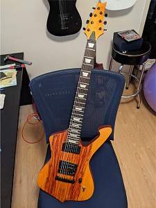

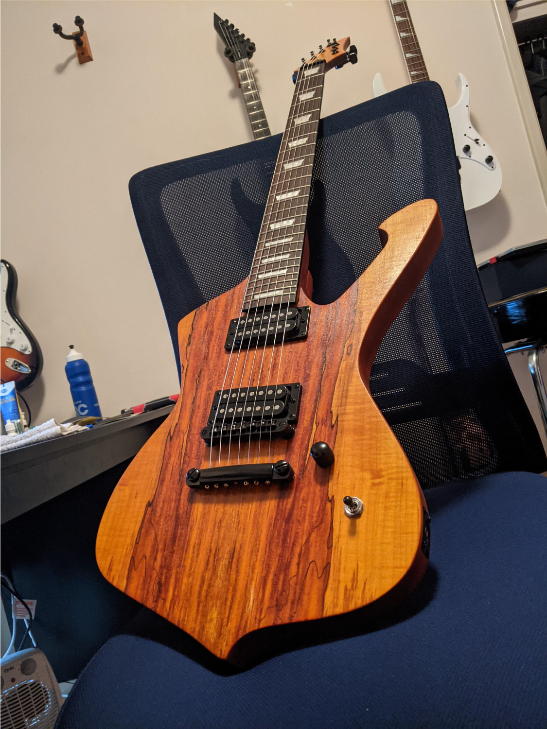

    Finished product!
    Here it is!
    Very happy with how this has turned out, the slight sheen on the top is exactly what I was after.
    Getting used to playing a 7 again (after about 4 years of not owning one) is taking longer than I anticipated.
    There are still a few tweaks I want to make before I am fully satisfied but nothing a good setup won't fix.
    Now to decide on a name for this guy... i'm thinking either IC-277 (7 strings, 27" scale length). I might end up 3D printing a logo and sticking it on the headstock at a later stage.
    I plan on taking some more/better photos on the weekend when the sun is out. But for now, I desperately need to practice
