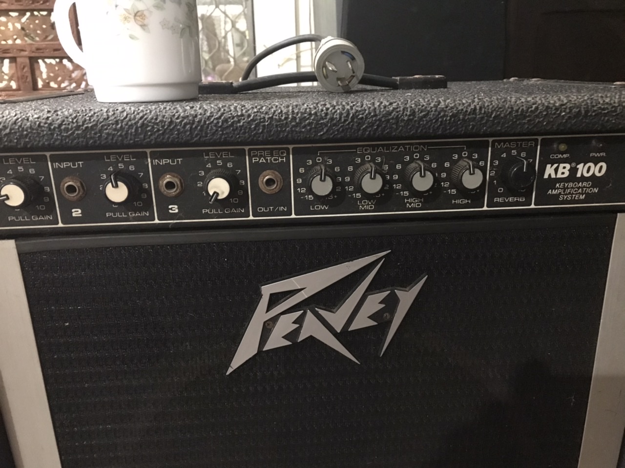

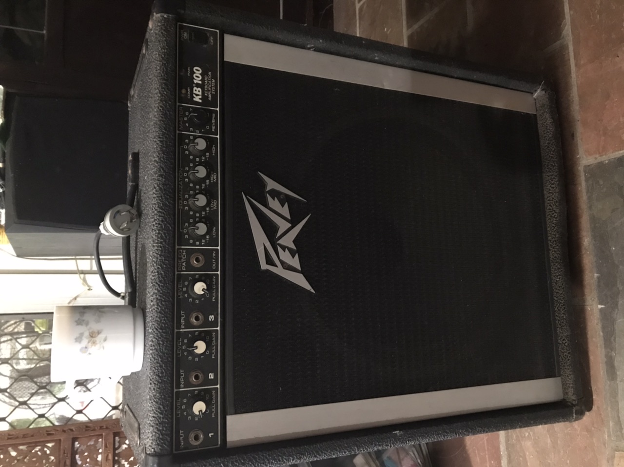

    I think this is the right place for this...
    I realise that this is made as a keyboard amp but a couple reviews I have looked at say good for bass and acoustic electrics. The best part is that my parents neighbour gave it to me and said if u don’t want it then throw it out because if u don’t take it then I will. One input is not working but everything else seems fine.
    Does anyone have any experience with these? Is it worth cleaning up and getting everything going again? Cheers

    It should be great for bass or acoustic electrics. KB amps have to handle all the highs to the lows on a keyboard which goes lower than a bass and as high as the highest notes on an acoustic guitar.
    I agree with McCreed that there is probably deadly voltage inside in the big caps. Best not to open it if you can avoid it.
    You could just not use the non-working channel. You still have two, so you might not even miss it. McCreed may be right that a solder connection may have come loose. Before opening it or taking it to a repair shop I would be inclined to try to clean up the jack a little with some contact cleaner on a Q-tip. It may not have an effect, but there is enough visible rust on the jacks to at least give it a shot....
    Was thinking that. Is only 2 of us at any one time playing anyway. I have gotten by up till now with a single small amp, so i think we should be right. Apparently has not been used for quite a while, so might just tidy it up as much as I can without opening the case up. Thanks for the quick replies. Might be a job for a rainy day ..... hang on a minute......
    Success. Little bit of electrical contact cleaner soaked on a piece of dowel slightly smaller than 1/4". Measured the length and shape of input jack and worked in and out a couple times. Little bit of crud came out and tried some sound on all inputs and works a treat. Thanks for the tips.
    3,004
    I am guessing you'll be pretty happy with it for bass. It's a 1x15 right? It should be built like a tank. Plenty of amp to play bass in a practice session or even small gigs. Nice get!
    Bingo! That was too easy!
    Yep. 15inch. According to Dr google it is a 15" eminence made 8ohm 100w speaker made in the 43 week of 1987. Well over 20 kg i am thinking and bloody solid.
